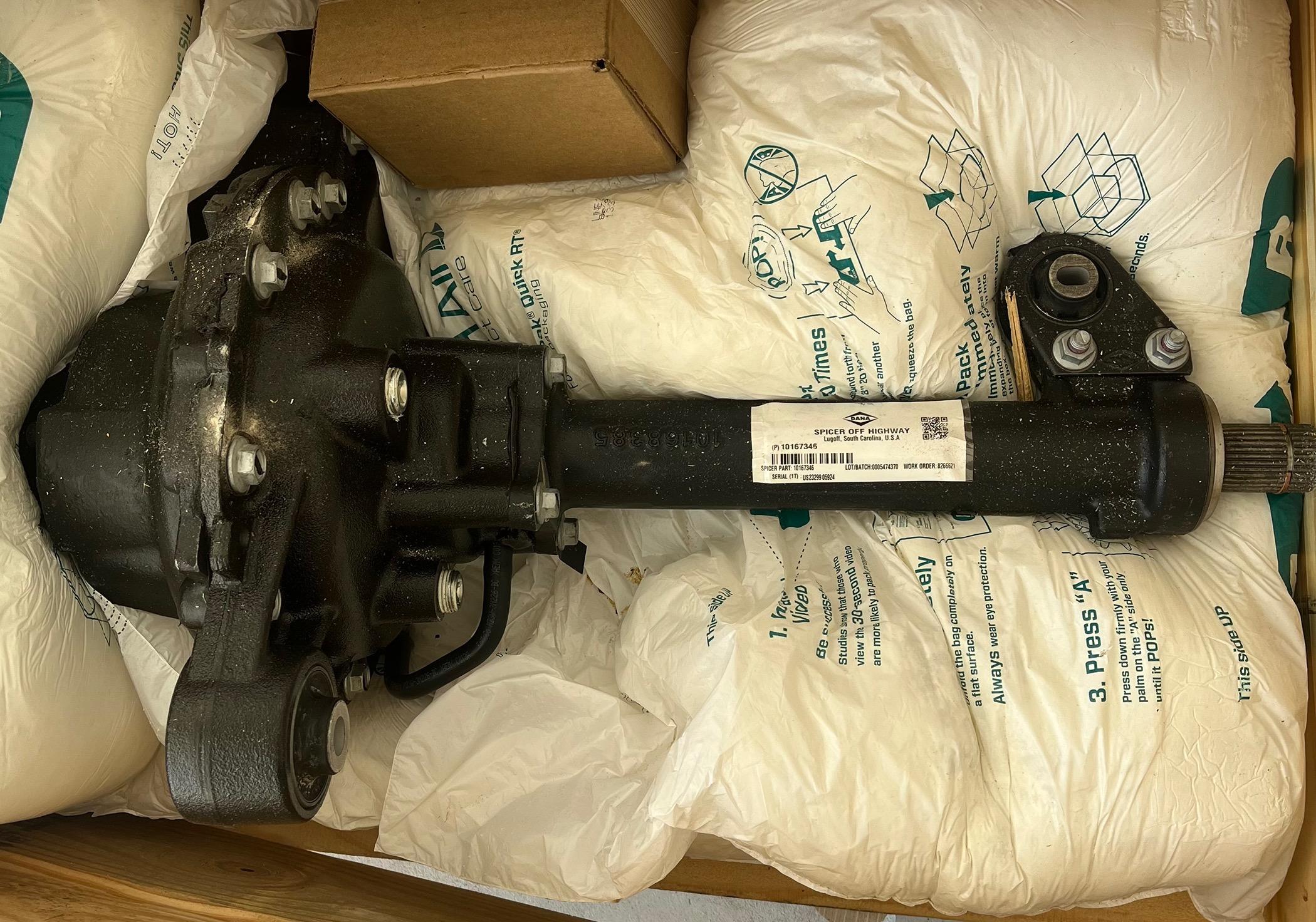

Long time lurker and decided today to create an account and start posting. I'm currently doing a pretty extensive build and my 32 spline FDU is actually scheduled for delivery today! If you want to upgrade to the 32 spline half shafts you will need the FDU as well. RCV has a lifetime warranty on the 29 spline shafts running 40's, but I think your weak point at that point will be the intermediate shaft-and in that case the broncbuster bandaid isn't going to help much. I originally planned on running the RCV's so I could keep the factory axles as spares, but again that isn't going to help me much when the intermediate goes and takes the differential out with it. Bit the bullet and went the full distance with the Spicer upgrades. Good luck with your decision!
https://danaproparts.com/i-30498010-ultimate-dana-44-advantekfront-drive-unit-fdu-fits-2021-ford-bronco-4-88-gear-ratio-electronic-locking-differential-32-spline.html?ref=search:https://danaproparts.com/search.html?q=FDU
This was the idea behind me upgrading to the UFDU vice the BB Band-Aid because the intermediate shaft was not going to be addressed. After selling my RCV's & Stock FDU it ran me an extra $1K over the BB Band-aid so it was a no brainer & the fact my wife insisted I do it 🤠
It definitely seems like the prudent way to go. Funny how that BB guy will talk smack on 74Weld for something like the billet steering rack “it’s just a $6000 shiny piece of aluminum that you don’t need” but he’ll turn around and sell a shiny piece of aluminum for an intermediate shaft where the housing isn’t even the issue. The more that guy talks the more I see him as a shady used car salesman.
It’s so beefy… 🤤
