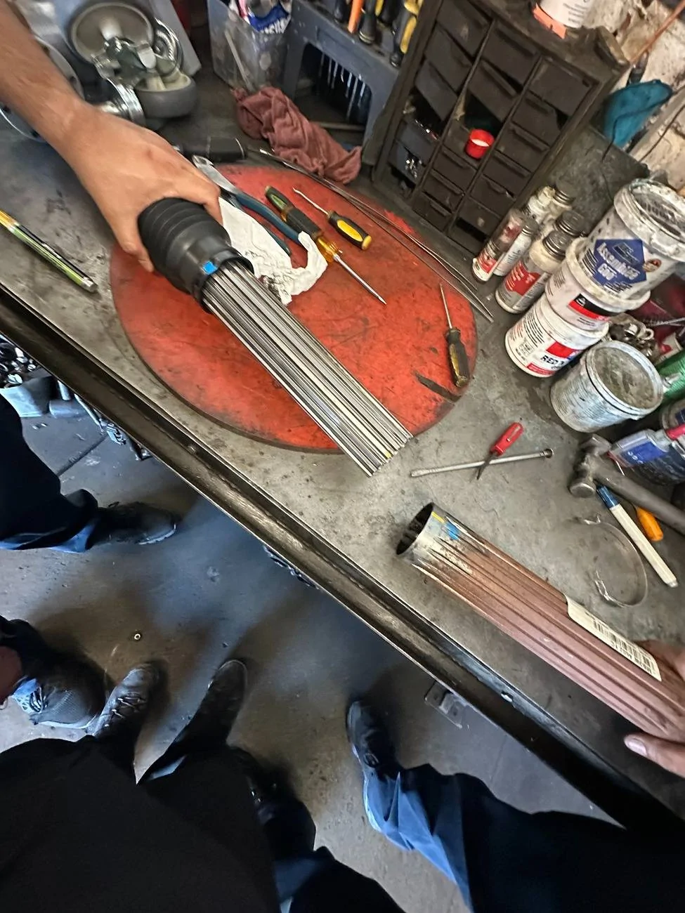

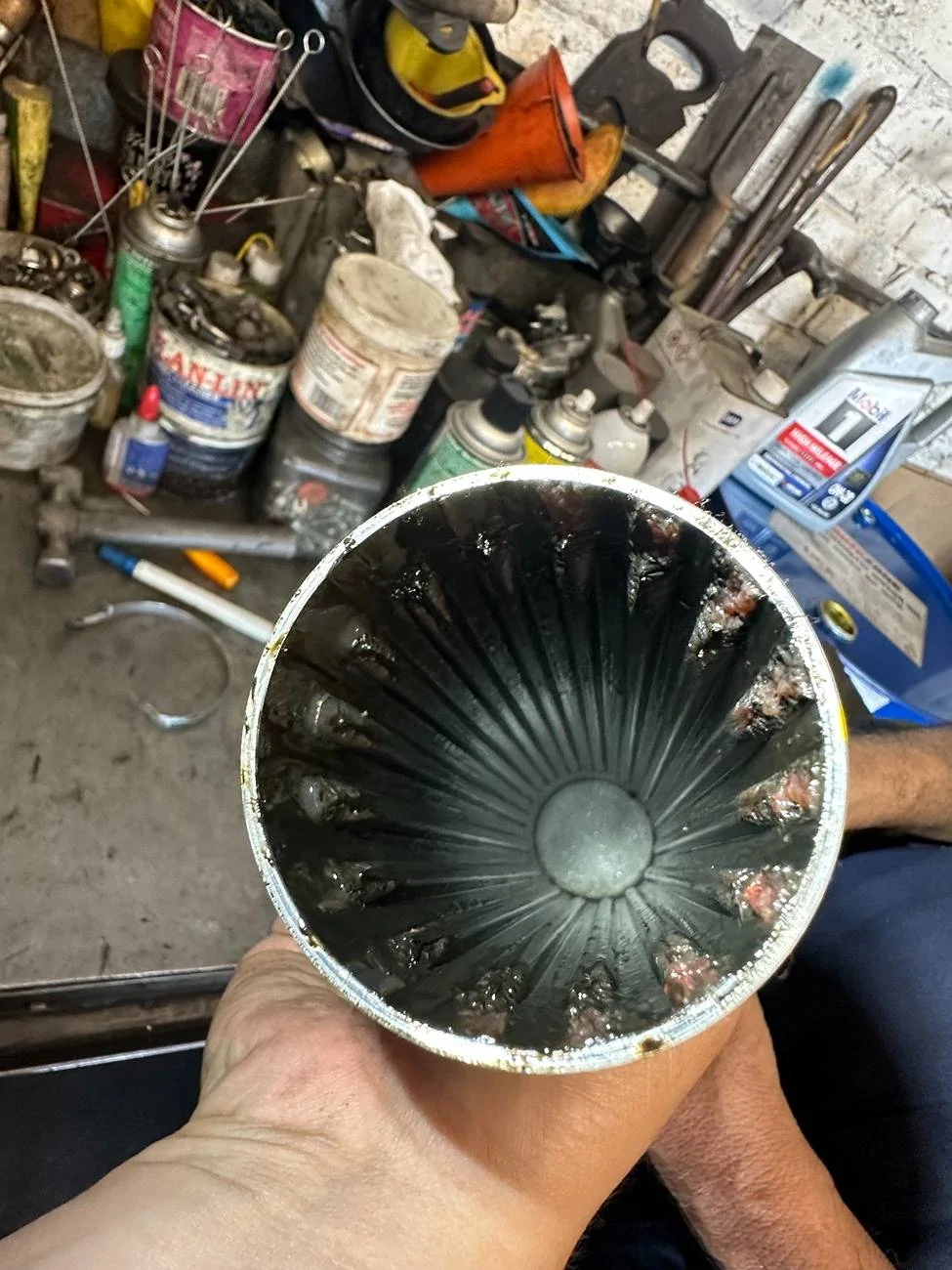

Performed the greasing of the driveshaft today. It's a little different from other Driveshafts I've seen before, very long articulation. Very little grease was in there, one tube of PTFE was enough. used some other type of clamp I got from a local reman shop. Drove around for 45m, so far the clunk is gone completely. There was some gouges on the splines and sharp areas. So it was causing some damage to them. I'll report back if it returns.

Gabriel, are the splines keyed like the Ranger so that one way only driveshaft couples back together?

Wow, that is/was dry!!
