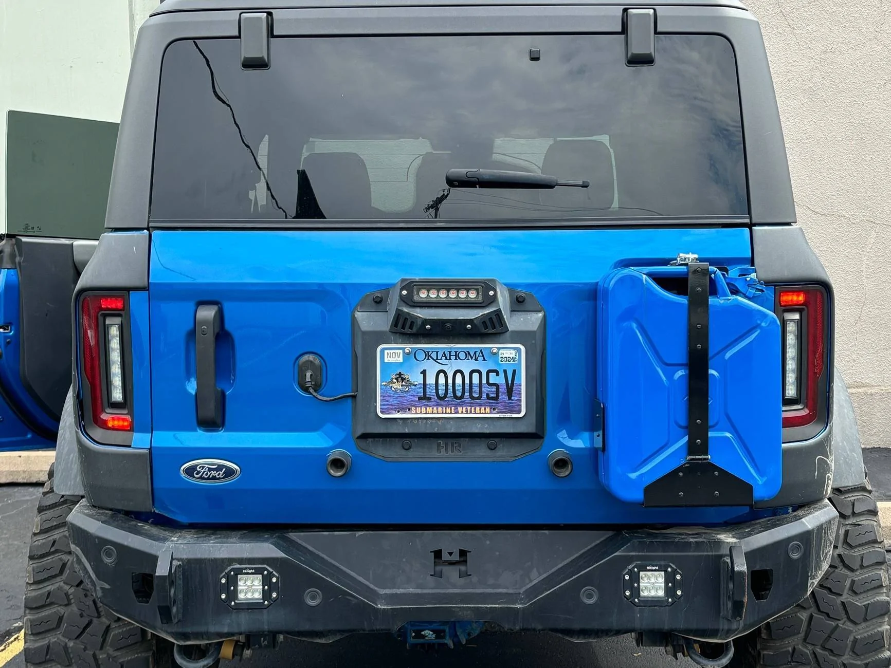

Count me in as another Oracle user on a second set of tail lights. Still, the set is 1/3 the price of a single Ford tail light so I guess I'm still ahead of the game?
I mean... are you though? Time is money right? Is it worth it to save a bit of $$ but have to constantly swap them out?
