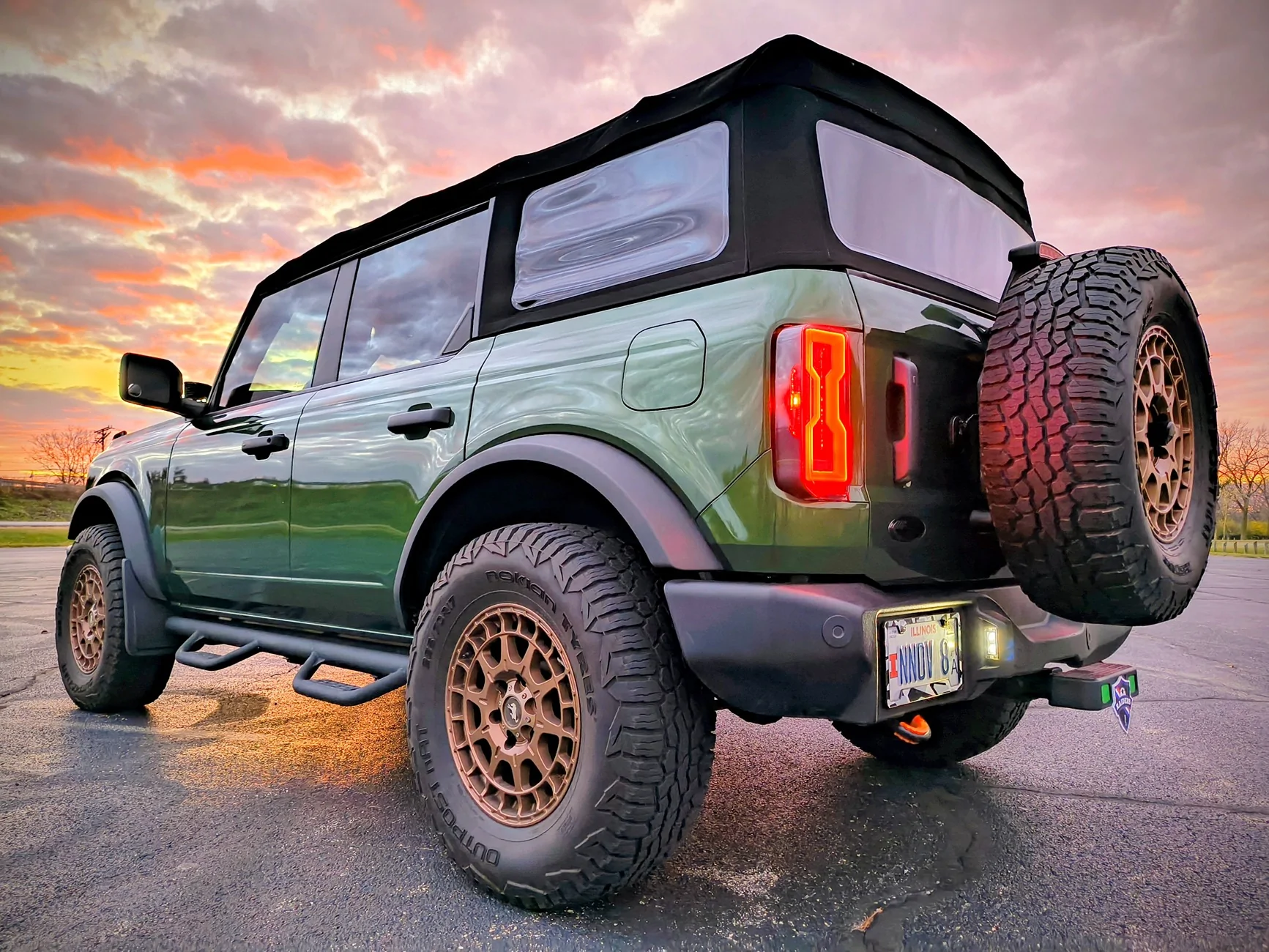

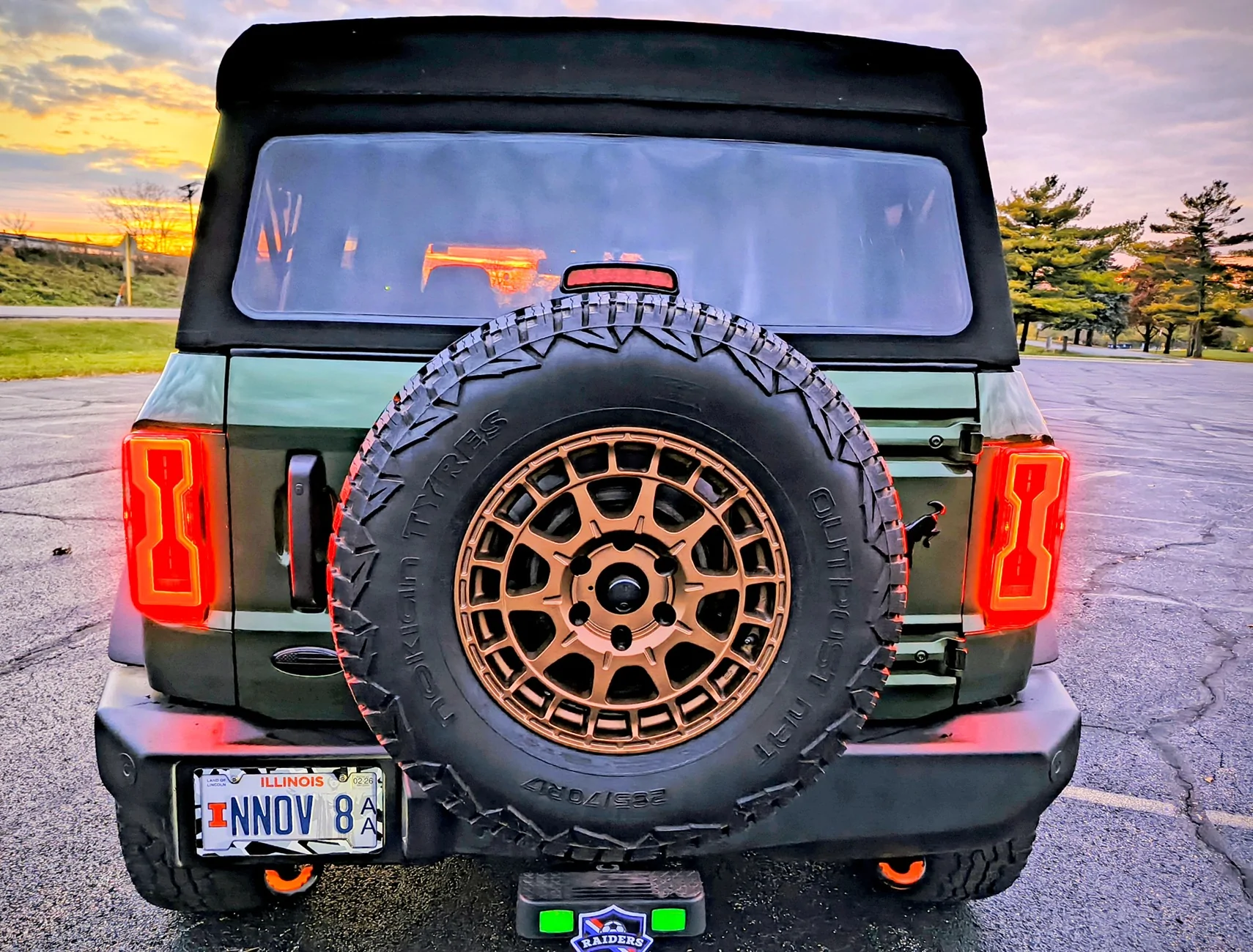

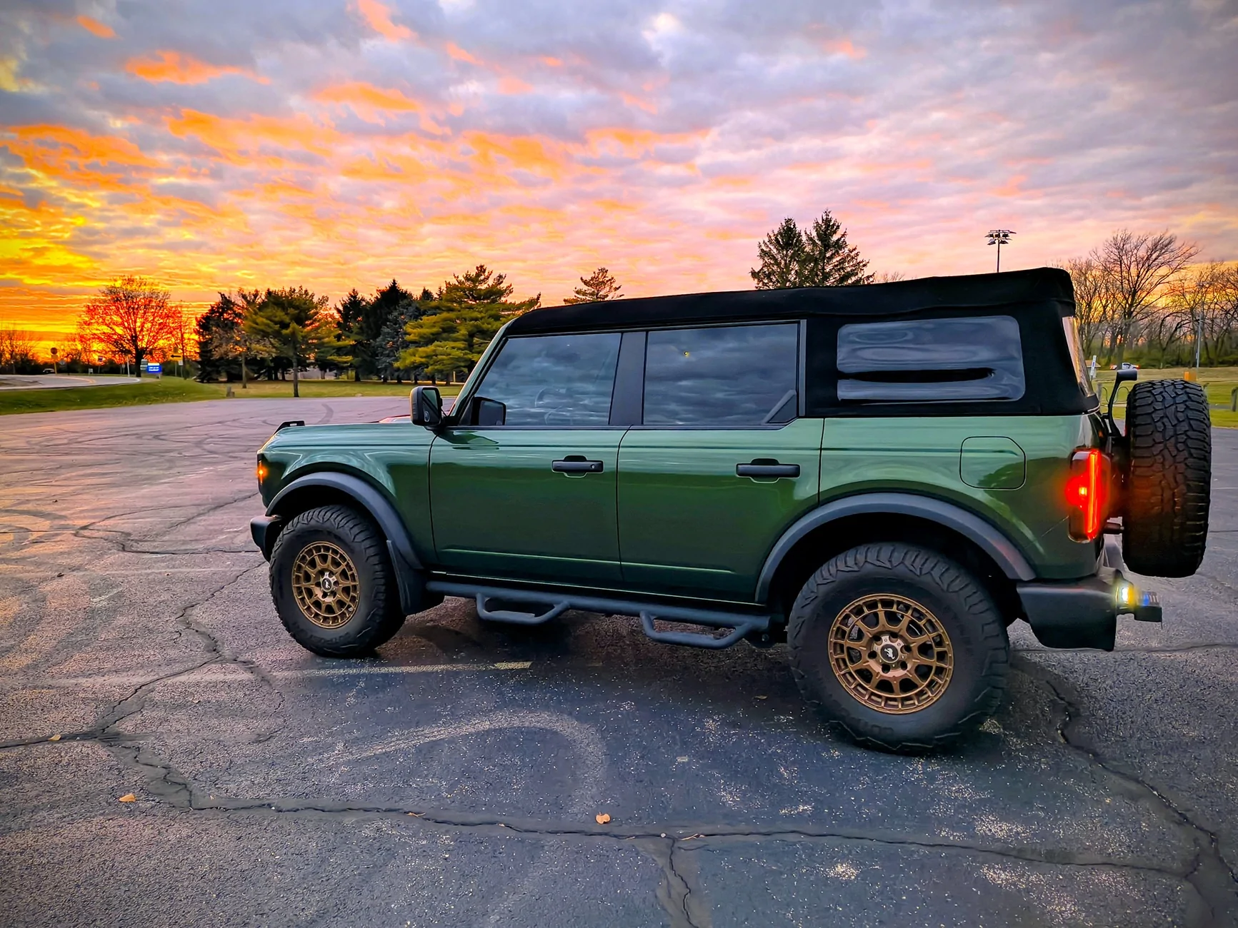

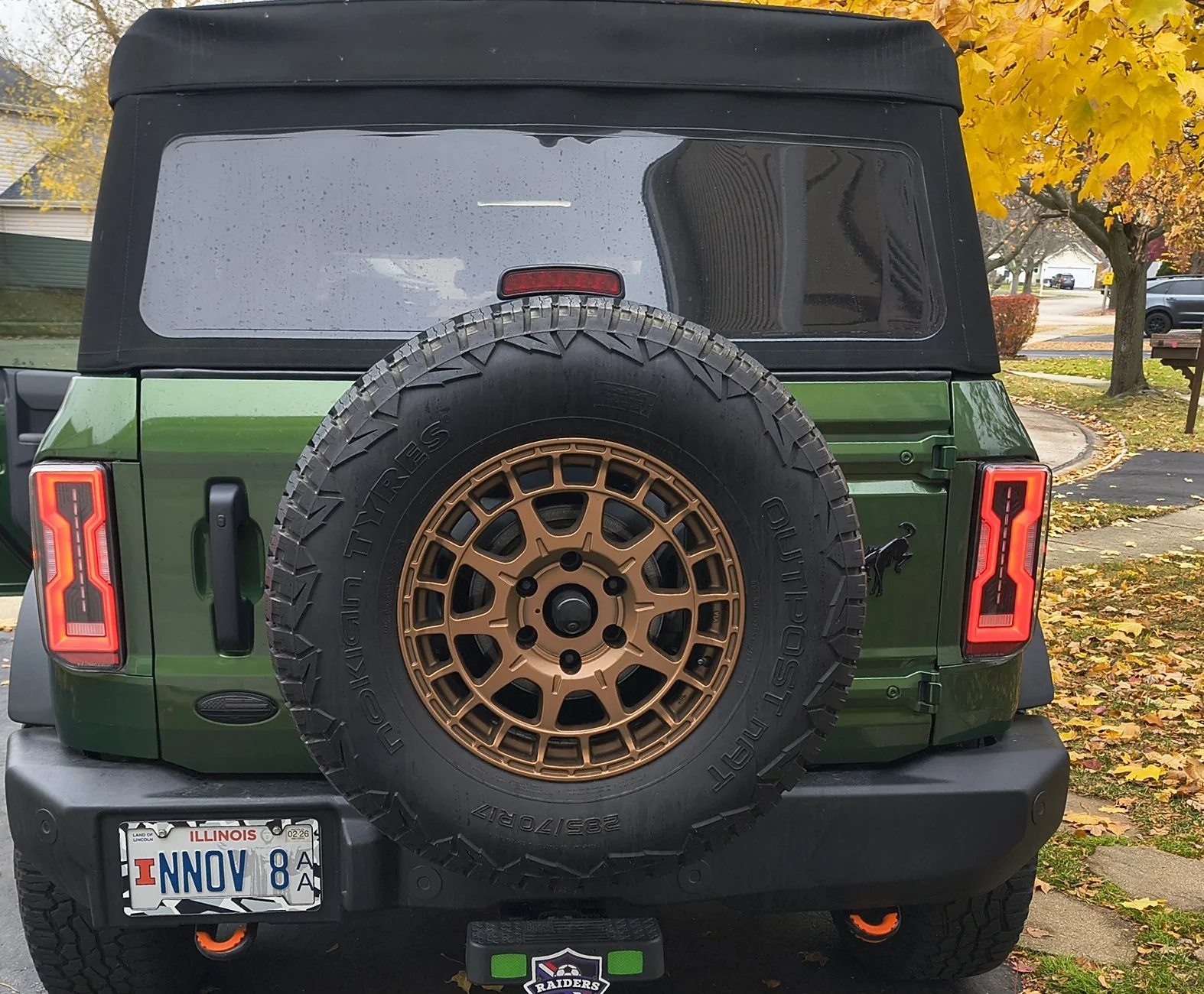

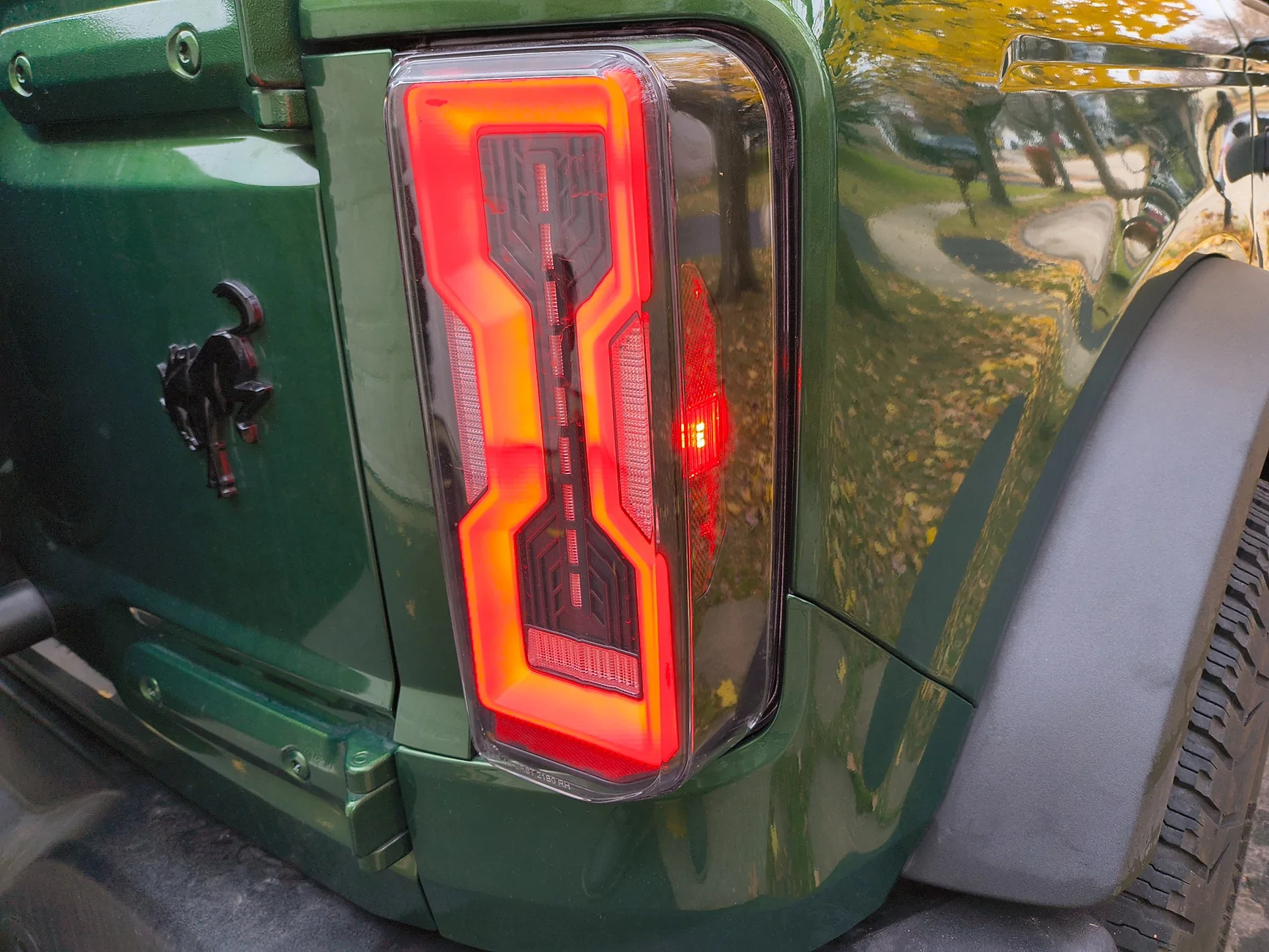

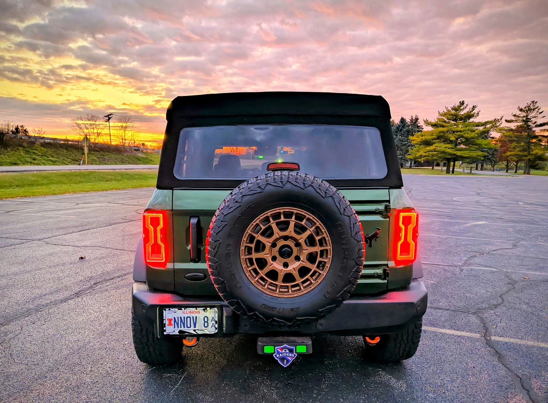

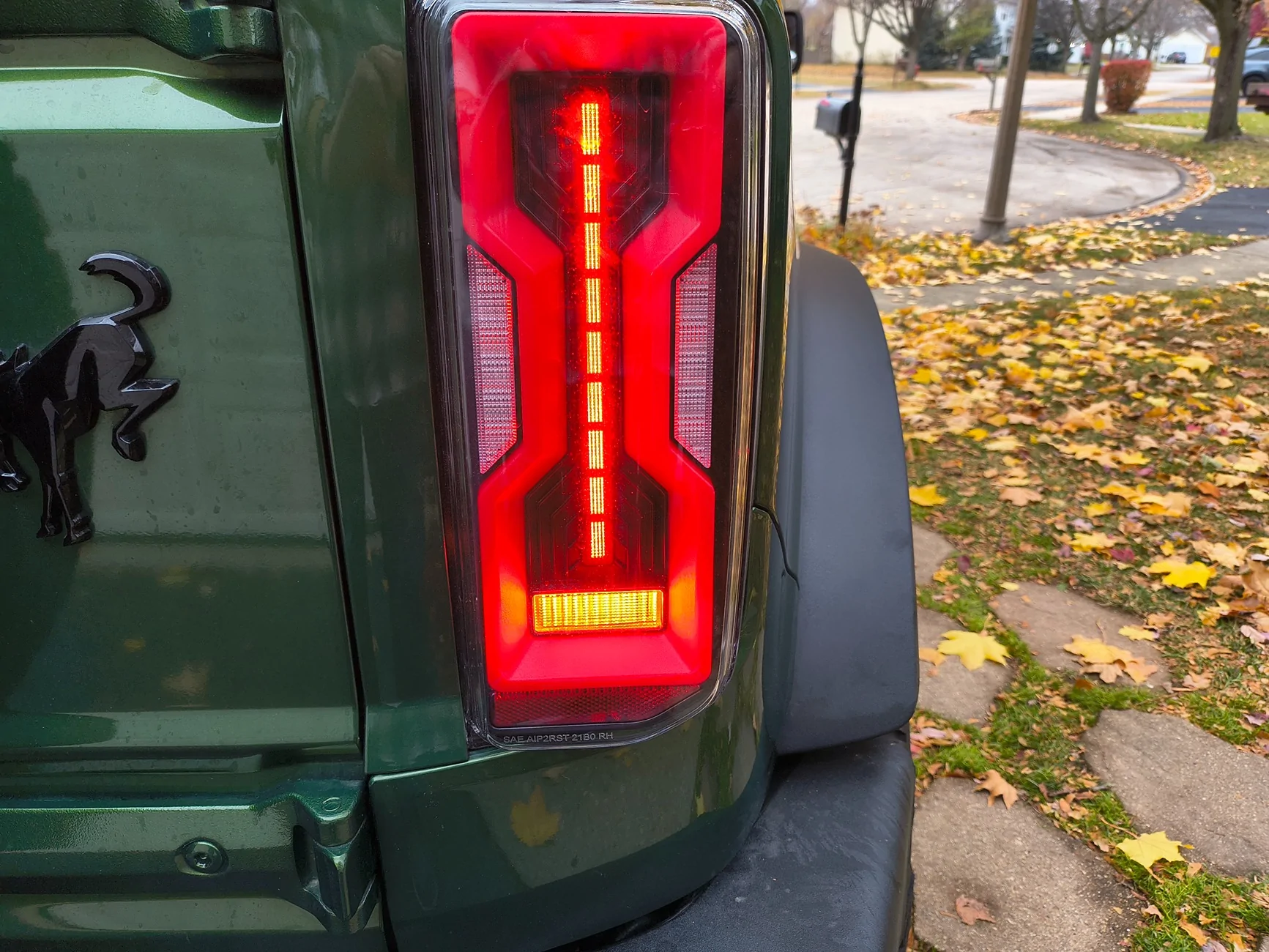

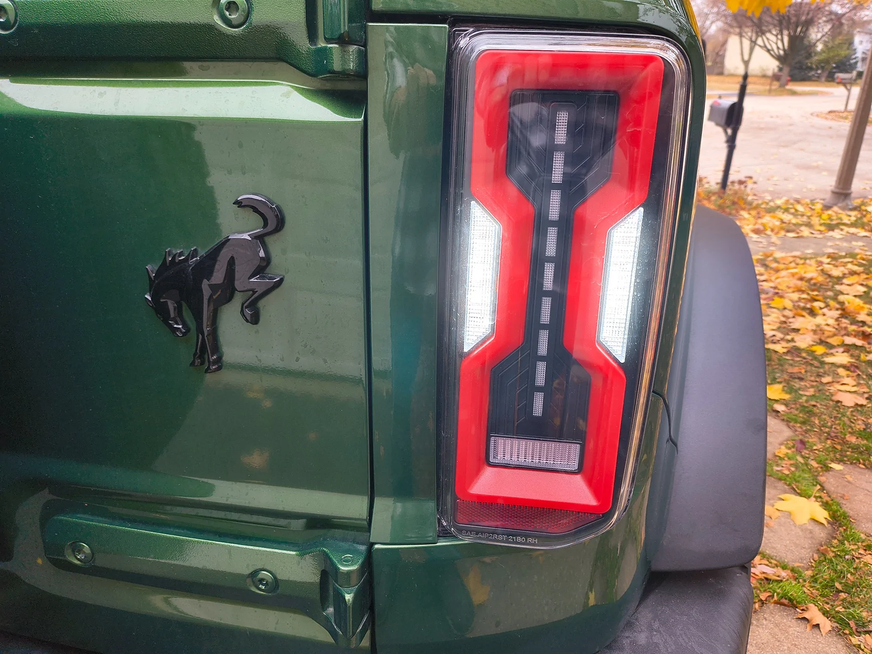

After a set of failed Oracles, I bought one of the cheap $70ish sets that are listed from various Ebay sellers. These reuse the oem halogen bracket for a good fitment, come with resistors mounted on the lights to avoid road spray, have a start up animation sequence, and are quite bright. Plug and play, no forscan needed if yours was originally equipped with halogen tails.
I'll update when or if they eventually fail. But for the price, I can perhaps live with swapping these out yearly if that ends up being the case. 🤣 I'll report back when/if that happens or if they explode in dramatic fashion. 😜
Outer dog bone shaped ring is taillight. Inner vertical and lower block is red for the brake and turn signal. Dual white backups aren't as bright as the Oracles, but better than OEM.
Video of them in action:

Look good!! Keep us updated as to durability.
