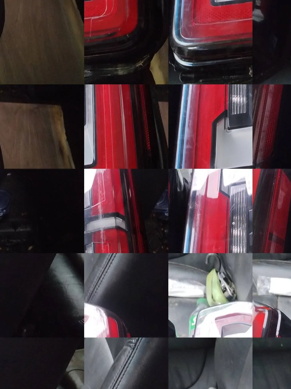

At this point, looks like the OEM LED taillights are the most reliable option. @GusVG do you know if these are the right part numbers?
M2DB13B504BN (Right)
M2DB13B505BN (Left)
I have a set of OEM signature led taillights for sale
Ford Bronco From Halogen to LED - All taillights replacement options IMG_20241209_135107

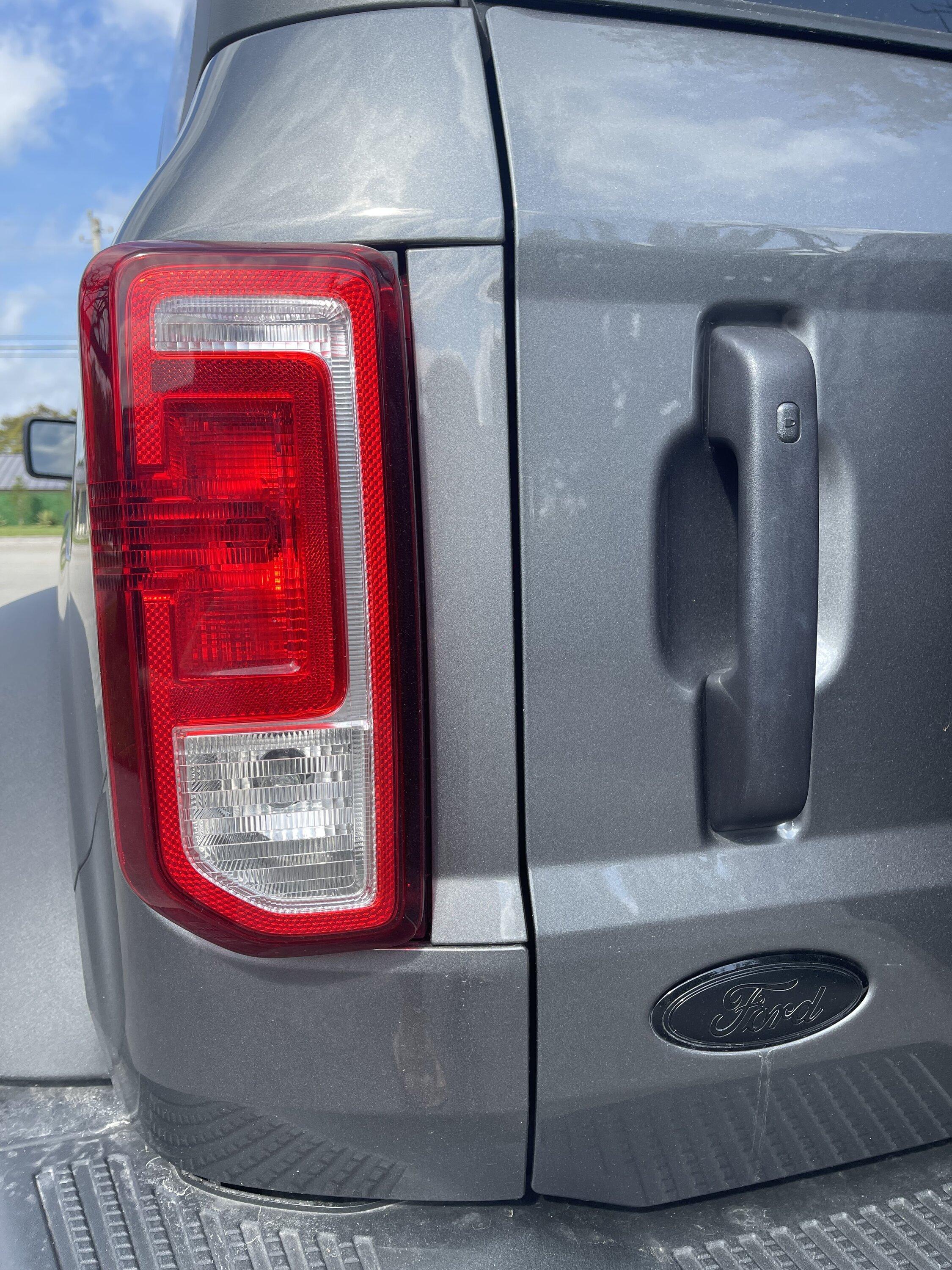

I'm sure this happens to many of us here. We are looking for something specific for our Bronco and we come across other "good" options but not quite what we are looking for. I'm still doing that search but I figured I start a thread with what I have found so far in case that is valuable for someone else in this forum. While I absolutely love my BD for many reasons, I think the OEM LED Taillights is the missing piece. I see many Broncos out there and, especially driving at night, I'm reminded that my car is missing something.

If Ford's OEM LED Taillights would have been compatible, I would have bought them a long time ago. I'm looking to replace my halogens for:
1) OEM LED taillights that look just like factory but from a high quality/known brand or
2) non-OEM LED taillights that would look like a decent replacement, also from a high quality/known brand.
