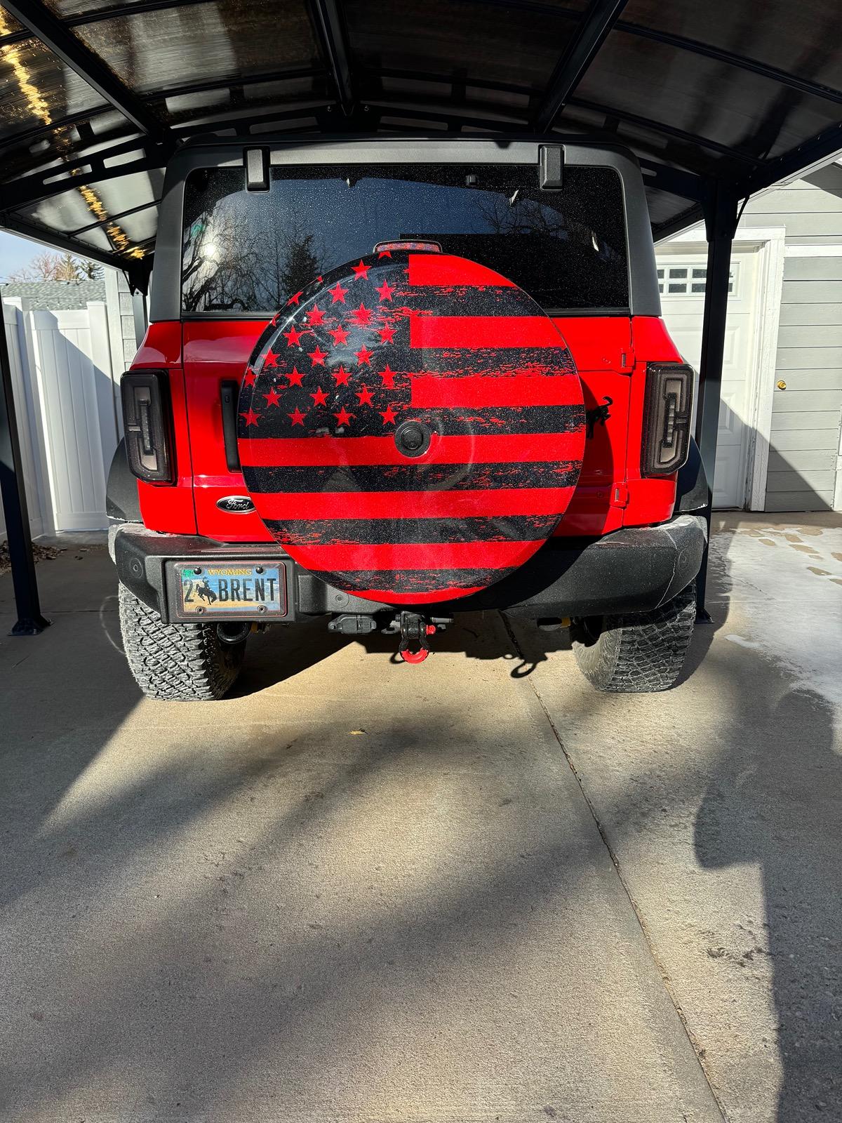

I’ve had the smoked Lumen8’s from buckle up buttercup for a few months. Easy install and no FORscan flash needed. They look good and so far so good. For performance.
Ford Bronco From Halogen to LED - All taillights replacement options IMG_4156
You can either do the normal pulse startup or the chase option (the one I chose) by simply flipping a dip switch.

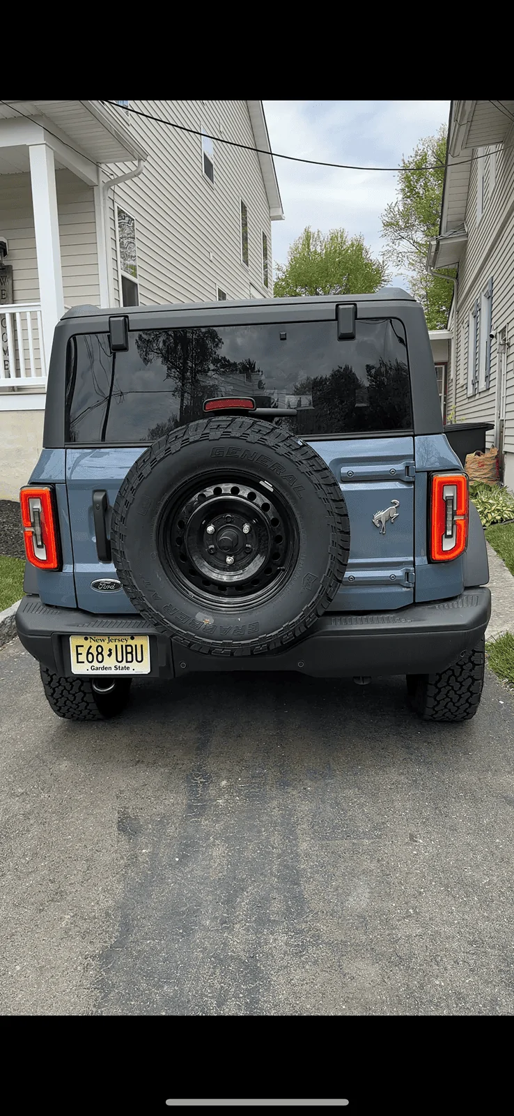

Ok guys I finally took the plunge and installed the OEM takeoff LEDs on my black diamond. I’m happy to report that they appear to work perfectly so far! They’ve only been on for 20 min so will have to test more when it gets dark. I made only ONE forscan change as suggested by GusVG (it was my first time downloading it and using it today).
“Rear bulb turn outage” set from enabled to disabled.
thank you to those in this thread who helped me with this.
Will report back if there are any issues at night time. I did not notice any flicker in real life (but it’s daytime). You can see the flicker on video but I think that’s normal for LEDs.

Sorry should have clarified- the amber does not illuminate, just flashes red, but I was expecting that already as others have mentioned there is some extra connection that the LED models have wired in. Maybe someone savvy with electrical work could get them to work by splicing some wires?
At night they look very good and very bright. I would not call it a flicker but they do "pulse" lightly with the running LED lights at night. I could not tell during the day. It almost looks like a breathing motion type pulse, it does not show up on video at all.
All in all I am very satisfied as they still look way better than the halogens, and the halogens have no amber turn signal anyway. Reverse light is much better as well.

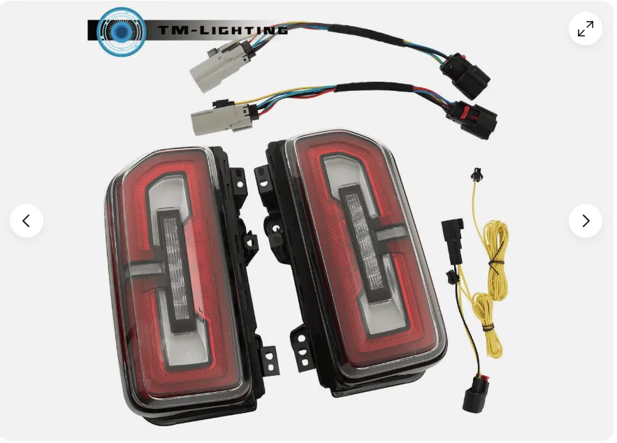

So I just scanned through this thread. Speaking to those who went with OEM, has anyone got this to blink yellow as of yet? About what I could figure is, 1 member had a shop do it for him, the shop won't say how they did it, and I don't see clarification as to whether that set is blinking yellow or not?
What confuses me more is, there are a ton of (Chinese) aftermarket tail lights out there. Quite a few of them blink yellow. The big concern is, are they working all the time? I'd hate to get into an accident because 1 or both of my taillights decided to not function properly that day. But if aftermarket can get it to blink yellow, what is missing from the Ford OEM set that prevents this?
BTW, just doing a quick search on ebay, found a set of aftermarket and they show an extra wire (the yellow one). Could that be the missing link in getting the OEM to work?

The OEM LEDs installed on the halogen models will not blink yellow unless the actually harness was changed as far as I know. I’m 99% sure the guy who had the local shop do it did not get it to blink yellow, just probably disabled the fast blink like the rest of us and the blinker blinks red. It actually looks really good blinking red, I don’t miss the amber at all. The only negatives I see that going OEM has is you have to go in forscan (mild inconvenience) and the mild flicker it has on the running light (not very noticeable except up close at night)
the yellow wire comes with all aftermarket LEDs that look OEM style. For whatever reason it has to be connected to the 3rd brake light or the yellow lights will illuminate with the brakes
