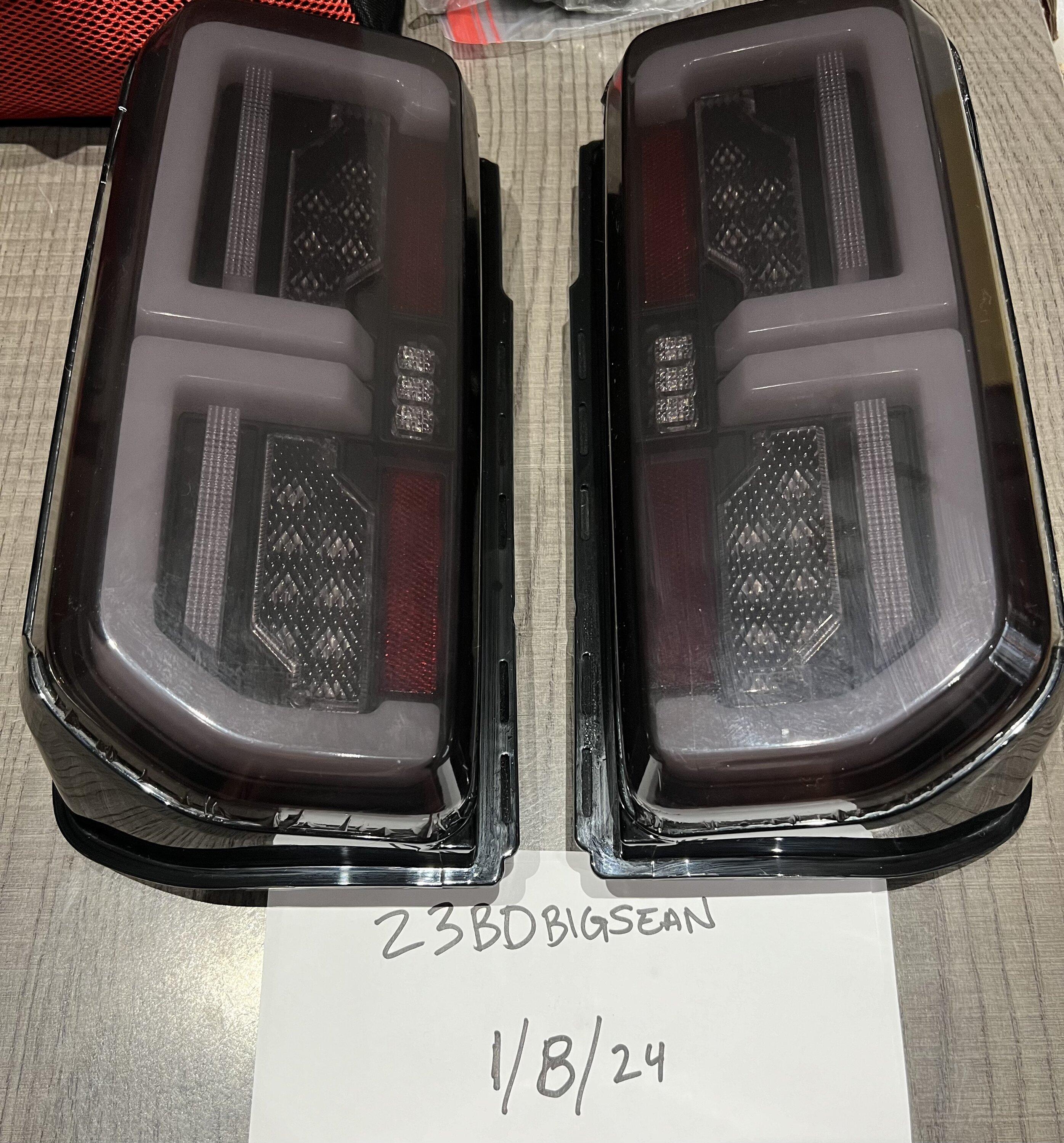

I got these and had them wrapped in black tint, just didn’t like the way they looked on my black Diamond. I also had a wildtrak grille and swapped that for a badlands grille cuz the gloss black doesn’t pop the way I like against the Cactus Grey
Ford Bronco From Halogen to LED - All taillights replacement options IMG_7947
aftermarket taillights still for sale!!😂😂

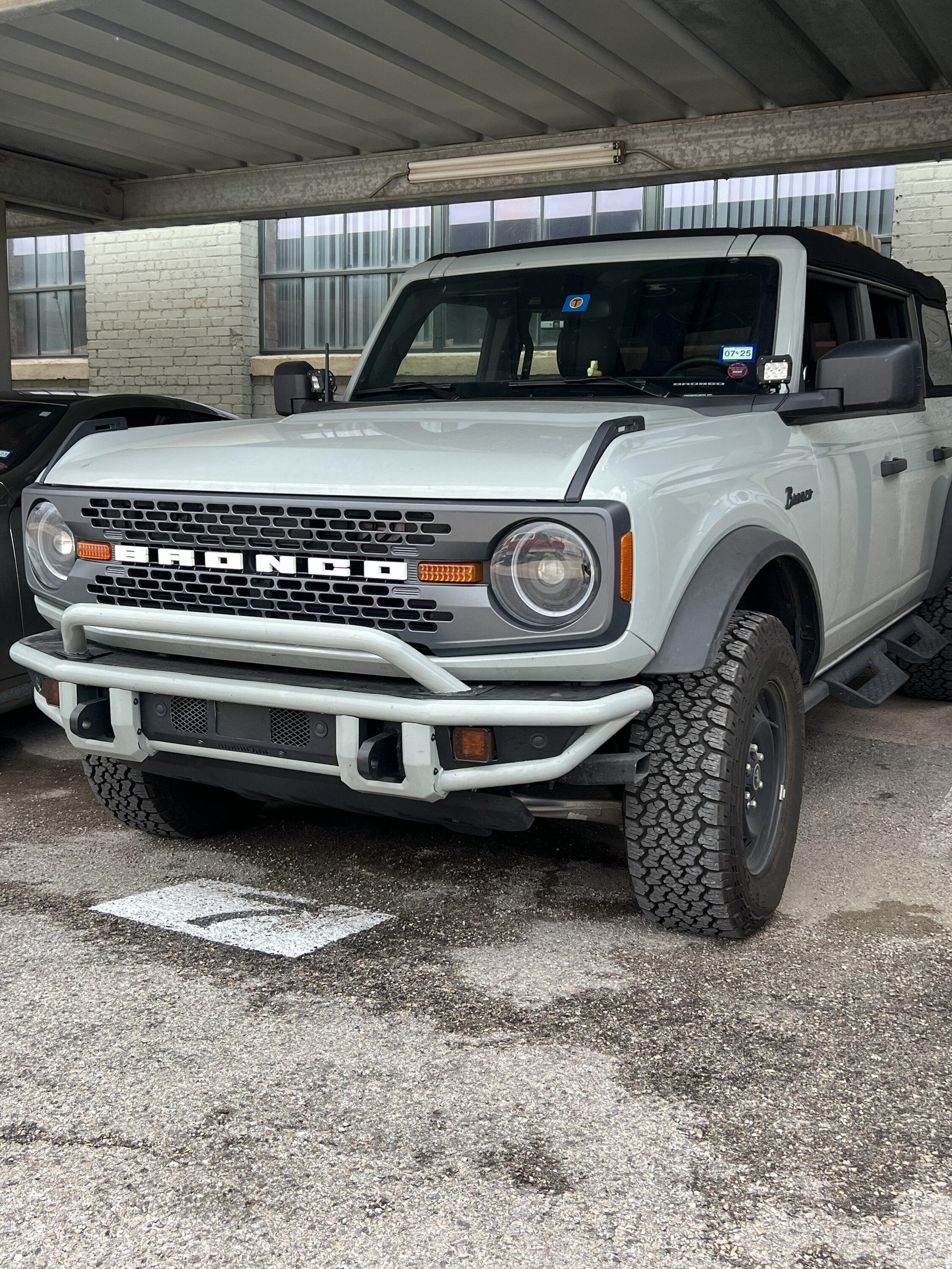

Interesting bumper you have there Big Sean what brand are your front and rear bumpers got any other pics with front bumper also
Thanks,
Jerry
23BDBigSean
Sean
Oct 2, 2023
262
333
Atlanta, GA
2023 Bronco
@Packen8 Barricade HD tubular front and rear bumper. Had a paint shop custom paint match the tubes.

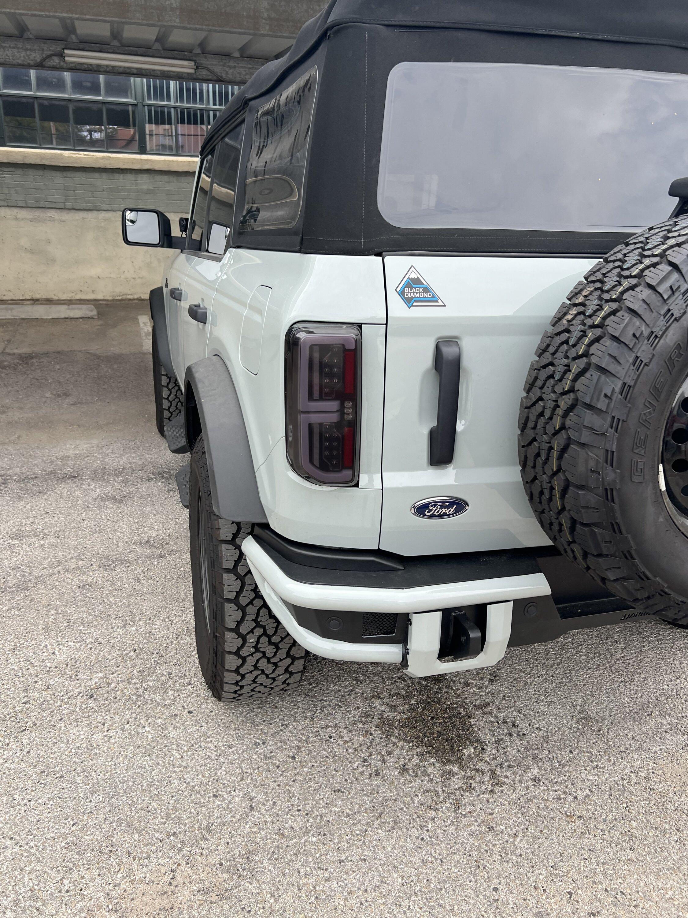

Thanks for the info ….I like what you did with the tubes looks great I really like your choice of bumpers l’m going to be getting new bumpers this spring … thing is I ordered my Bronco with modular bumpers but it was delivered with the plastic bumpers bummed me out ….. thanks again
