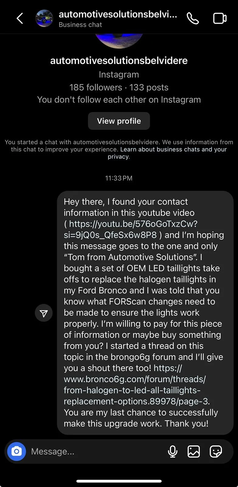

I had the wrong store. The store is located in Belvedere. Just sent him a message via instagram. Fingers crossed

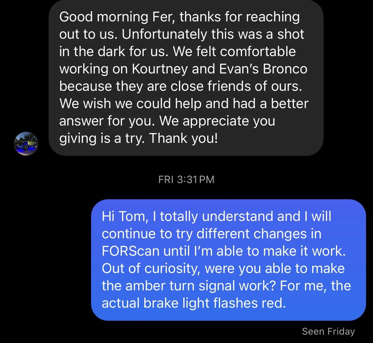

I got an answer from Tom but not what I expected. Looks like he doesn’t feel comfortable sharing the forscan changes he did.
Ford Bronco From Halogen to LED - All taillights replacement options IMG_2757
Waiting to hear if at least he was able to make the amber turn signal work.

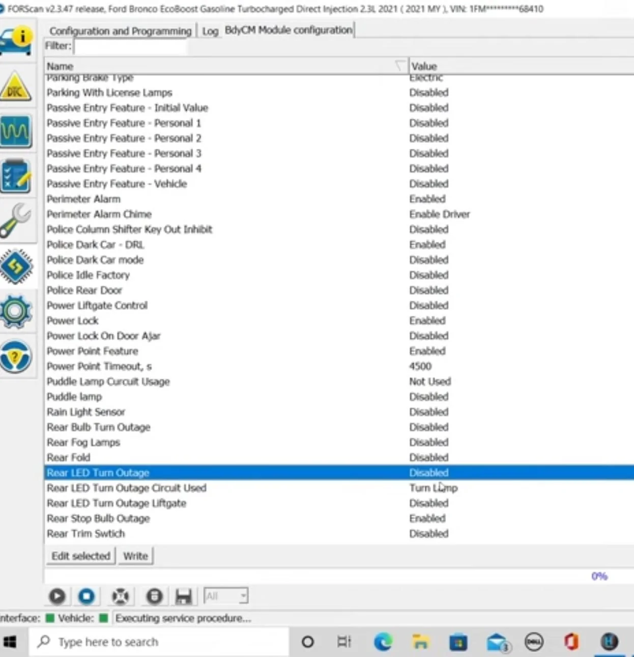

Unless @EvanPeterson can convince him of sharing what he did, looks like I will have to go with your set up. Any chance you can share a screenshot of what your BCM settings look like now? There a several LED lights settings (image below is from the Oracle install video)
