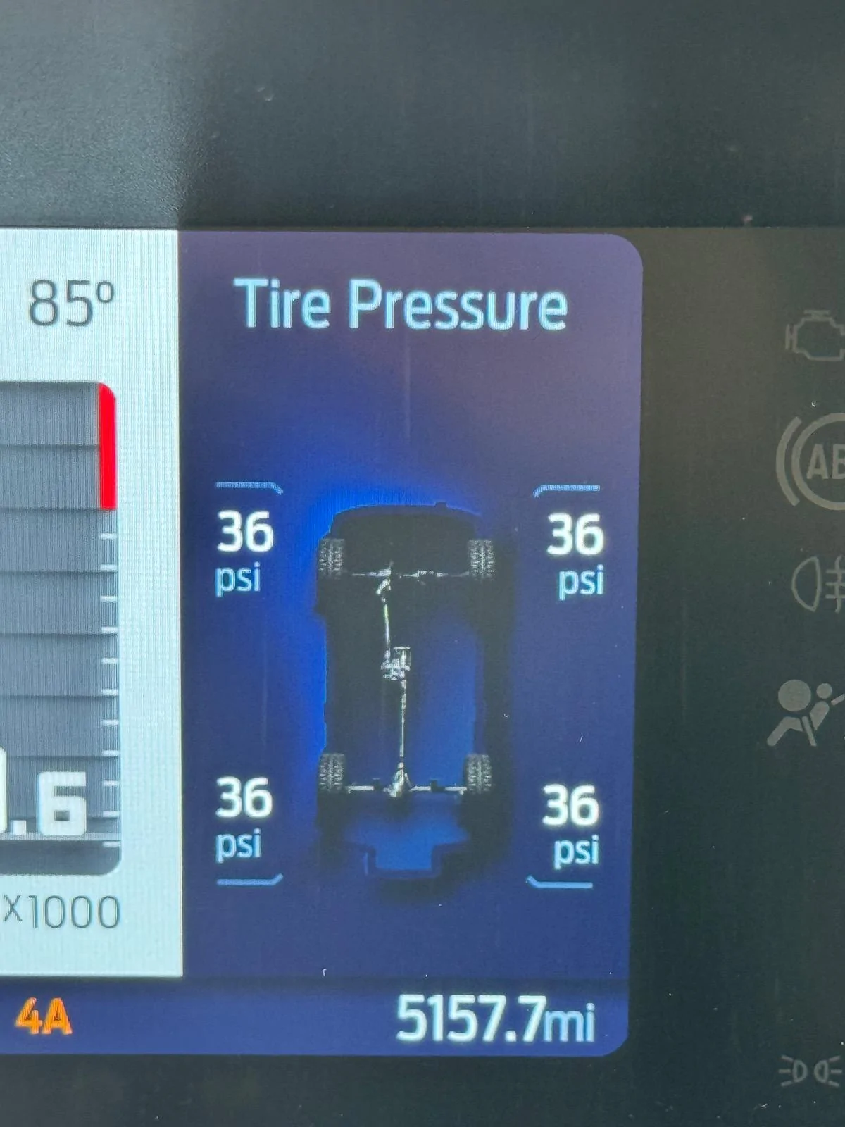

I just brought my 23 wildtrack in for its first oil change tire rotation at a local Ford dealer. I asked them to do a 5 tire rotation and the service advisor stated that the spare does not have a tpms sensor and it would throw a light if they rotated it in. Is it true the spare does not come with a tpms sensor from the factory?
Hey Potter, your dealer does not know what he is talking about. My dealer has now done two 5 tire rotations with no issues. Either he does not want to do it, or he knows nothing about the tpms systems on the Bronco.
Potter
Jan 2, 2024
50
Raptor and Bronco
Ford Bronco Does spare tire have TPMS sensor? IMG_0740
Just rotated the spare in on the right rear. It took 5-10 minutes for the bronco to pick up the TPMS, but it worked fine without having to reset. Thanks for the feedback everyone.
