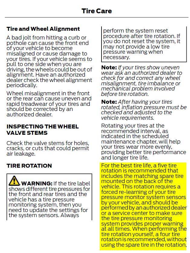

Just dropped my 2023 Badlands off for service (dealership), having them change oil and rotate tires also. Asked for 5 tire rotation and told no because the spare does not contain TPMS.
Is this true and, if so, what's involved with taking the sensor from one of the tires and installing on the spare?
TY.
Edit: Thanks to everyone for the replies. I informed the dealership, got the 5 tire rotation done, spare tire sensor works fine. On a related note: my passenger side roof panel was hard to remove and I was told this is not adjustable. It is. Had to inform the dealer how to do it.

Yes it does. The service advisor probably told you "durrrr the pressure don't show on the screen because there is no tpms". Drive it a few miles and it wakes up the tpms.

Yes, it’s in the spare tire and you no longer have to use the crazy calibration tool like on the early TPMS sensors from 2008. After a few miles of rotating it displays properly.

All 5 tires have a sensor. If you rotate them you justhave to drive a few miles and the vehicle will pick it up.

What is the "forced re-learning" the dealer does?... Drive it around for a few miles?
Forced learning is not required. Not sure why it's still in the owner's manual
