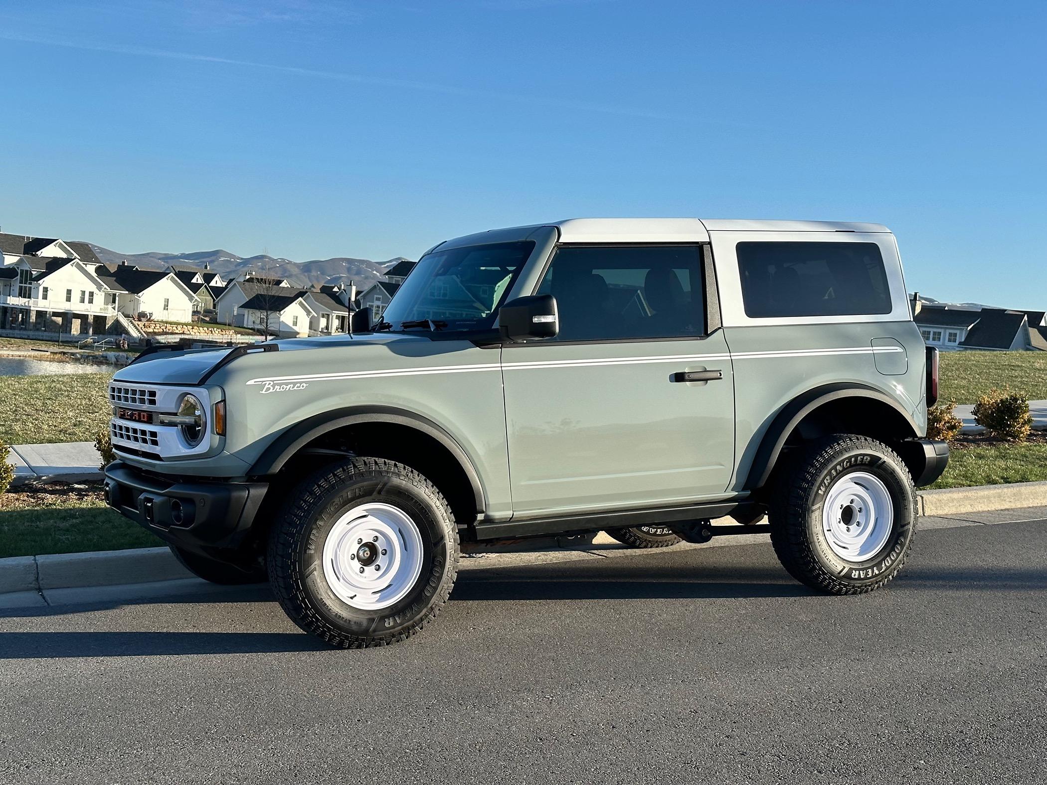

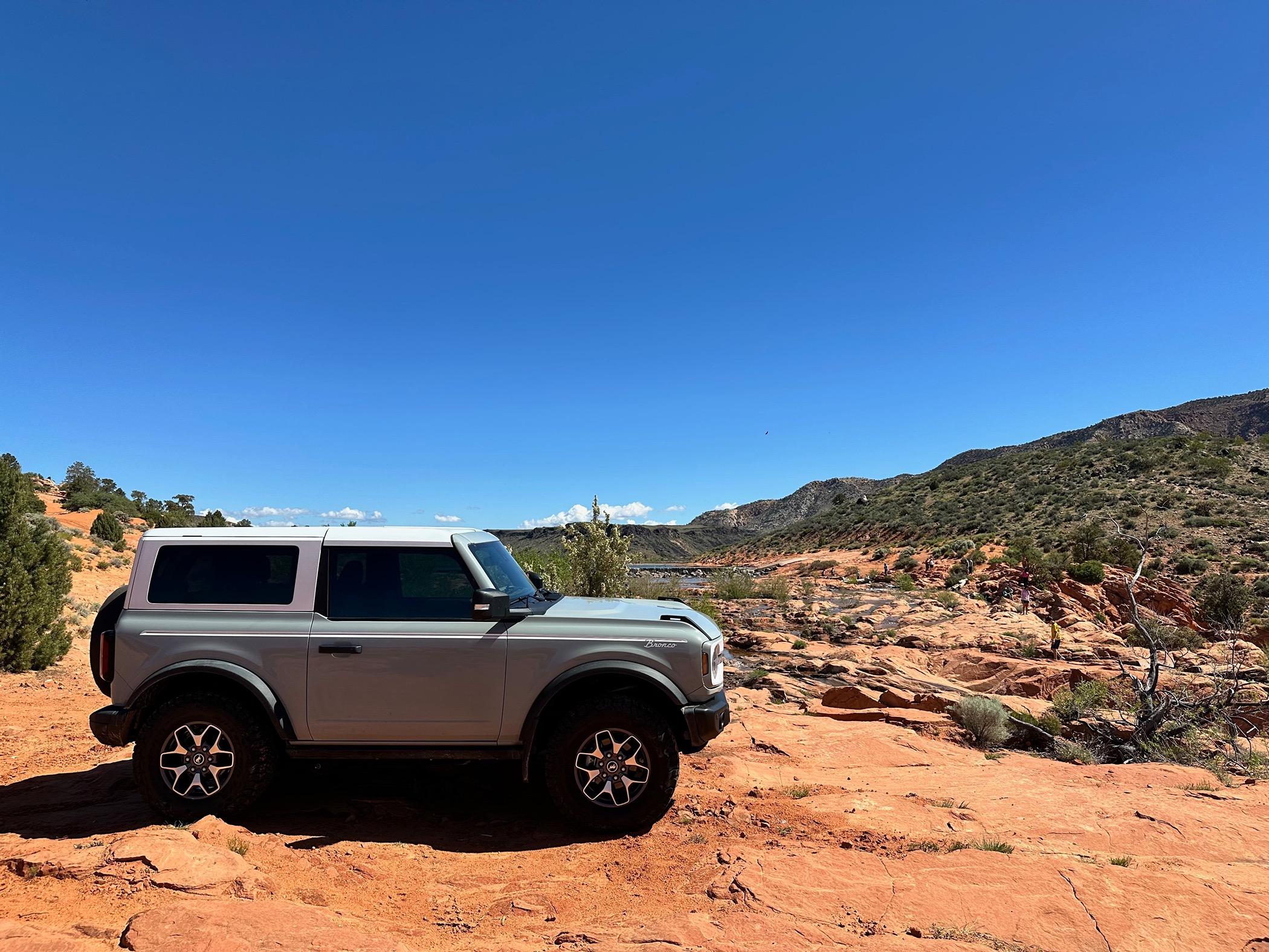

I just brought my 23 wildtrack in for its first oil change tire rotation at a local Ford dealer. I asked them to do a 5 tire rotation and the service advisor stated that the spare does not have a TPMS sensor and it would throw a light if they rotated it in. Is it true the spare does not come with a TPMS sensor from the factory?
OMG, that service advisor is uninformed. Not only does the 5th tire have TPMS, but your Bronco will automatically recognize when you rotate it in. Trust me, I've changed my tires at least a dozen times in the past year. Not only will the Bronco recognize the spare rotated in, but it will also recognize the TPMS sensors on a complete second set. I run these as my street tires:
Ford Bronco Does spare tire have TPMS sensor? tempImagercgII
And regularly swap in my OEMs for off-roading. I've never even given the TPMS sensors a second thought. They just work.
