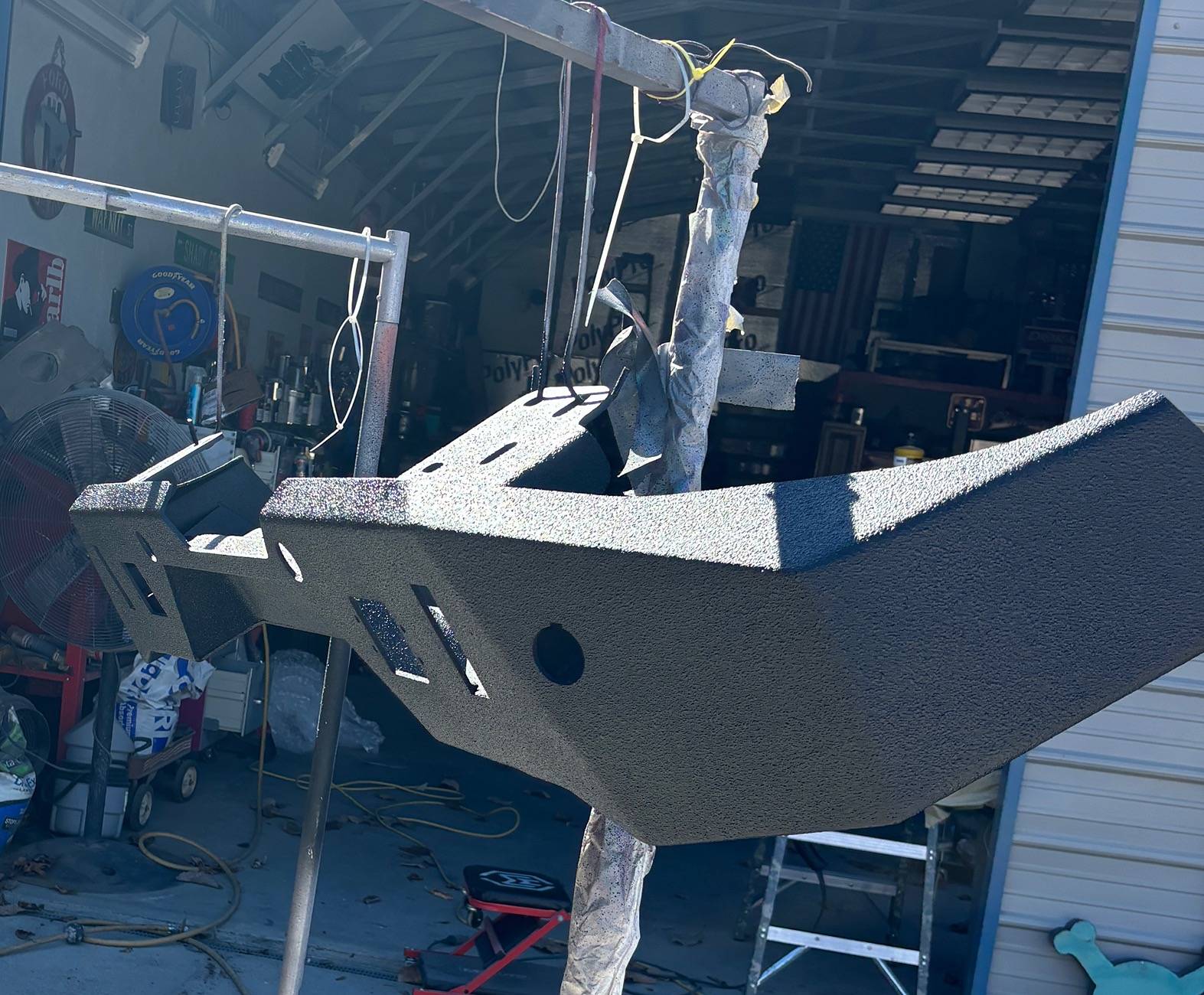

broadicustomworks
Aug 25, 2020
42
4,107
16,681
Hanging Rock, North Carolina
Agree 100% with @Brian_B and @Snacktime , Frame-mounted rear bumper with swing-out eliminates all the weight from the body.
We have our rear bumper system 50% in stock. Reg. $2600 with the swing arm is $1300. Why stock lasts.
Of course the bumper system is real armor for the back of your 6G. Can see us working it hard, running the Rubicon, Its also nice to carry 11 gallons of extra fuel too!
Yep, this is the one I am currently getting prepped for install. It's beefy and looks like it can take some abuse, should the event ever require it.
But I’m also making it look good while doing so…
