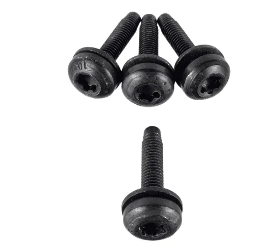

W721070-S450B (M8X33) is for the cap to quarter and the two brackets, 12 total.

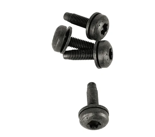

W721071-S450B (M8X24) is for the two brackets on the top of the cap that bolt to the roll bar.
so I should get these ones? W721070-S450B (M8X33) is for the cap to quarter and the two brackets, 12 total.

Front brackets should be there already. At this point it's just a choice of which of the above two bolts you wanted to use on the rear cap.
I didnt get the hardtop prep kit. So i dont have the hardtop brackets yet

Sorry, misread. The shorter bolts should work in all locations as the longer seem like overkill.
