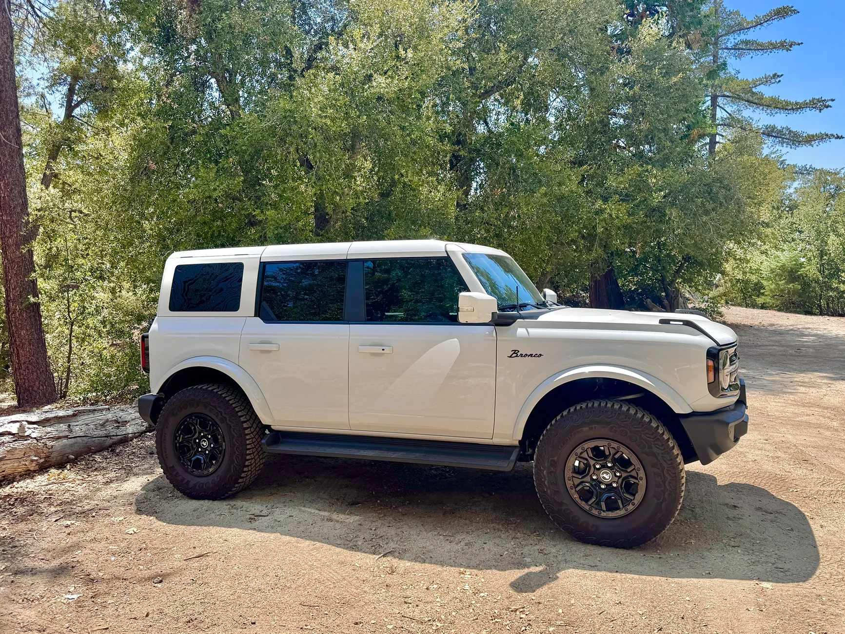

I asked for a Starlink mini for my birthday coming up and I'm trying to figure out the setup that will work best when I've got my hard top on half the year. I see a lot of posts about how it works through the MIC hard top, but I've got the painted hard top, and I don't seem to see any threads on that (maybe I'm missing it?).
Does anyone have a painted top and Starlink? How are you installing it? Any tips would be great. :)
Pic of her in her summer top for attention (I use the soft top in Winter here in San Diego).

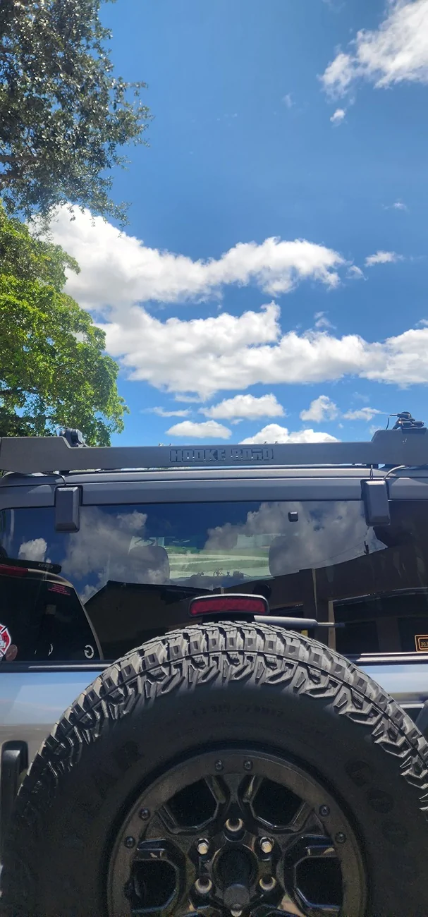

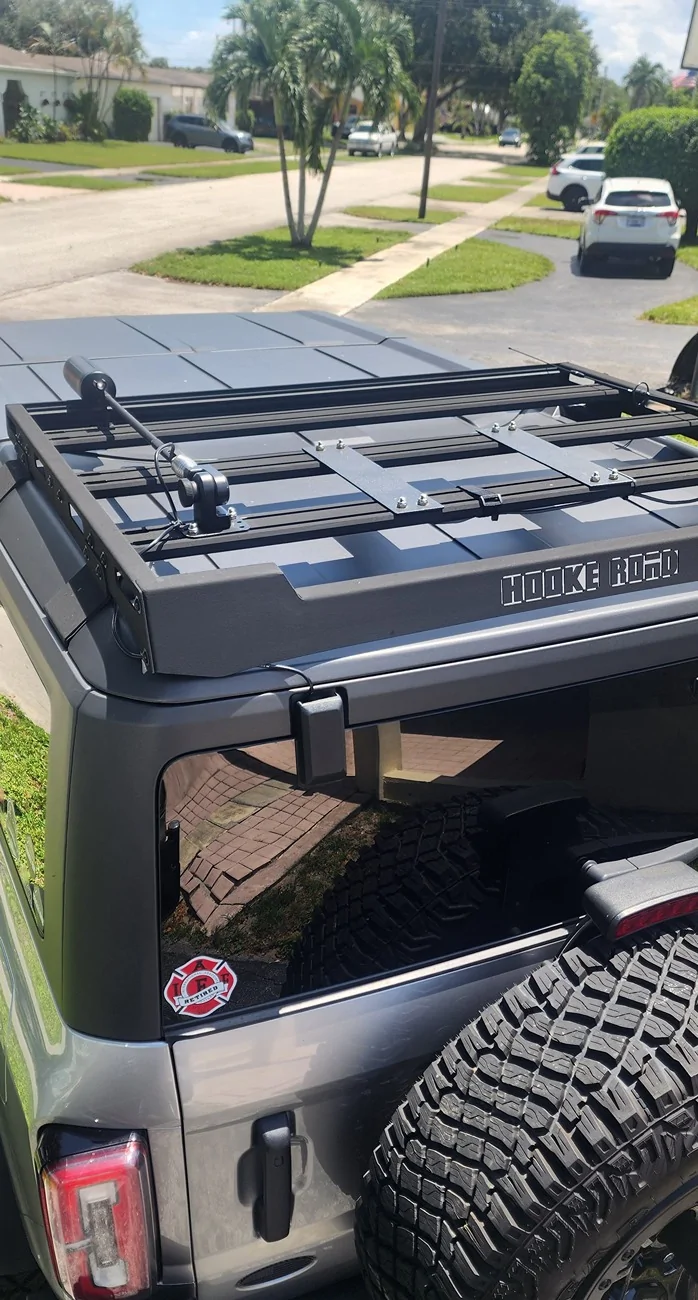

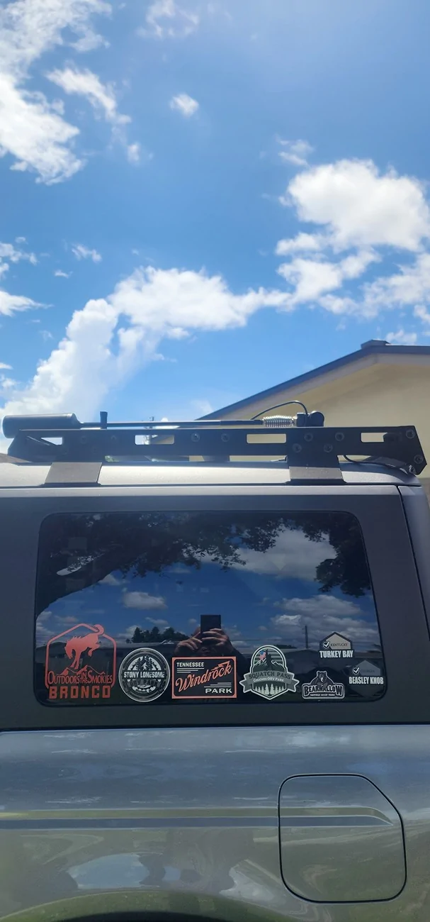

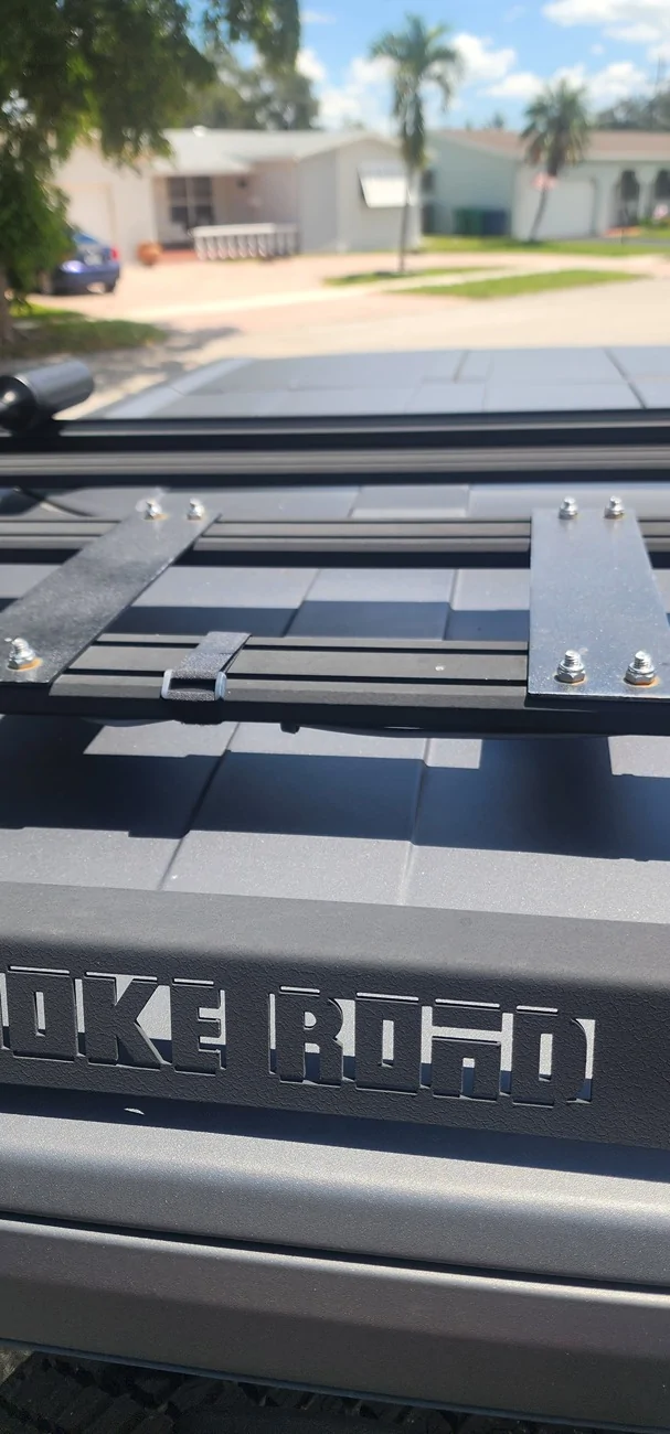

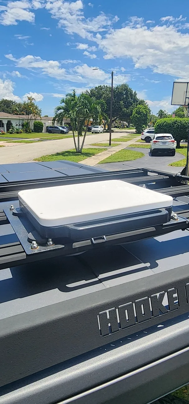

I have the hardtop but not painted. I bought the Hooke Road Half rack which fits perfectly for the Bronco as it attaches to the sides of the roof. I attached to metal flat bars painted because the roof rack is aluminum. My starlink sticks to the flatbars using the 4 magnets. I've been offroading and highway speeds and the magnets are definitely very strong. I hard wired the starlink cable to one of my aux switches coming from the cargo area.
Nice! Sadly, I don't have aux switches. May add them later (but then where will I put my sunglasses?! lol /s). Also switch back and forth between soft and hard top, so I haven't done too much looking into racks bc it seems like it would be a PIA when switching.
I've heard the magnets are pretty good though. I don't think I'll need it while driving, so I can probably be a little less anal about placement than I am. The half rack looks nice.
