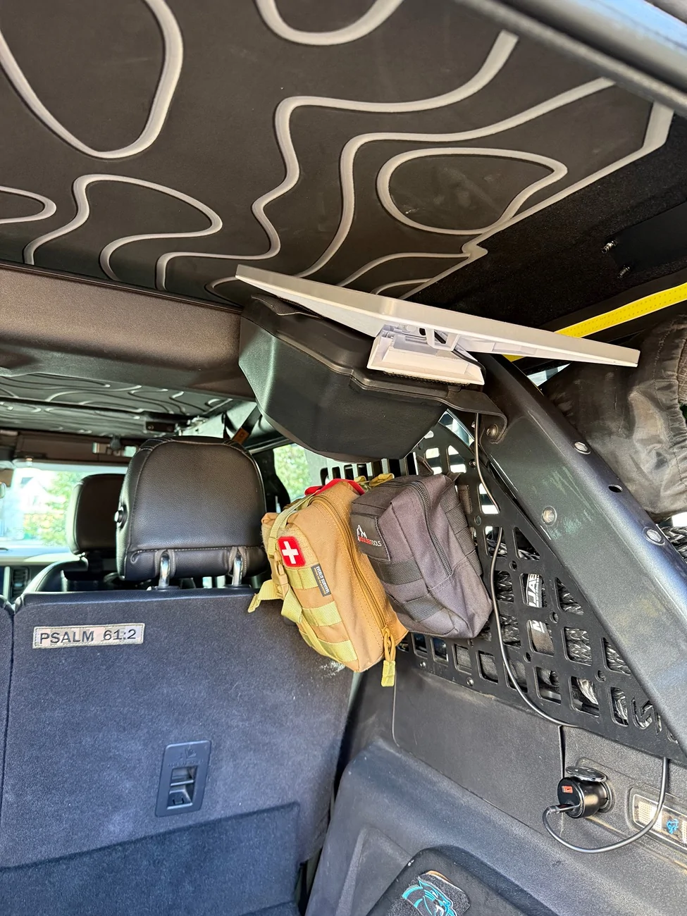

The Mount cost more than the dish, I'm glad my DIY works so well.
I won’t knock a DIY effort - I’ll just say the Revolink is the molle shelf and the bracket that mounts on top of the shelf. So kind of a twoferone deal. I’m all for DIY stuff, but in my case I was looking at rear shelves anyway

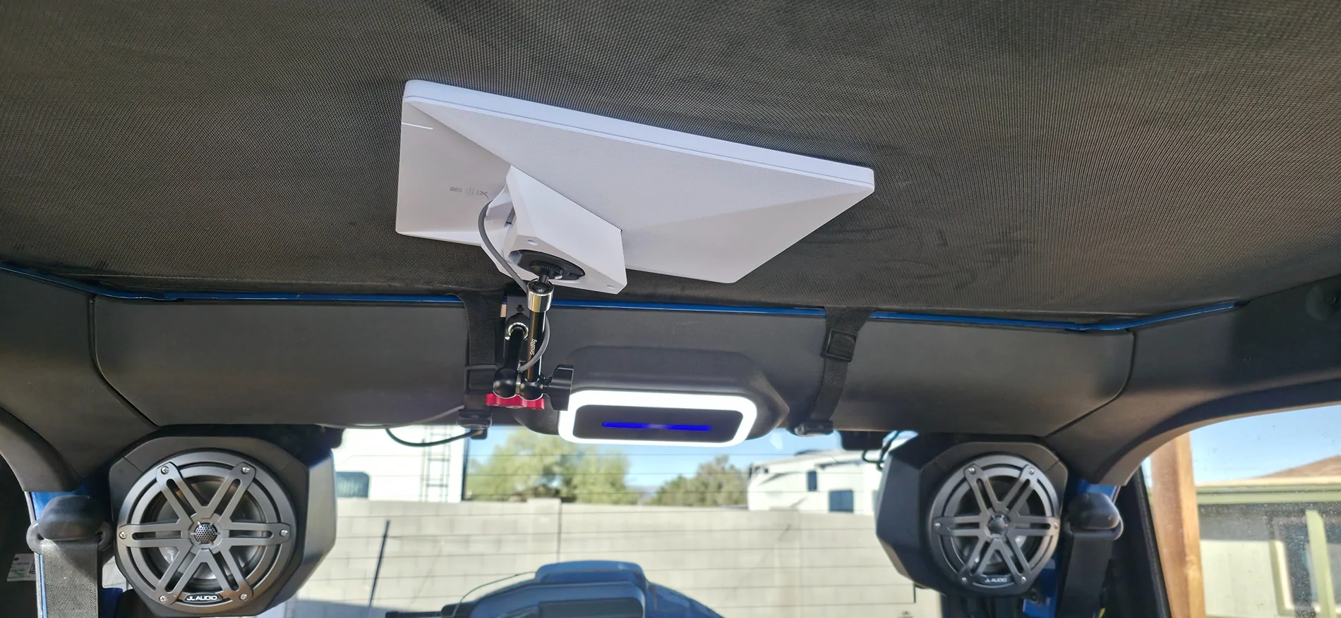

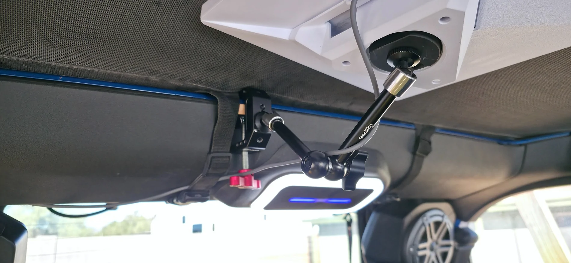

I was able to get this to work in the 2 door. The Starlink also works through Jtops mesh as well.
I got the same thing and struggled to get it to hold up as well. I see you have a spacer in the clamp, I think I need to look at doing the same.

I could not get it tight enough without the spacer. I used a piece of wood but I'm going to have my buddy 3d print something better. This feels really solid so far.
the 4dr I did not need a spacer, has not moved yet

The problem I was running into was the red handle started hitting the plastic on the pillar before I could get it tight enough. The 2 door has a smaller flat area to work with.
Yep. I had the same issue and it let the arm sway. If you come up with something, pass along please.
