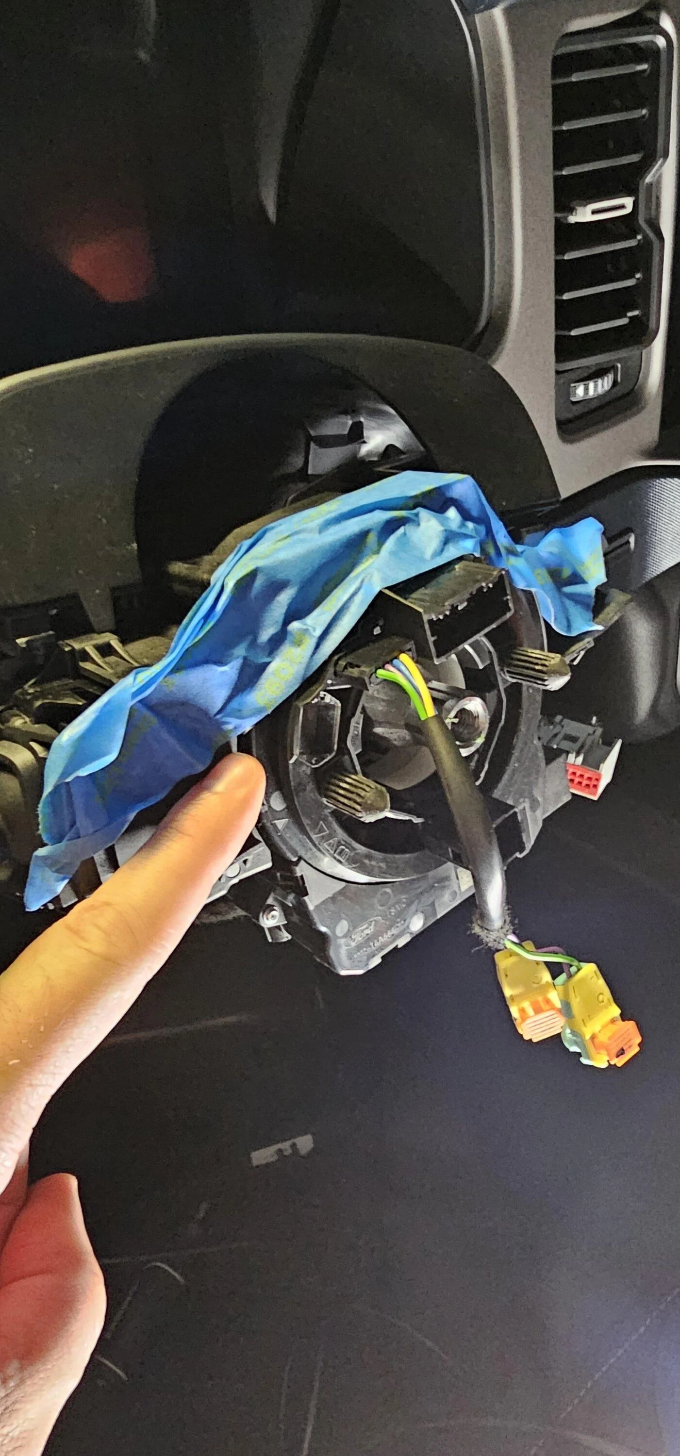

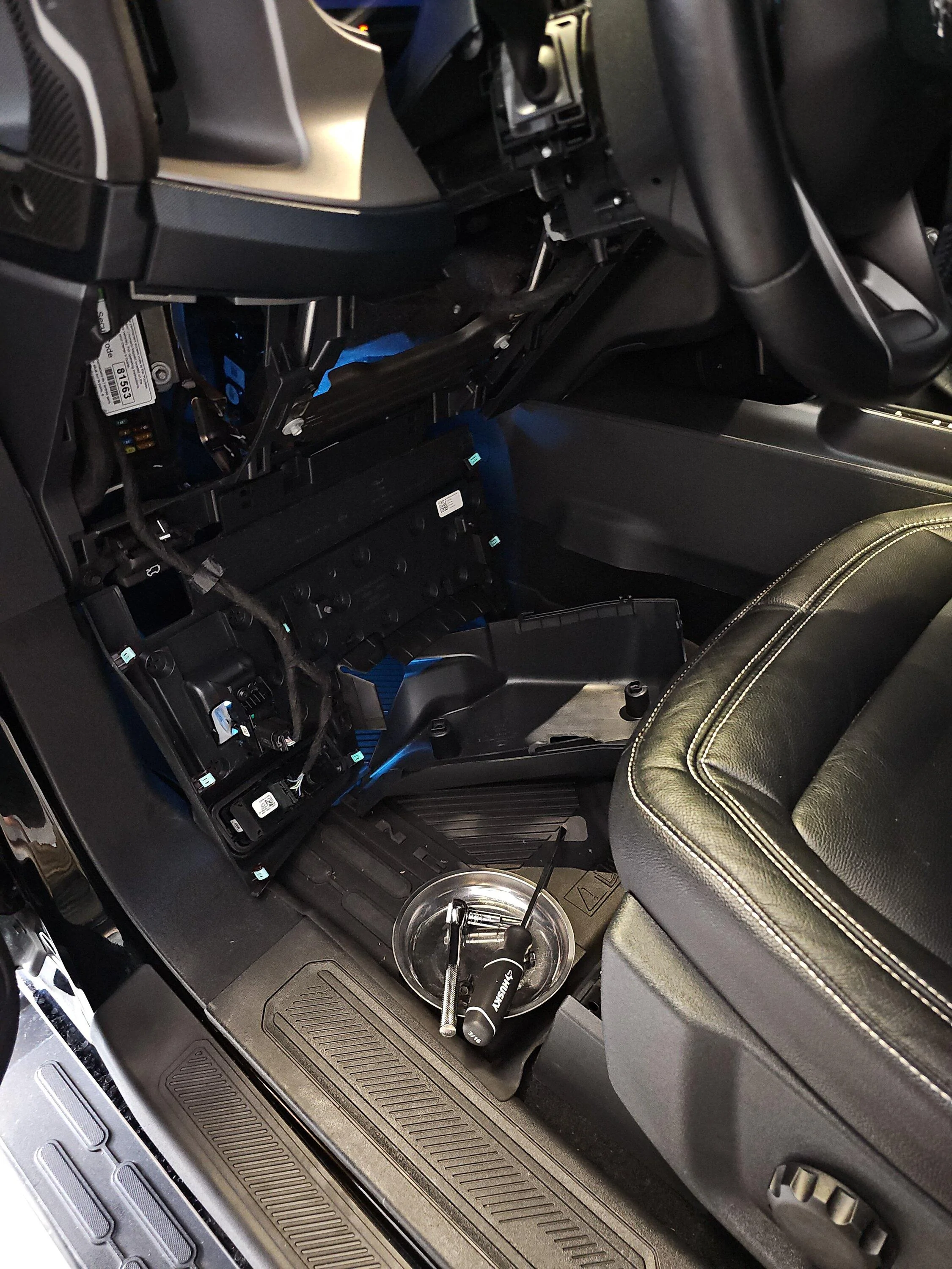

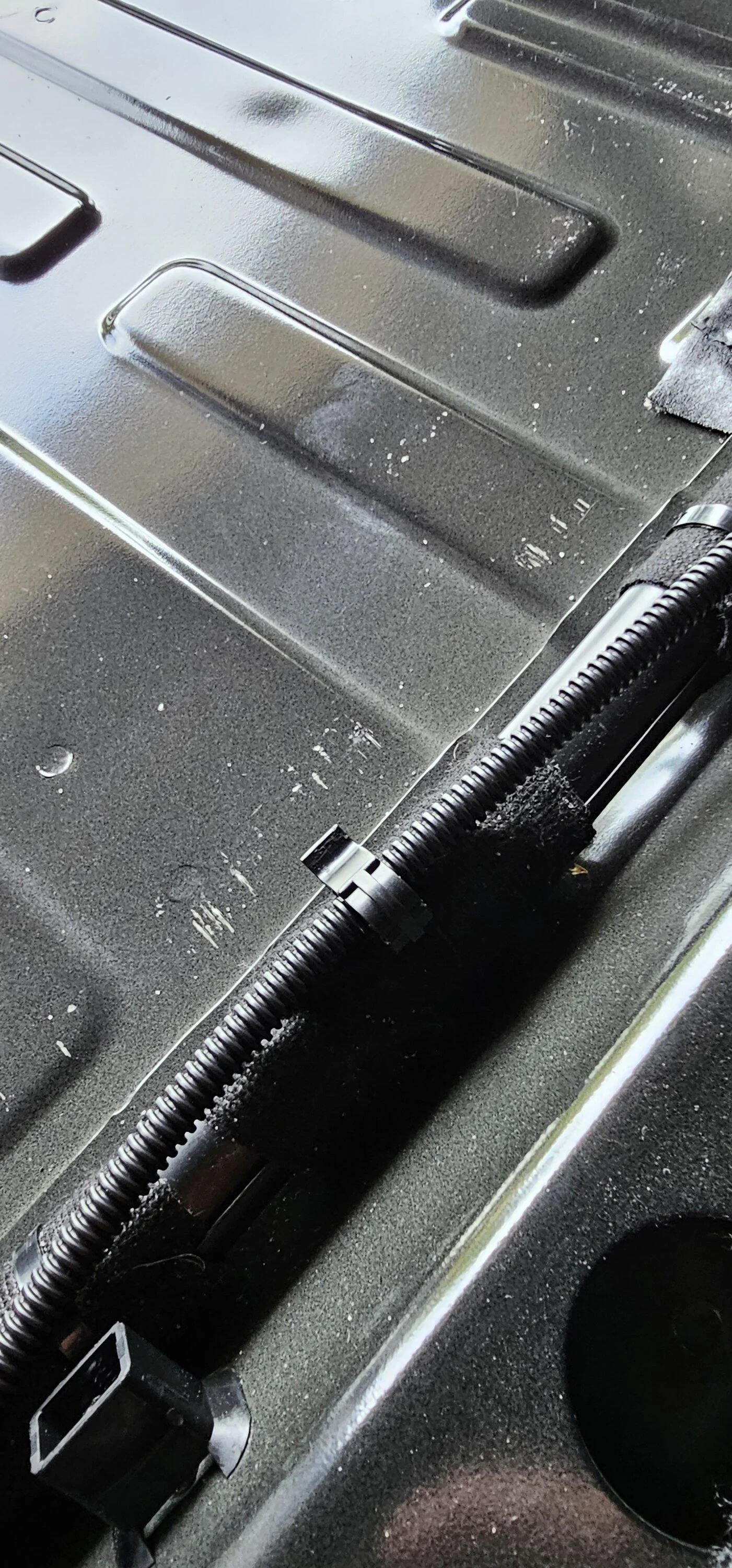

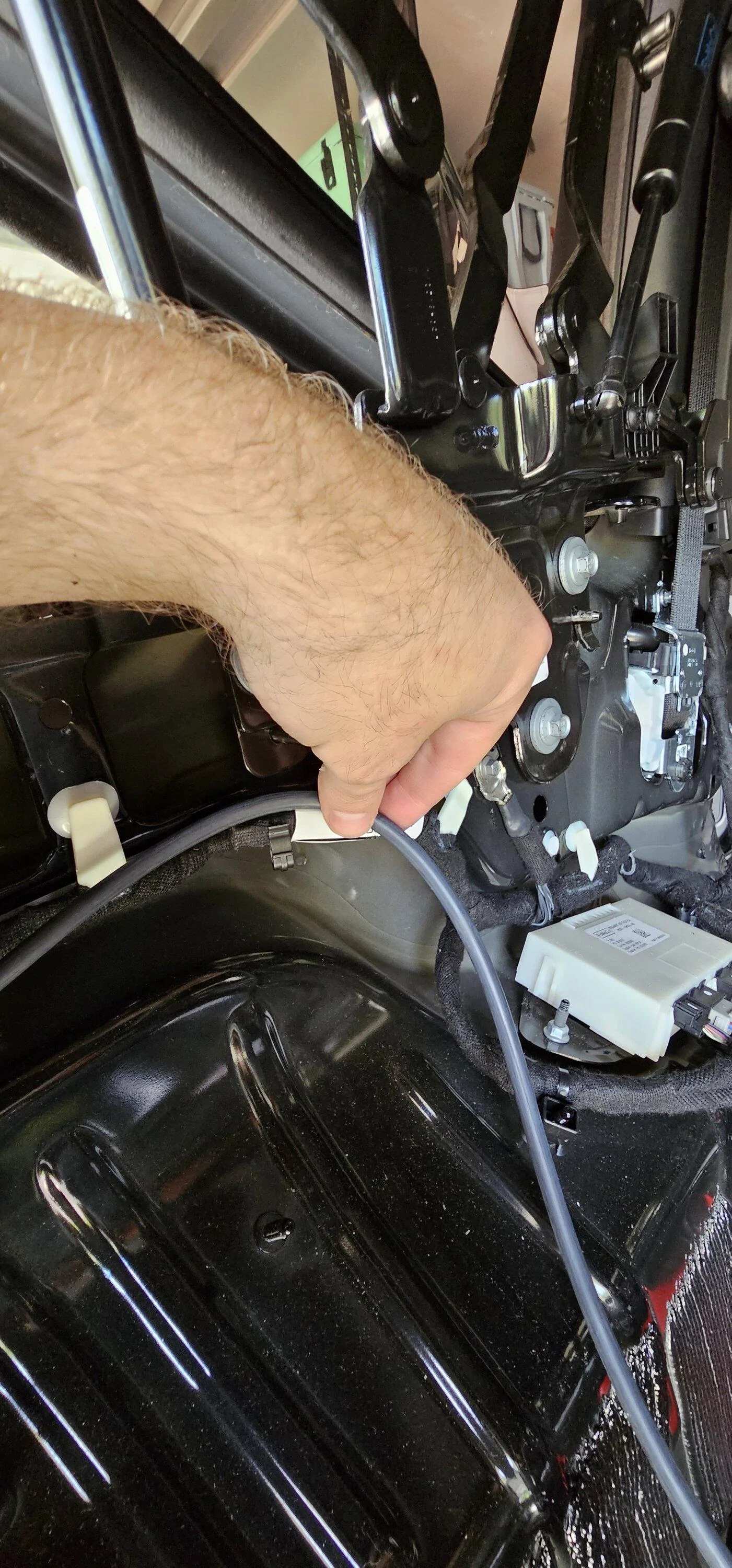

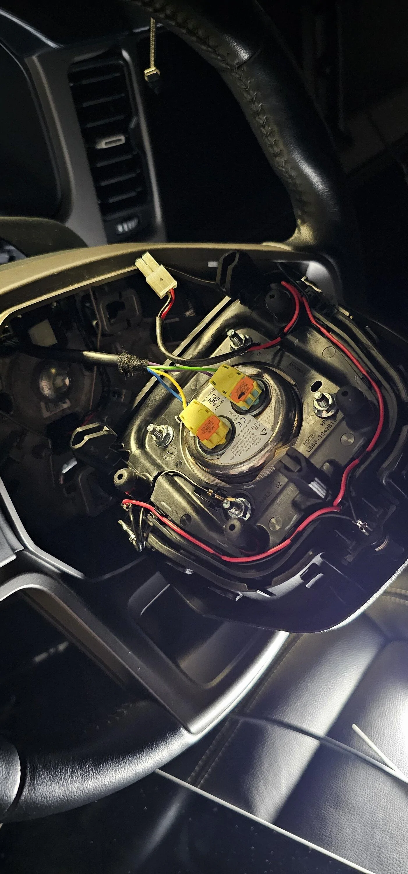

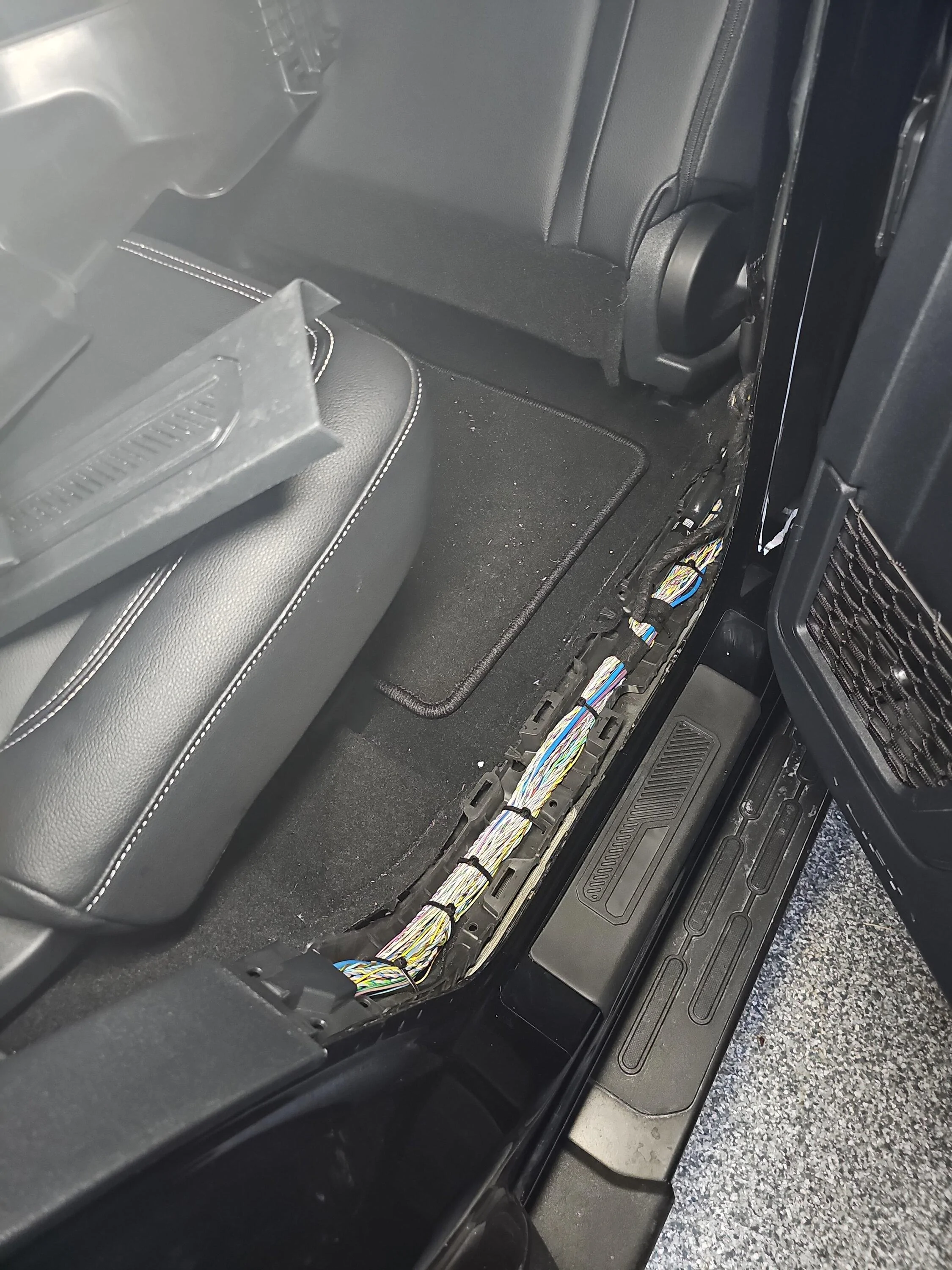

Also own an early editon, non-prep kit Bronco. Parts are on order from @MangoldFordParts to knock this out. Once I dive into this, I will try to document with pictures the routing and installation of the wiper hoses, electrical hook ups, and replacing the windshield wiper controls. Whether everything works after that will be TBD.

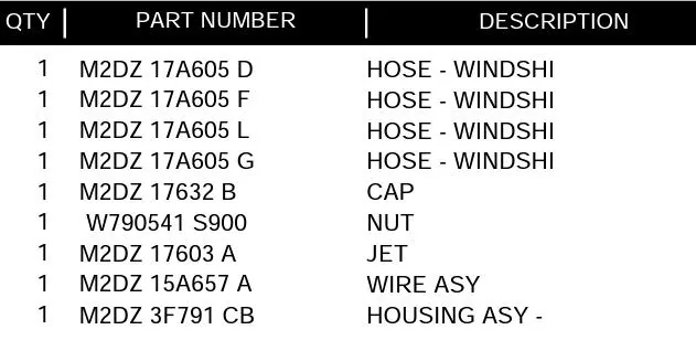

Here's the parts list put together by Bradley @MangoldFordParts that should make this functional.
Forscan, etc TBD

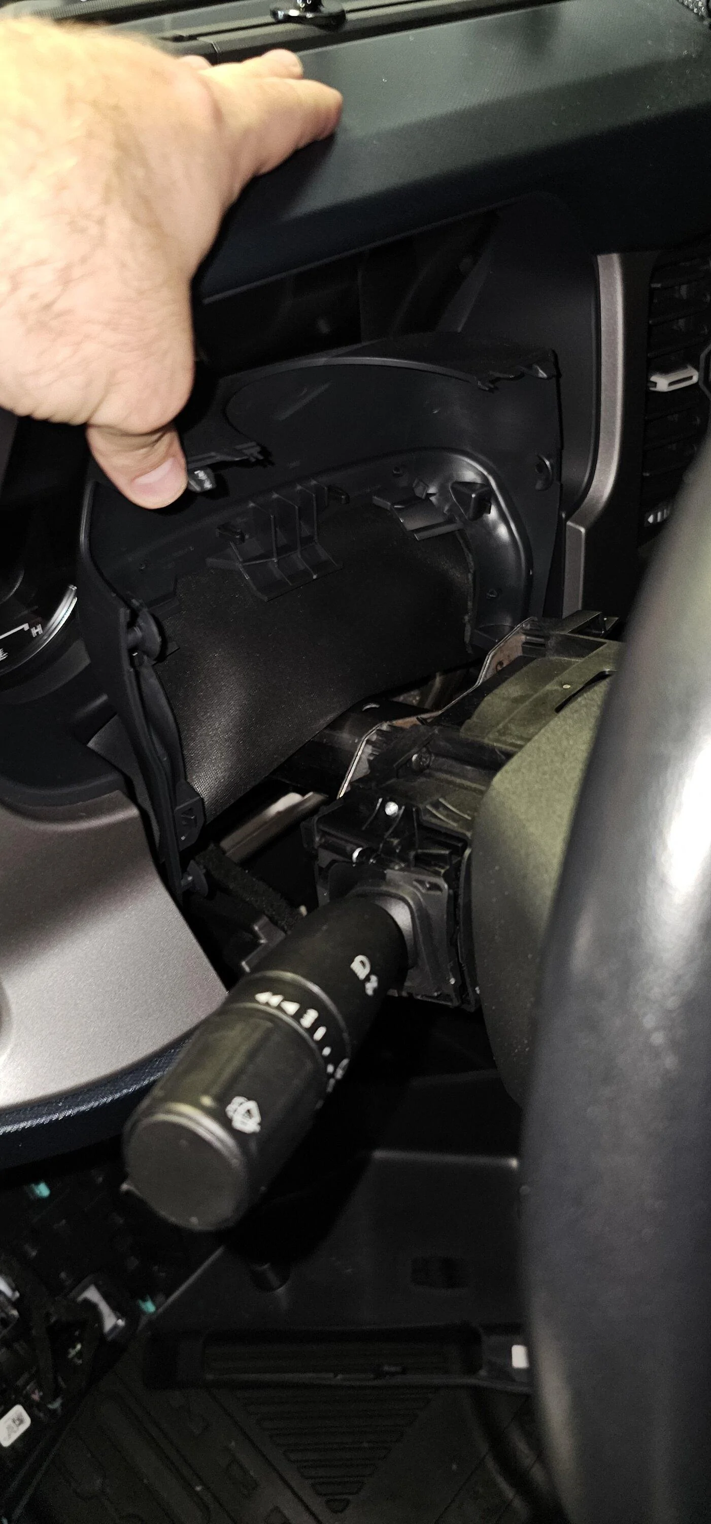

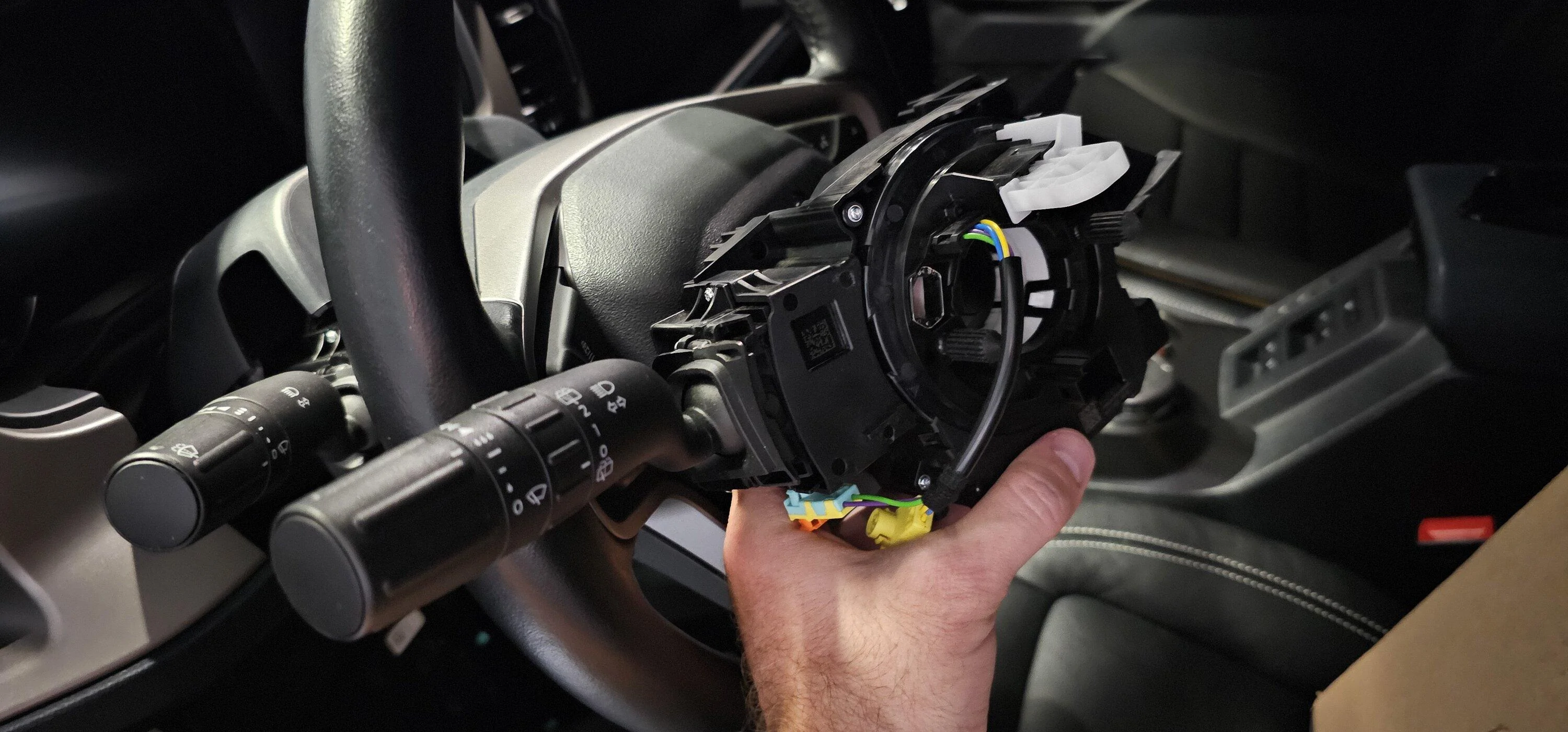

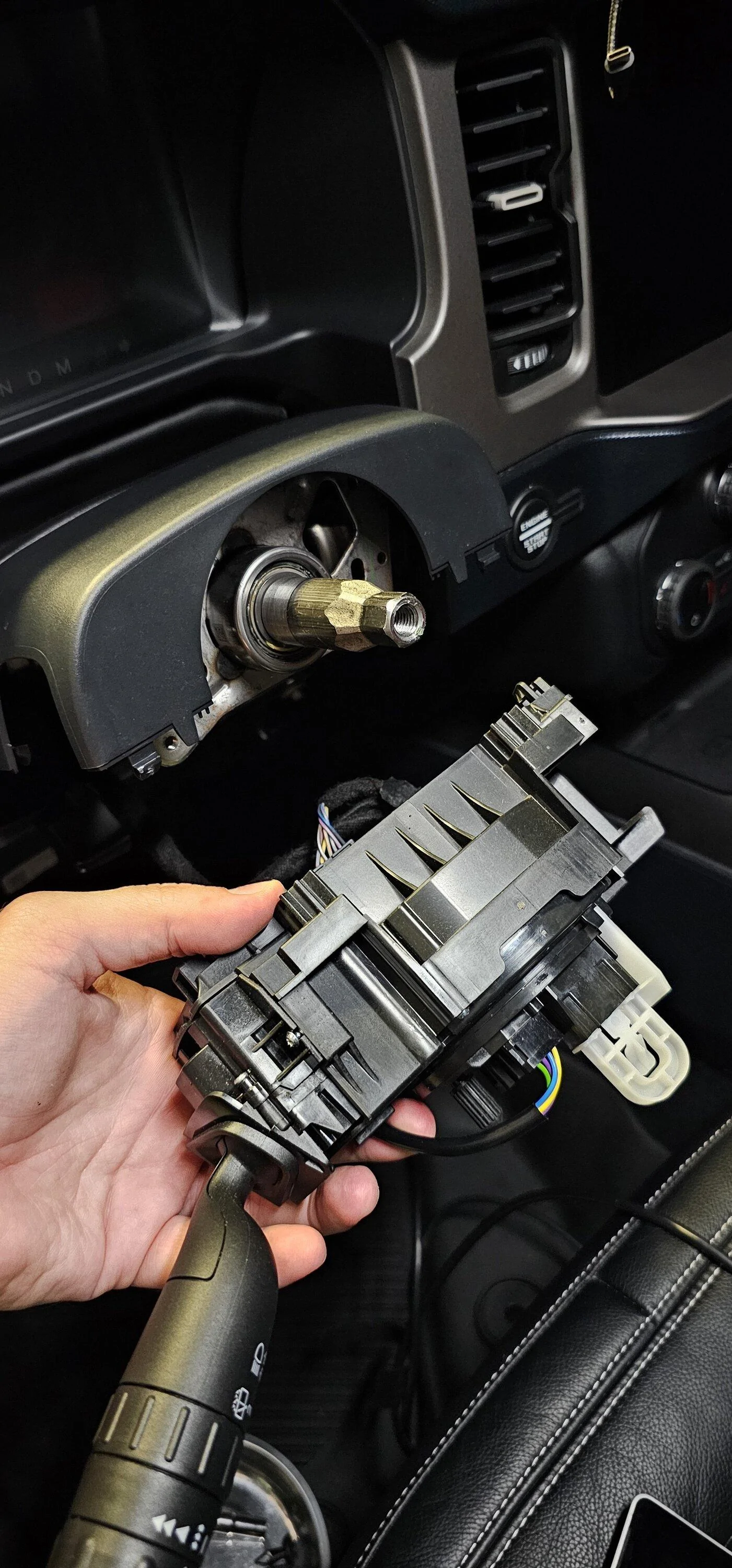

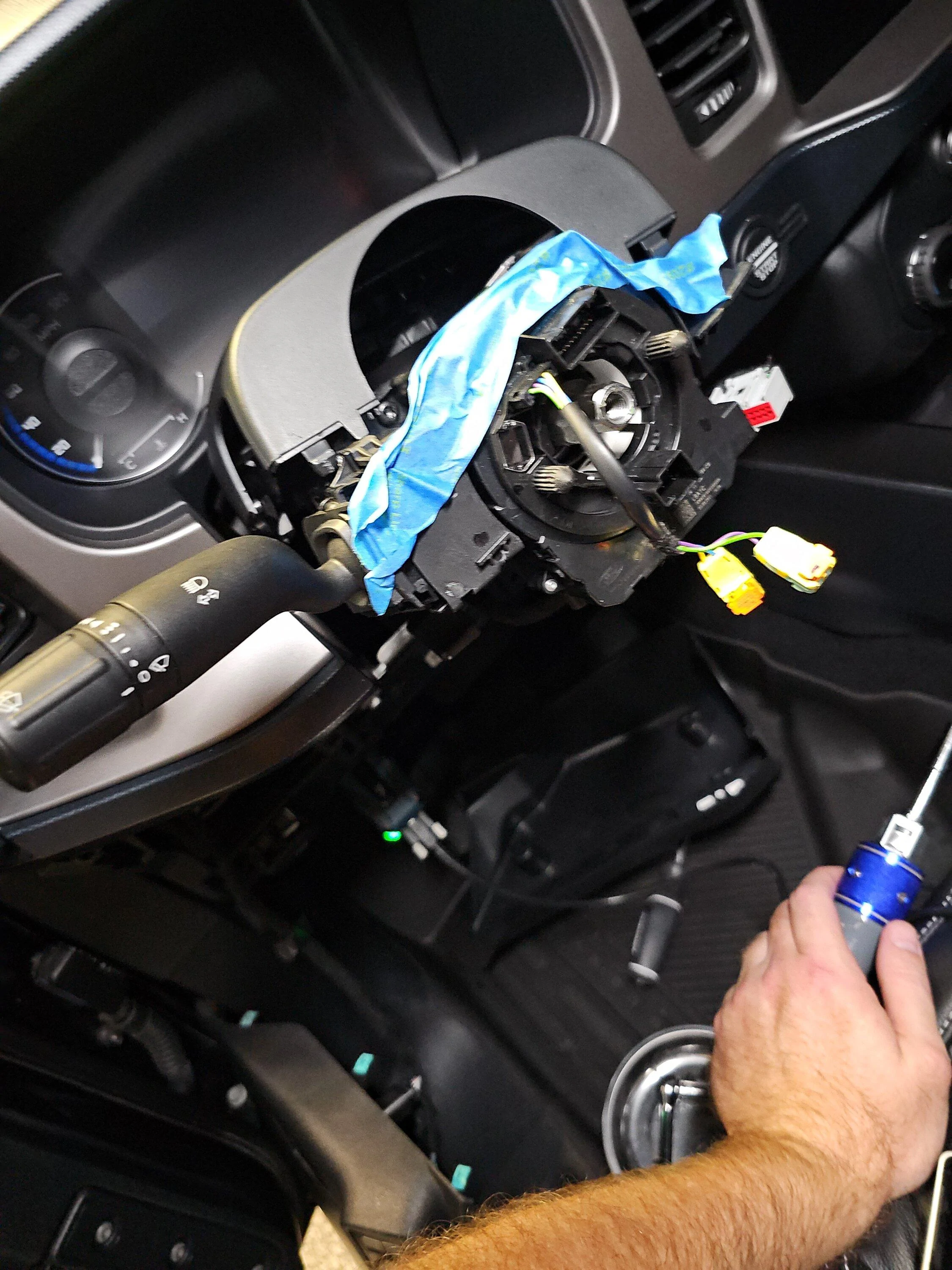

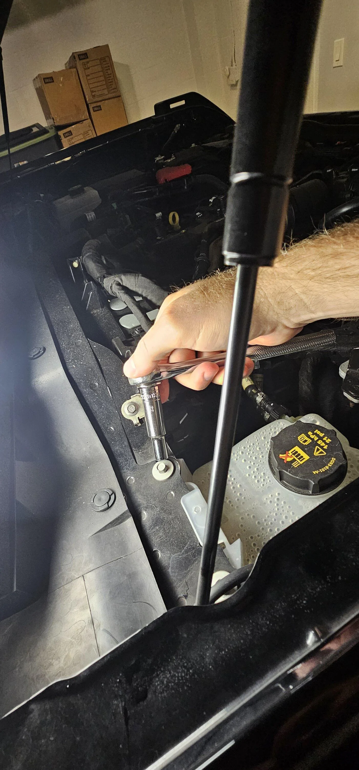

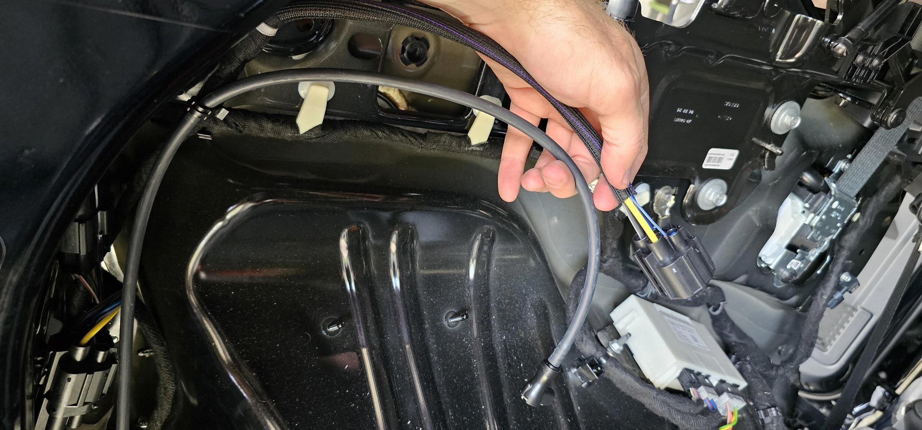

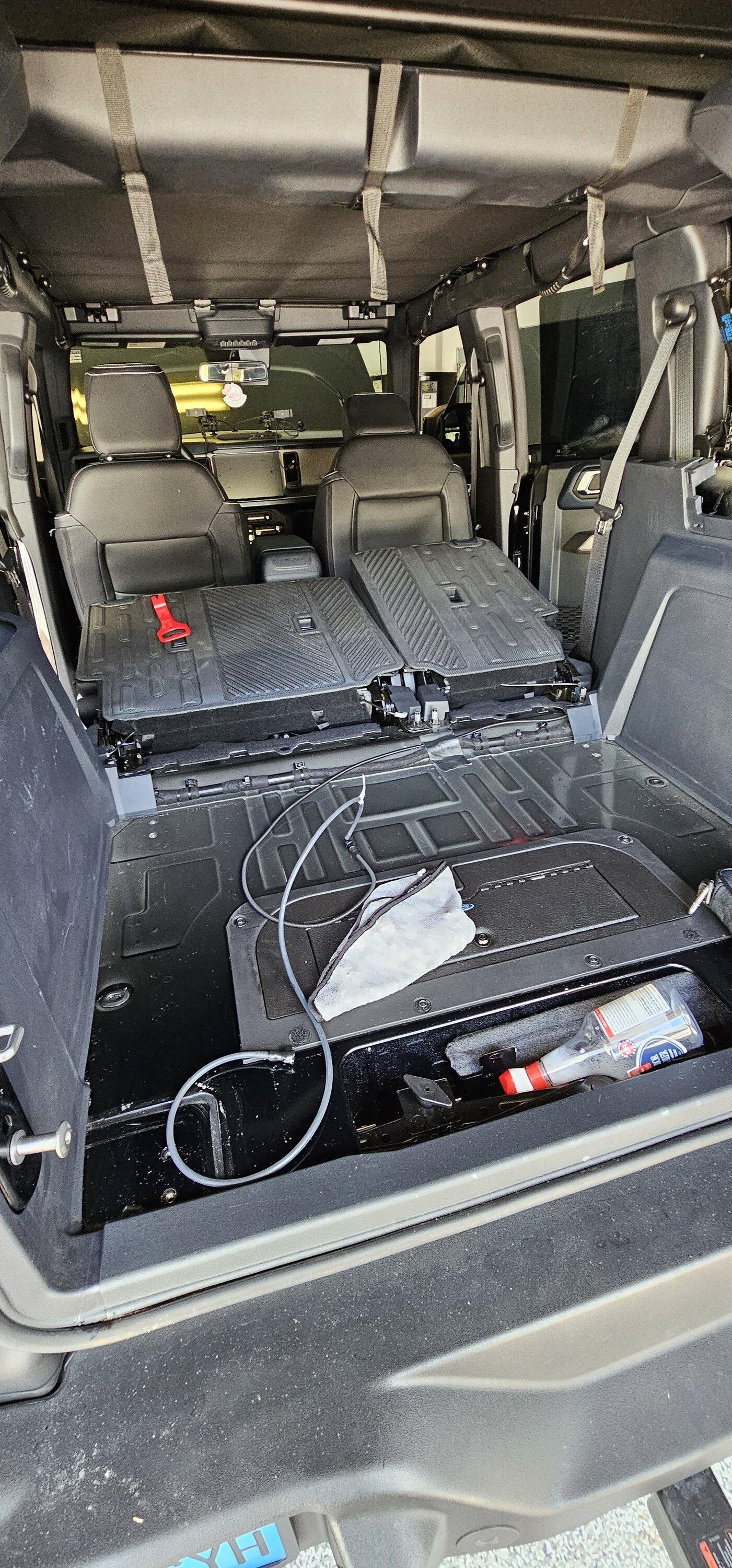

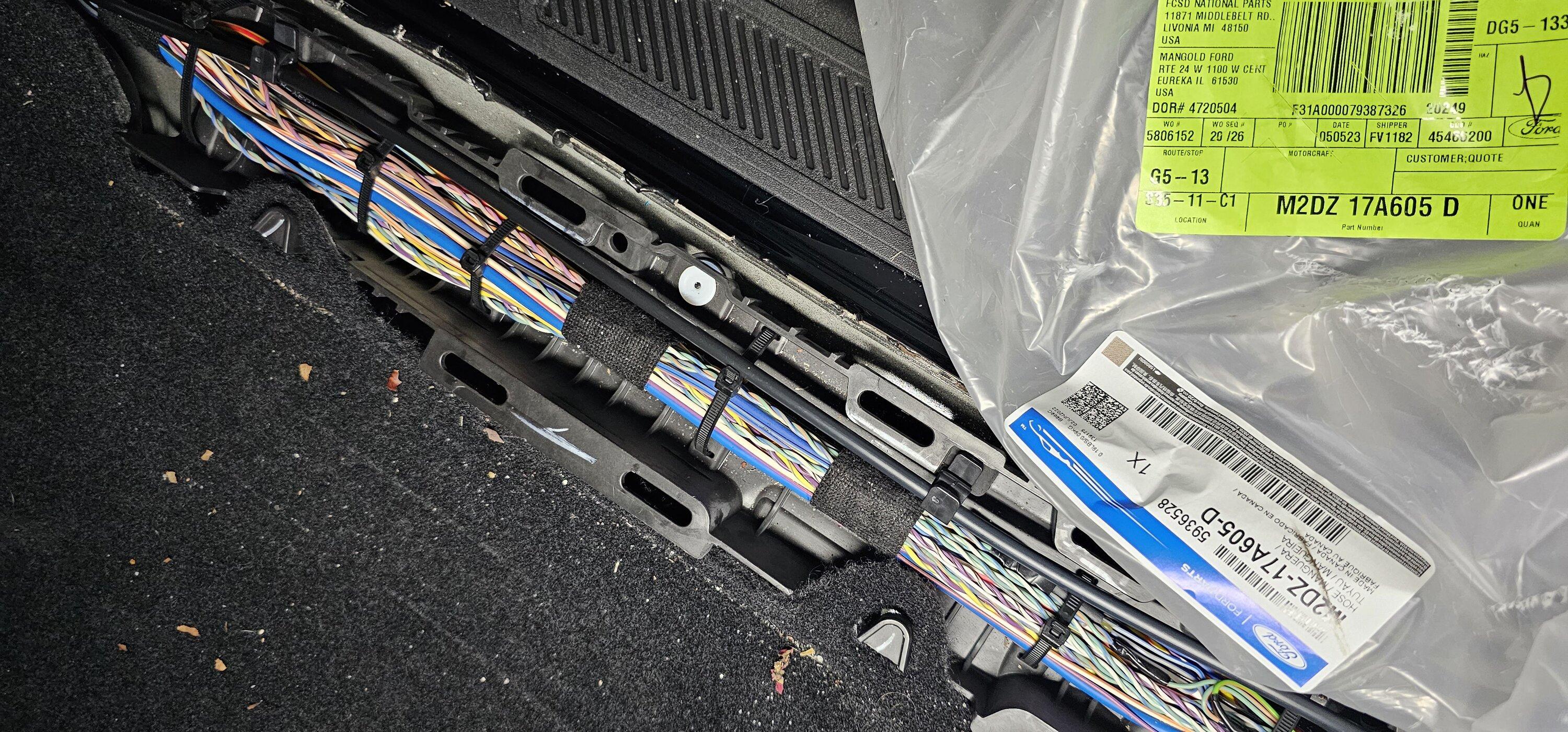

Had a chance to pull the Bronco apart and found my parts list from Mangold had a bunch of extra parts not needed. Also, I was missing one hose (not on the list, noted below), that runs from the reservoir under the hood to the hose that terminates at the firewall. I'm waiting for that to ship to me, so still have more to do. Sharing the parts that I ended up needing:
M2DZ-17A605-K - Dual Top Front Hose (under the hood, taps into the washer reservoir and connects to the M2DZ-17A605-D hose at the passenger firewall). Part number includes both hoses for front wipers and rear.

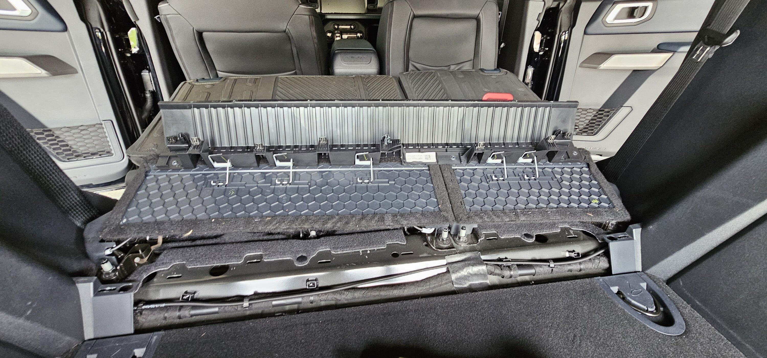

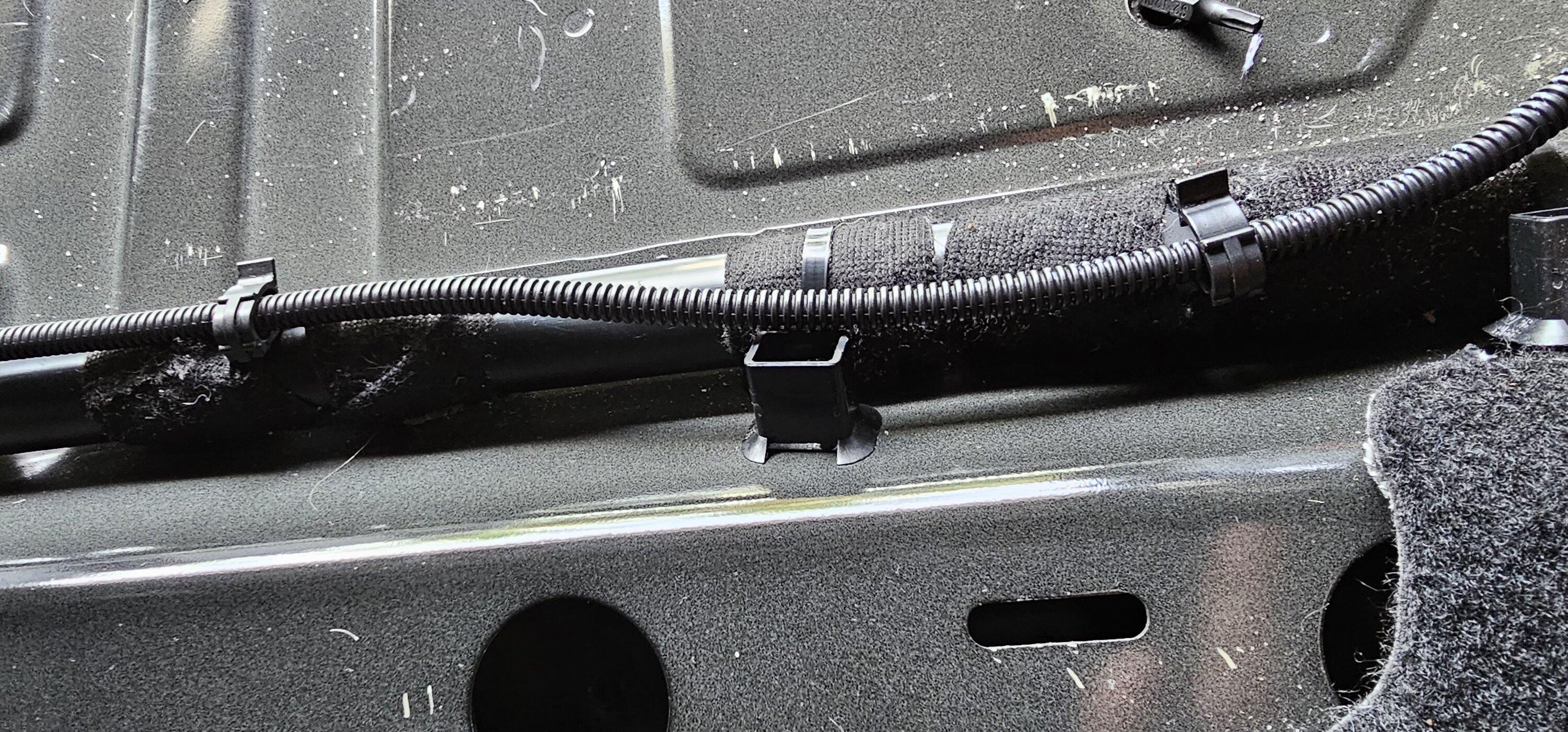

M2DZ-17A605-D - HOSE (runs from passenger firewall, down behind glove box, adjacent to wire harness running down passenger side and to cargo area hose M2DZ-17A605-F).
M2DZ-17A605-F - HOSE (connects to M2DZ-17A605-D and runs across the rear cargo area from passenger side to drivers side, connecting to M2DZ-17A605-G).
M2DZ-17A605-G - Lower Hose (quick disconnect hose that connects to hard top hoses, or next to the harness in the cargo panel when not used).

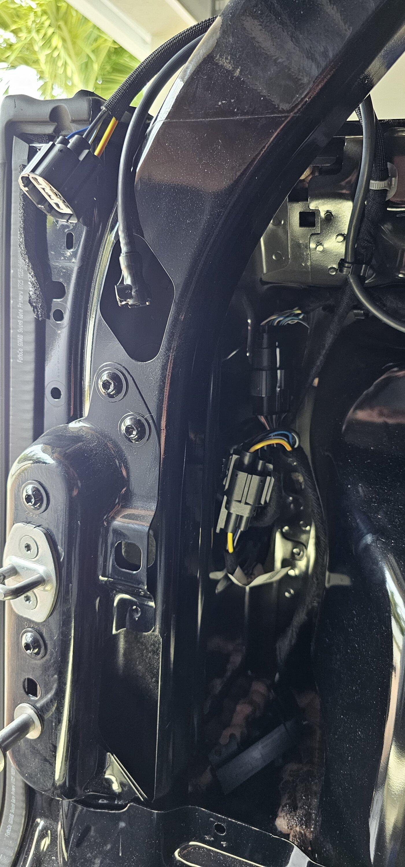

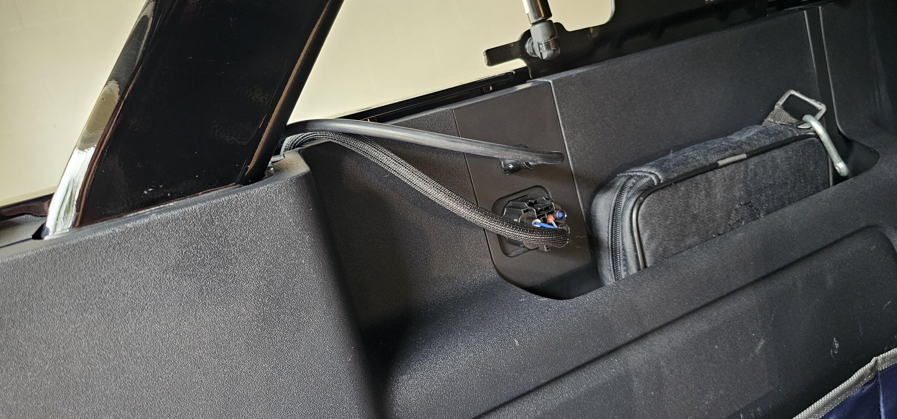

M2DZ-15A657-A - Wire Assembly (Connects to existing harness at rear of vehicle).

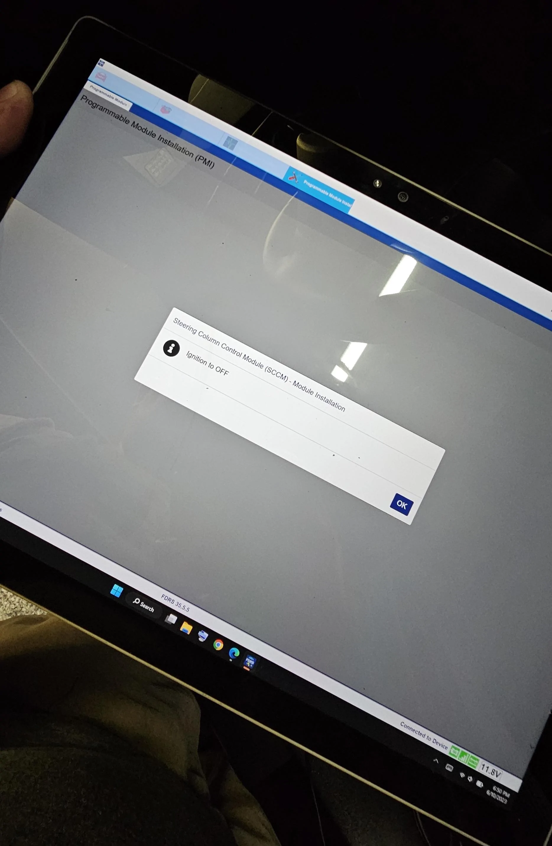

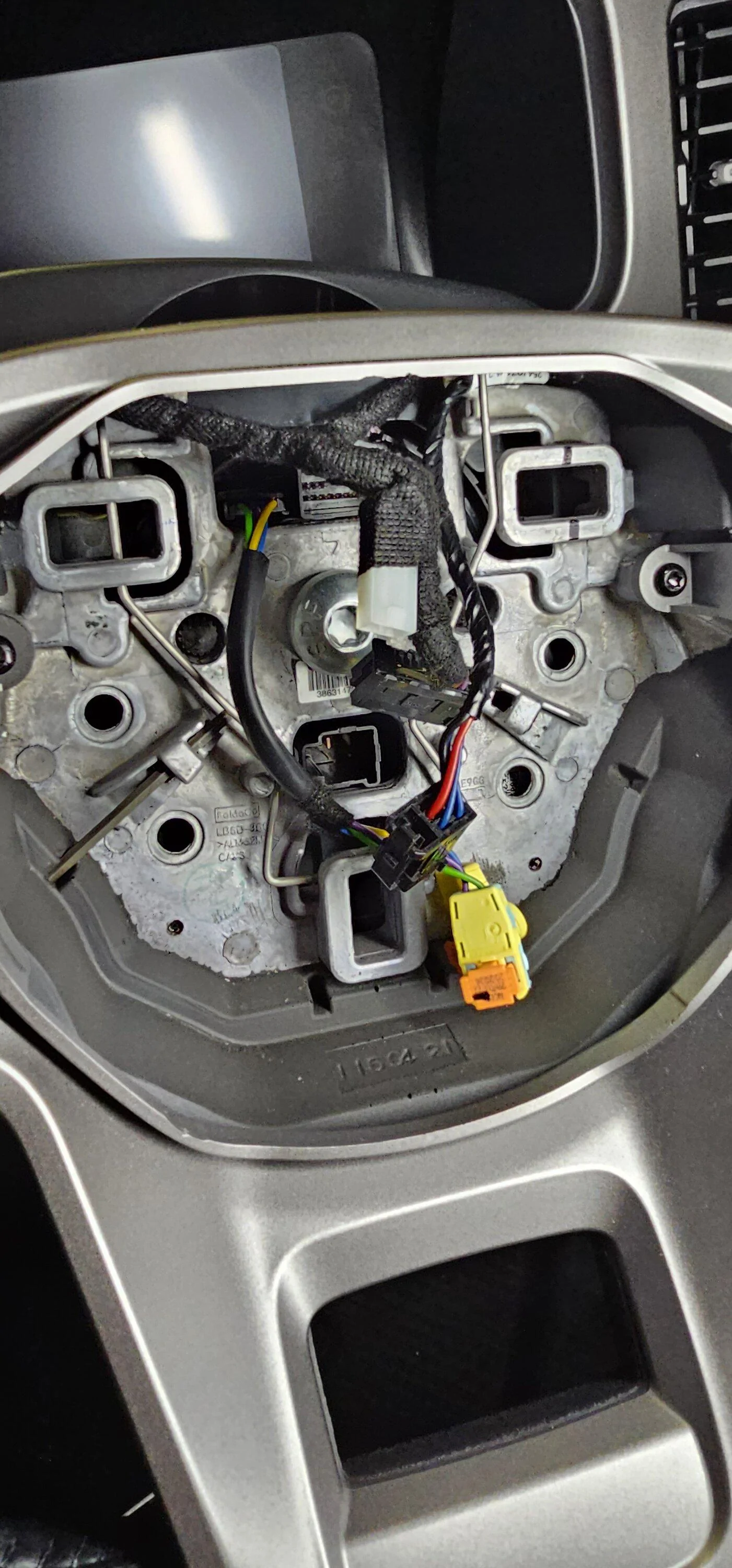

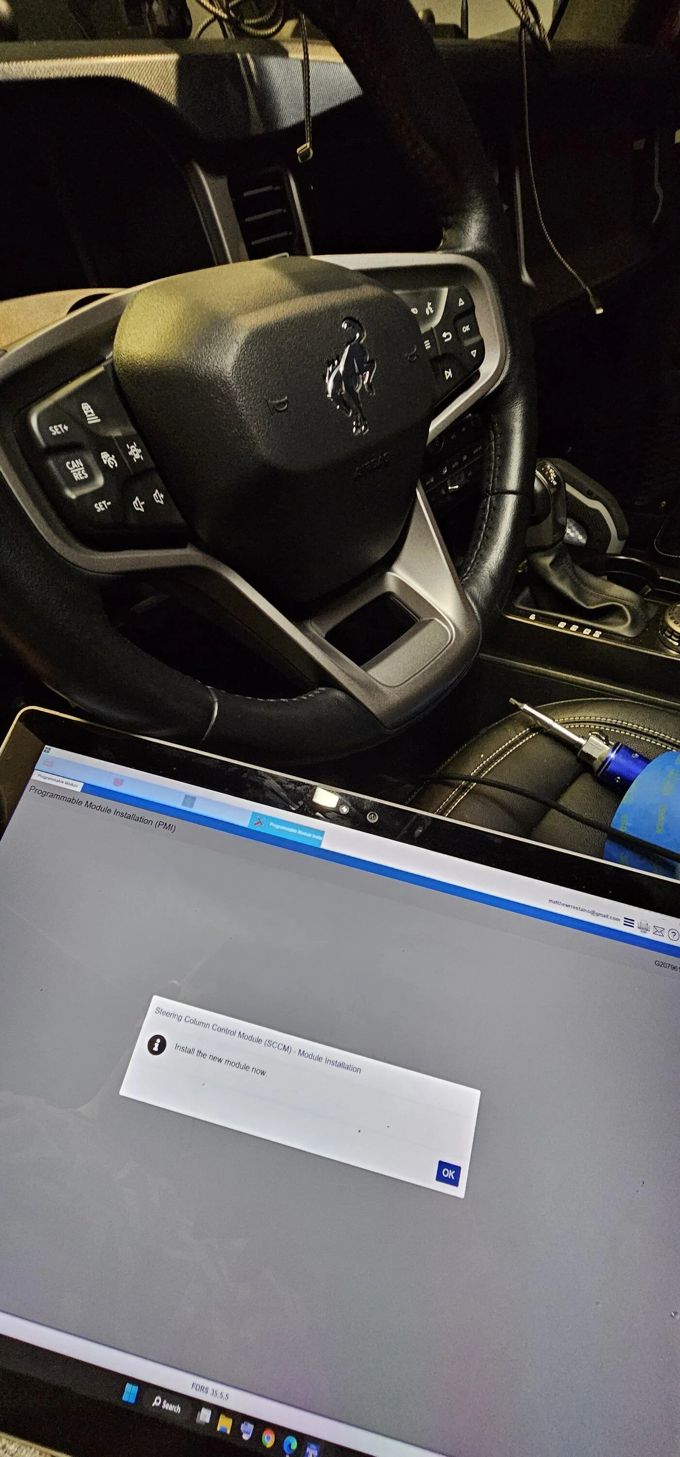

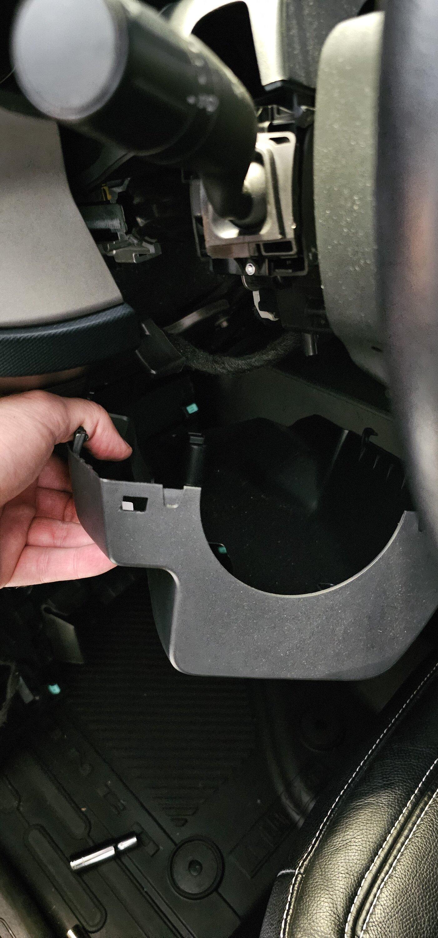

M2DZ-3F791-CB - Housing Assembly Steering Column (Front and Rear Washer Control, replaces existing, requires programming).

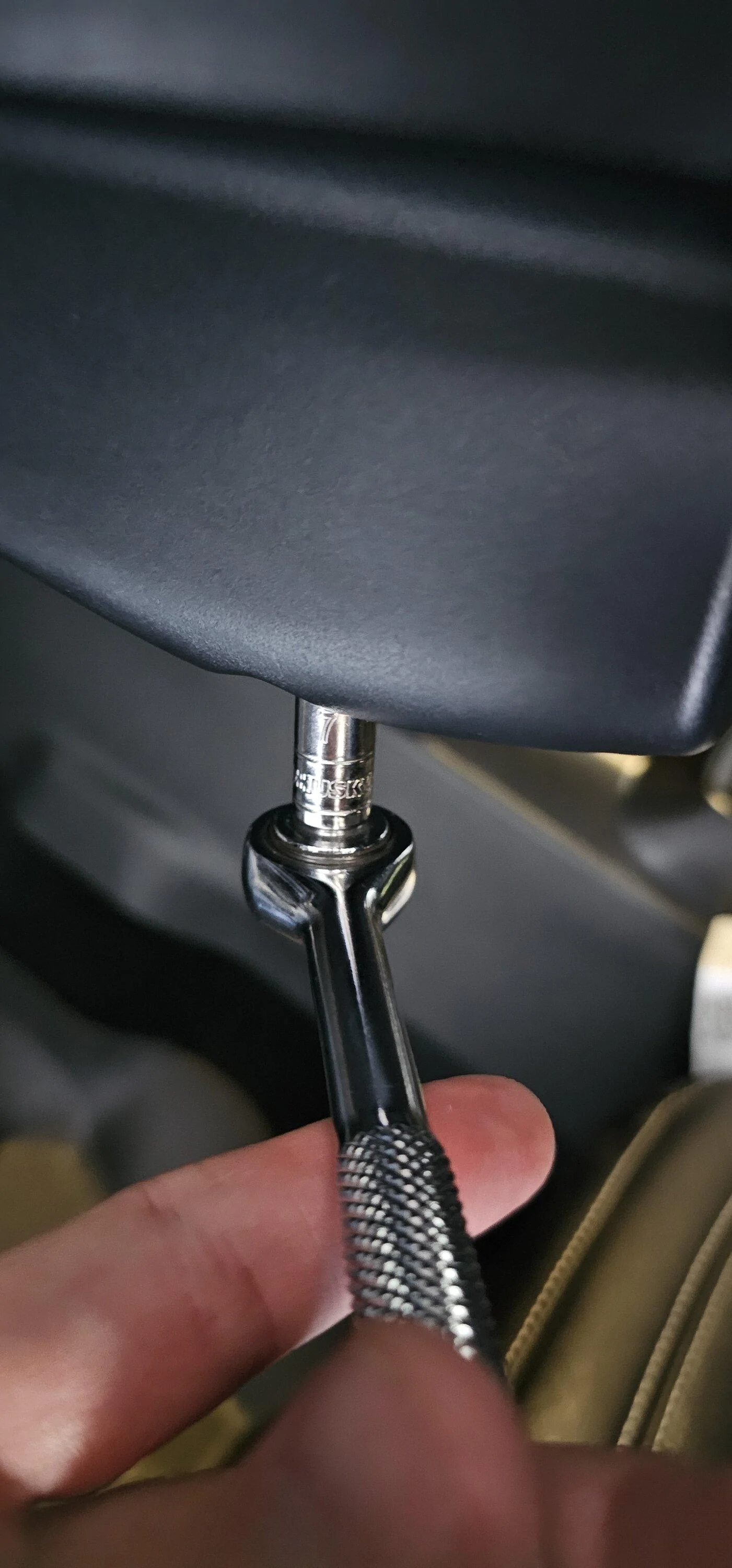

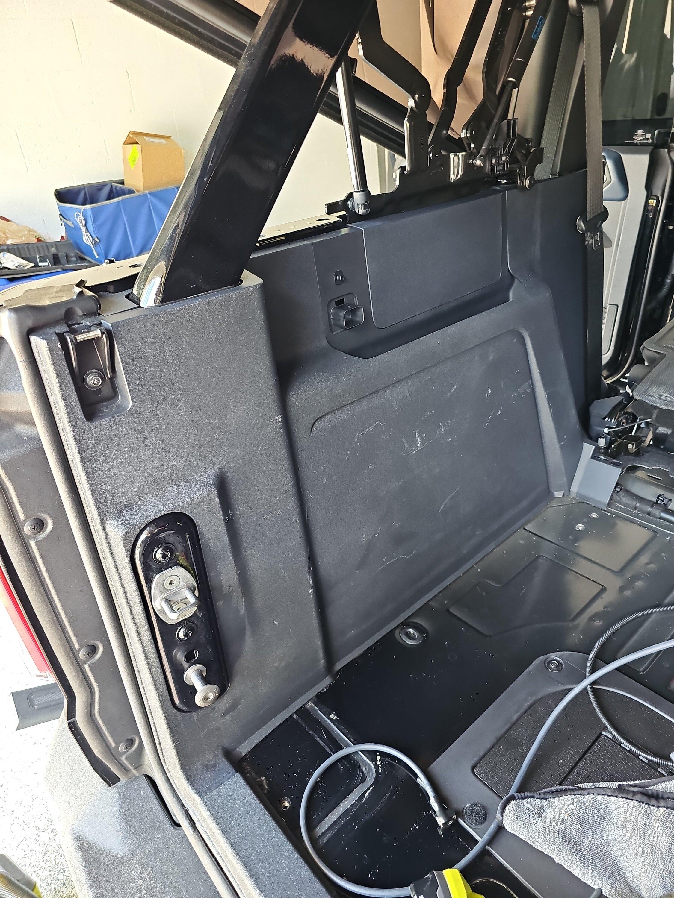

M2DZ-78245A26-B and M2DZ-78245A27-B - Hard Top Bracket Latch Mounts
TP50 Bolts (W721071-S450B) Quantity 6x - Secure Hard Top Bracket Latch Mounts

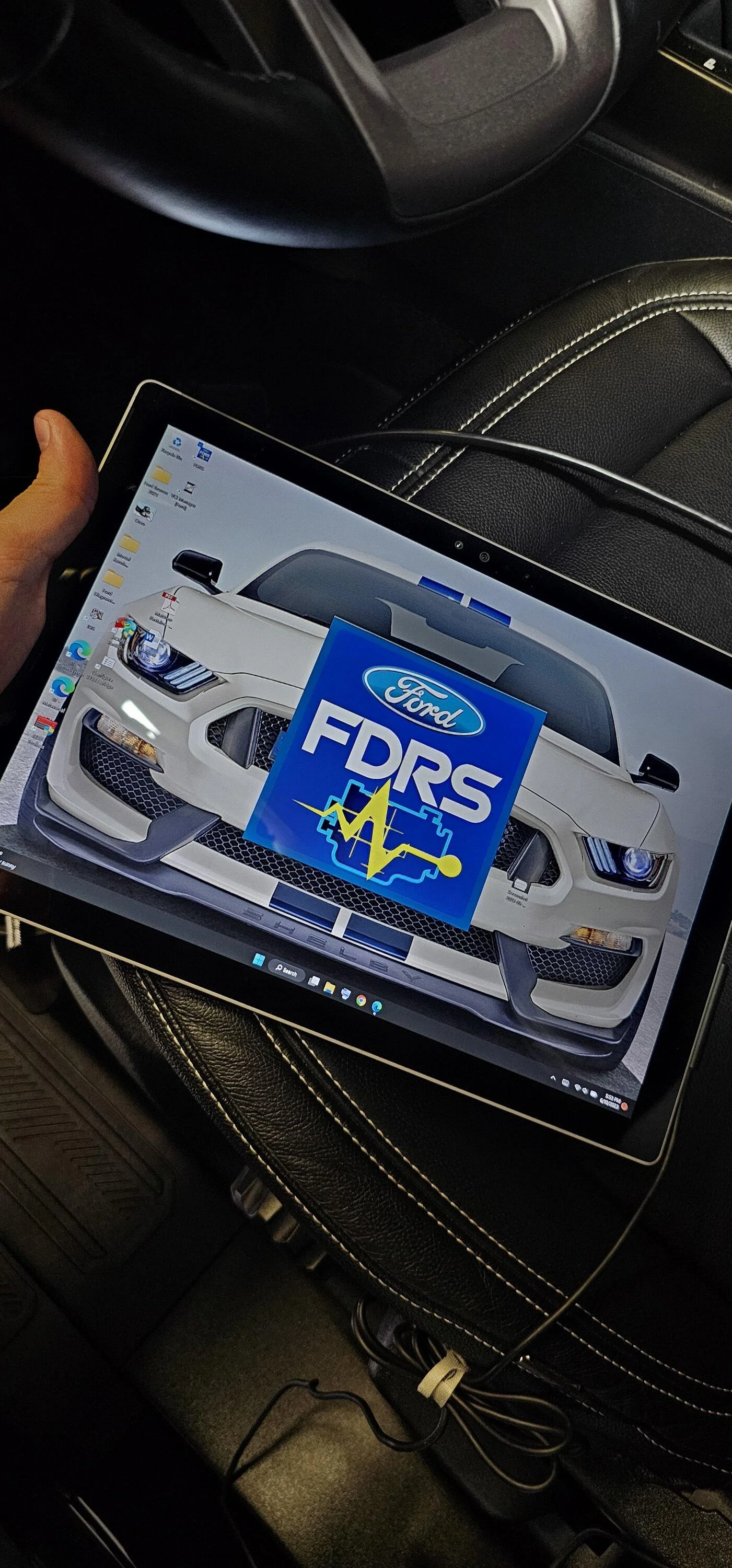

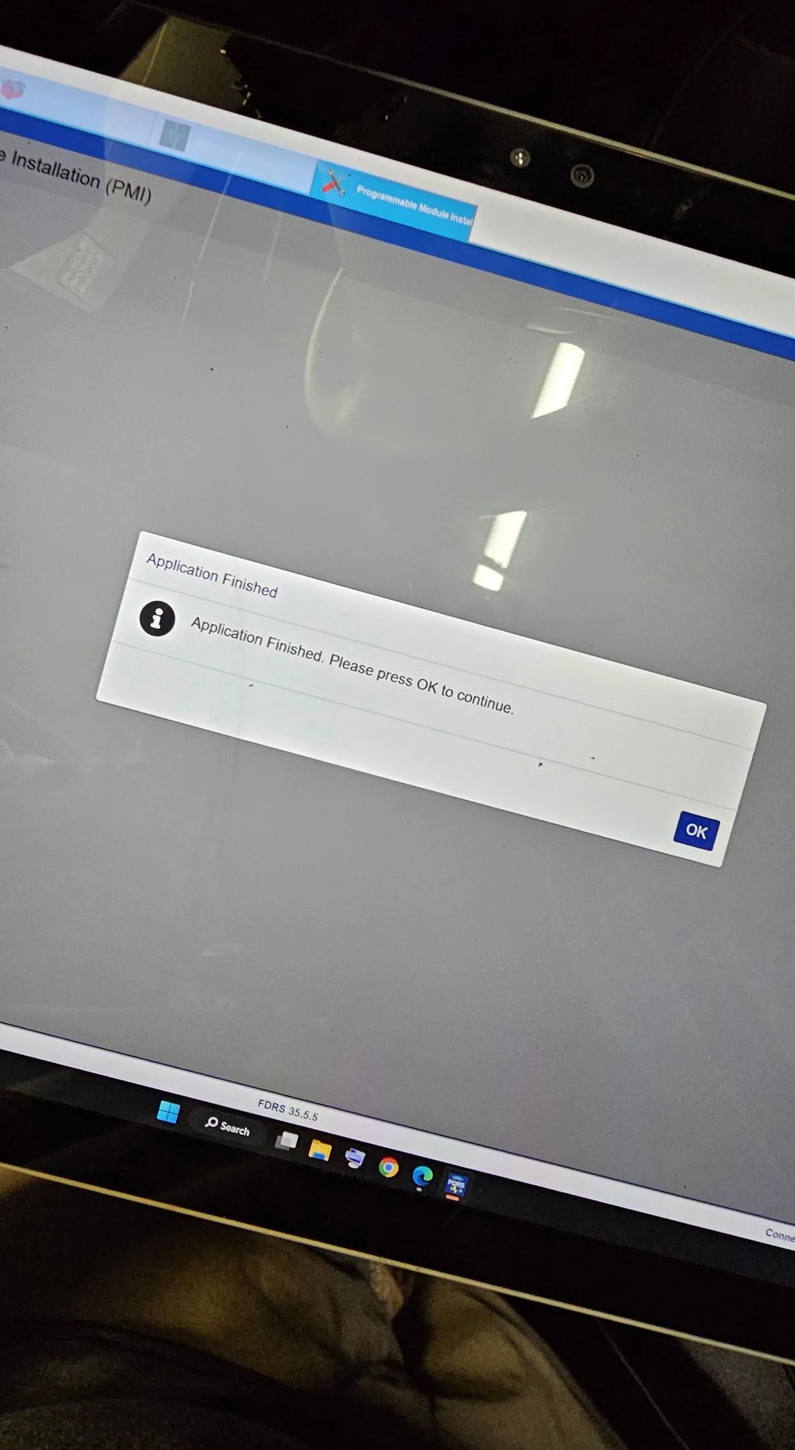

My expectations are that I will need to (1) connect the hose under the hood to the reservoir, (2) install the steering column controls for the wipers, and (3) program the new steering column to make the wipers work.

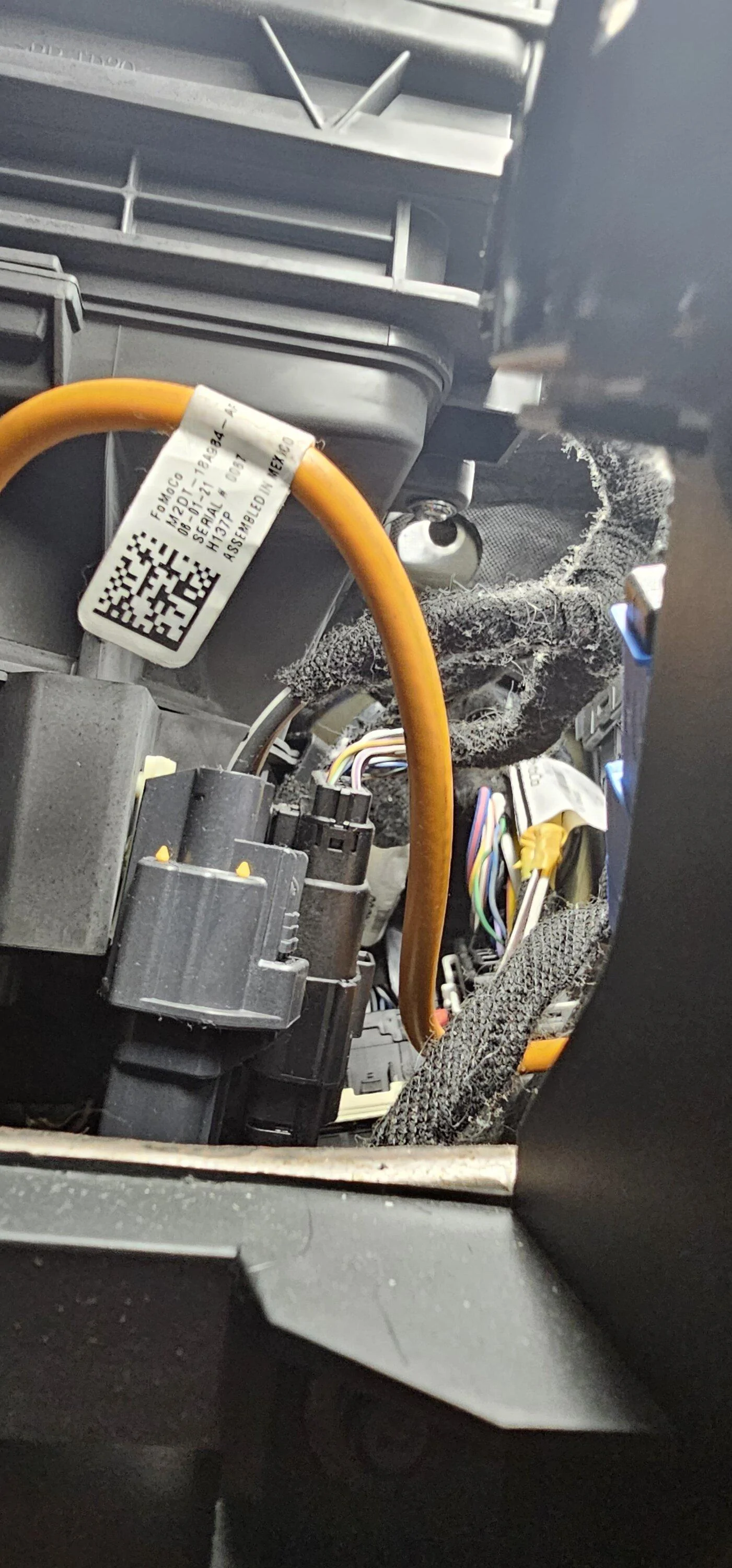

Still not sure if I need to swap the HVAC controls M2DZ-19980-C (Dash Control Unit, Heated Steering Wheel & Mirrors) & program those for the rear heater, so that's TBD.
Pictures from last night's efforts and this morning to follow.

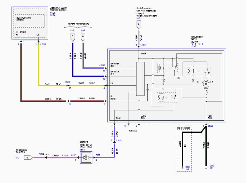

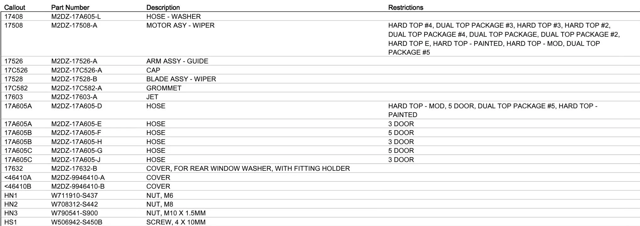

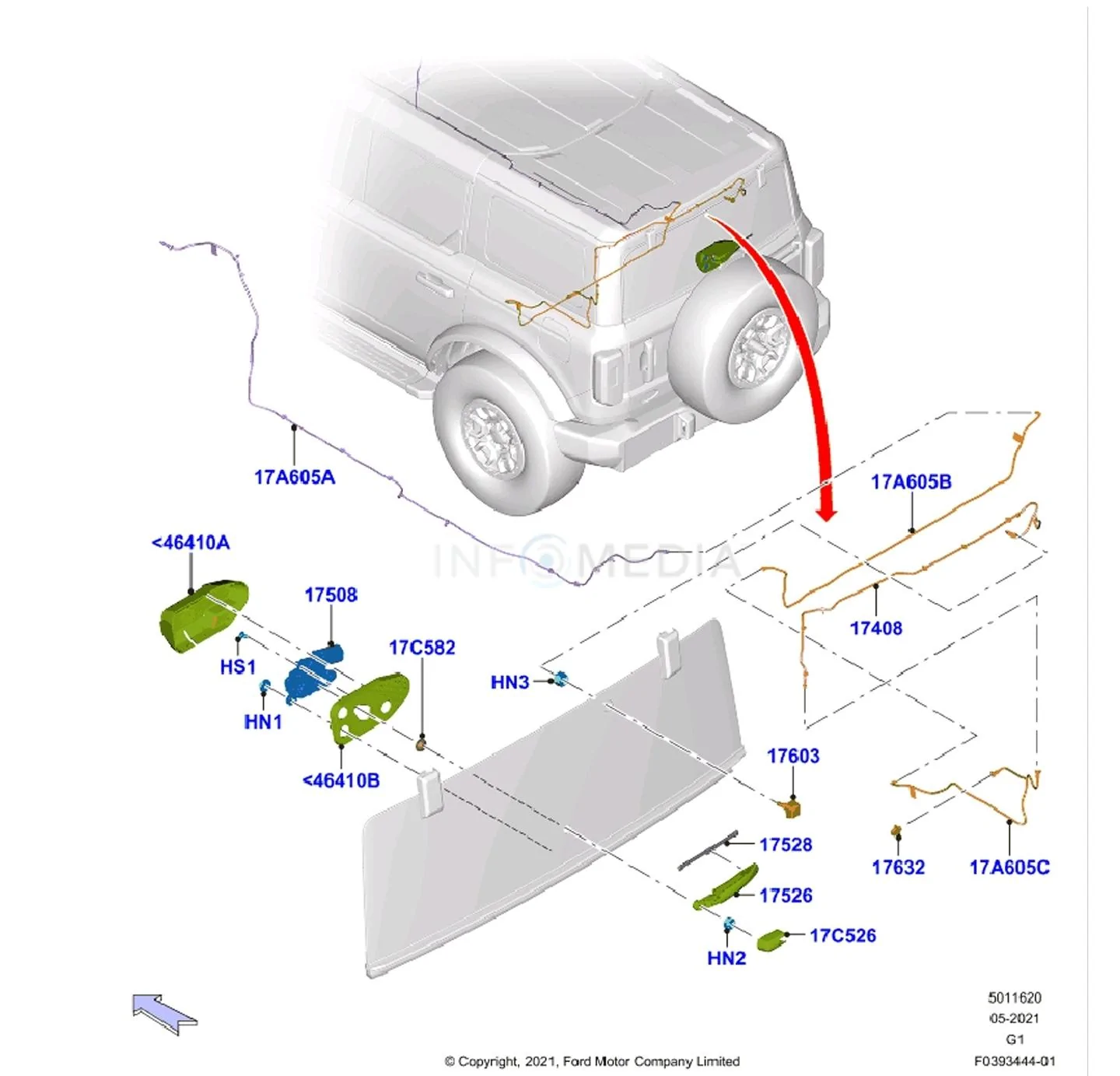

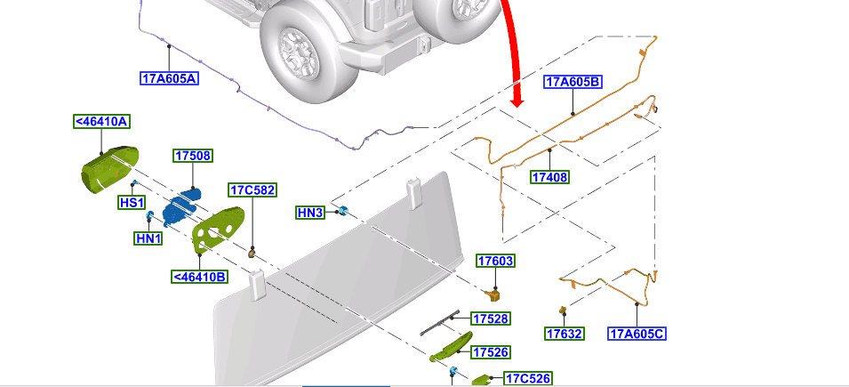

Thought this might also be helpful for cross referencing part numbers above for the hoses needed:
Ford Bronco DIY Hard Top prep kit Screenshot_20230604_071610_Adobe Acrobat
Ford Bronco DIY Hard Top prep kit Screenshot_20230604_071726_Adobe Acrobat

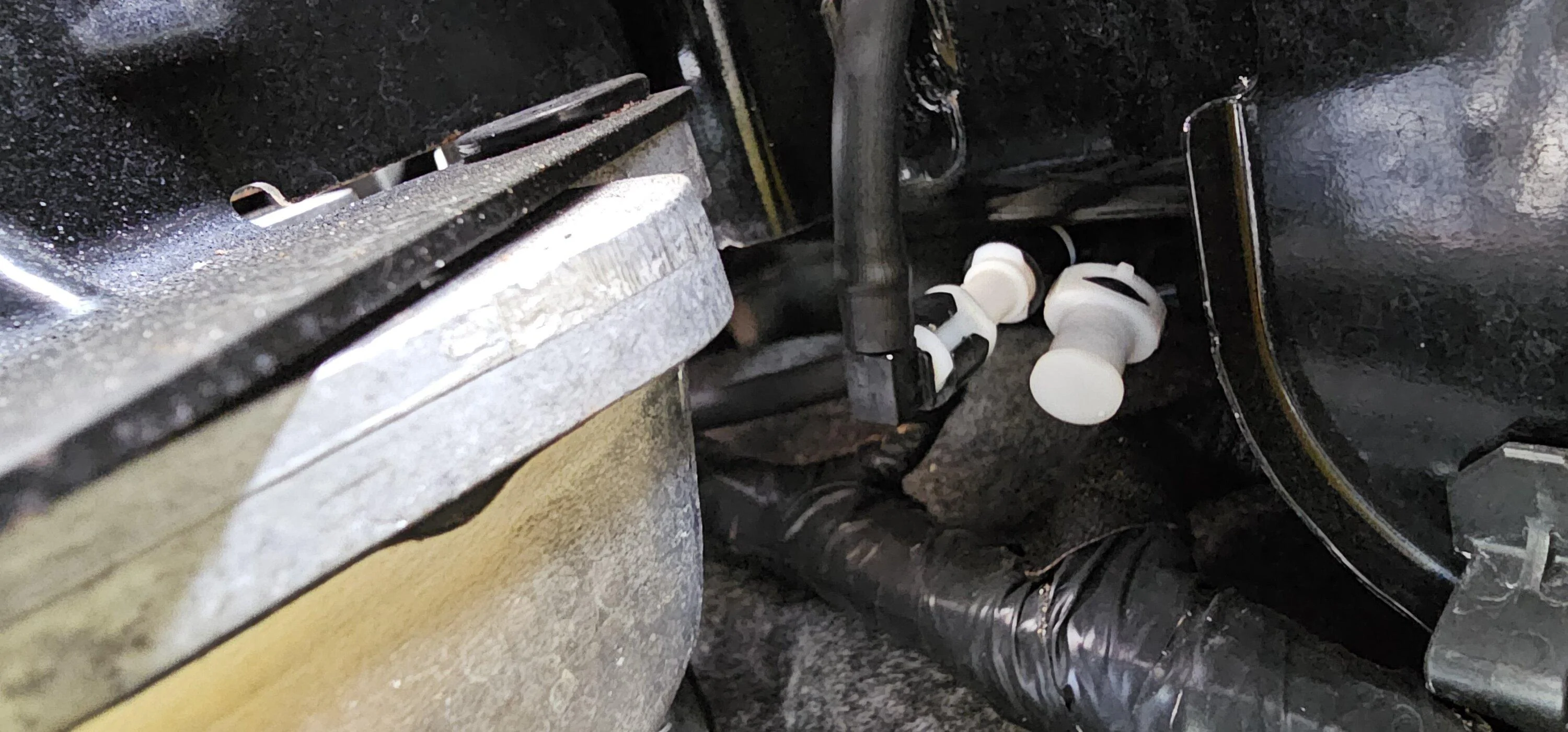

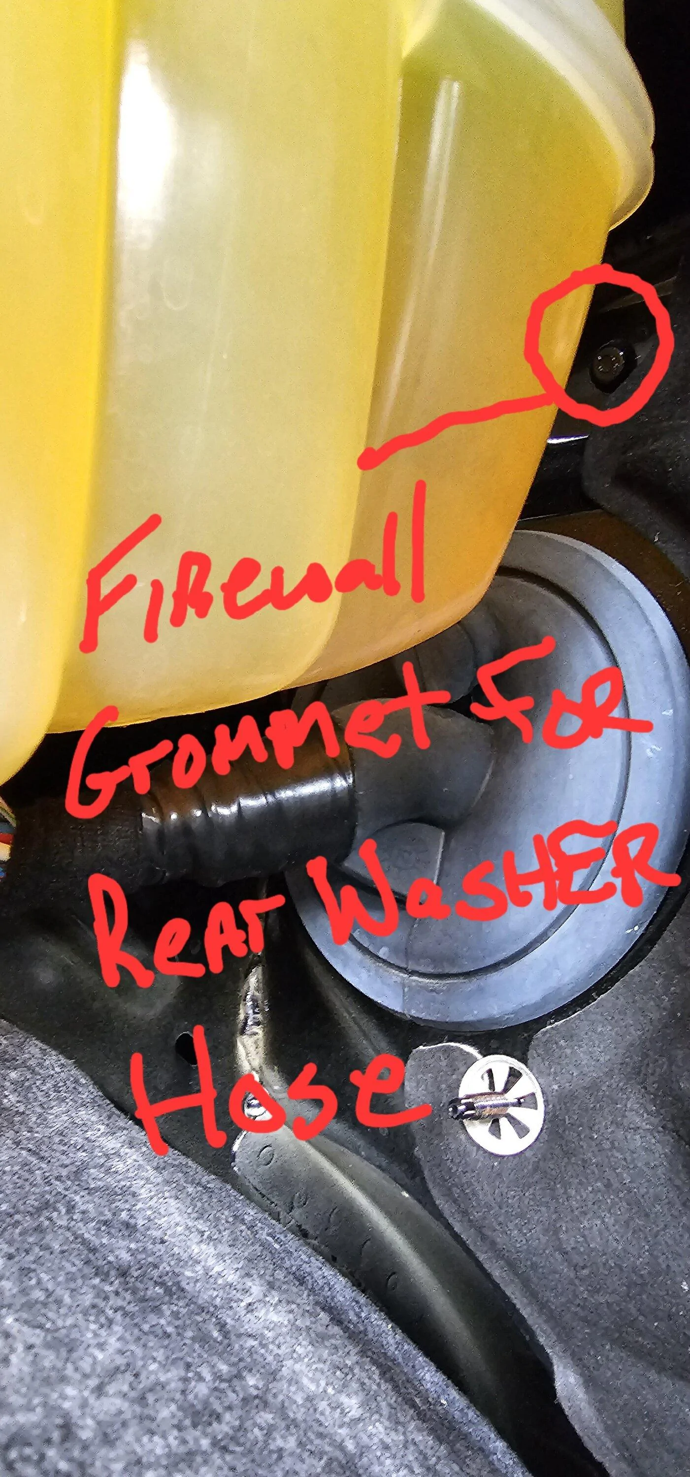

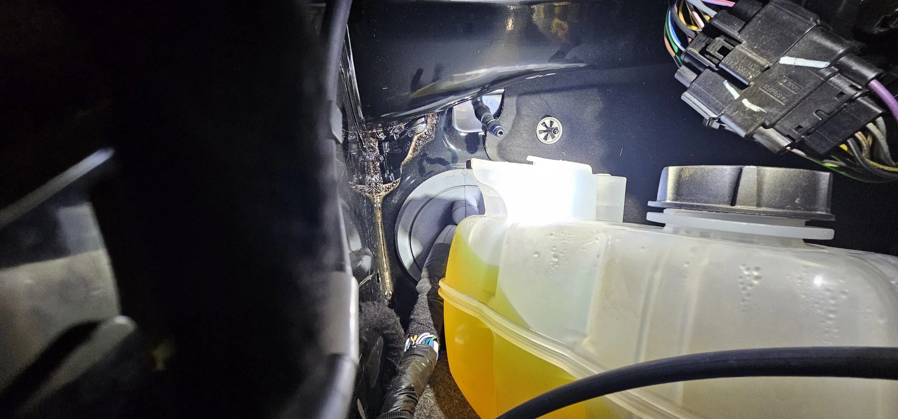

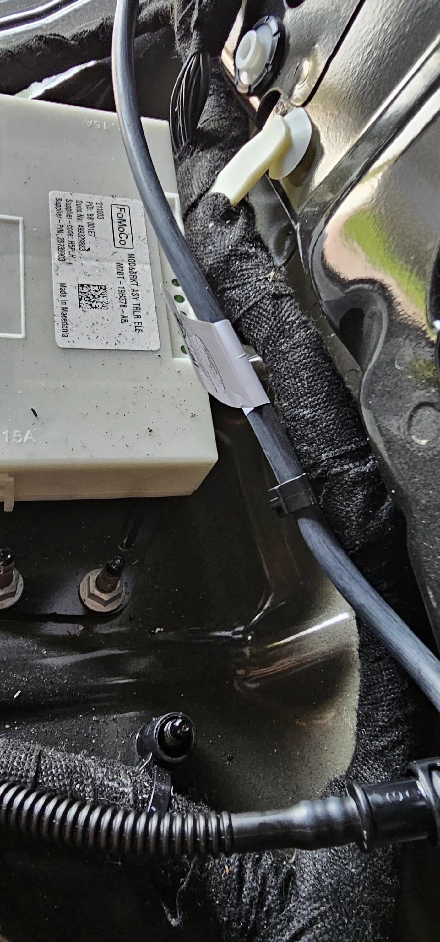

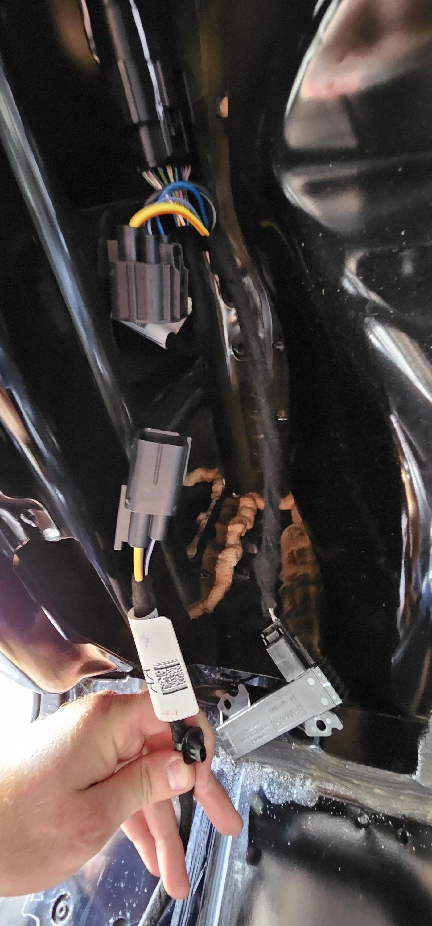

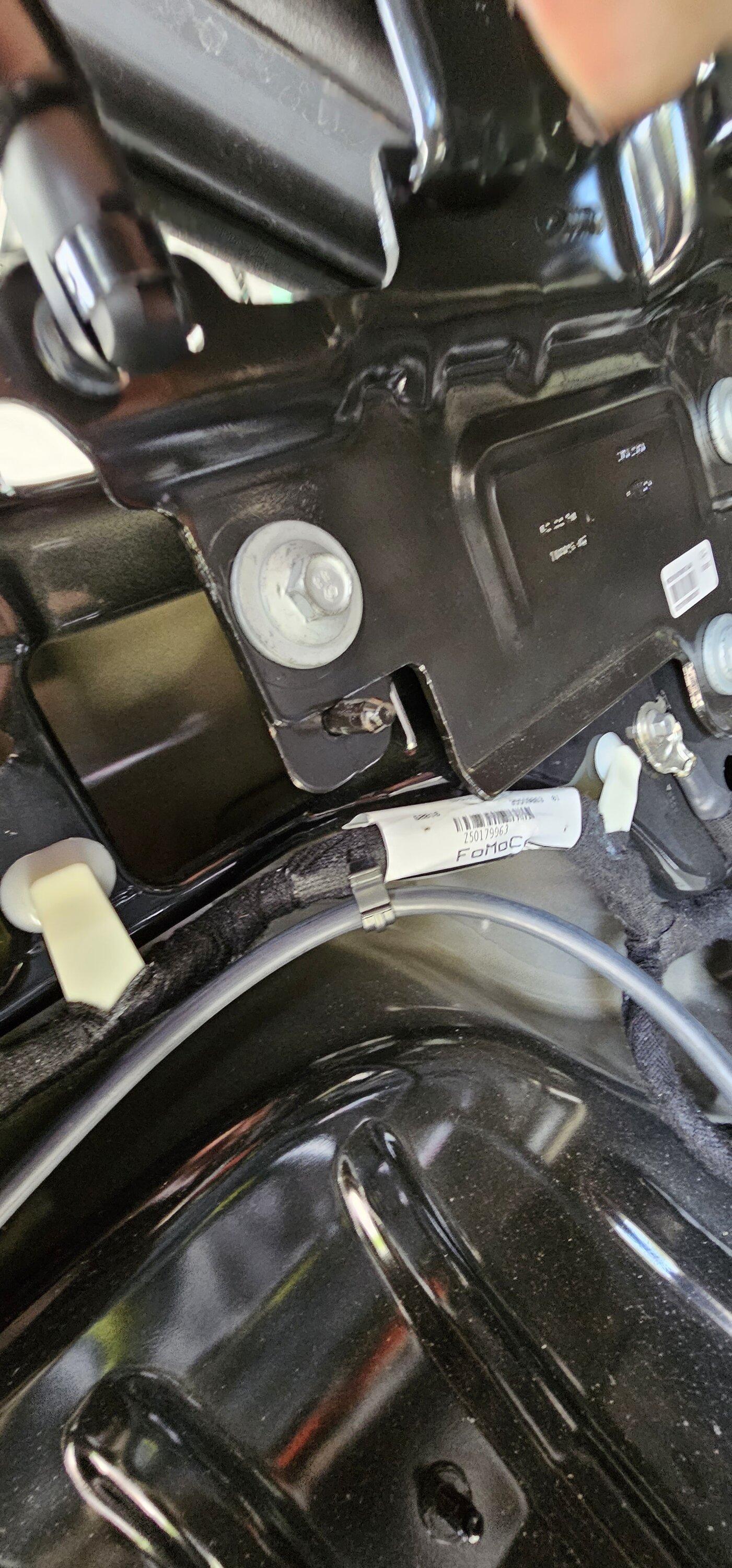

Today, what I thought was last hose I needed for under the hood arrived. Turns out it's the wrong part number.
@flip can you assist with telling us which hose is the correct part number?
Here's a picture of it connected to the hose routed through the firewall.
Ford Bronco DIY Hard Top prep kit IMG_3158
Ford Bronco DIY Hard Top prep kit IMG_3157
It connects to the hose capped off that's coming off the reservoir.
Ford Bronco DIY Hard Top prep kit 20230603_073448

For basic install - just the brackets on the roll bar. I’m sure you can ask ADV for the part numbers - I don’t have them off hand. I can dig them up.
Oh, and more of those TP50 bolts for the rear quarter/cap.
Otherwise, the parts for defrost are TBD. From my research, you need to replace the HVAC controls for the one with the rear defrost button.
Dumb question. What holds the brackets in place? Need to order bolts too?
