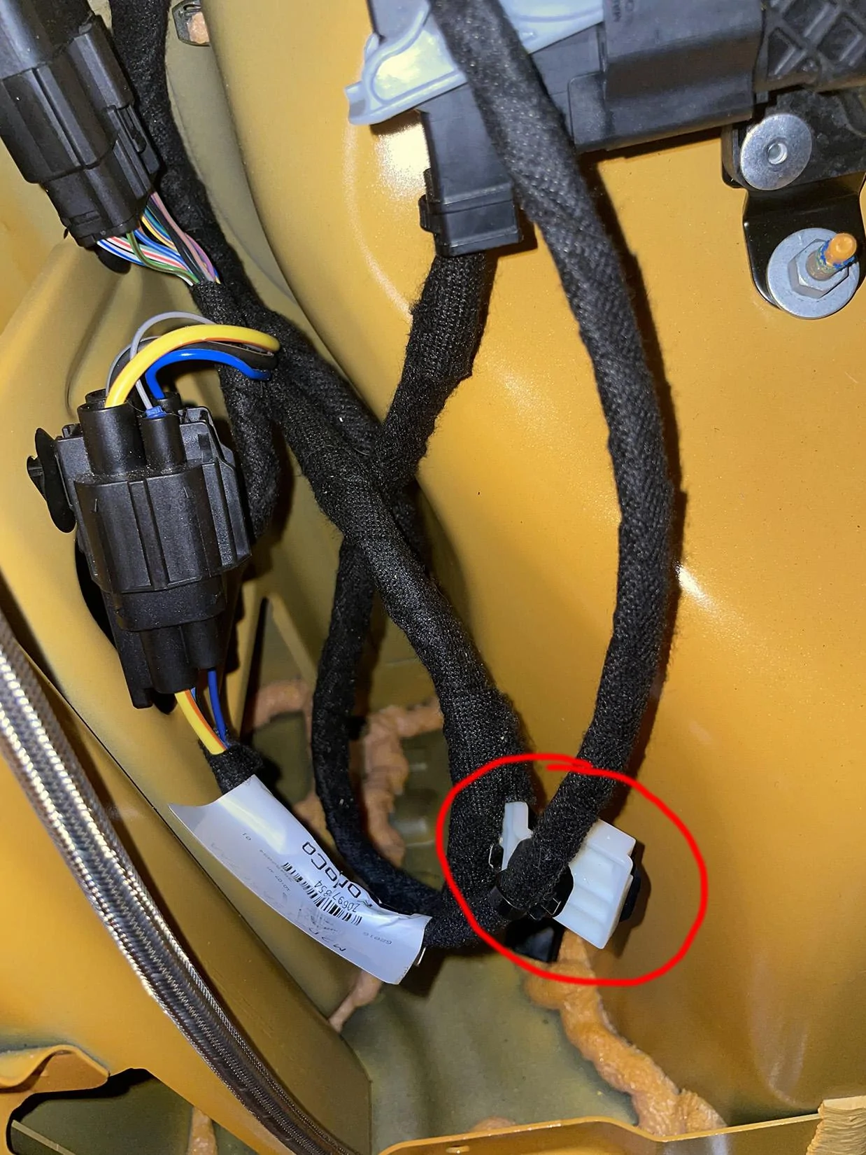

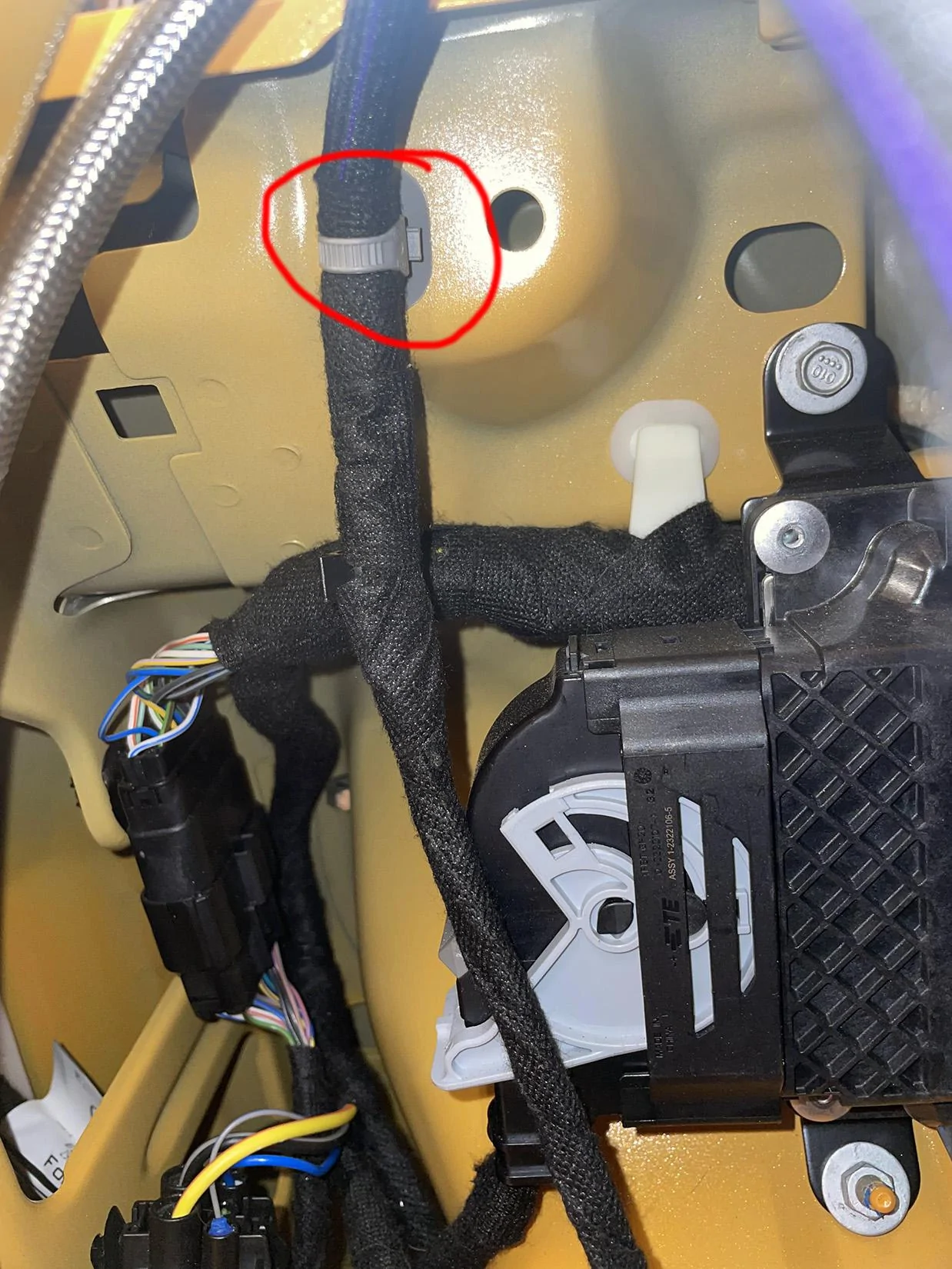

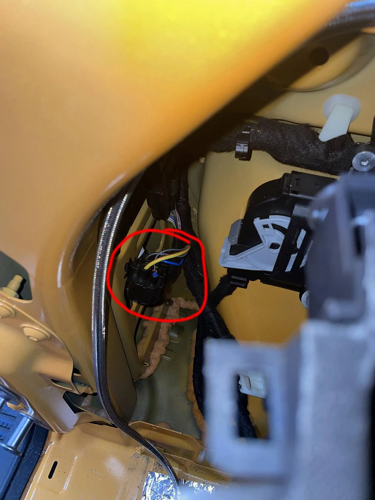

So I was one of the lucky few that got a Bronco last summer. Unfortunately this was before the hard top prep kit was a thing. I was doing my compressor install in the rear cubby I noticed a familiar looking plug and wires behind the driver side cargo panel.

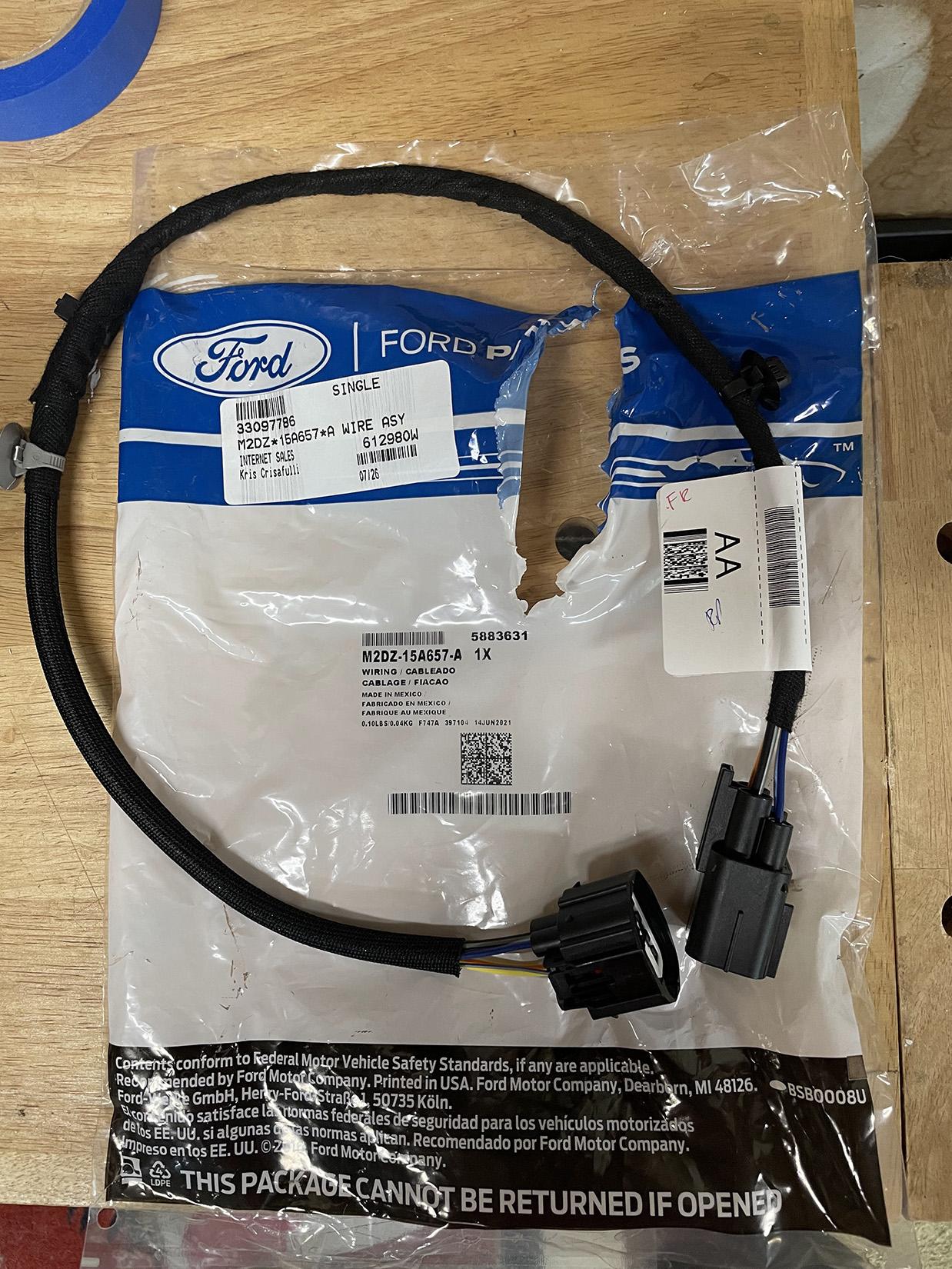

In a discussion of adding a hard top later @flip mentioned a part# I would be interested in. Fired up the google machine and found it as a wire assembly and $40. Eh, lets take a shot.
Got a week or so later from Tasca.com and it appears to be what I'm looking for.

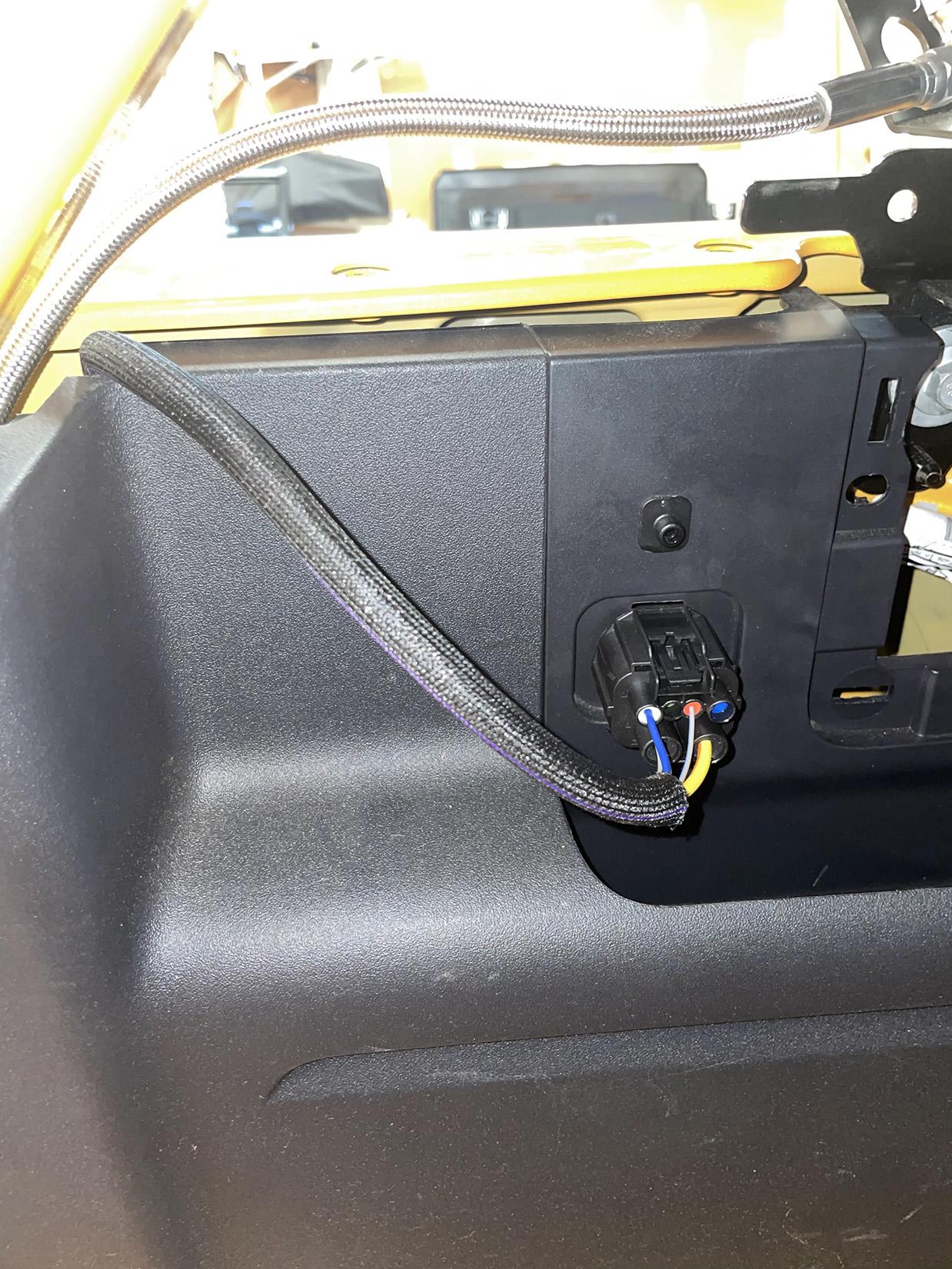

Clicks right in and even has the wire retainer clips to mount in factory locations. Sweet!
Now my hope is that the heated mirror switch on the HVAC controls will activate the rear defrost as the rear defrost button activates the heated mirrors on the vehicles with hard top or hard top prep kit, or at least be able to toggle on with forscan. I'll need to multimeter to check it out if its activating though. I hope this is the case as I looked at replacement HVAC control panel needed and it's $250 bucks. At that point I'll just tell the kids to hold their breath on those days.

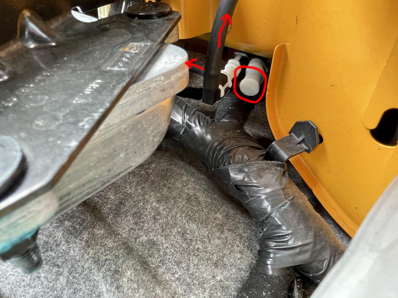

I also noticed there is an extra washer hookup on mine. The front one t's off with one going to the front camera and the other to the windshield. If anyone can confirm the other goes the rear I would appreciate it.
I can confirm the wiper washer line. Passenger frt. Fender feeds the washer line to the back from. The reservoir.
I capped mind an did a rear wiper delete.
