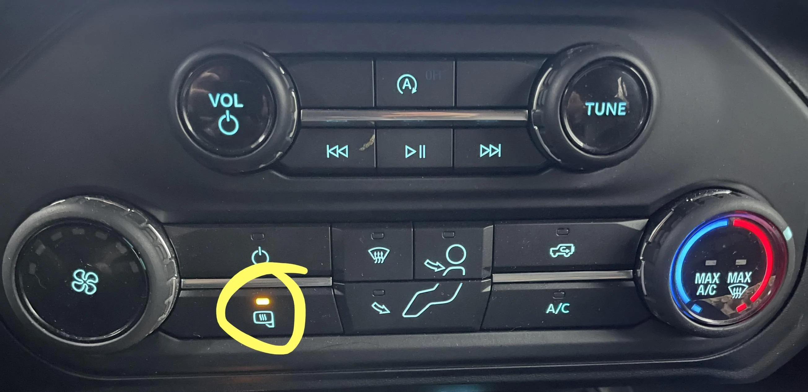

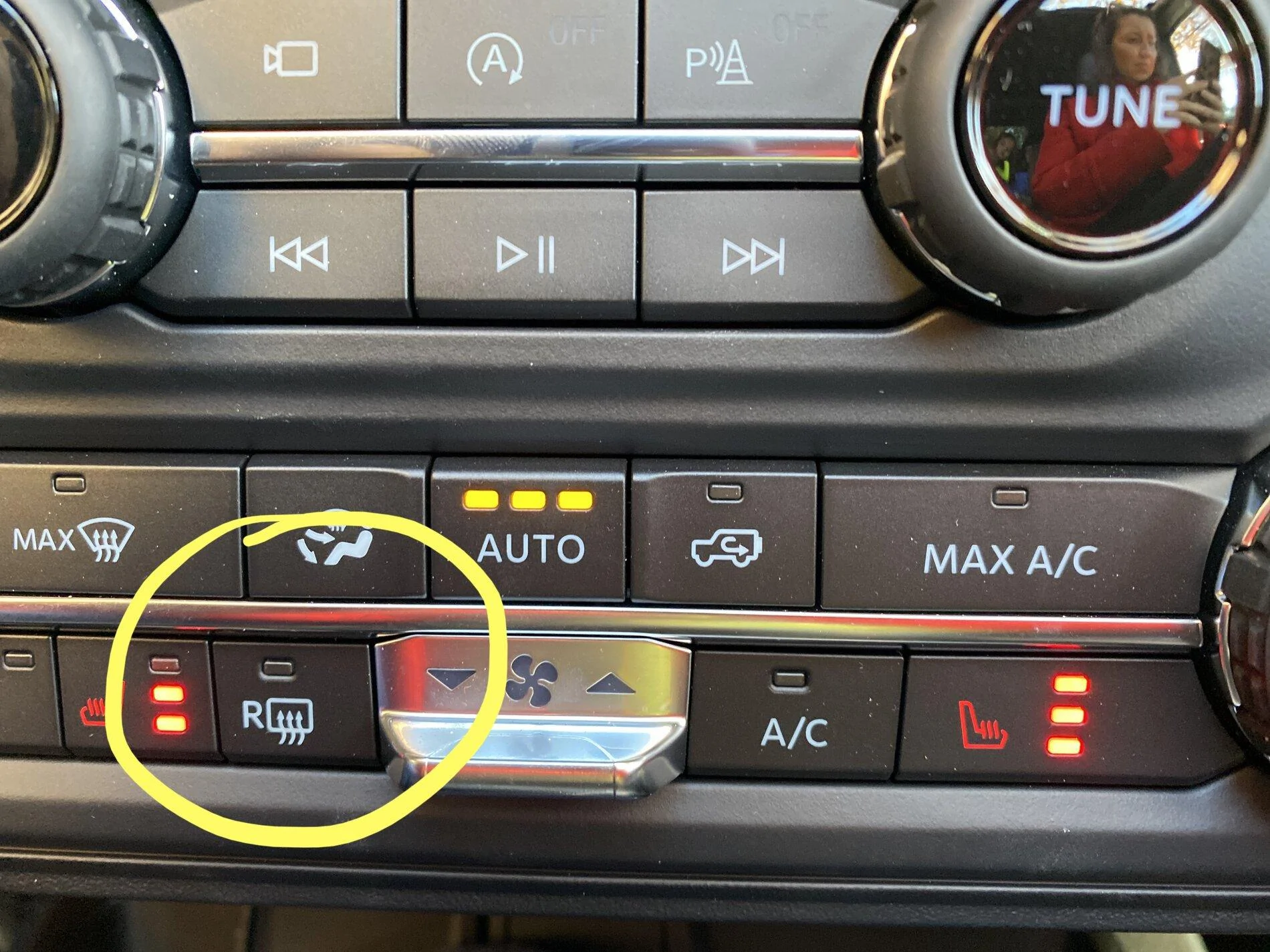

This got me thinking…those with the Prep Kit from factory - but, Standard Package…what is the defrost button on the HVAC controls? Is it the mirror icon?

@flip - any input is appreciated.
I can care less if my HVAC controls aren’t visually updated - but, can we expect that mirror button to perform like the higher packages. Assuming theirs has the R icon - but, defrosts the mirrors as well. That is the case, right?
