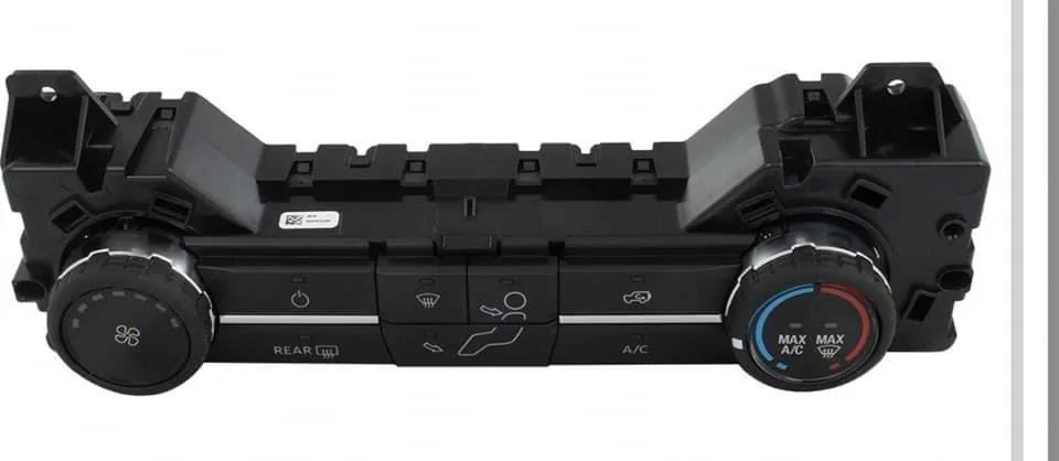

Looks like Prep-Kit/Sept 2021+ w/ Standard have an updated HVAC control.

I think I narrowed it down....N2DZ19980L - $350! Yikes.
Manual Air Conditioning, With Heated Rear Window

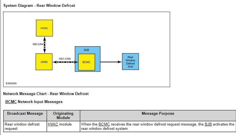

Huh, I did not see any settings for Rear Defrost in the BCMC Module…I guess I’ll dig further. BJB = Battery Junction Box? Is it possible I don’t have a fuse in place? I’ll report back.

Ah, I was thinking BdyCM. Don’t see anything in there.

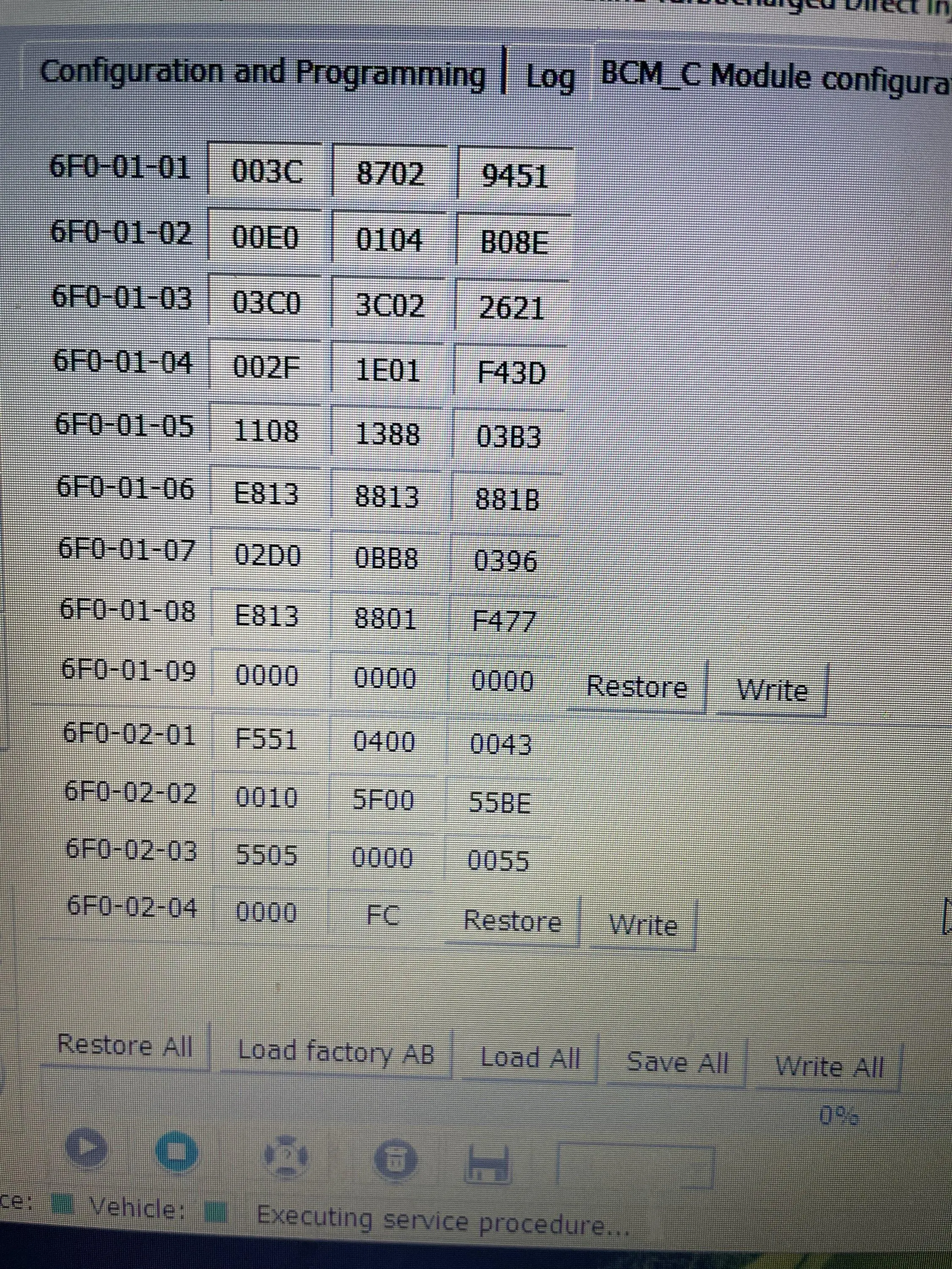

As for BCM_C these are my settings:

@flip - can you see what the difference is between M2DZ-19980-B and N2DZ19980L?
I gotta find someone that can translate those BCM_C modules I posted above for me...
