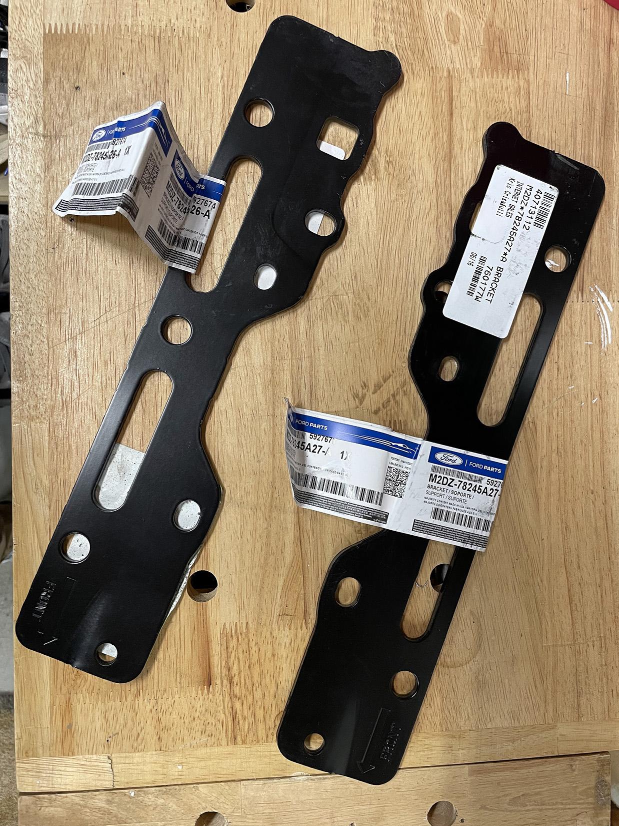

So I just received my brackets from Tascaparts.com. Part#'s are m2dz78245a27a and m2dz78245a26a. I thought they were the "b" parts too but they contacted me to confirm they were "a" parts that fit my VIN. I think I can reuse the bolts for my Bestop Trektop as they would have been replaced by them anyway if I had the bracket to begin with.
Ford Bronco DIY Hard Top prep kit IMG_3442
Ford Bronco DIY Hard Top prep kit IMG_3443
Now just for the install and figure out what bolts/holes are used up there since there is so many haha.
yeah I ordered my brackets and got mine a few days ago and got them installed. I used some bolts I received for my sunshade and they fit perfectly. Super easy to install. All you have to do is line up the holes and just make sure the long flat side goes on the outside of the bronco. The inside of the bracket that isnt straight goes towards the inside. You'll figure it out pretty quick

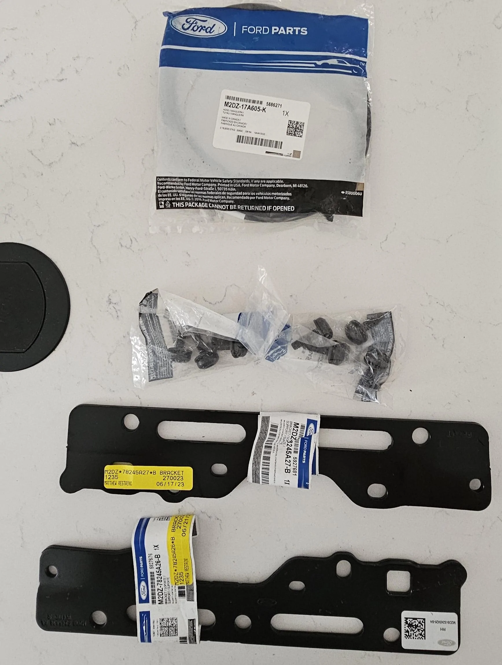

My brackets, bolts, and the last hose just arrived from FedEx. One step closer to having this wrapped up.
Still looking for a hard top to actually test all if this with.
Anyone in the West Palm area willing to assist with donating theirs temporarily in the name of science? 🙂

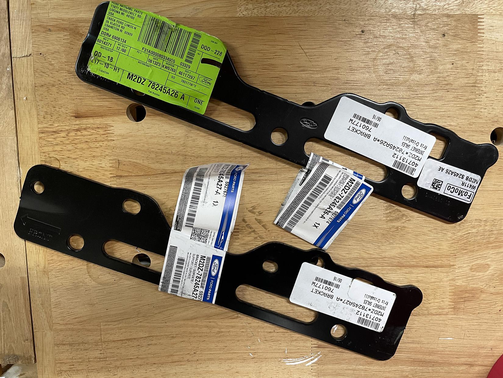

I wonder what the difference is in the "A" part#'s and the "B" part#'s. They look, at least to the eye, as identical.

I've had both brackets in hand (-A and -B) and was unable to see any physical difference between the two. One of the holes may have been slightly more oblong but never got calipers out to check.

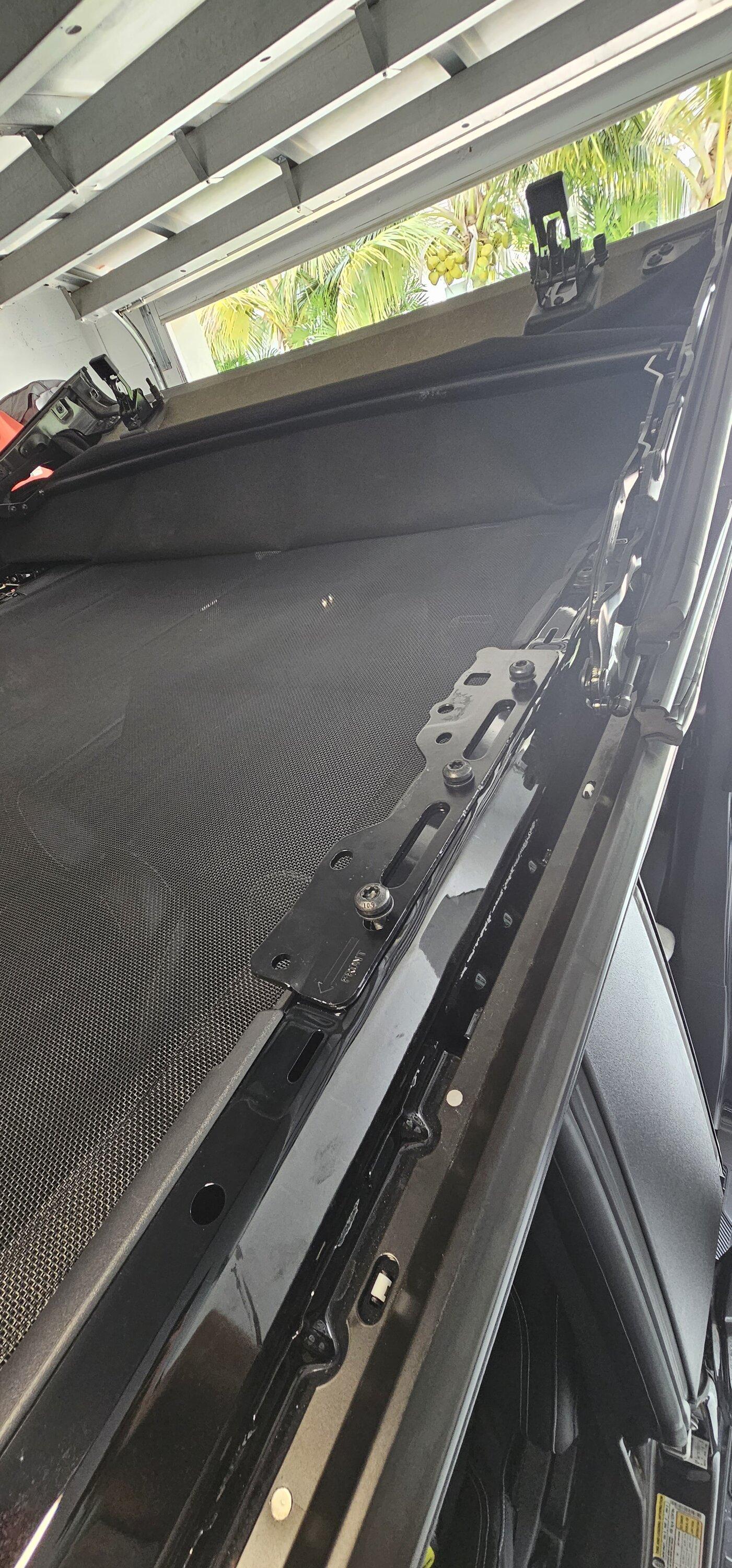

Last of the hoses are all attached and routed, brackets are secured, harness is setup and in place. Now I just need a hard top to determine if the rear wipers, washers, and defrost all work.
I suspect I'll be changing out the HVAC Controls based all your prior findings.
To be continued......
