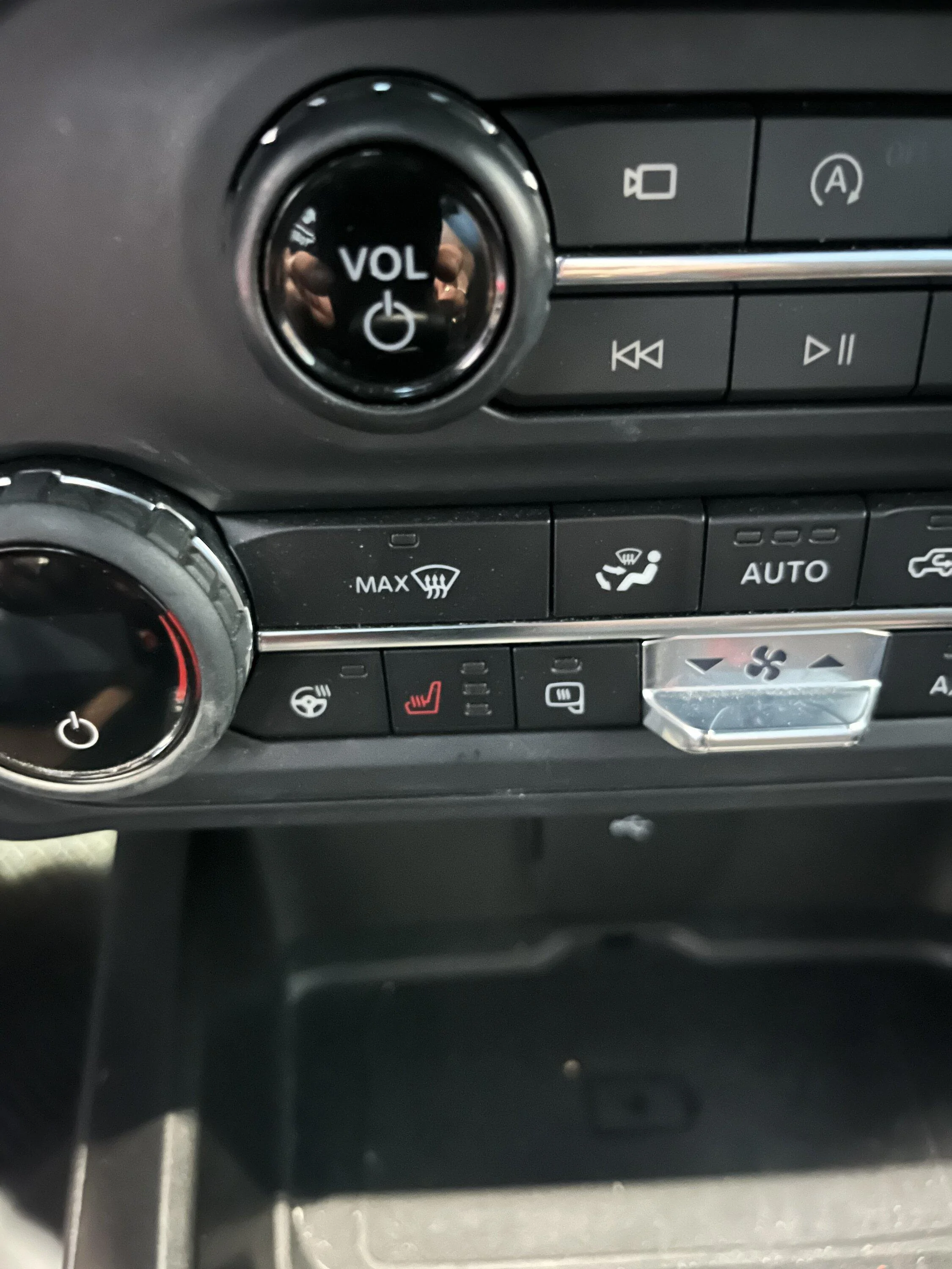

Anderson Composite hard top finally arrived and installed. Also swapped the steering stalk for rear wiper was successful in forscan to enable rear wiper and washer control but no dice on rear defrost. I have heated mirrors and steering wheel but no voltage to the rear defrost grid when buttons are activated. Think the HVAC control needs to be swapped like you said then enabled in forscan.
Does your HVAC have the R on the mirror defrost button?

No. Just and image of the mirror.
Dang. Didn’t realize they made the advance HVAC without it. Jeez. Ford made this more difficult for everyone involved.

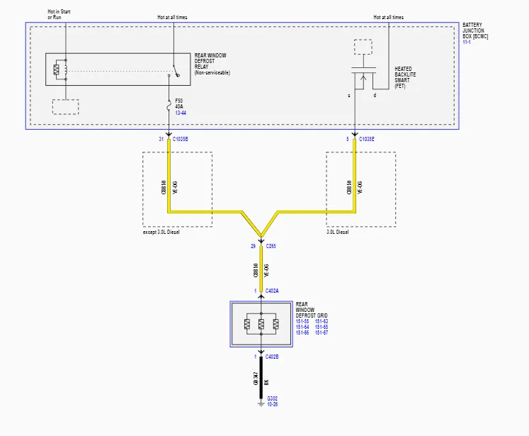

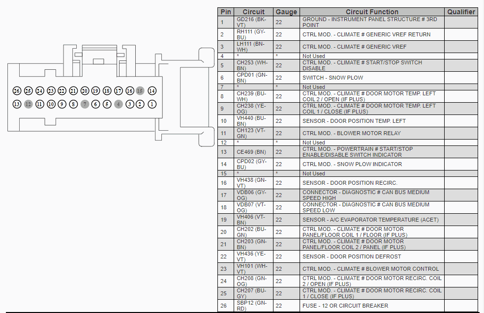

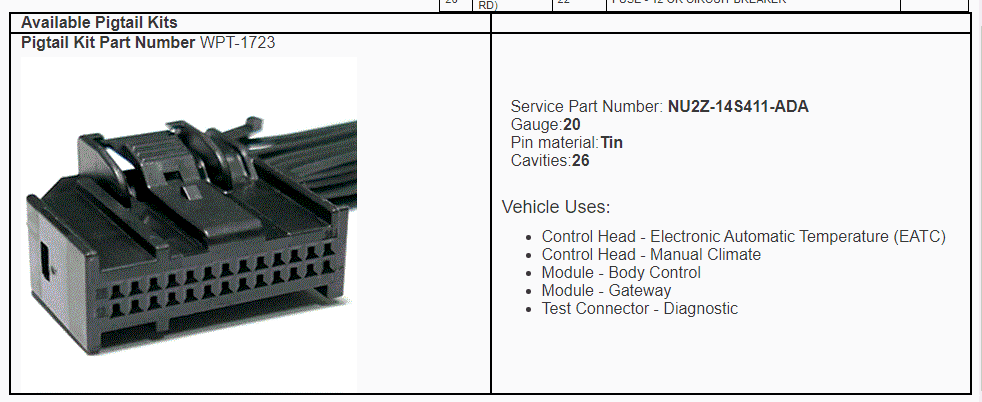

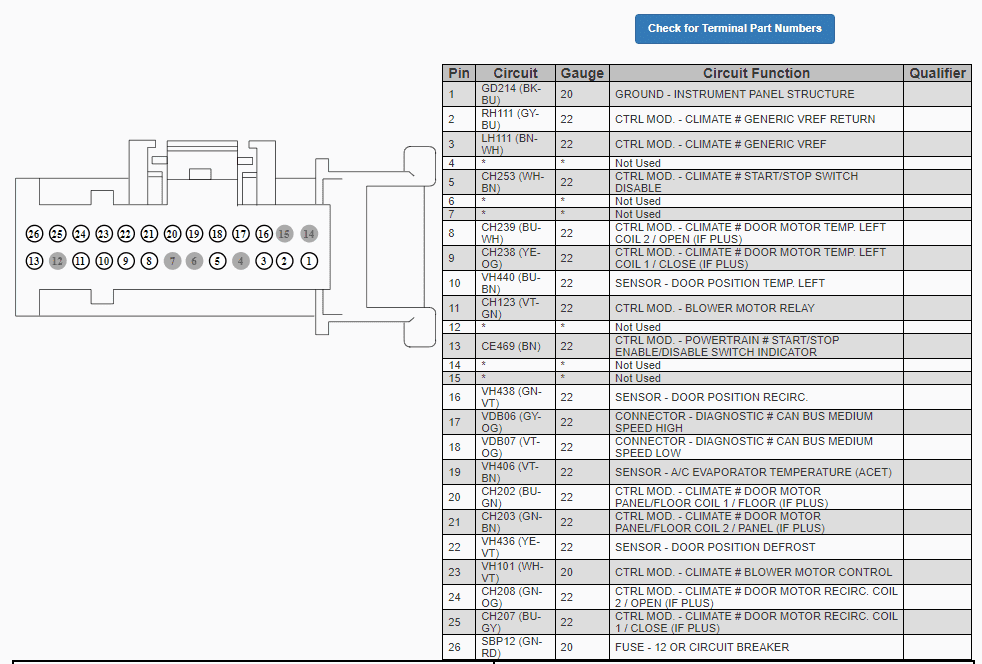

The F150 number you have is an engineering pn which translates to ML3Z-19980-N then supersedes to ML3Z-19980-P. Manual climate control with rear heated window.
It looks like the connectors are the same, CAN network is going to trigger the relay in the battery junction box to provide power.
'21 F150, man. climate control connector and pinout.
'21 Bronco man climate control, connector and pinout.
'21 F150 rear window heater circuits.
'21 Bronco rear window heater circuit.
