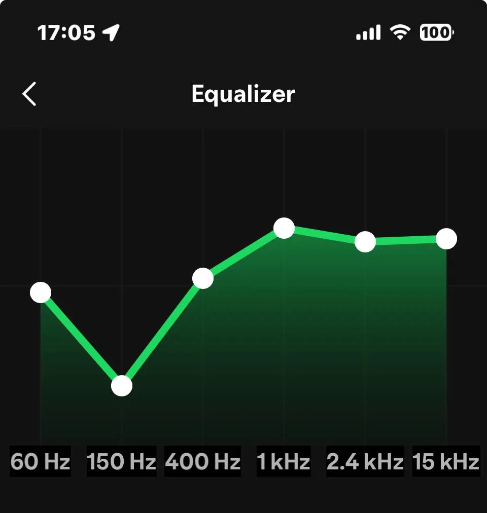

I gotta be honest, I just adjusted my Spotify equalizer and the entire B&O system woke up. Clear thumping bass with the existing BS speaker. I left the 60Hz freq a bit high and turned down the 150 Hz almost all the way.
like this:
Ford Bronco did the kicker sub swap.. not worth it. IMG_0574
Im no audiophile, but it sounds clear and succinct to me, with no rattles or clipping. I don’t know, but it sounds great to me now.

mmm, is that something that can be under with Apple CarPlay stuff and Apple Music?

Apple Music has a lot of pre-configured EQ settings .. found under Settings -> Music -> EQ
That said, I was playing with them the other day and couldn't notice them really change too much. The Spotify EQ had a lot more impact. And unless you are running Apple Music on a PC/Mac, you can't do any adjustment, just use the pre-configured options.
There are apparently also 3rd party EQ apps that work with Apple Music, I haven't tried any of them.
