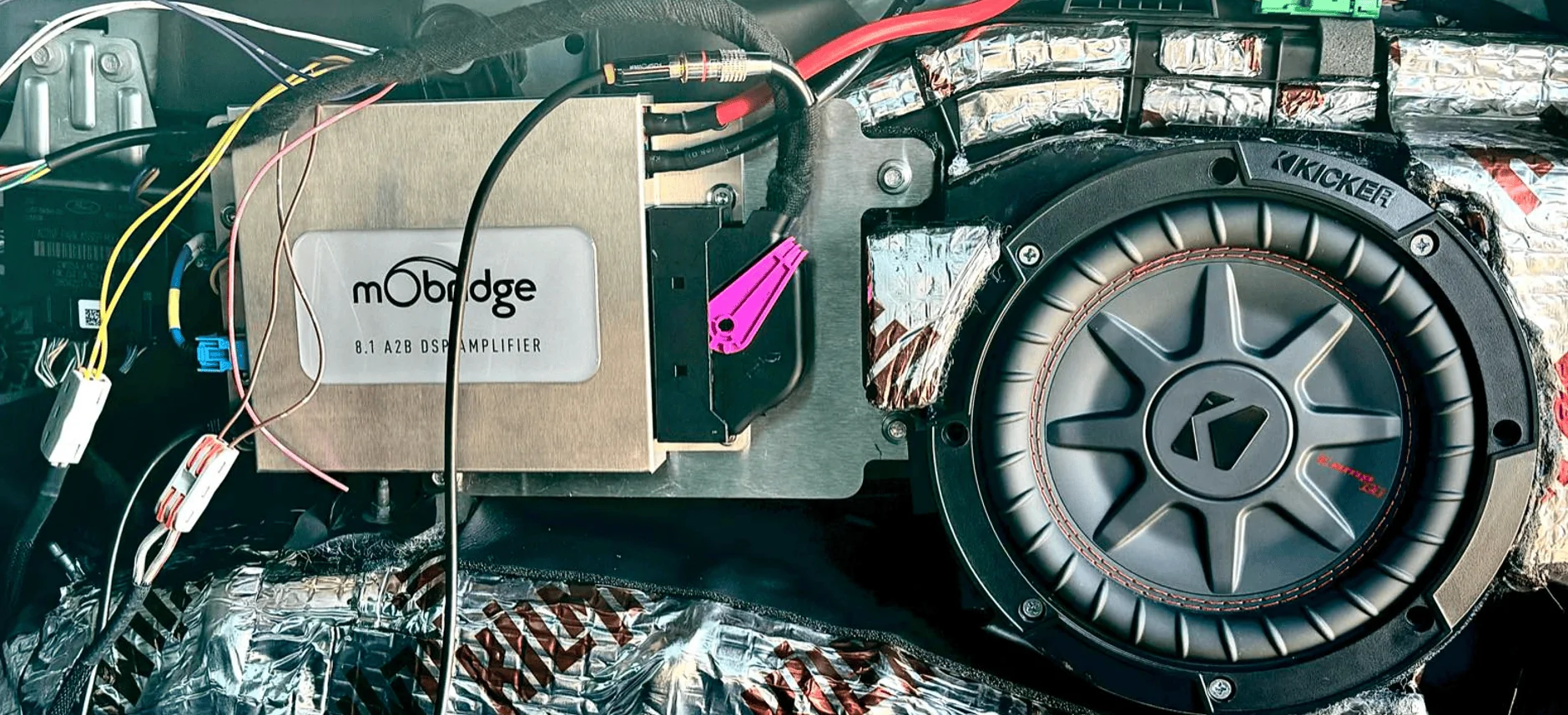

I dremel'd the stock enclosure and fit a Kicker CompR 8'' in the space - but at full power I strongly believe it's over-powered for the available air volume so I'm getting a sympathetic vibration at certain frequencies.
Ordered the Kicker 6.75'' 4ohm version that should come in today and I'm going to swap it out to see if that's the issue.

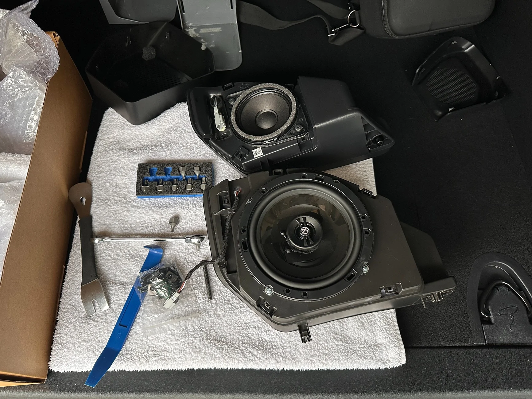

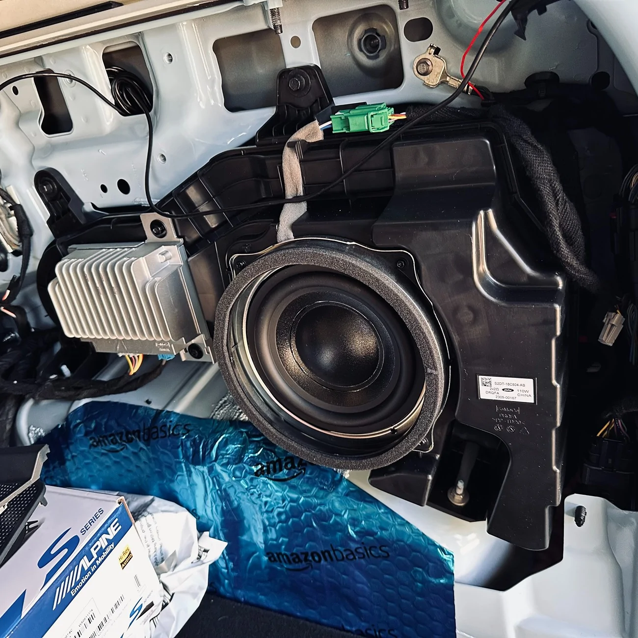

I had every intention of swapping my 6.75" stock woofer for a Kicker 6.75". But I'm also bi-amping the front four speakers with a Kicker 200.4, and I already added coaxial Memphis 6.75" speakers to the back, with larger pods.
BTW, the stock woofer for a 2025 Heritage (7 speaker setup) is 110W, 2 Ohm and is run in parallel (2+ 2- connectoins) for 1 Ohm total. The speaker itself sounds great, looks great, and is pretty much the same weight as the Kicker. If I upgrade, it will be to something mounted on the tailgate, and I want to see if there's a difference after Forscan. Anything larger than a 6.75" mounted in the stock location needs to go through a 6.75" plastic vent. I can't square that circle.
Last, once the front speakers are set up, Forscan is run (you can see the numbers below), and the Memphis coaxials are set up, I'll have a better idea of how much woofer I'll need.
