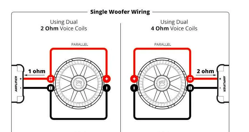

I've got a 2025 Heritage with the 7 speaker setup, and apparently the sub amp is more powerful. That probably means 150W instead of 110W.
If I use the stock location and stock amp is 6.75" or 8" recommended? I don't mind trimming. Also, it looks like the OEM subwoofer is 2ohm, wired like below.
Do I go 2 ohm for the 6.75" or the 8"?
Thanks in advance.
