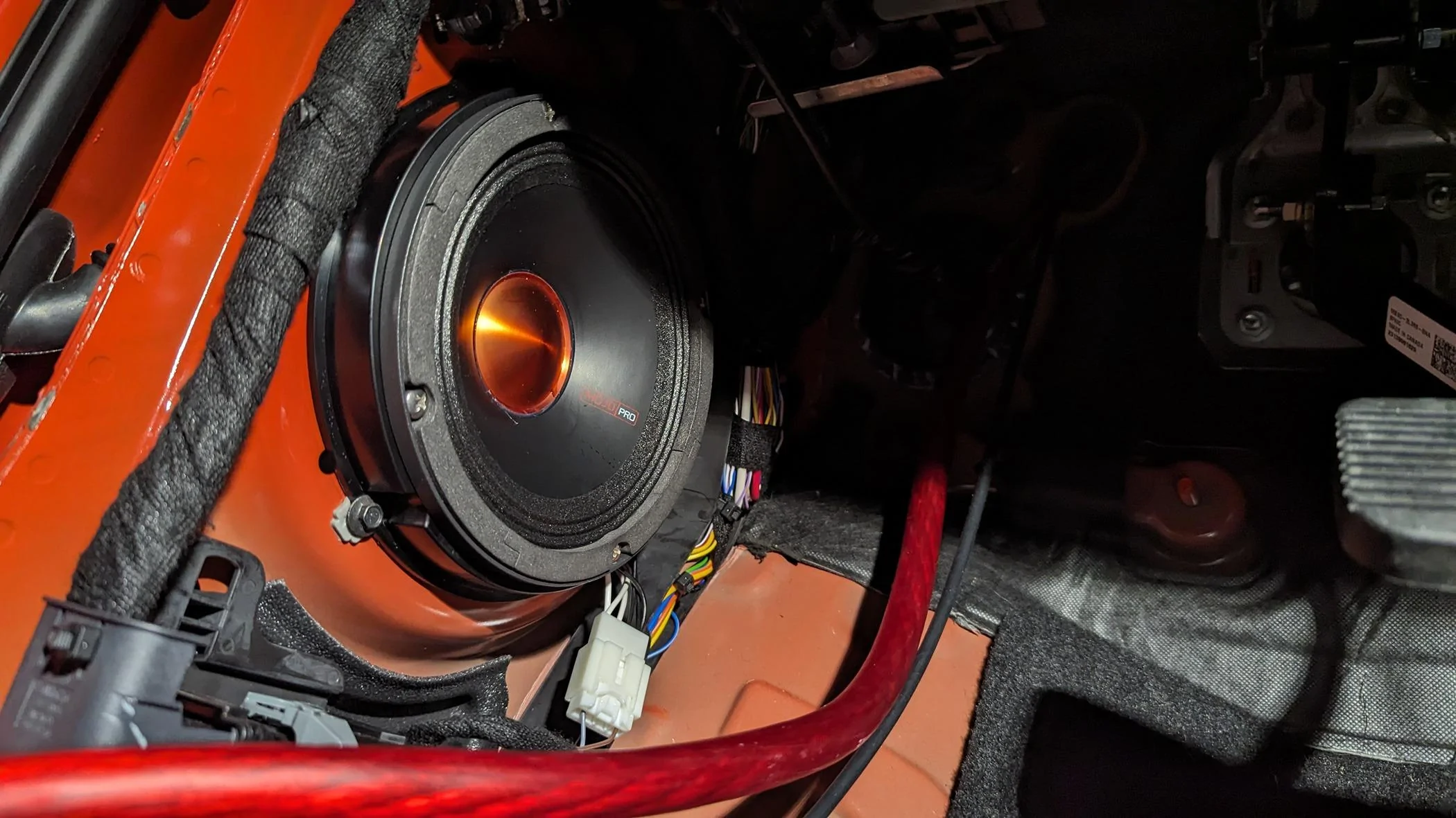

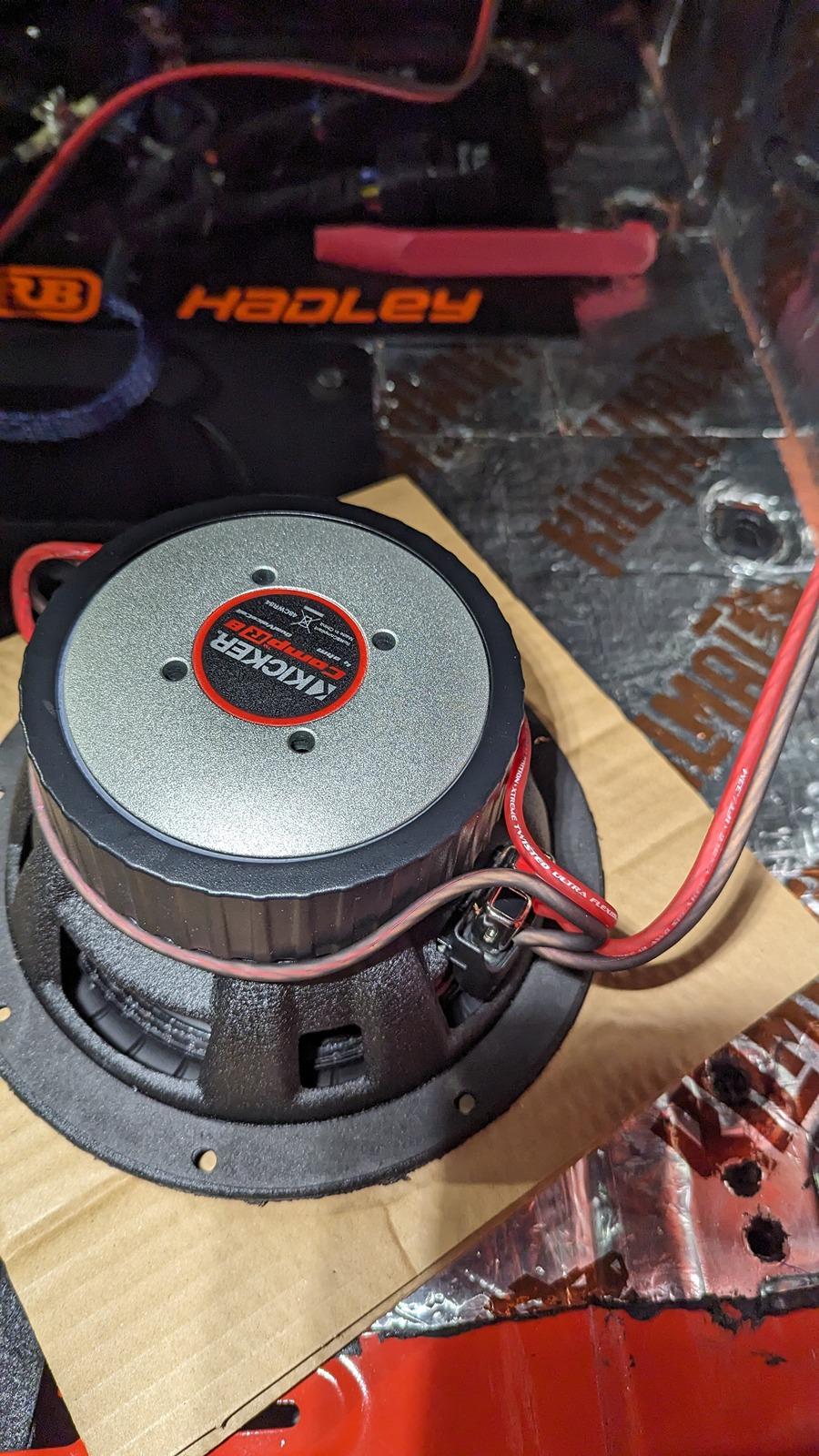

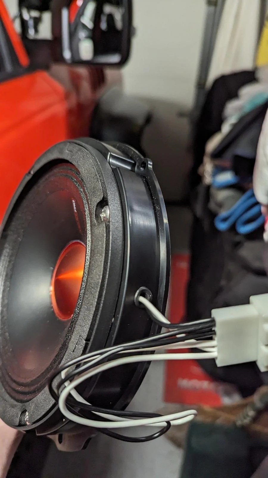

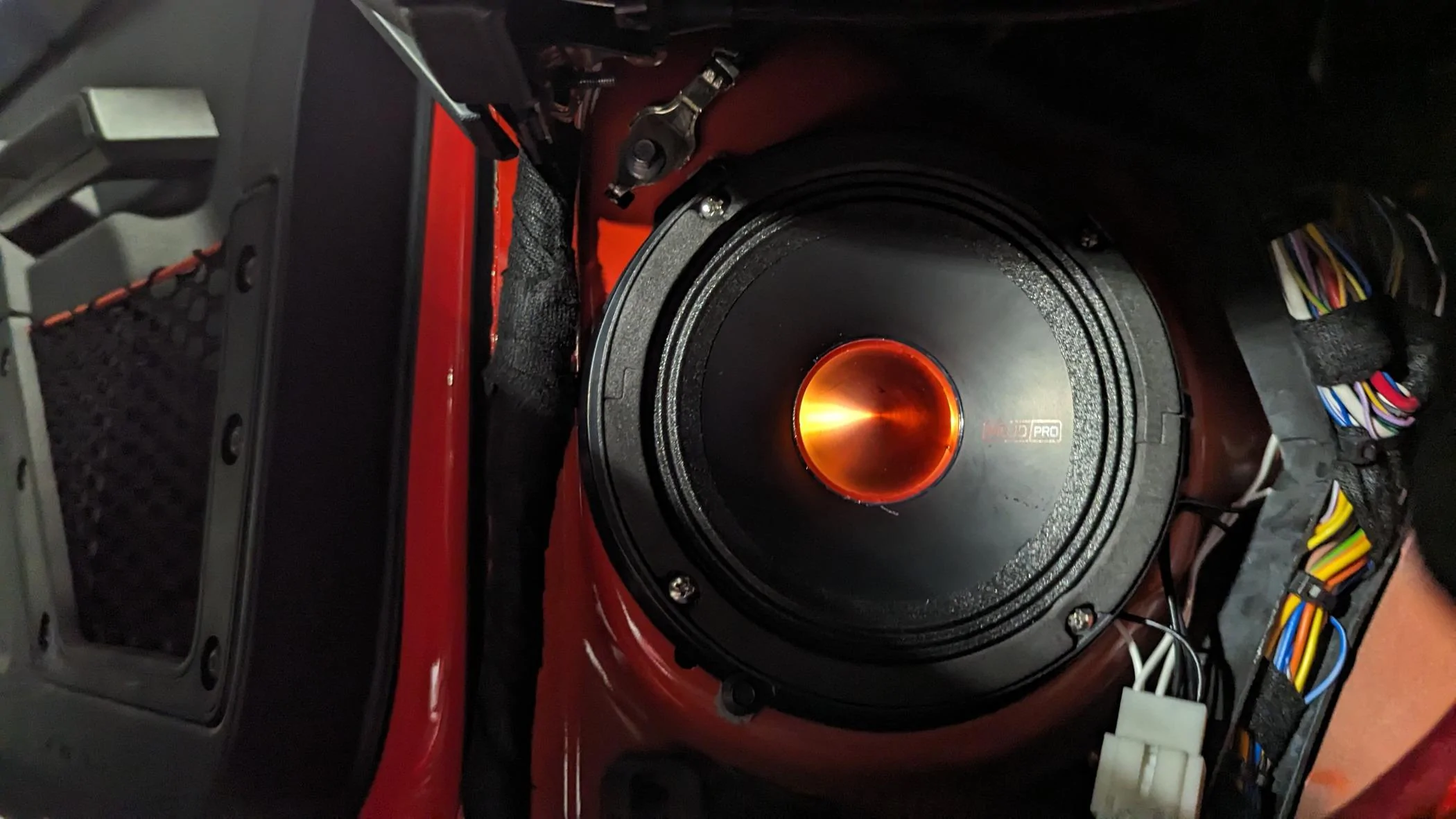

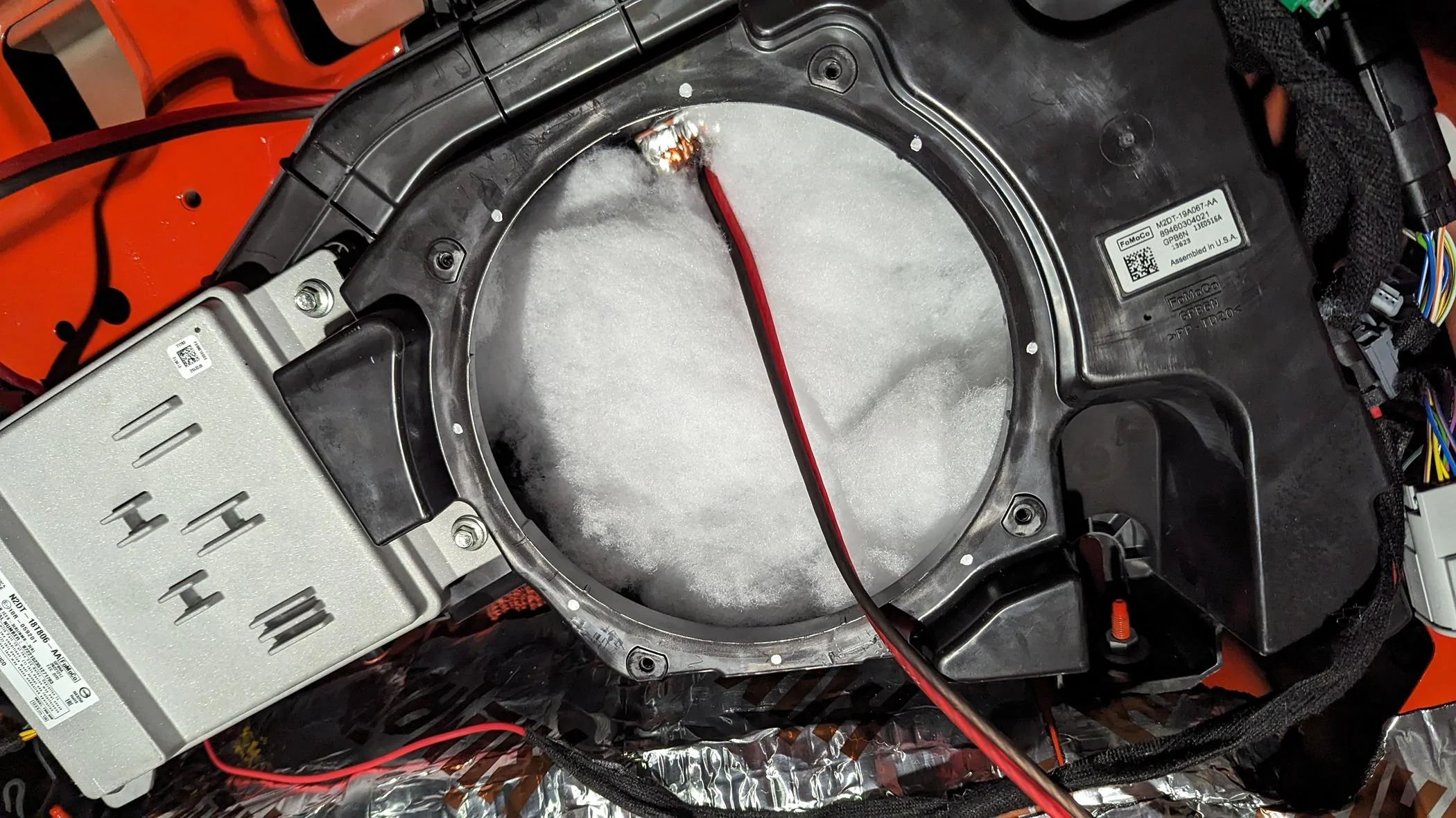

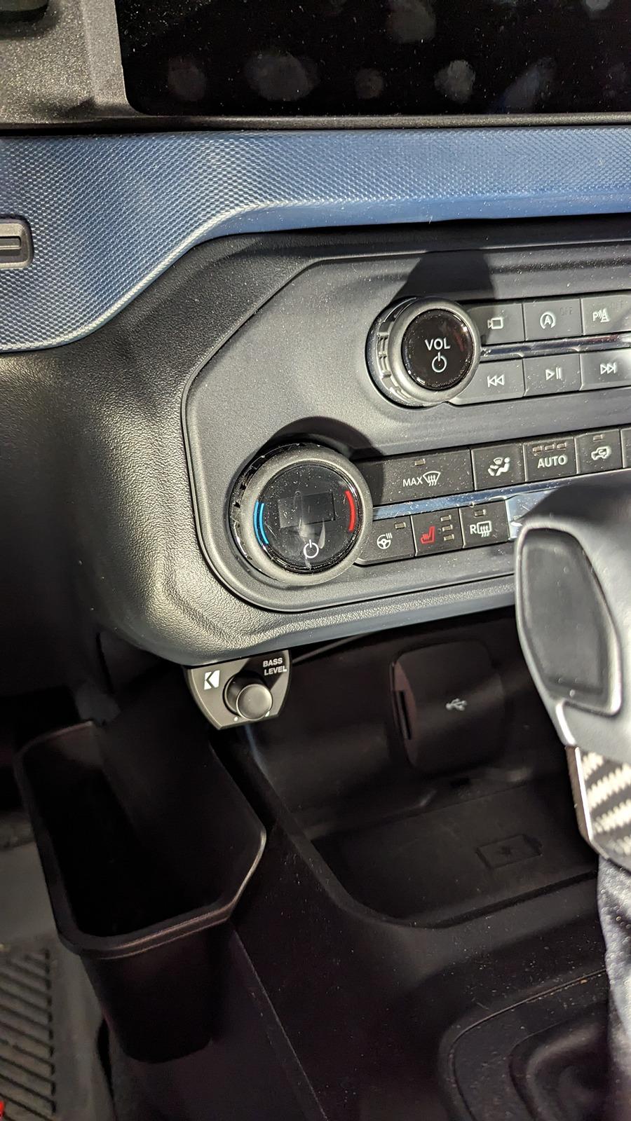

Yeah the plug & play kit for just a sub is a bit unnecessary. I did mine myself, but I've been doing car stereo stuff as a hobby since I was 16 - over the years I've learned a few things and overall I am really happy with my system now. Replaced all speakers and added an amp to the sub.
