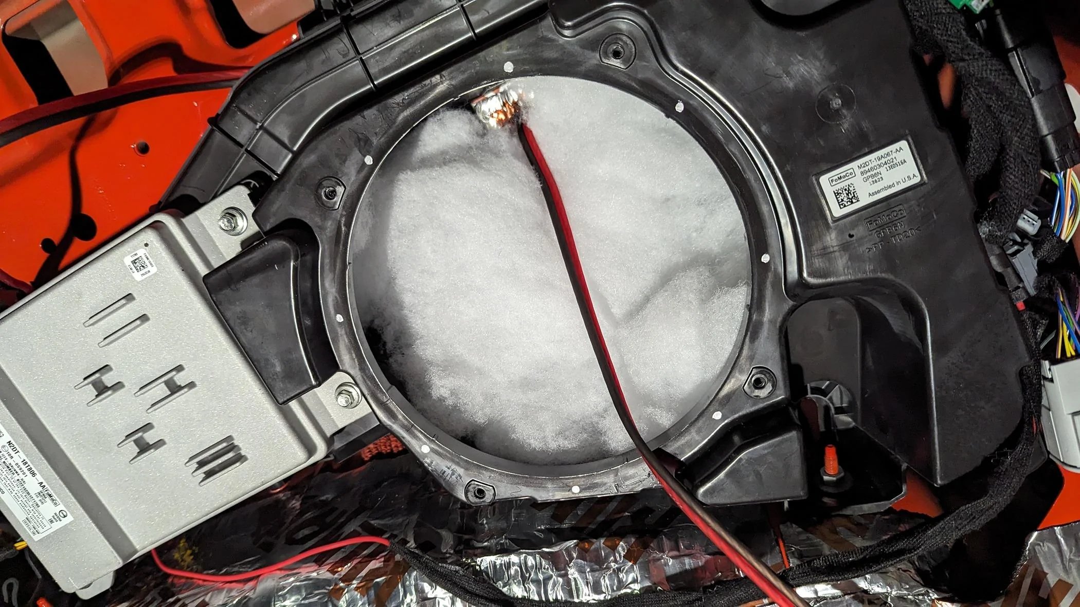

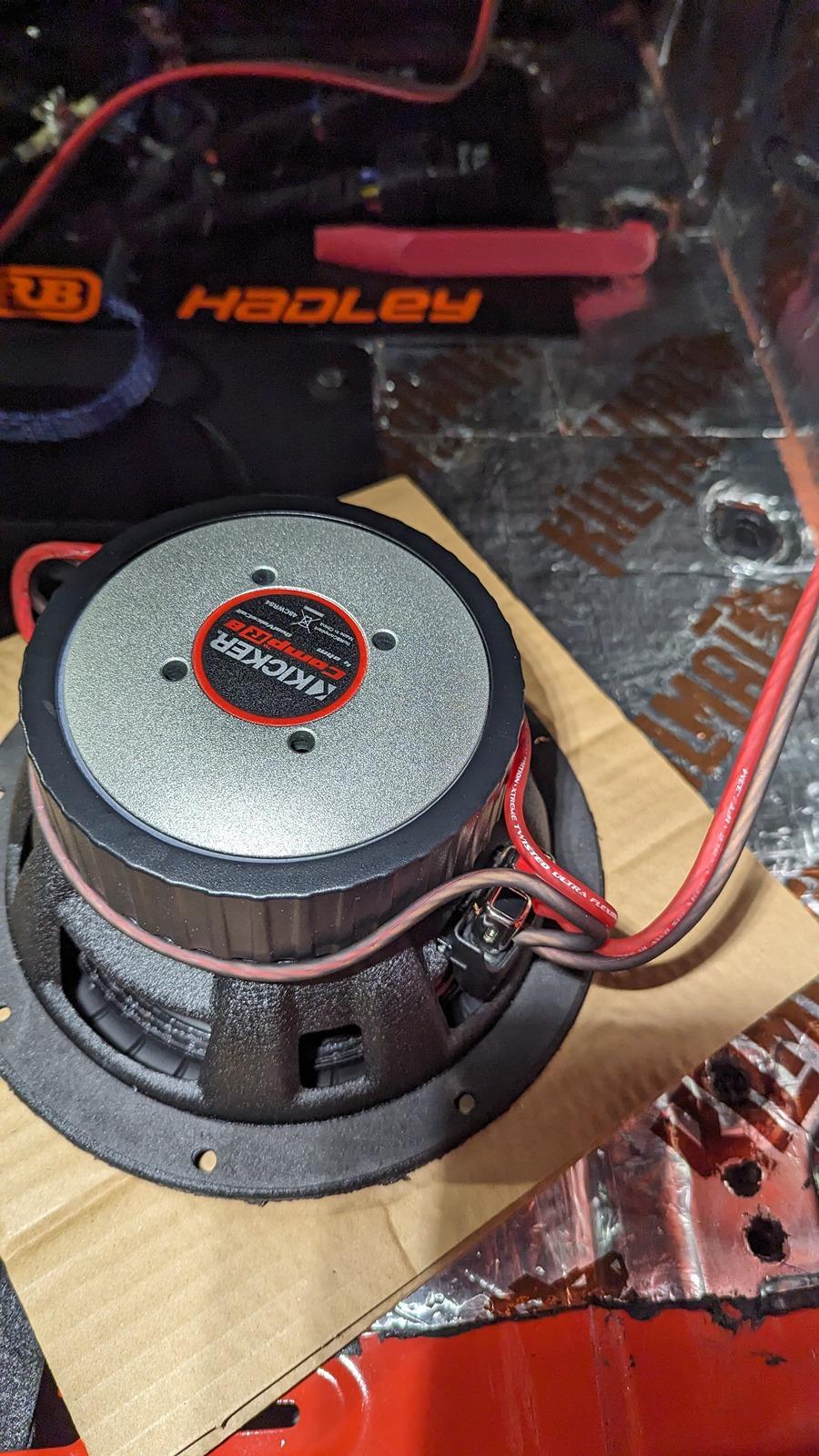

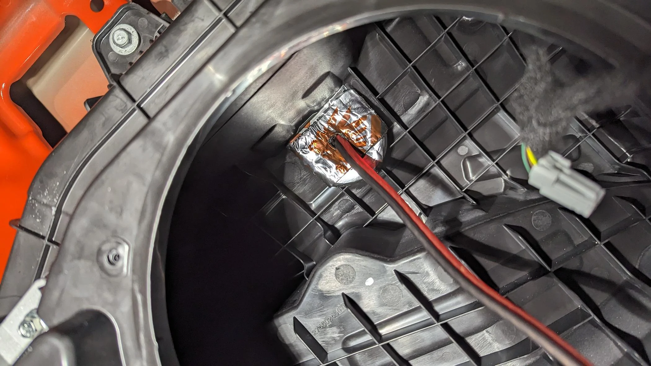

The tab is on the bottom face of the enclosure, it is about an inch long and maybe the thickness of a credit card. You will notice it when you rest the sub in the opening as it causes the wumb not to sit flush. The opening itself is the right size. The beauty ring can be removed by wedging a screwdriver between the metal basket of the sub and the plastic ring that says KICKER. I kept the sub resting face down on the cardboard packing while I pried the plastic ring apart in pieces, eventually it loosens the entire ring.
Ford Bronco B&O Factory Subwoofer Replacement Help PXL_20240309_024739671
Ford Bronco B&O Factory Subwoofer Replacement Help PXL_20240309_022545623
Ford Bronco B&O Factory Subwoofer Replacement Help PXL_20240309_022553476

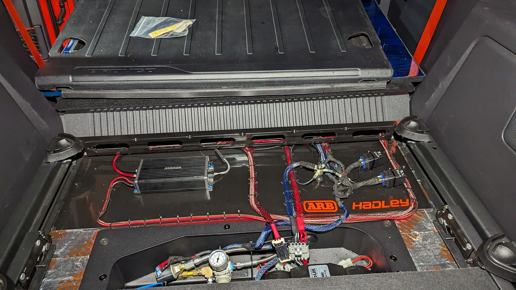

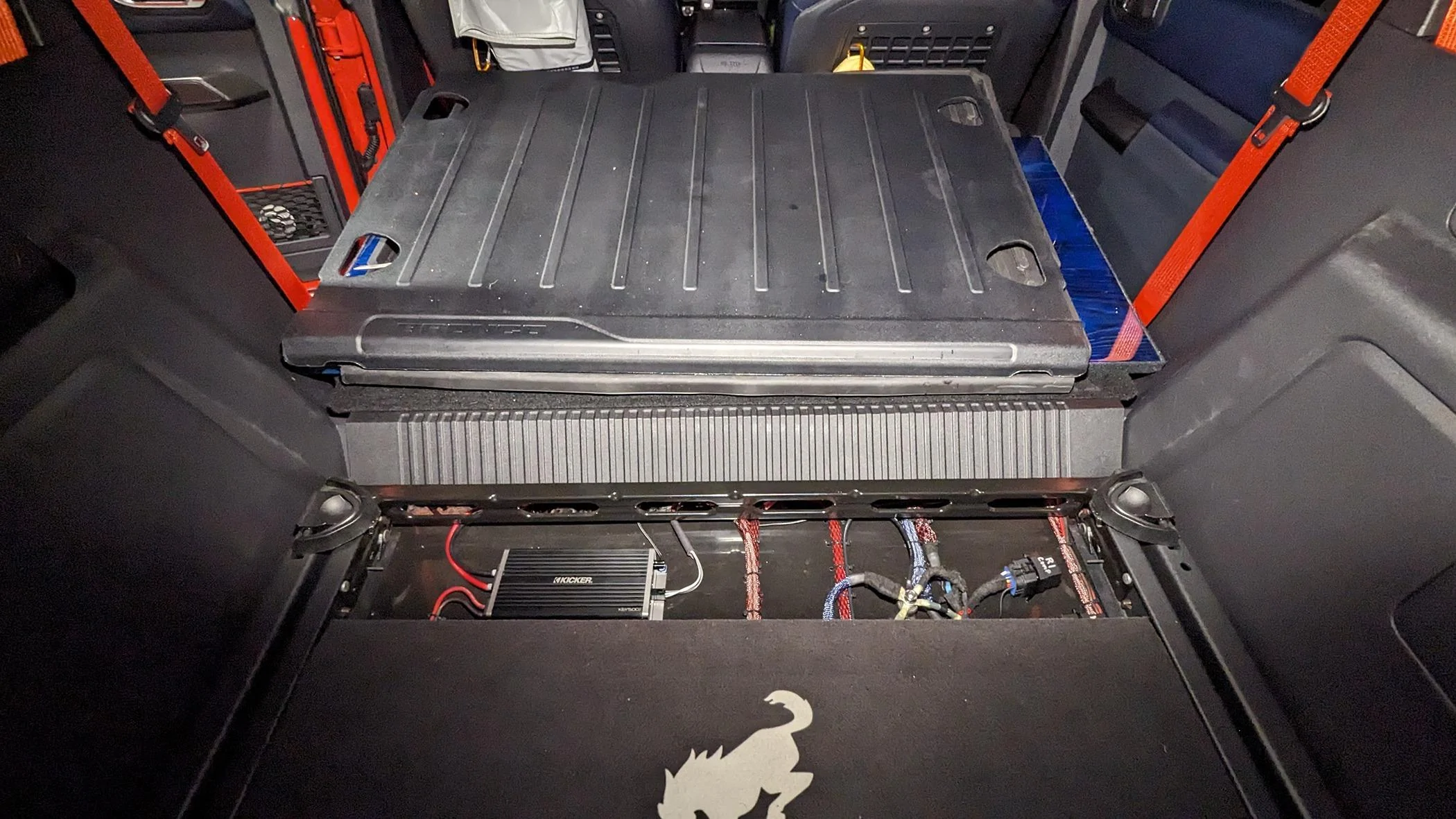

I kept the existing B&O amp, replaced with better higher efficiency speakers and added the Key 500.1 only for the Sub and ran that off the sub line level outputs. The only indication of anything beyond stock is the remote volume knob for the sub. My slide out tailgate hides my amp and onboard air.
Ford Bronco B&O Factory Subwoofer Replacement Help PXL_20240311_011040910
Ford Bronco B&O Factory Subwoofer Replacement Help PXL_20240311_011109846
Ford Bronco B&O Factory Subwoofer Replacement Help PXL_20240311_010621759
