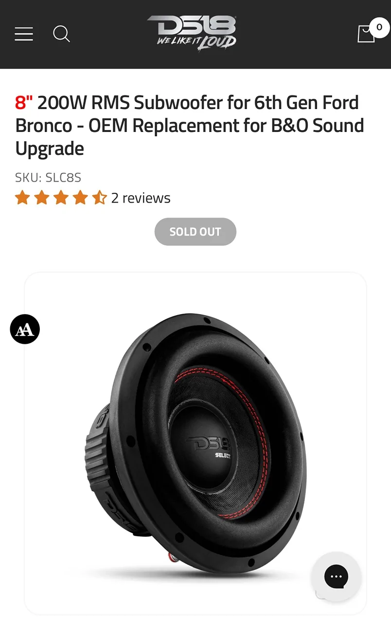

It’s working great. I bought a DS18 ‘drop in’ sub and did end up bridging the 2 channels into the single channel on this sub. I then tested it for several days making sure the amp didn’t overheat or cut off. This sub was definitely an improvement over the factory sub. I wasn’t looking for earth shaking bass and am satisfied with it. The sub cost around $80. I believe they do offer a dual channel sub now. This is the one I have.

Safe to say the B&O sub channels can be safely bridged then? Have you tun it at above 20 for 30min plus with no smoke? Haha

Correct. As I said, I tested the amp for days before reassembling the panels. No smoke, no overheating and no distortion. Works fine.

Thanks! That opens up a lot of 8" options!

So based on this, it seems like we could use a DVC 4ohm or a SVC 4ohm (combine inputs) sub.

Yes, correct. As long as 4 ohms is maintained, the amp won’t suffer.
