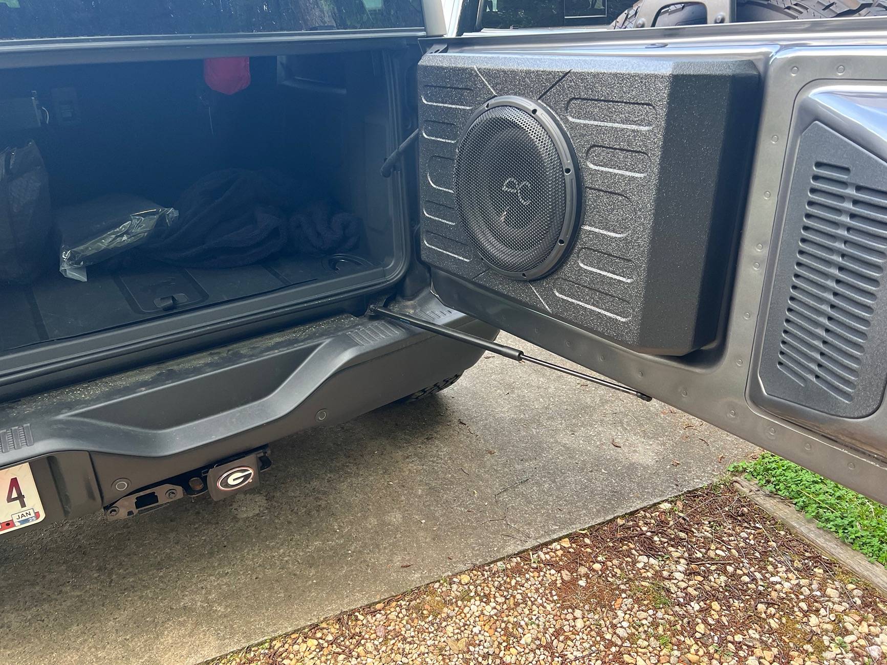

I went a whole different route, mainly cause I already had plenty of audio equipment. I mounted a box to my tailgate with a shallow mount JL 13tw5 that I took out of the stealthbox I had in my jeep. I have a JL hd900/5 amp and an audio control LC7i. I used Fosgate 6.5 components up front and 4 in the rear. It will rattle your teeth with no problem. With the top off at 70mph and volume at 17 its just as clean and clear as low volume with the top on.

I used that kicker key 500.1 with a tailgate box. It booms, but not enough to wake the neighbors. I’m plenty happy, and relatively small footprint into the rear cargo area.
