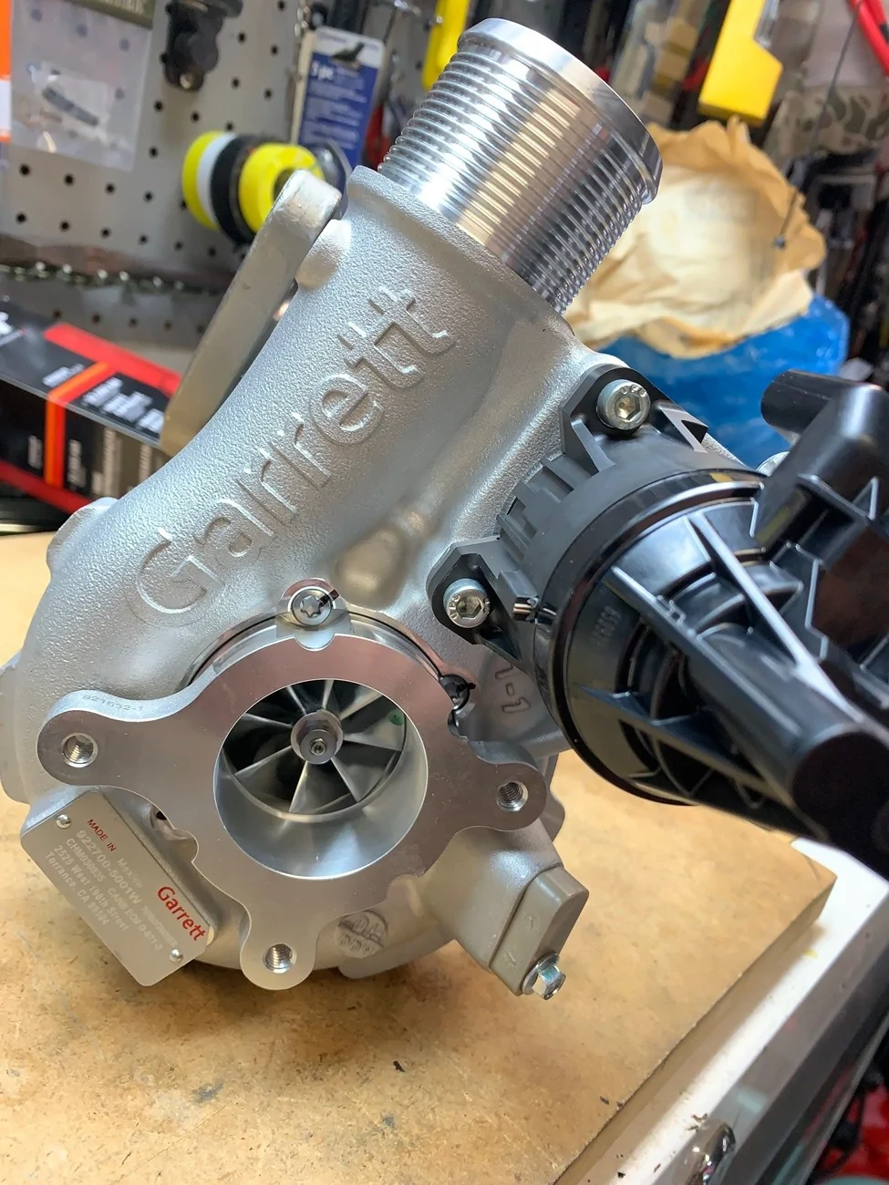

Awesome! How do they feel compared to the stock turbos?
It's like a two-stroke dirt bike when it comes on the pipe.....IYKYK!
Seriously, I can now say I don't need or want anymore power. It's almost scary how fast it is. You can definitely out run the suspension's capability on the road.
