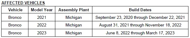

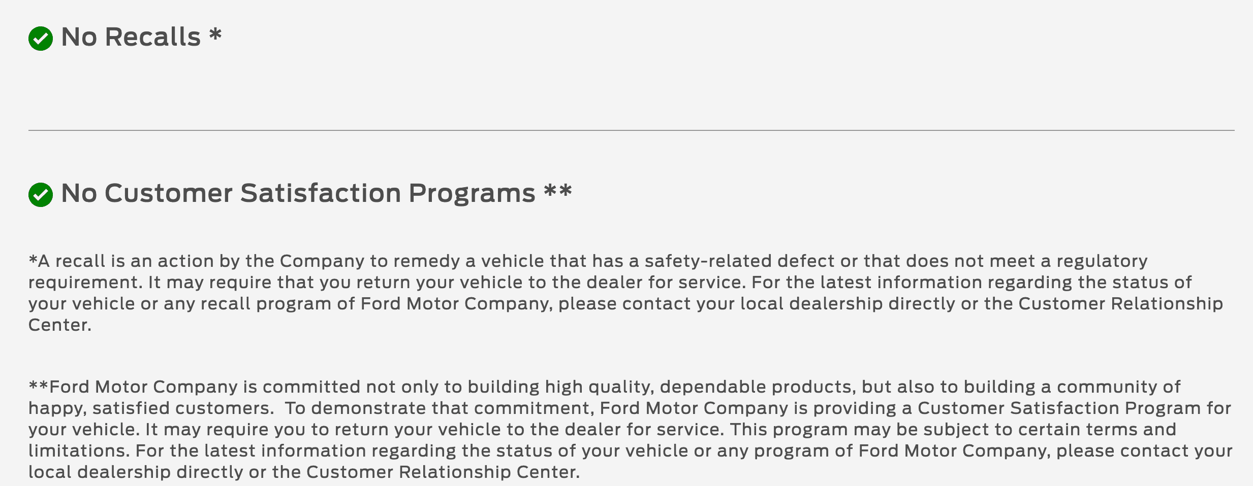

Does this mean mine's not affected by this issue?
Build date: 2023 June
Doesn’t appear to be affected. The build date on the program only goes up until March of 2023

What I am confused about and truly curious is the sporadic production dates of the recall/repair.... I fully understand that there may have been a software or hardware change at a specific time.... where all vehicles would be on the list either prior to or after that date.... but his list is on again off again... were there two wiper motor subs that supplied half a year each???
How would the time of the year (production) change the wiper configuration file???? OR.... the hardware (ie motor) that required a different config file?
Yeah I can’t explain that at all. It is very interesting though.

I am in a similar boat I am guessing.... I am not in the effected dates but I only have 1200 miles and have not driven in the rain.... Not my daily.... It just seems odd though.... could have even been the sping manufacturer changed every 6 months or so.... Just seems odd.
My 22 isn’t in the build dates listed and has also never had this issue at all 🤷‍♂️
How are you not in the range? Your sig shows a 1/11/22 build date which falls in the MY22 listing? Appears that every Bronco built other than those after March 17, 2023 are included??
Oh I read it wrong. I thought that first date said August 31 2022.
I just ran my VIN in Oasis, and it does show up for mine. But still have never experienced the issue.

These build dates don't even make any sense to begin with. They weren't building 2022's in August of 2021....? 2022 production didn't start until the end of December 2021
