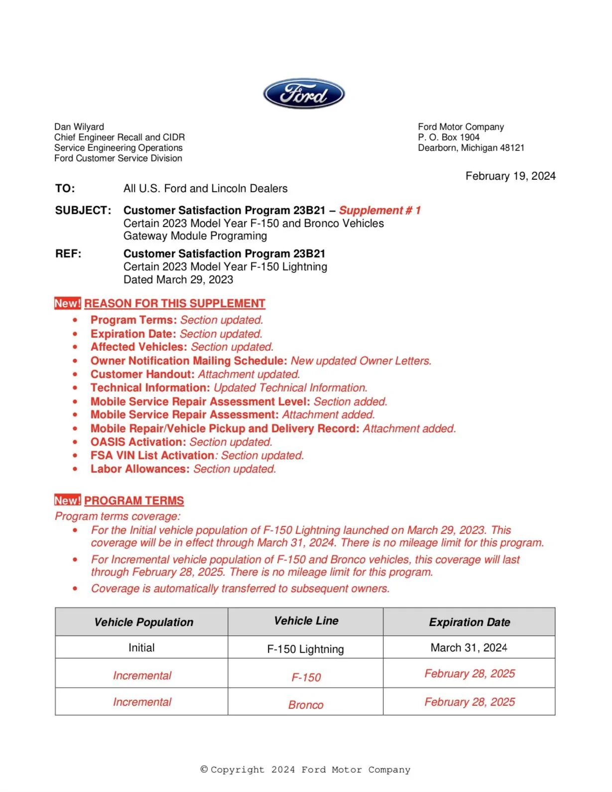

Anyone know what this is? Just popped up when I looked up on the VIN on my Bronco on Ford's website to see if there were any recalls. No further explanation provided.

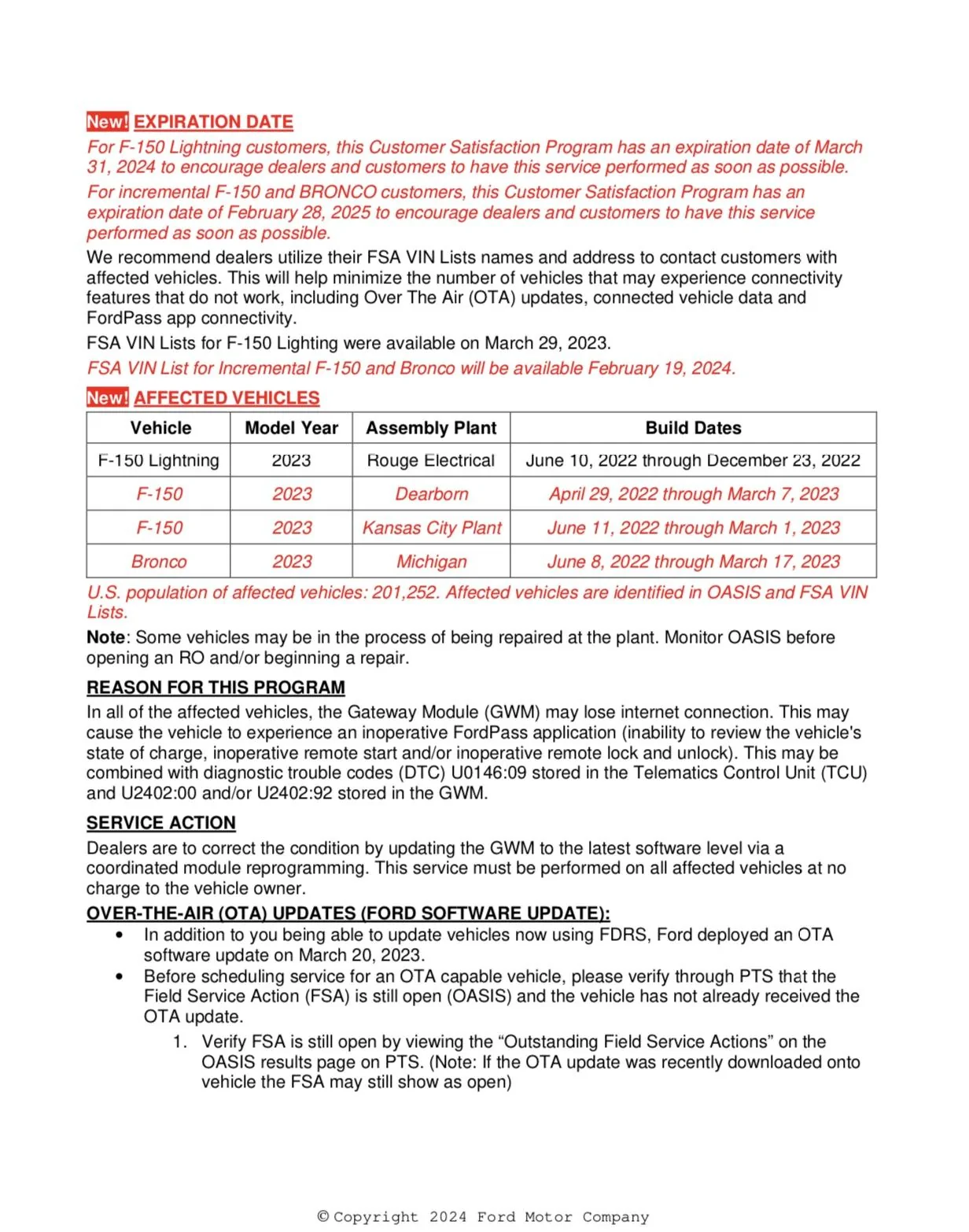

This is probably the root cause for a lot of OTA updates taking forever.
