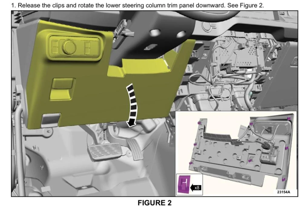

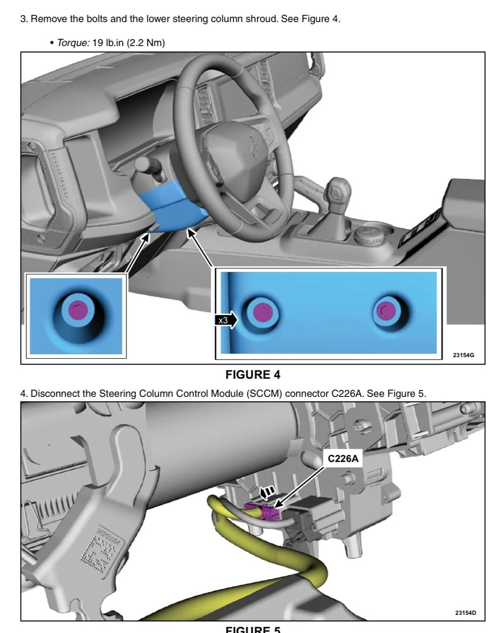

@Ducati1098 do you happen to know what area of the vehicle a tech would need to access to plug in with this flash box? Under the hood? ODB2 port, or somewhere else under the dash? Only asking b/c if it is under steering column I need to clean up some wiring from a couple installs before I bring it in....
It’s under the steering column shrouds. So the steering column trim needs to come off, then the shrouds around the column behind the steering wheel.
Ford Bronco Customer Satisfaction Program 23B35 -- 2021-2023 Bronco windshield wiper motor software update IMG_2305
Ford Bronco Customer Satisfaction Program 23B35 -- 2021-2023 Bronco windshield wiper motor software update IMG_2306
Three screws with a power driver and one plug. If you can't get this done in 5 minutes they should take your Snap-On box away. :)
