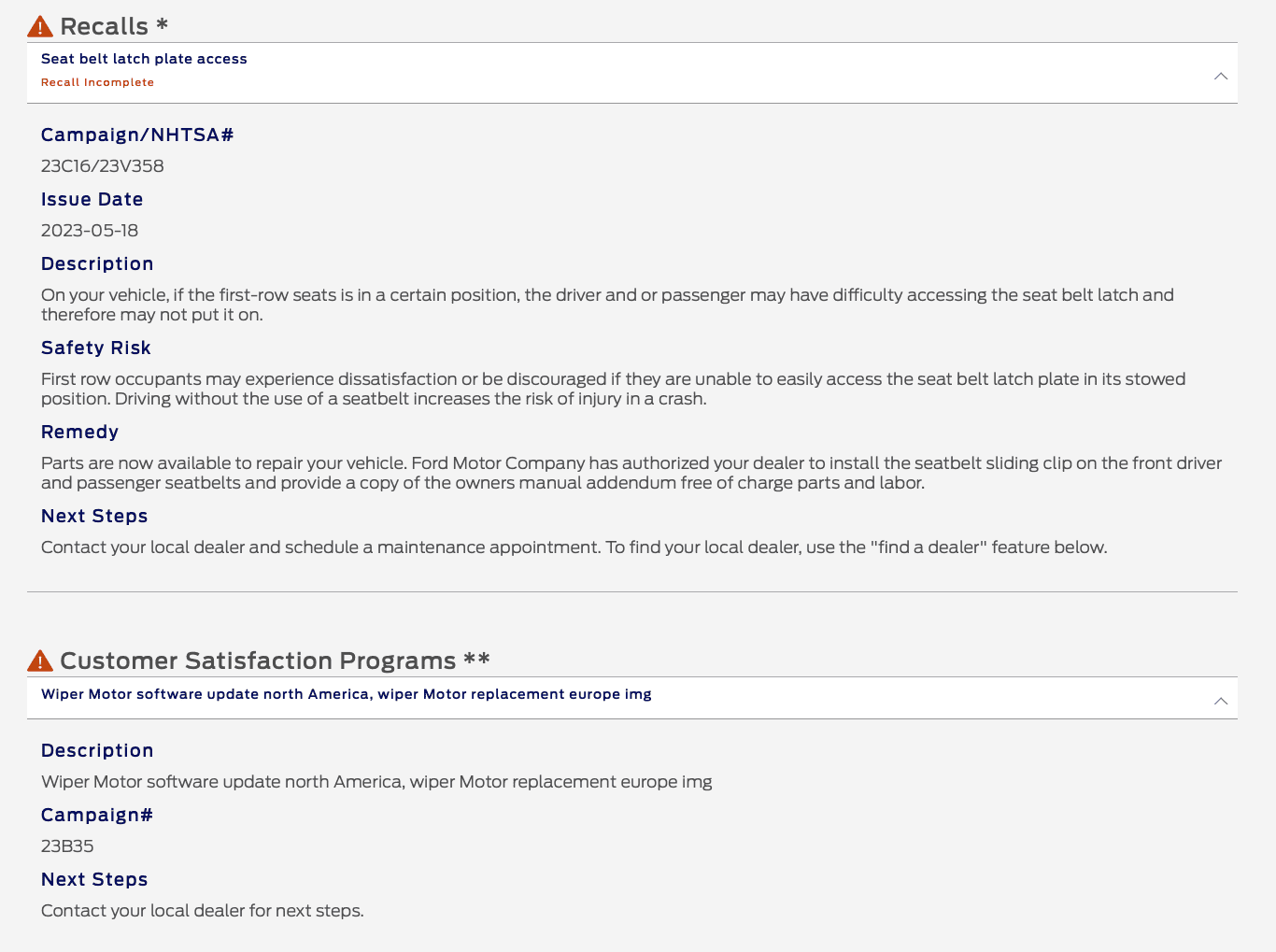

Windshield Wiper Motor
The windshield wiper motor is a smart motor that receives mode requests from the SCCM through a LIN . The windshield wiper motor continuously monitors the wiper/washer switch inputs from the SCCM when the ignition is on. Based on the wiper/washer switch inputs from the SCCM , the windshield wiper motors activates to achieve the requested mode.
The windshield wiper motor may have the ability to reduce wiper speed if it detects higher than expected physical resistance on the motor caused by a dry windshield or physical obstructions such as ice or binding wiper linkages. When this occurs, the SCCMPID values will remain unchanged. Clearing the obstructions or wetting the windshield and switching the SCCM OFF then ON again, will reset this condition.

Ford will be sending letters to owners. Dealerships can also already see affected vehicles and should be performing the update.

Remove lower steering shroud, update wiper motor software with flash box, reassemble shrouds, and use FDRS to clear codes 23B35C 0.3 Hours
it take me longer than that just to get FDRS functionality working right...ROFL
