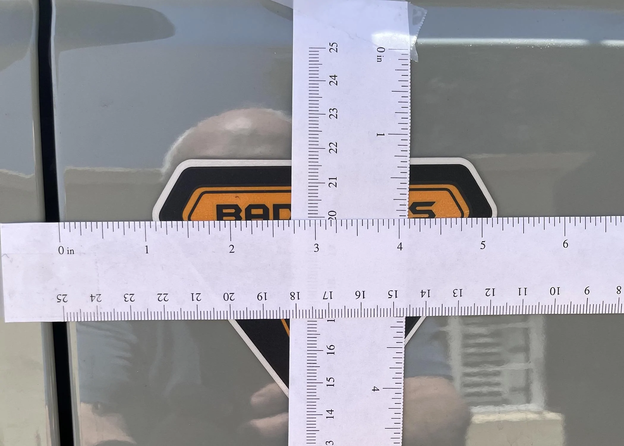

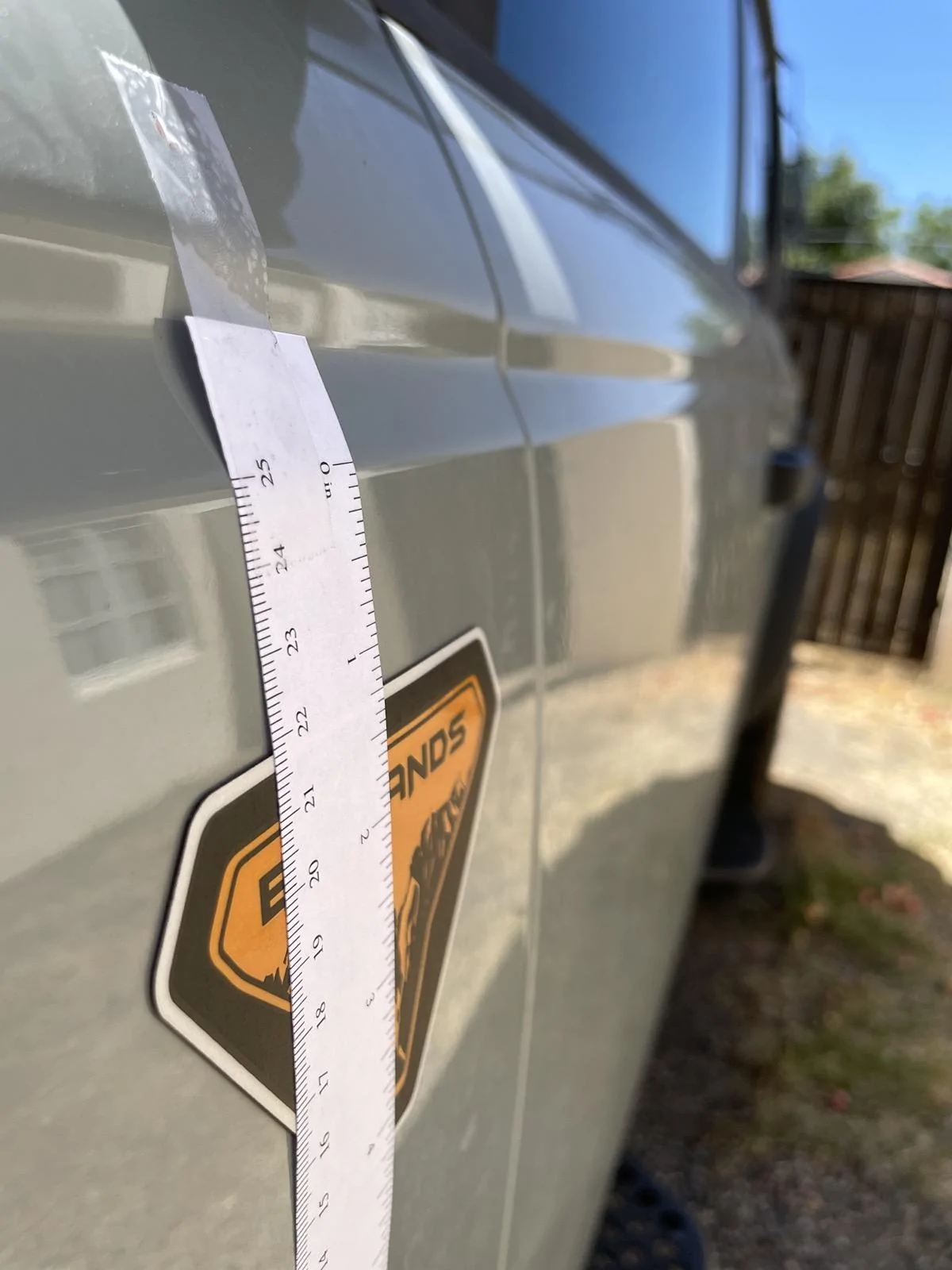

Took pictures of mine. Ruler is accurate.
Great! this is what i needed. Is the up and down ruler on the body line at 0?

The ruler is taped flat to the fender. The 0 on the up and down ruler is where the crease flattens out. In other words, the fender is flat at that point. The photo doesn't show the contour very well but I thought you might ask.
I might be able to get a better picture when the sun is at a better position or if I take the picture from a different angle. I'll give it a try later today.

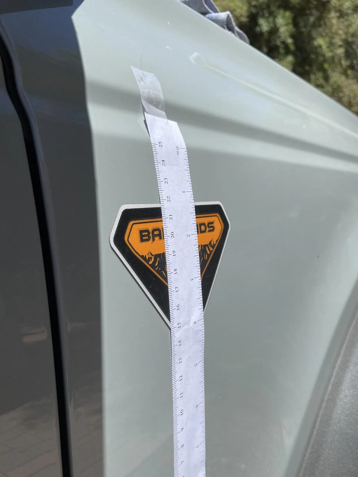

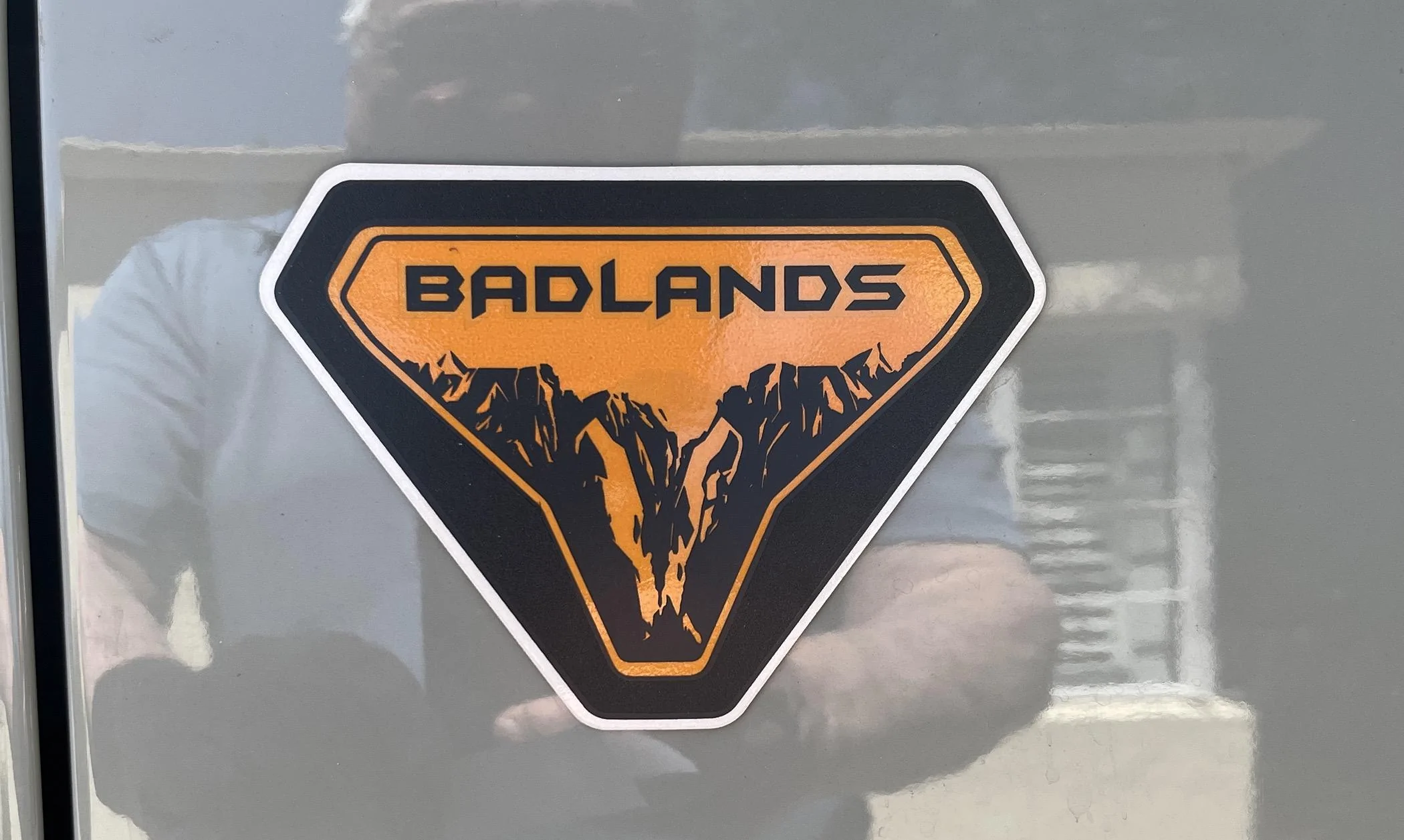

I compared both sides. There's roughly a 1/16 difference in how the left and right decal locations.
The left decal is about 3/32 farther forward than the right. The photos show the difference in height.
