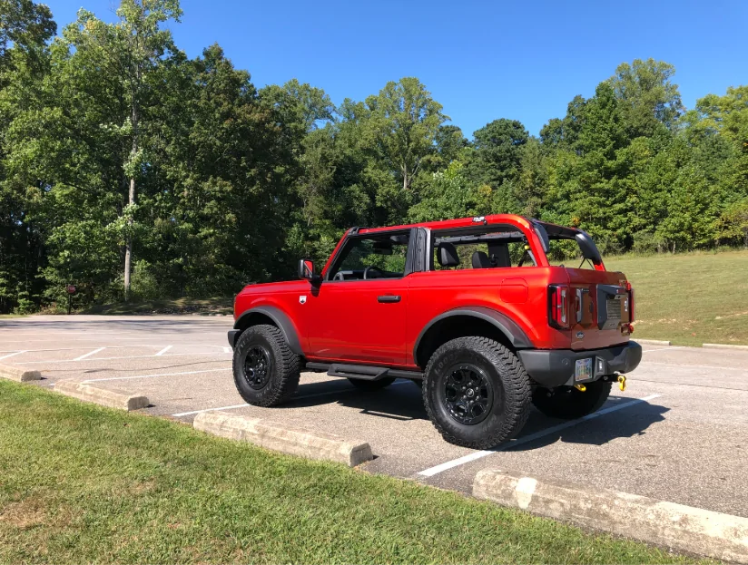

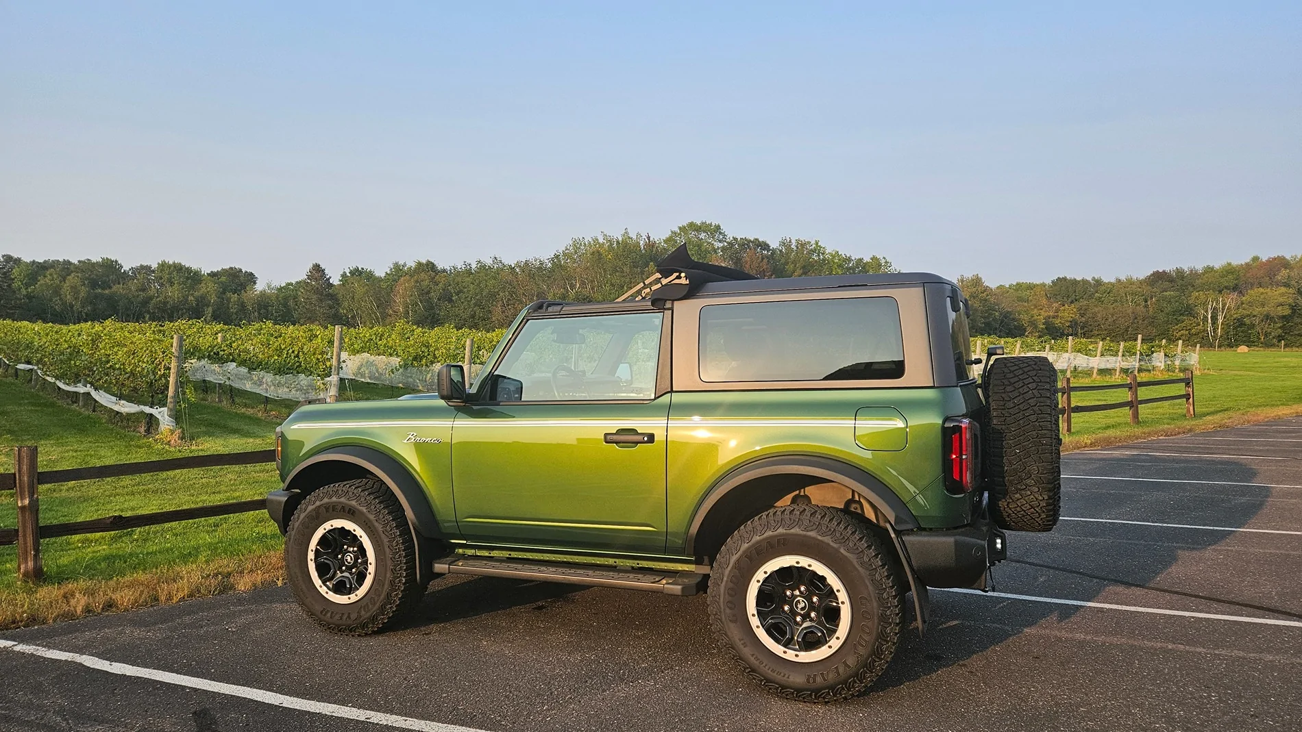

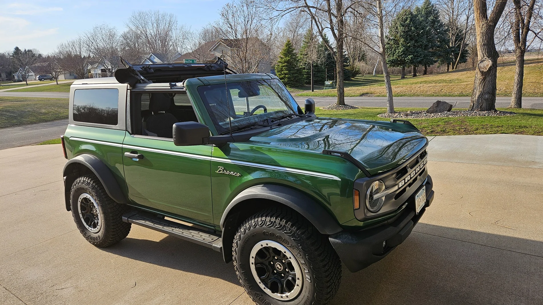

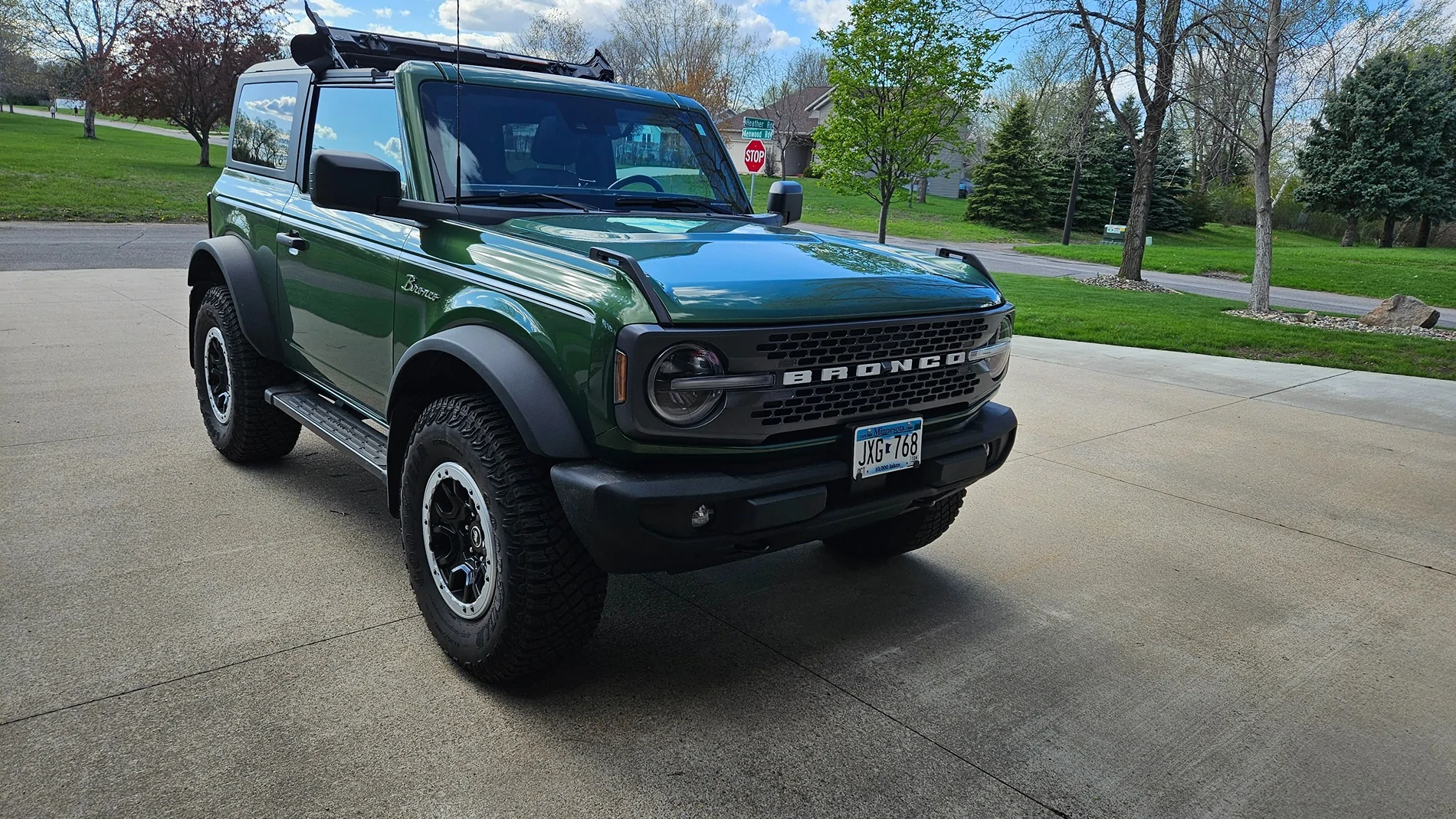

We absolutely love our 2dr with the @bestop Sunrider flip back that replaces the front panels of the standard hardtop.
Waterproof, car wash proof, not much more noise at freeway speed over the hardtop, and has the ability to open in under 5 seconds. I throw it back at a stop sign. With the heated cloth seats and the heat on, I have enjoyed open top sunny days as cold as 45 degrees. When rain pops up,close it up from the driver seat just as quickly. I cruise the freeway with the top back, side windows up, and its very comfortable. If the Bronco was not my primary vehicle, I would leave it on year round. But in MN, the solid roof is preferred about 5 months of the year. Good luck in your search, and enjoy the Bronco experience!

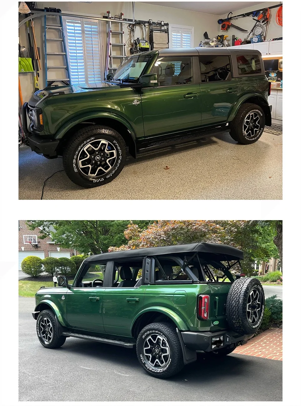

Soft top is nice, but not terribly user friendly to lower all the way and get back up. Does take some strength and effort, especially when fully retracted all the way back. It goes in two stages - (1) flips open for all passenger area exposure, (2) all the way back to the spare wheel. At night, it's wonderful under the stars. Not a cruiser though like a sports car would be, aerodynamics just aren't there for that in general. But like said above, 45mph and below, it's great.
You have to remove the windows first to fully lower it down.
You see in my photo the black plastic pieces along the back of the roll bar by the cargo area? You will 100% want to get them, as the soft top will scratch the crap out of the paint of the exposed roll bar in that area. They're not expensive, many 3rd party options for the protection (mine shown are from IAG).
In my photo, this is called "safari mode", and it is fantastic! Keeps the sun off of me while enjoying the open air cabin. I rarely lower my soft top in general, just cruise around like this instead.
The Brono's HVAC for the front seats is very very good. You're close to the vents, and it blows hot/cold very hard. Match with the Lux package for the heated seats and steering wheel, and it makes for a relaxing drive in the spring and fall. AC blows so cold that it'll condensate on the vents and dash in high humidity situations sometimes (think coastal).
If you have the room to store it (garage ceiling with a winch is ideal), I would recommend the dual top option, especially in Maine. I swap out for the HT around Thanksgiving and again back to the ST around Easter. It's not a particularly hard process to swap them out, but not a one-man-band chore either. The ST is a bit clumsy (and heavy) to get seated in the back initially. Once seated, it's a few shared bolts from the HT and you're on your way. Takes two people to remove and reinstall/position. Once seated, it's a one person process to bolt down.

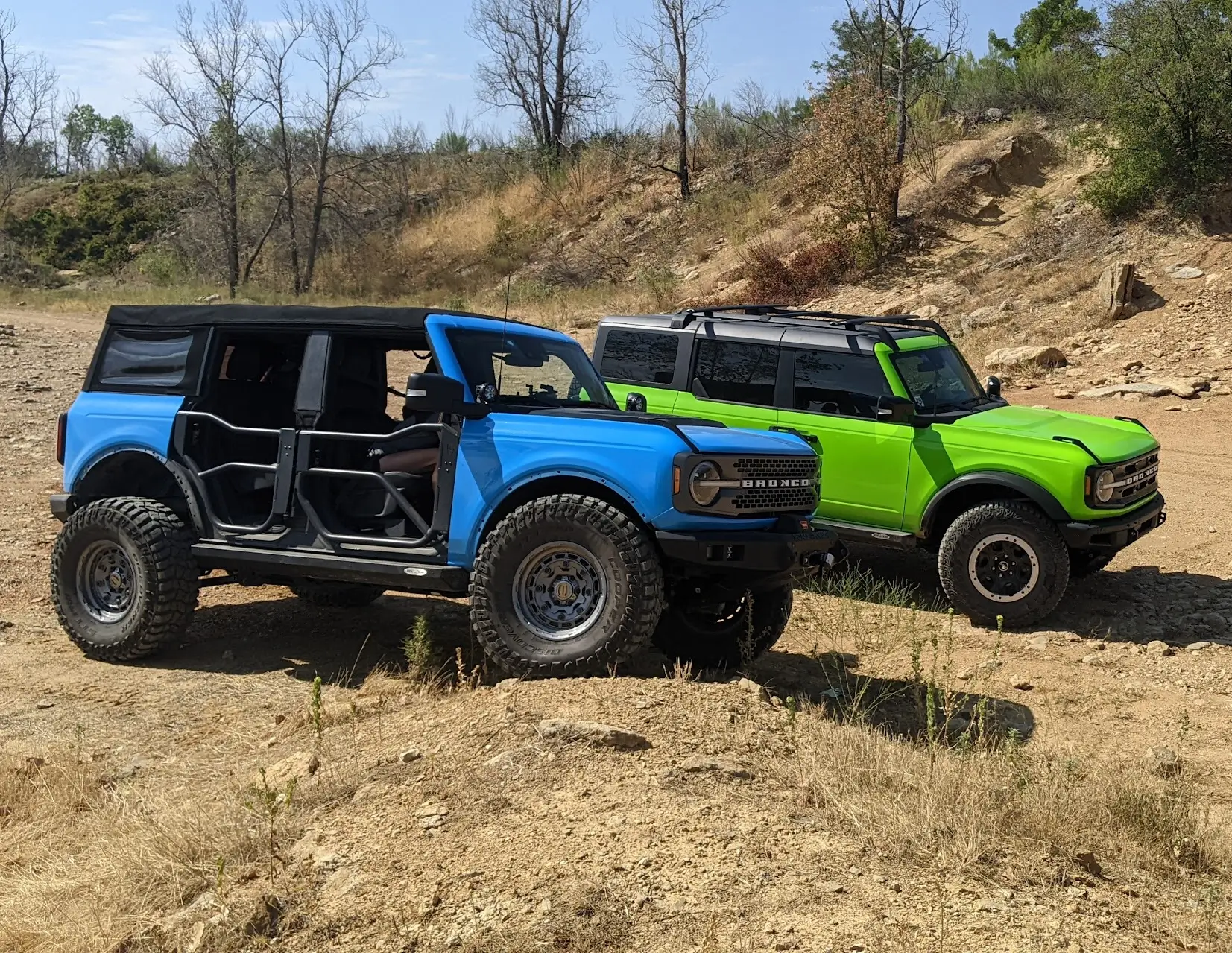

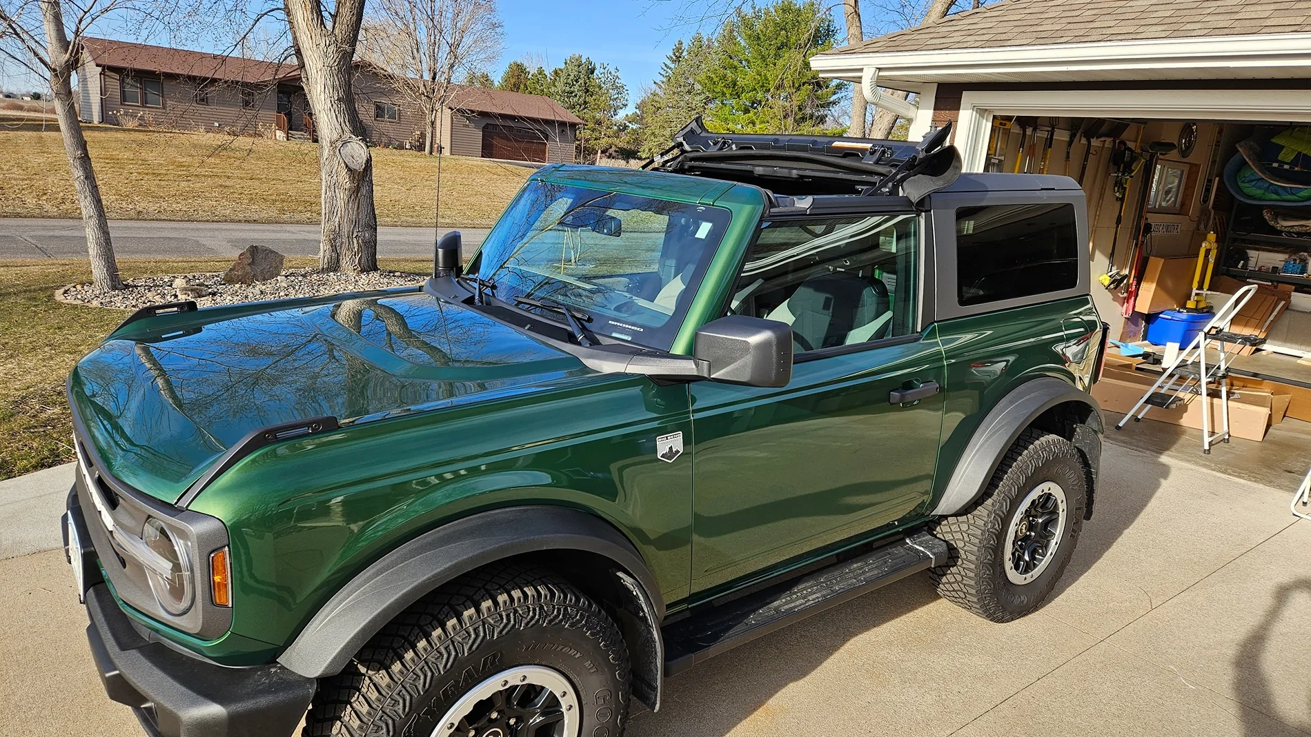

Broncos come from the factory with 3 tops options (for the 4-door):
soft top - four door only from the factory, release two clamps and it can be flipped back, remove the rear vinyl windows and undo another latch to stow the top all the way back. Can get real noisy at highway speeds in the closed position
MIC hardtop - QC issues early, somewhat resolved. 4-door comes off in 4 pieces, 2-door in 3 pieces. Both have two piece panels above the front seats (think old t-tops) that easily come off, one big middle piece over the rear seat (4-door only) then the rear clamshell (a bit larger for the 2-door). The MIC top has a textured finish and only available in a carbonized gray looking color.
MOD hardtop - same panel design / configuration as the MIC. Better quality and has a smooth painted finish. Available in different colors.
These tops are made to come off so they can be noisy. Best to do some test driving. Both hardtops have sound deadening material options that helps out some, and there are tips and tricks posted on the forum to decrease sound levels further but they will never be as quiet as fixed top vehicle.
If you went with one of the hardtops, consider buying one of the available removal assist tools or build a winch system for your garage. Or else, hardtop removal is a 2-person job, and while the pieces aren't overly heavy, the clamshell can be awkward to handle (be careful setting down so you don't bust the guide pins)
As far as the open air experience, unbeatable.
There are also aftermarket options for hard tops and soft tops and what not. Bestop now makes a powered soft top for both 2 and 4 door that stows with a push of a button. It is also less noisy than the factory soft top. They also make a sunrider soft top that replaces the front panels on the hardtop.

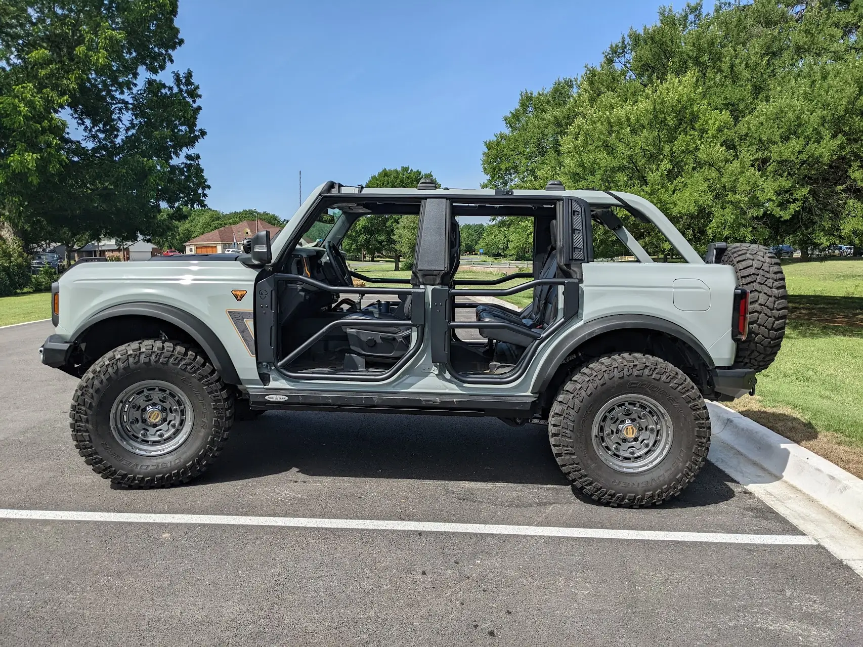

Oh, and the doors come off too. Here are a bunch of gratuitous pics of my first bronco in various mod stages and soft top open positions to give you ideas and inspiration.
Safari mode with doors off (would be awesome in Maine summer months):

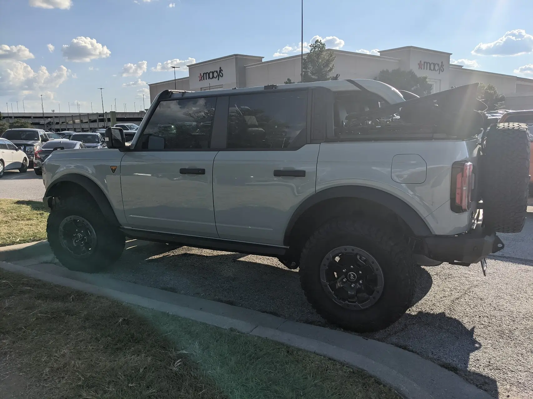

All the way back for a little mall crawling:

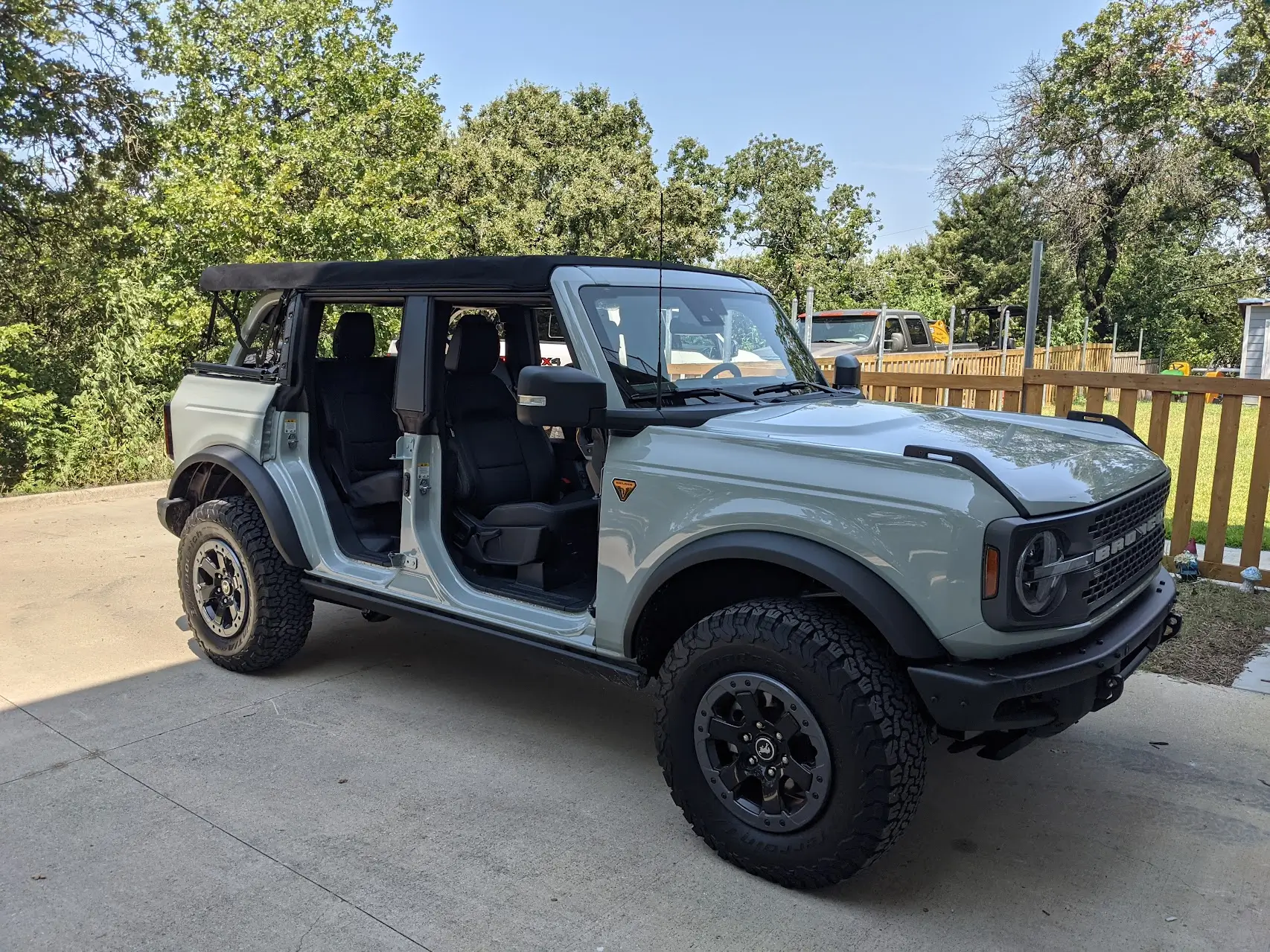

You can also take the soft top all the way for the clean look. However, the soft top is really awkward and unbalanced to remove fully. And tube doors
Ford Bronco Convertible experience with a Bronco 1768659653025-95

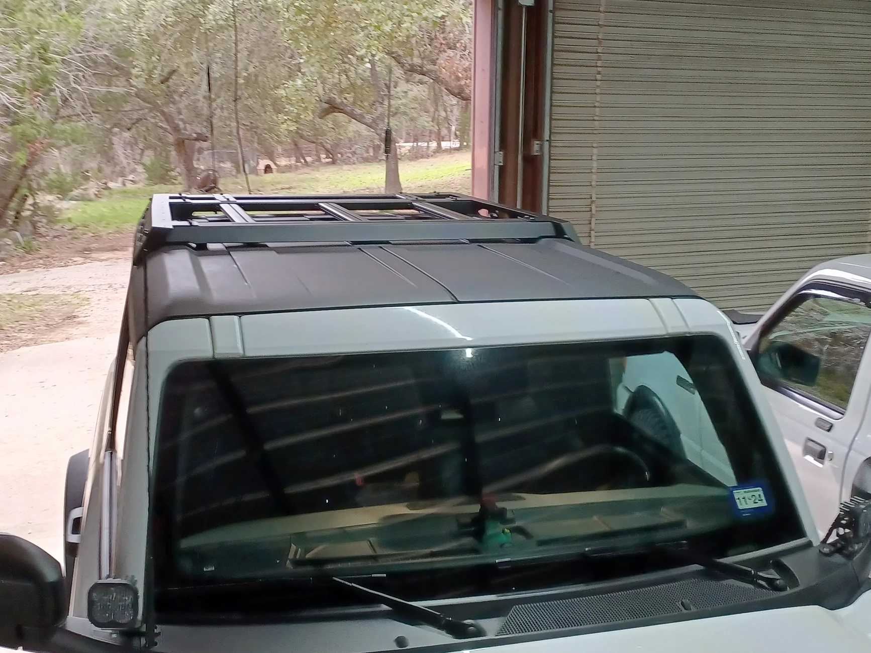

Closed top, no doors (or fenders, they come off easily too)
Ford Bronco Convertible experience with a Bronco 1768659836685-wc

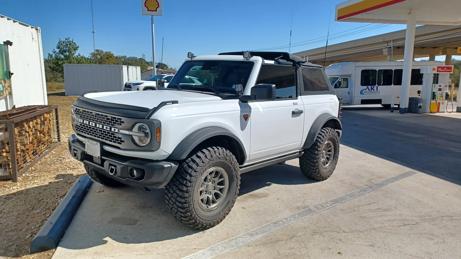

I've got the MIC top on my 2 dr 22 Badlands, no problems yet. But parking is in the garage.
Taking the front "T-Tops" off is a five minute job. Figuring out whether to leave/take them is a bigger problem.
I bought a Rampage black soft top new for $825. Takes about an hour to swap out, and an extra peep to help remove the back part of the hard top. It is very functional, and wind noise is not that bad. I don't think I'd drive cross country in it tho.
Why not have both?
