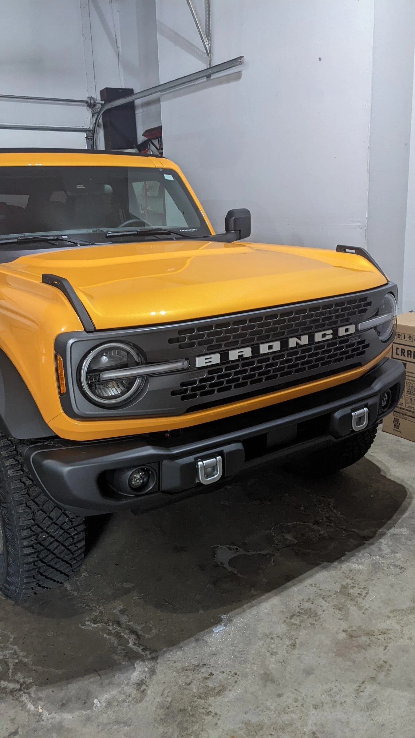

awesome so does it look like you could paint them without even taking anything off? Just mask around the whole thing?
Yes!
In fact I could not wait and just got it done. I was not that careful masking around it and got a bit of flash on the inside bracket of the bumper. But when I snap the covers back on, it will not be visible. At the end, I decided to go with silver paint, like the Bronco concept. In black they go completely unoticed, but in silver they really pop and they match the Bronco letters.

looks good
I had not considered painting the mount brackets as well, just the rings. But that looks good.

Paint dried up!
Put the covers back on. I like how it turned out.
Do you need to scratch it with sand paper before applying paint?
Never done that before so just wondering what's the best process.
I cleaned the surface with alcohol. But the surface was already pretty rough (material is a casting). So far it seems the paint is sticking on. But rubbing it with a Scotch Brite to improve adhesion will not hurt.

What kind of paint did you use?
did you use a primer first and/or a clear coat after?
I used Duplicolor Engine Enamel paint. I just cleaned the shackles and base prior to painting. The surface is pretty rough from factory, so I figured the paint should not have problems sticking.
I could probably have done a better job painting, but I see it as a short term finish. If you really want a good durable finish the best way would be to remove the base and shackle and get them powder coated.
