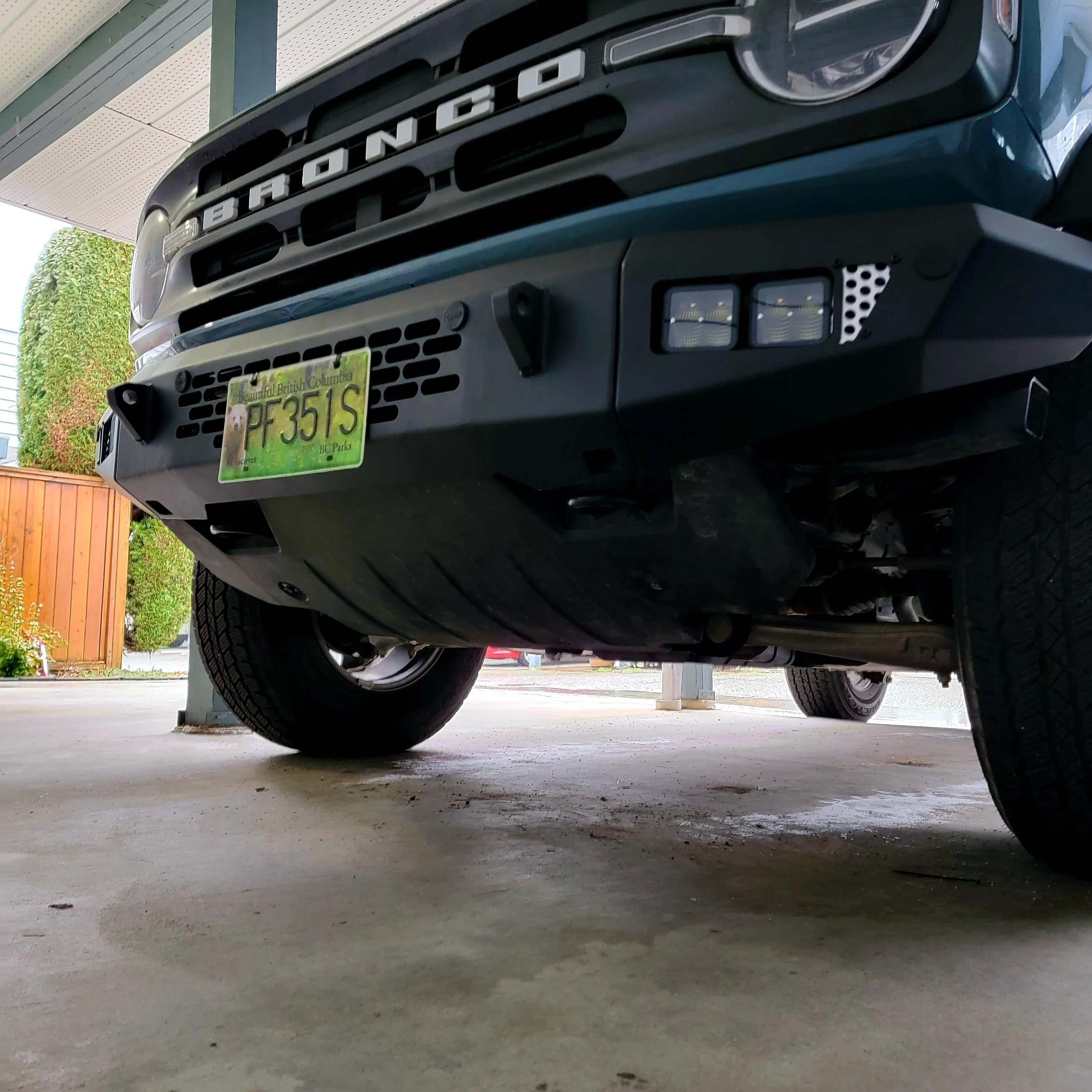

I have the OE Plus and left the factory tow loops on. I like having 4 recovery points. I also did the 4 x Elite Pods. They are insanely bright and the beam pattern is super-spread. Just an FYI.
Installation was super easy too. It only took an hour, maybe.
It looks great! Was it hard to install the Elite pods? Did you do the DV8 mto for your back bumper? Thank you.

omg! Thank you so much!!! I was so bummed when i talked to dv8 and they told me i had to cut off my tow loops
were you able to plug those lights into your factory fog plug?
If you use any aftermarket skid plate, except maybe the Asfir one, you will need to cut off the loops. I kept the plastic one, so I didn't have to.
The lights required a H11 to double-Deutsche DT Y adapter, which I got here: https://store.ijdmtoy.com/products/wirng-harness-adapter-aa1294 Installation was easy and it's nice using the factory fog switch. I've had them on for almost a year and there are no issues.
The lights were easy. See my previous post with a link to the adapter harness. I did not do the rear bumper, but may get their MTO eventually, as it is a nice match.

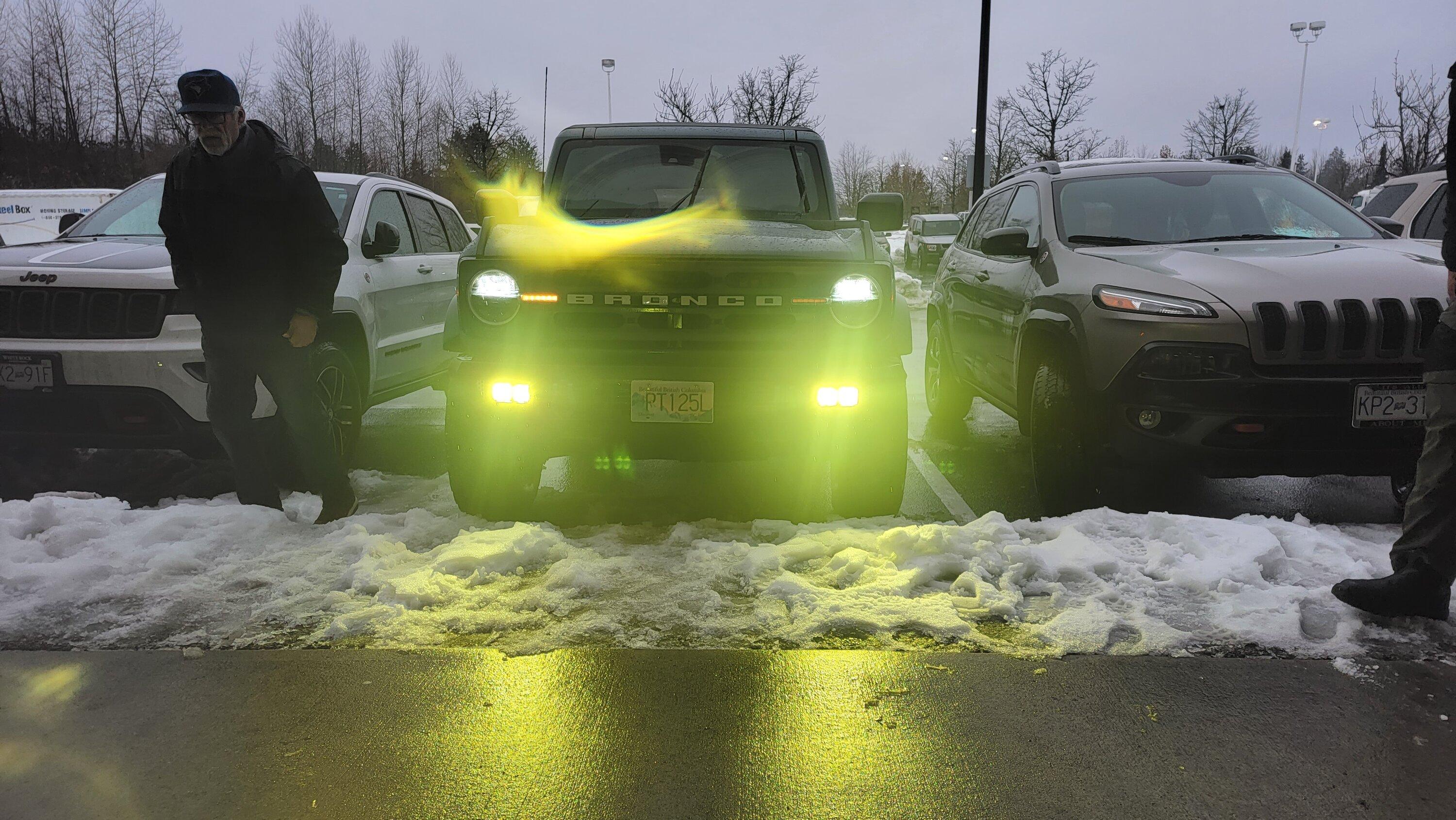

Yes, buy two adapters. The factory fog harness has 2 x H11 outputs (one per side), and you need 4 DT plugs in total.
Yes, IMO they are too bright to be roadworthy. I added 2 layers of yellow film, aimed them as down and inward, and they are better, but they still light up my whole neighborhood! They are great for trails at night. I guess it will really depend on your intended use. I have never, despite always having them, used fog lights on the road, in any of the cars I've had.
If I remember, I'll try to take a pic tonight from the front, with them on.

Here's a pic with the DV8 elite pods on.
Ford Bronco Dv8 and factory capable bumper 20221224_111444
