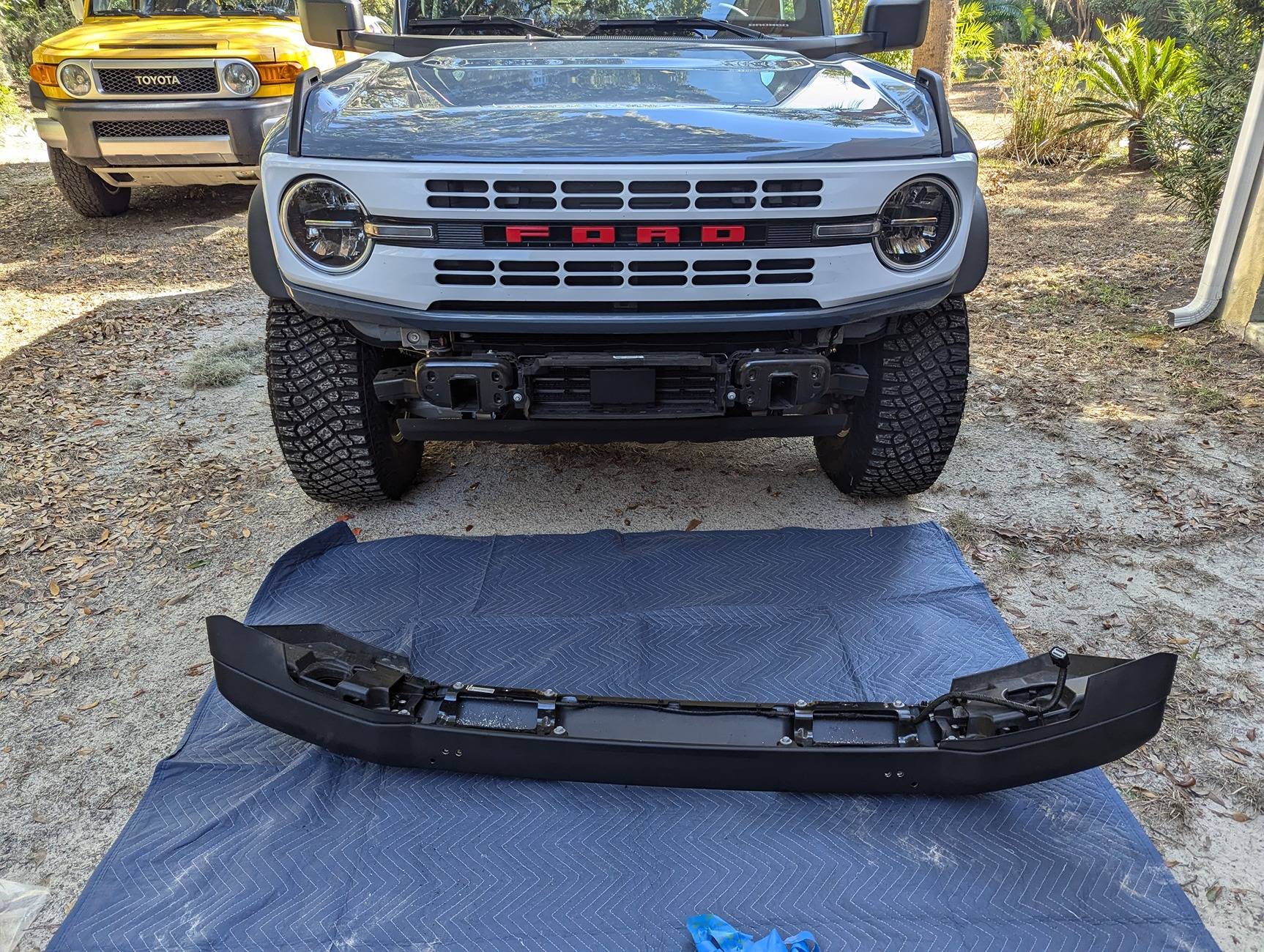

I'll say installation was kinda a pain for me, I consider myself a novice that can do most small jobs so your mileage may vary. You do have to drill 3 holes per side so the bumper has to come off, which was the easiest part of the job. Make sure you have a good drill bit, I had to order one that was supposedly for metal and it was work. I'd recommend after you mark the spots to use a tap and a smaller bit as a starter because the big bit just wanted to walk. You'll need a rivnut tool so buy one in advance or borrow from a friend, I bought this one from Harbor Freight and had no issues:

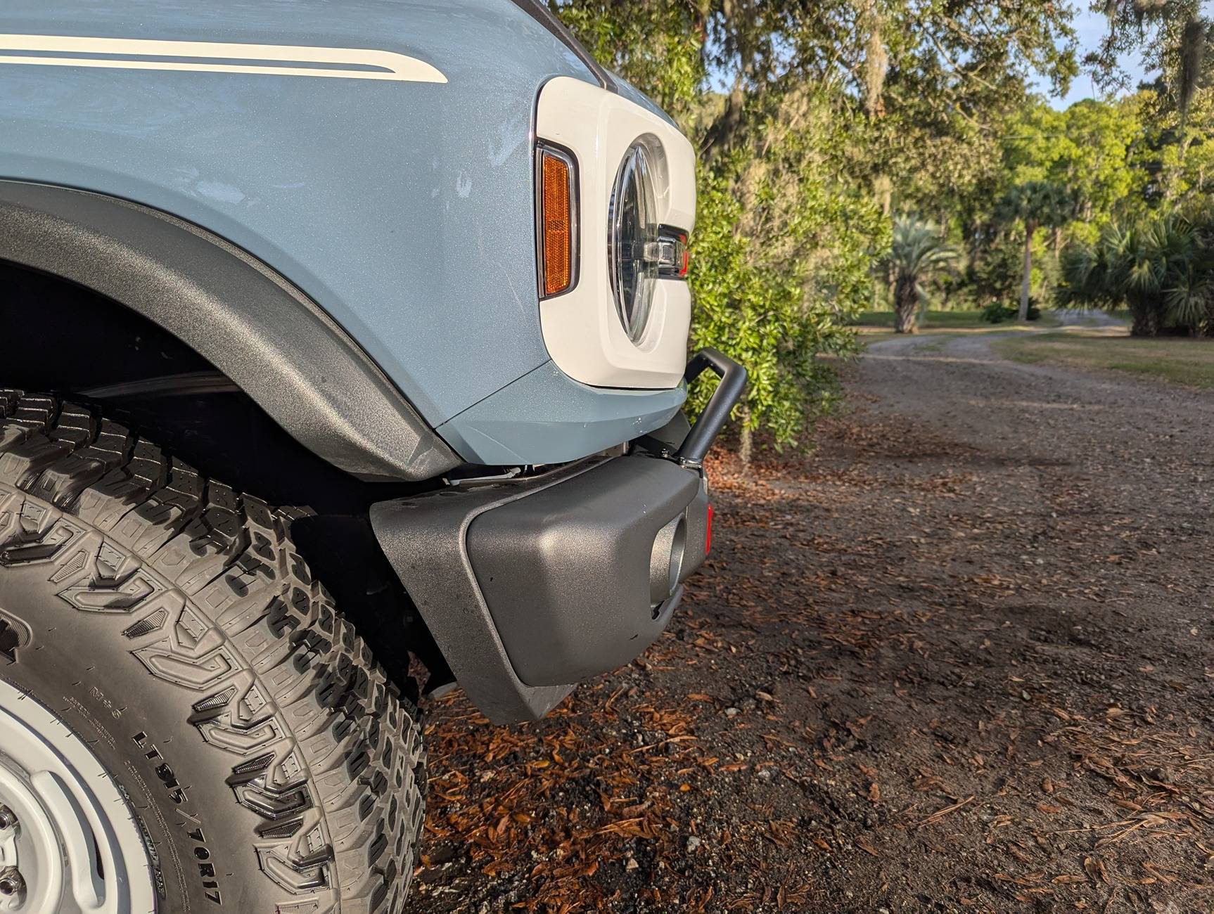

Here's the holes drilled out:
Ford Bronco DV8s Capable bumper bull bar! PXL_20241117_171412363

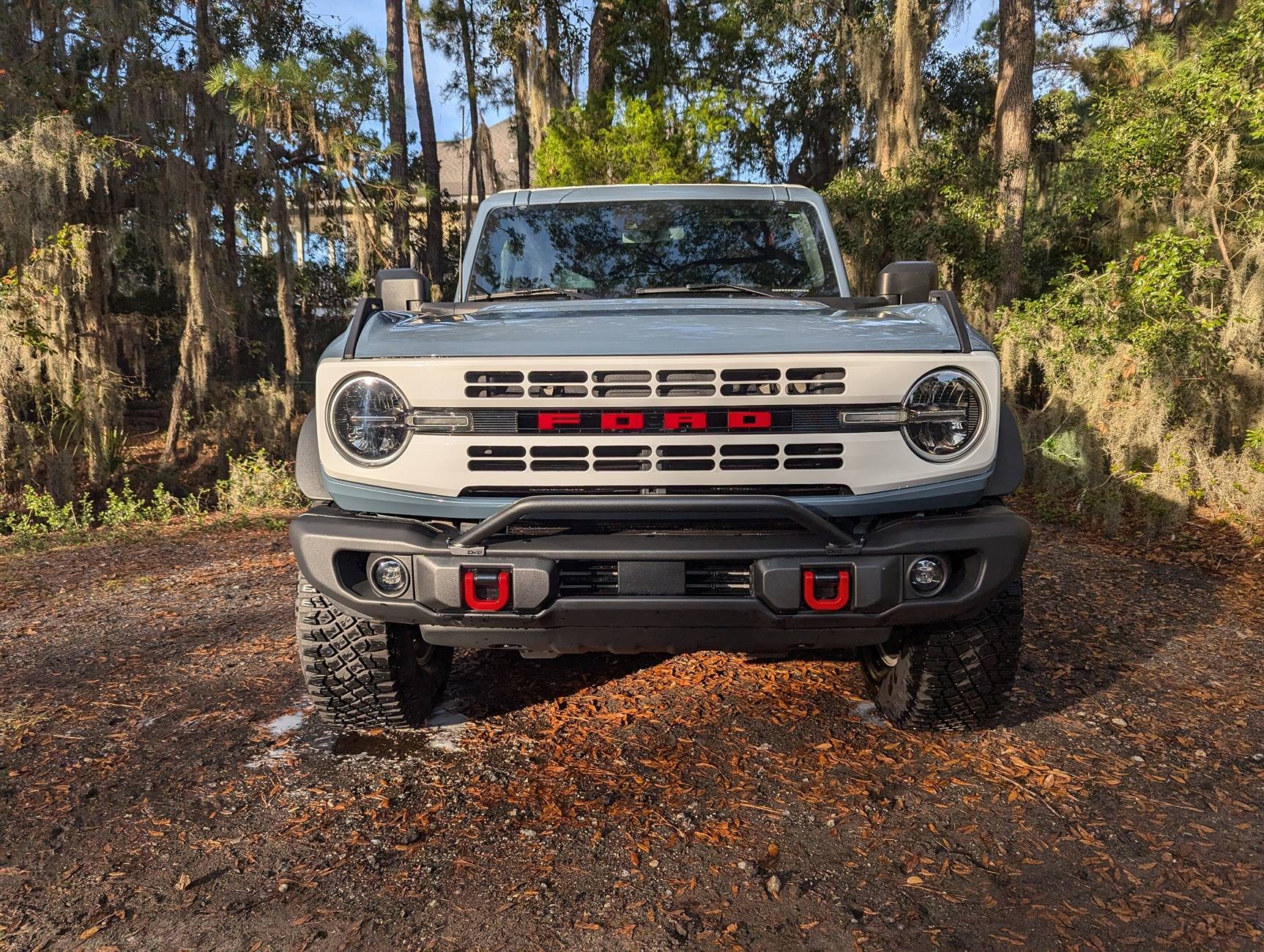

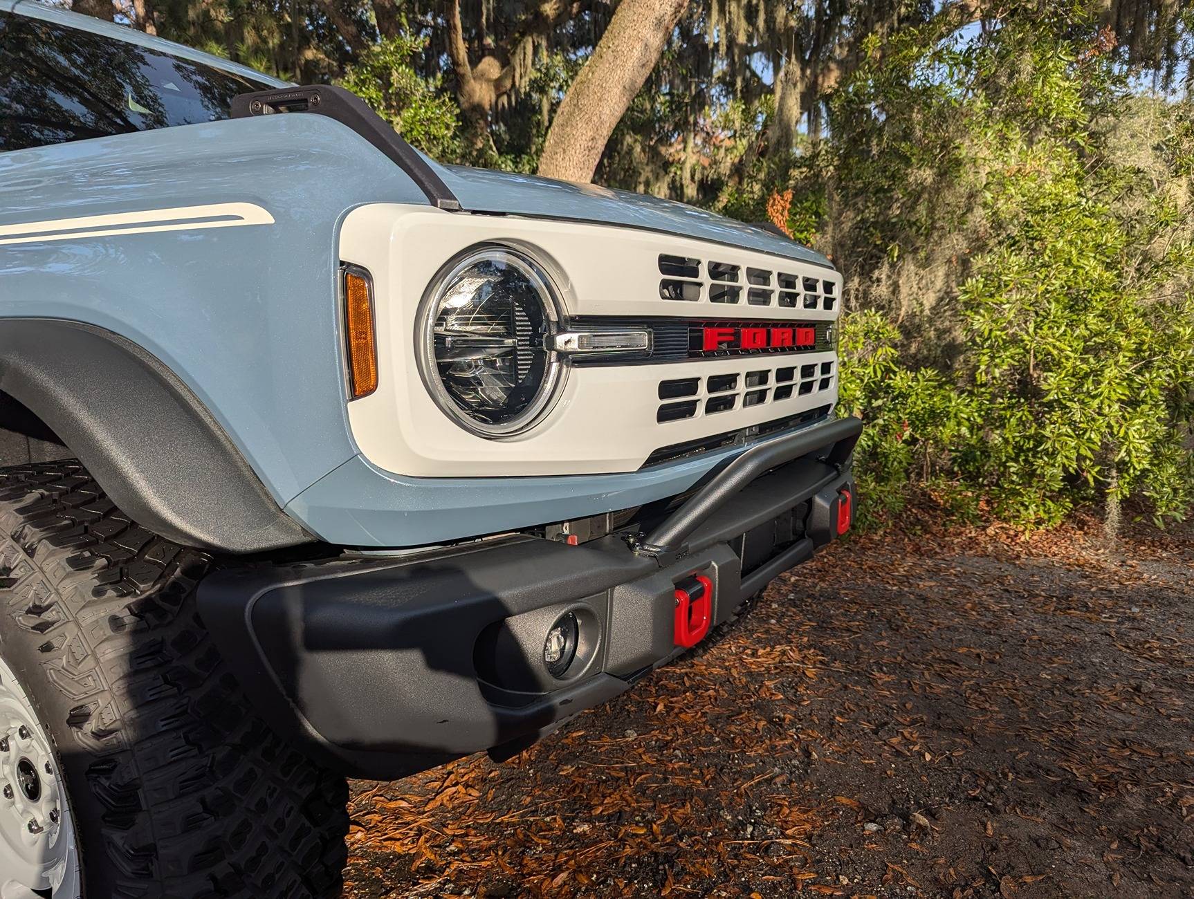

And pics installed:
Ford Bronco DV8s Capable bumper bull bar! PXL_20241117_205534123
Ford Bronco DV8s Capable bumper bull bar! PXL_20241117_205518251.MP
Ford Bronco DV8s Capable bumper bull bar! PXL_20241117_205505945.MP

Looks good. How well do the finishes match up in person? I’m on the fence, not sure how much I like only mounting in the rear. For a light mount, it’s fine I’m sure. You might want to stay away from any bulls though!
It's a tad blacker than the bumper but the Bronco is a year old so it'll fade to match I'm sure. It's not going to do much to protect anything but it's plenty solid for a light mount. Luckily no random bulls on the coast but them dang deer, if I can throw more light to see 'em then it's worth it.
