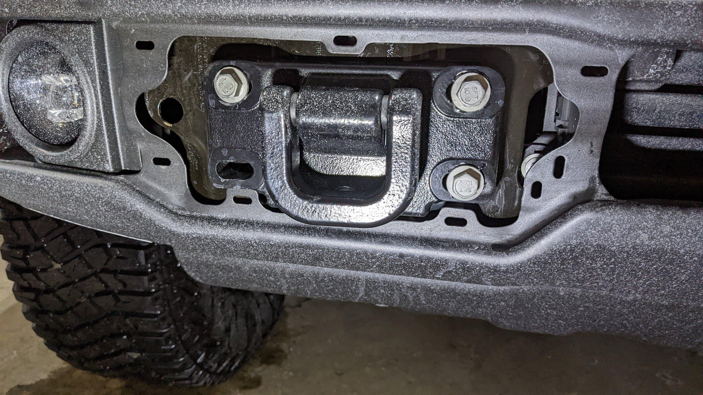

Took off the bumper yesterday and I confirm the whole shackle mount was held with a 8 mm socket bolt from the back. After that it came right off. The capable bumper mounts essentially the same as the modular bumper, but it does not have the "modularity" part. However it is compatible with the same skid plates as the modular bumper. The bumper is super easy to take off. 6 screws and one harness connection total.
However, I could not take apart the shackles. Looks like the pins holding them are press fit. So you might need a press to take them off.
But honestly, if you just want to paint them, I would recommend just taking off the plastic trim and masking around it. If you have any imperfections on the edges, they will be covered by the trim anyway.
I am going to paint mine, but I unsure if I want to do some kind of silver or red or orange to match the body color. Too many choices!!!

awesome so does it look like you could paint them without even taking anything off? Just mask around the whole thing?

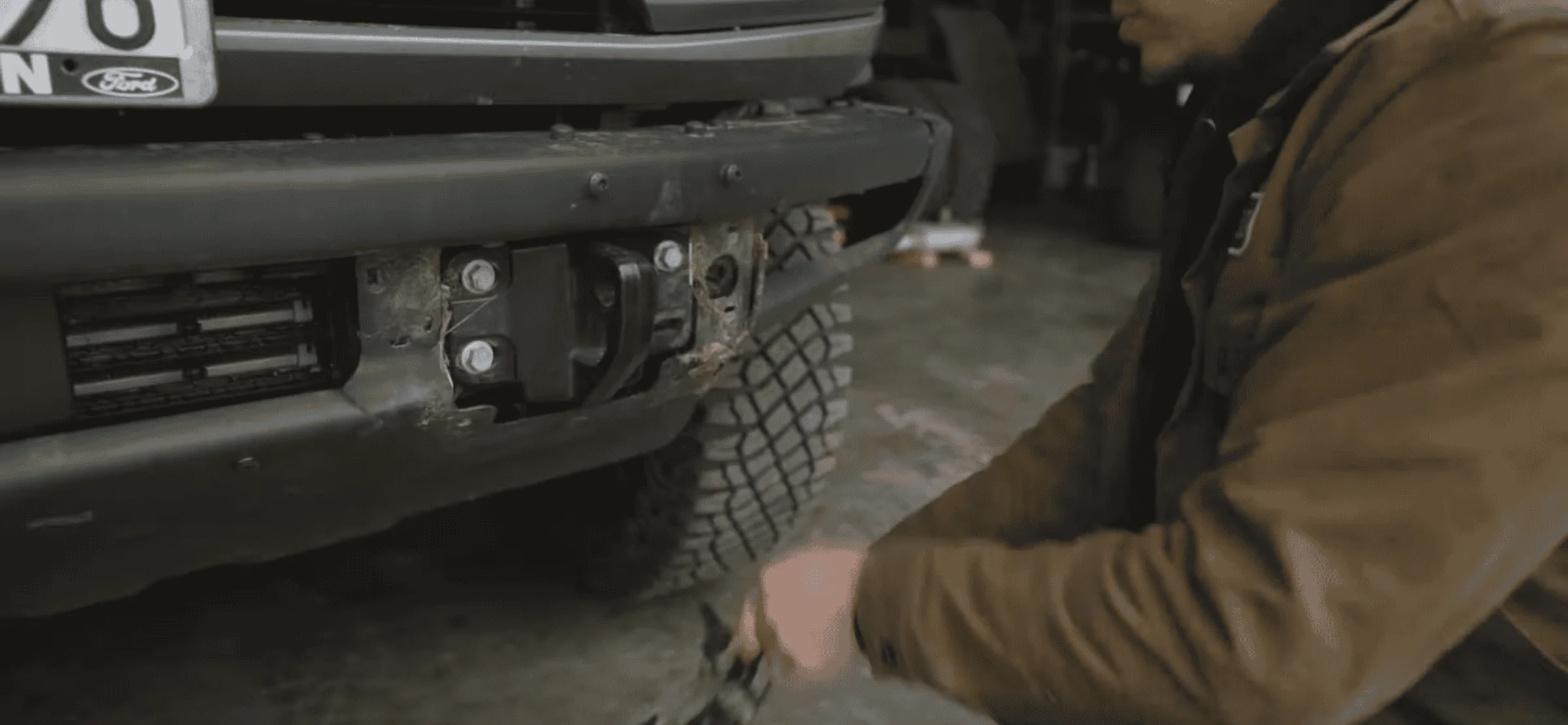

The capable bumper and the modular bumper share the same skid plates. So based on what this guy did, I do not think it will be an easy bolt-on. The guy had to cut some brackets from the frame (n)
One of my projects in the next few weeks will be to design a custom bracket for a Warn winch that can be mounted hopefully without removing brackets. It will also need a custom skid plate. But it will be huge if I can avoid having to cut parts from the frame.
