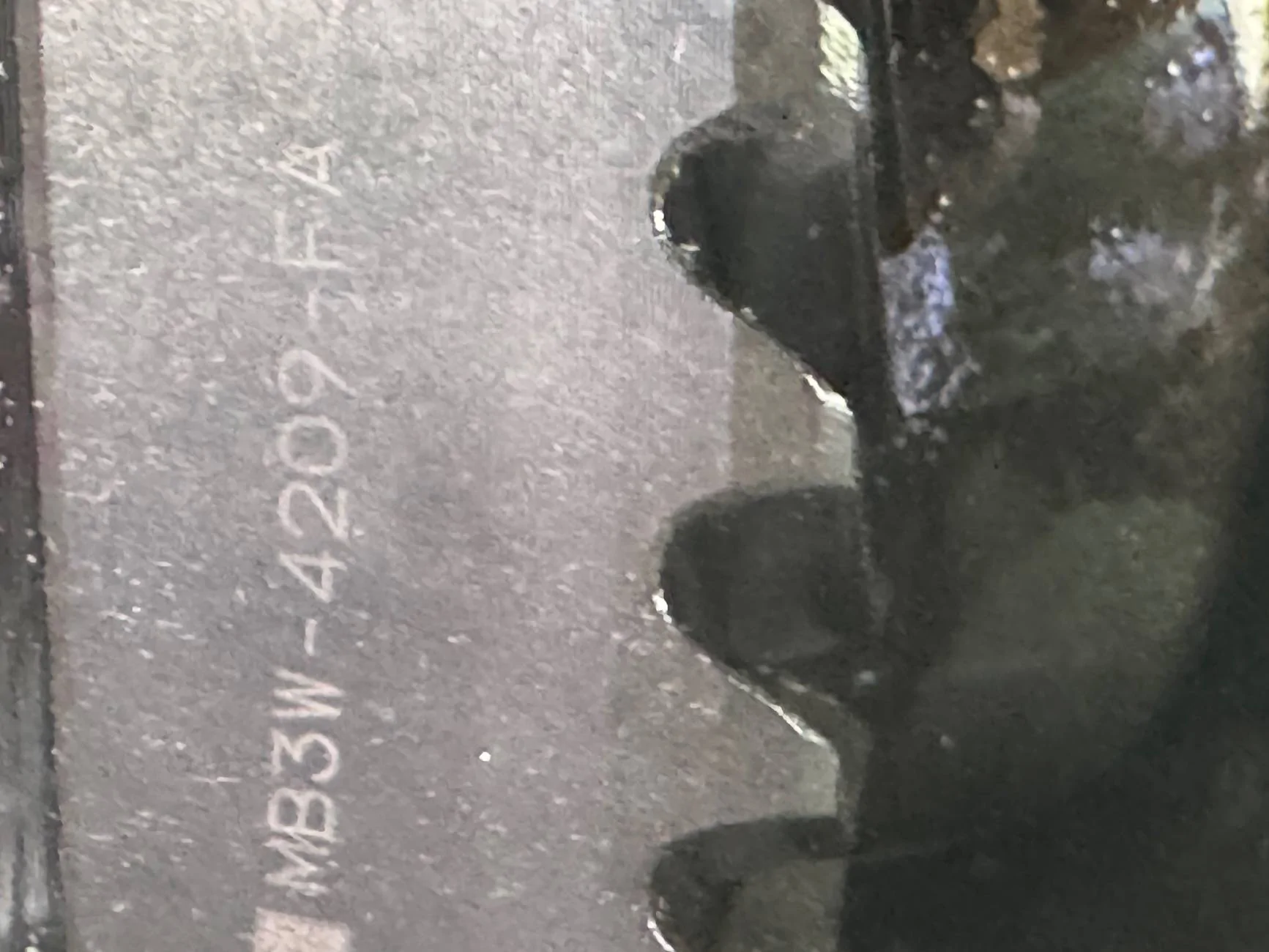

Can someone help identify my rearend ring?

Everything I see says my rearend is supposed to be a 4.47. But when I installed 35s on my bronco my speedometer was perfect according to both gps and radar signs. I had some funky shifting, something I couldn’t place my finger on, so I decided in my wisdom to update my tire size from 33s to 35s and shifting seems right but speedometer is off 5%. Doing the math 33s with a 4.46 rear end is about dead on to 35s with the 4.7 rear end. So I took and checked my rear end and the housing said 4.46 the same as my door called for. I decided to do a fluid change and check the gear. I found part number MB3Z-4209-FA which only thing I can find says it’s a 4.27 so I’m wondering if ford maybe installed a wrong rear gear.

It’s 4.46
That’s an engineering number, not a service part number.
The actual part number is MB3Z-4209-C
Also, it’s not uncommon for factory speedometers to be off by 3-5%

wouldnt that then make mpg off by 3-5% I would think that would be a huge lawsuit and fines from the epa for falsifying mpg stats.

No. It would change your calculated MPG or whatever the instrument cluster shows.
It’s never going to change your actual MPG
Either way you look at it, with tire wear, your speedometer is never going to be perfectly accurate. Which is why 3-5% is just considered normal, for every vehicle.

it says it right there 42 ÷ 9 = 4.66 ratio. wait that dont make sense... Usually the manufacturer does list the tooth count in the part number, but apparently not in this case...

I work at the Ford Sterling Axle plant and every ring has the ratio cast into it and every pinion has the ratio stamped into the pinion head. Unfortunately, we lost the bid for the Bronco/Ranger differentials to Dana, not sure if they have identifications like that or not.
