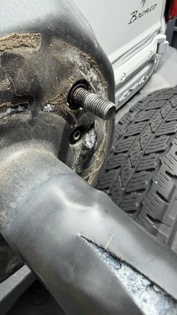

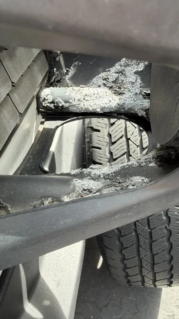

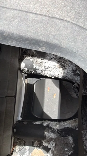

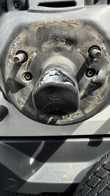

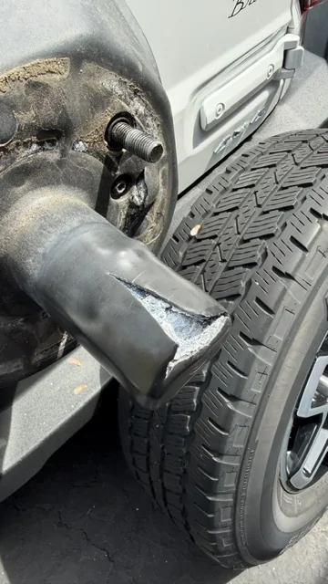

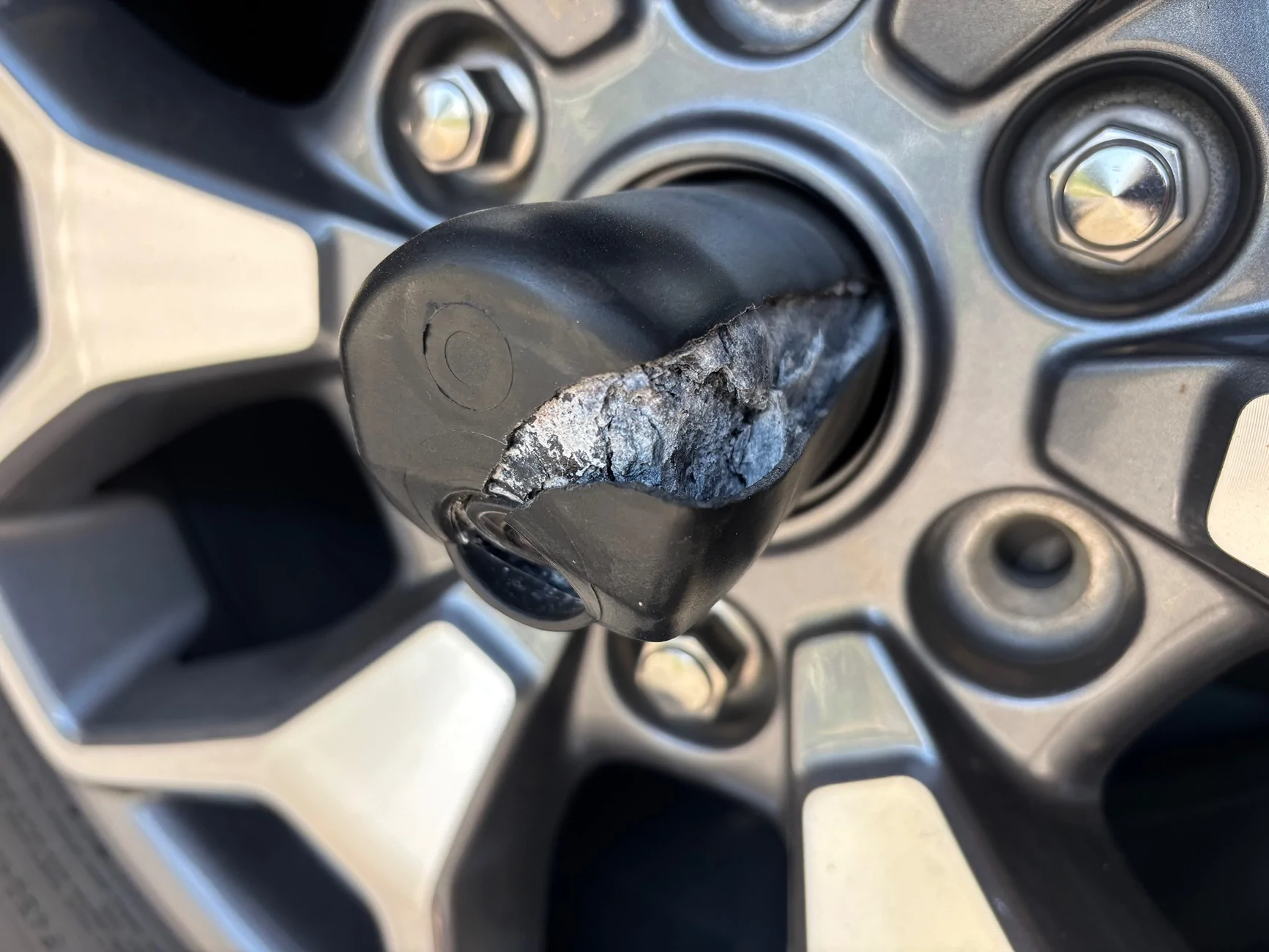

Took everything apart tonight with the intention of swapping the carrier for the replacement I picked up off EBay. Pics provide more detail, it was definitely corrosion of the inner sleeve, I believe it’s aluminum. My guess is water got between the plastic and outer surface of the aluminum tube. Maybe it froze, maybe it was extremely salty and corrosive. Had to cut it to free the camera, was too swollen to slide out.
To make my night great the replacement I picked up is incorrect, the camera tube is too short for the “digital” 350 camera. If anyone has a lead on a 35” digital spare tire carrier let me know.

IT’S GETTING WORSE !
You didn't expect it to get better did you :unsure: ? Kind of like how all those granite kitchen counter tops end up cracking when they use to use steel bars to reinforce them. The seals would fail the steel would rust, causing expansion and the stone would break. As long as it continues to corrode, it will expand and the damage will increase.

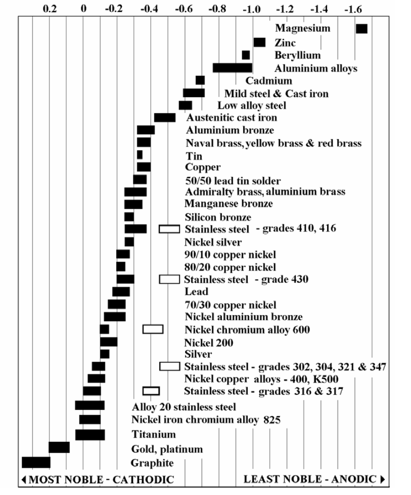

Even that can be a problem, at least with some alloy combinations in some environments and without protection. The further apart the alloys are on the chart, the greater the difference in potential. Carbon fiber composite paired with magnesium in a wet environment is a very bad idea!
https://www.ssina.com/education/corrosion/galvanic-corrosion/
Cool graph.
I learned the hard way when I screwed my flatbottom battery tray to a rib with non-stainless screws!

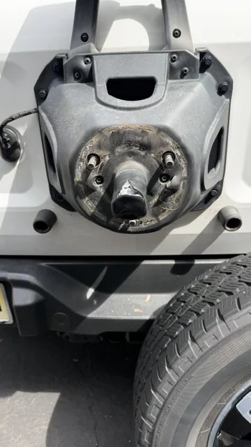

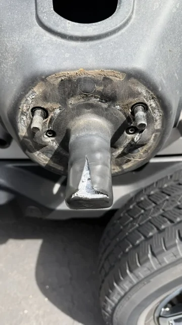

My claim went through all the steps, Service, Dealer Owner, to Corporate. The corrosion complaint was denied. FORD stated, due to the fact that the tire bracket is an accessory part and not part of the body. Therefore it is not covered.
Yeah, Factory accessory that is on every Bronco made. If it was considered for Bumper to Bumper warranty they would probably say, Sorry that part extends past the bumper :sneaky:
