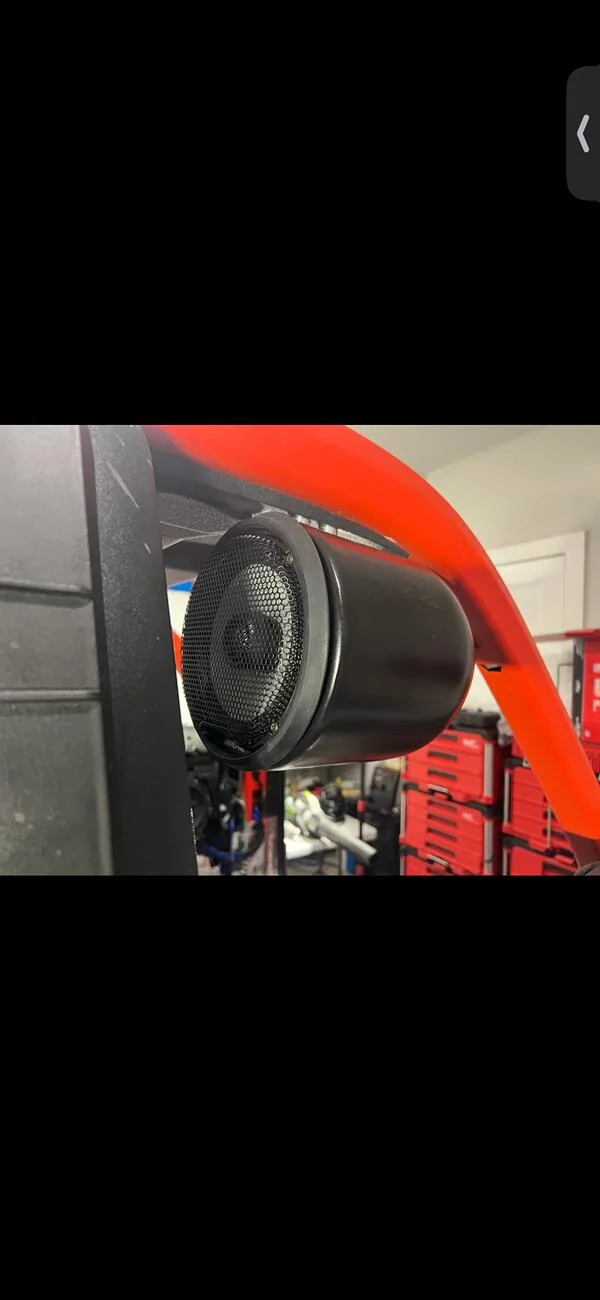

What wakeboard boat speaker pods are those and how did you hook them up?

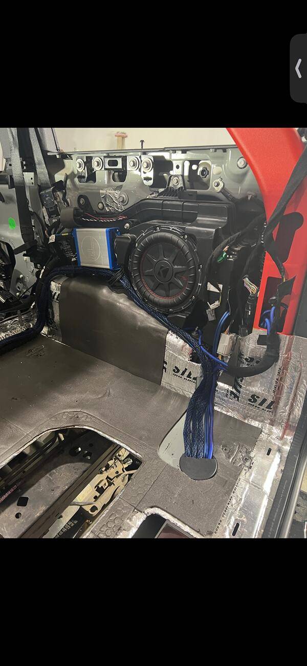

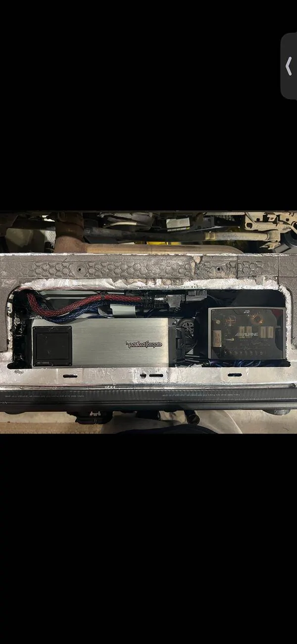

Rockville pods with alpine R2 6.5.
all of the speaker wire is 16g copper, I didn’t use any factory wires. Front I did 3 way setup so I was running wire anyways and didn’t trust the factory wire.
The “premium” amp was removed and everything was aftermarket.

Yea I don’t even have the dummy sub box or a sub in the panel at all, how are the pods attached?, to the bolt holes built in to the bar?
BuckWildOffRoad
BuckWildOffRoad
Austin
Dec 10, 2019
473
1,934
Arkansas
Badlands Bronco, King Ranch F250, Taurus SHO
I drilled holes and inserted rivet nuts to mount through. Drilled through the plastic and used aluminum spacers to offset from the rollbar.
honestly the premium system makes it harder and more expensive with extra modules.
you should just get a takeout box, put a nicer 8” speaker, and run a kicker 500.1 to sub and then a kicker 200.4 to the pods.
