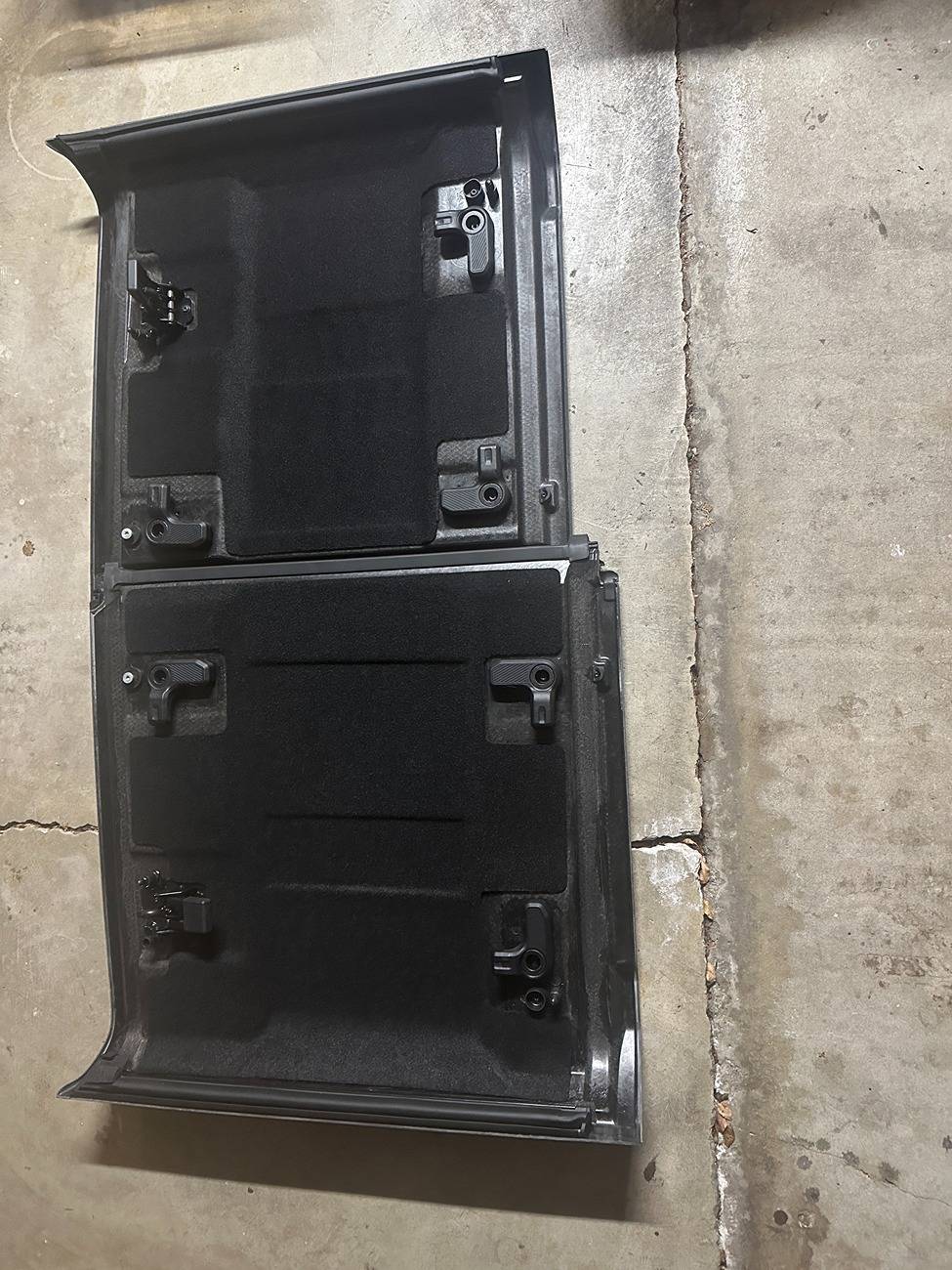

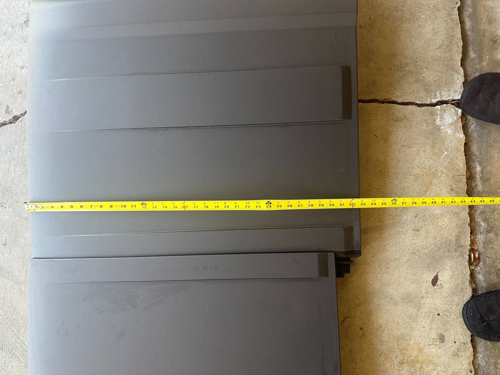

When it arrived, the passenger panel was 3 inches longer than the driver panel. It would not fit by itself or with the driver panel.

  3. Picture of issue (pic of hard top piece with tape measure next to it showing its height)

pics of bad panel for reference.
Ford Bronco Bronco OEM hardtop issues: panel wrong size bronco3
Ford Bronco Bronco OEM hardtop issues: panel wrong size bronco 4

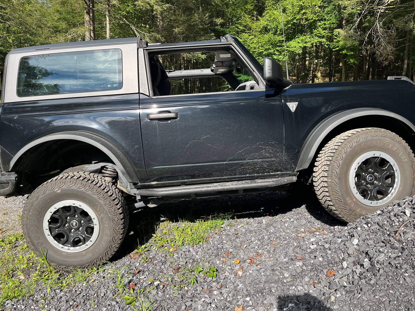

I find that hard to believe. My 2DR top section is as long as the door itself. I would imagine a 4dr matches the door as well. A 2DR door is longer than a 4dr door.

2 door panels are definitely not the same.
