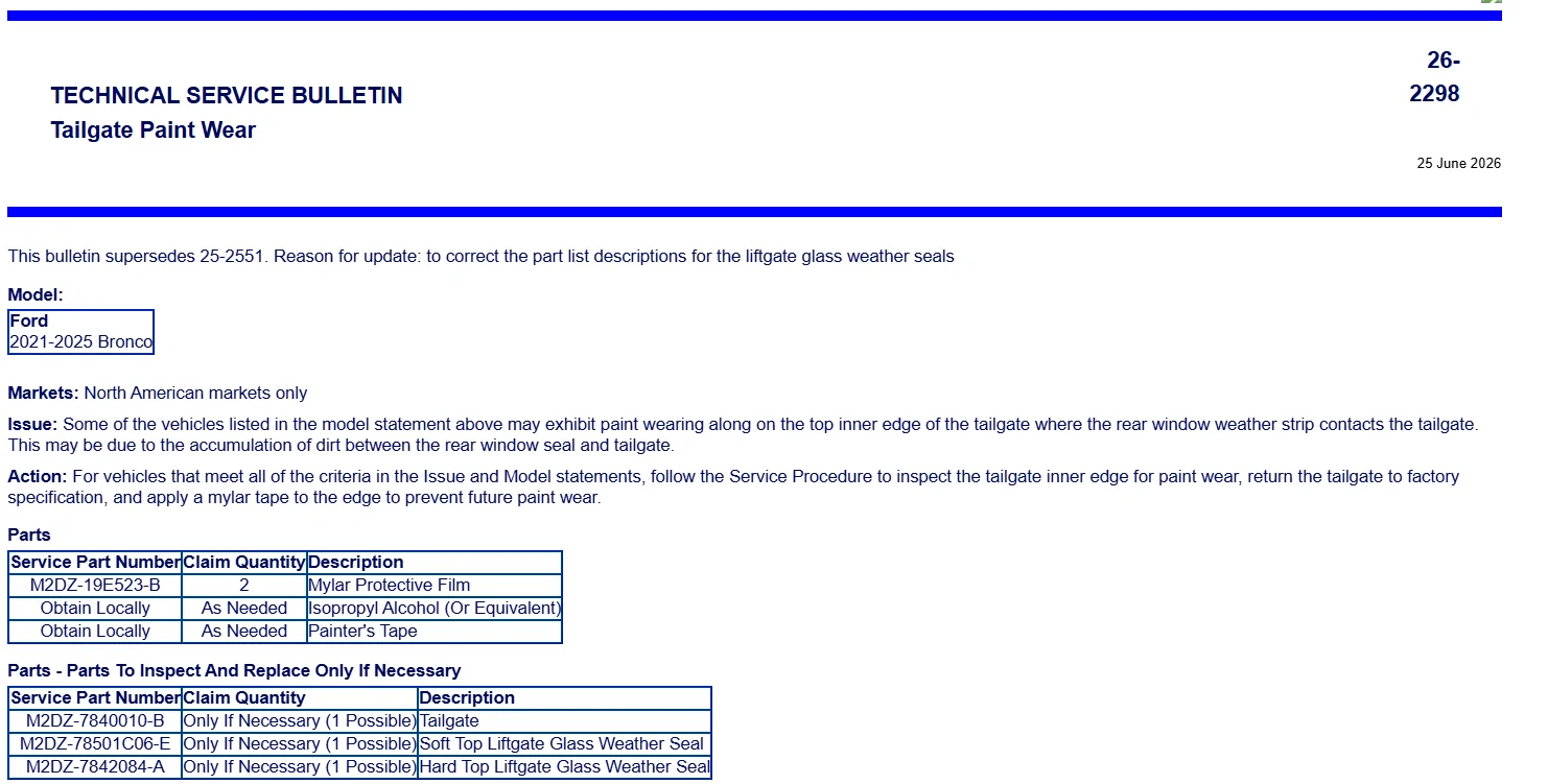

I know the original post was about the glass to tailgate squeak, but I came across a bulletin describing potential tailgate paint wear that might help some of you:
Ford Bronco Hardtop rear window squeaking issues Screenshot 2026-08-17 103140
