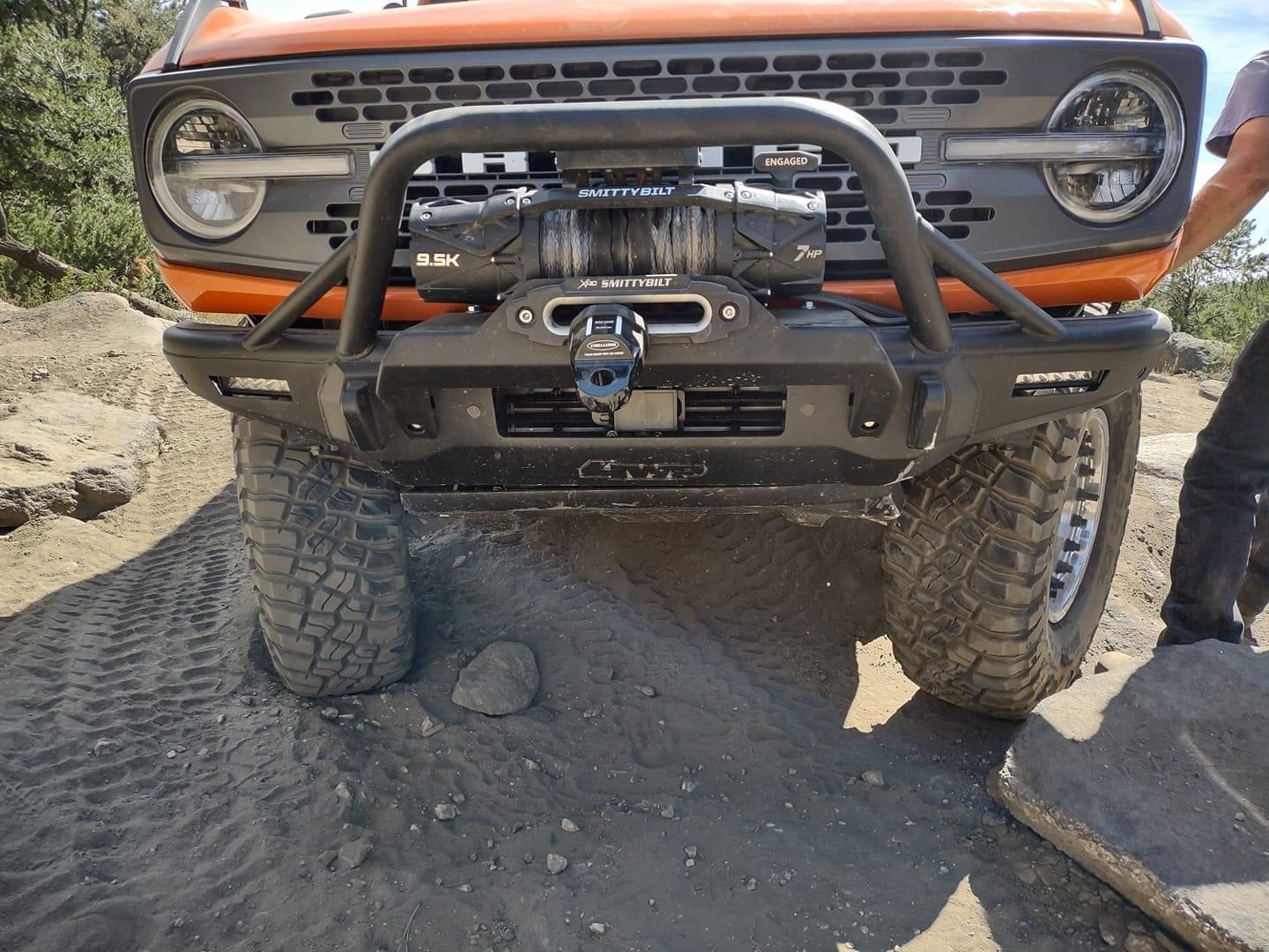

More than one now! Got an inny instead of an outie though.
Just wait till all those "self" squatchers start wheeling hard and start having front axle problems. :ROFLMAO:

Does Sasquatch come with upgraded axles and tie rods? Is there a reason that would be an issue for "self" setup Sasquatch models vs factory configured.
So far I've seen 3 of these, all with different wheels/tires than stock. Any idea what tire sizes were involved? At least one here was on 37s, I can't tell with either of these if there was a left or larger tires.

Squatch has a nodular iron case and is 210 MM. The non-squatch is aluminum case and is 190 MM.
So yes the squatch has a stronger axle. Tie rods are the same.
The bigger the tire the stronger axle you will need, in theory. If you are light wheeling or going to the mall you can get away with it but if plan to use it and use it hard then troubles will be on the horizon.
One other consideration is the weight of the wheel and tire combo. This is can cause premature problems as well.

So far axle doesn’t seem to be the issue, so self squatch or real squatch, it seems 37s and factory tie rods MAY be an issue.
Would like more info to see what the real issue is.

I haven't seen axle problems yet either and for the most part you won't until people start "hard" wheeling with their "selfie" and I don't see them breaking it either. It will just "wear out" faster.
Bigger, heavier tires have a larger load on the axle assembly. Aluminum will "defect" more than cast iron when put under heavy loads. This "defection" may not break something but it will wear on it and cause it to fail before the stronger one will.

Are these overly aggressive off roaders, or are these overly fragile tie rods?
#epicorange pretty aggressive off roader. His first split was out in the rubicon. I also believe fragile rods. 2nd spilt was in Moab. He also runs 37s.

Like I said in the other thread, this is what happens when you delete your fender flares!
Two Broncos with broke tie rods, two Broncos with flare deletes.
Take notes, folks.
