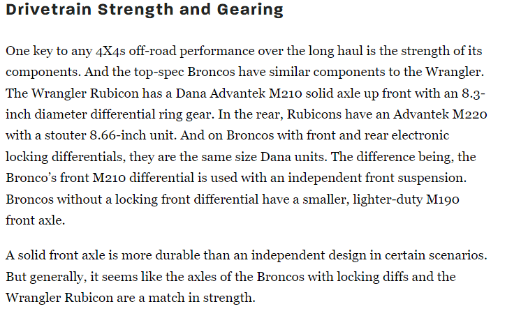

I'll start with this from an Autoweek article first just to put the numbers in perpective.
