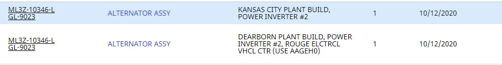

Bronco Alternator (2.7) is MB3Z10346B
F-150 Alternator (2.7) is ML3Z10346L
They sure look the same to me though.

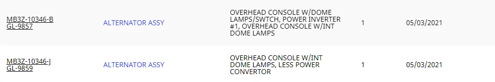

Need VIN. There are two possibilities for both engines.

2.7 F-150, I vote no. F150 is about $300.00 more than Bronco. Might some of the guts interchange, possibly but would hate to spend $700.00 just for a dissection.

If it were the same alternator.. it wouldn't be on national backorder my friend.
Are both 2.7 versions on backorder? Maybe the one that doesn't match his VIN will still work.

Interesting. Dealer told me my P/N was “ MB3Z10346B”

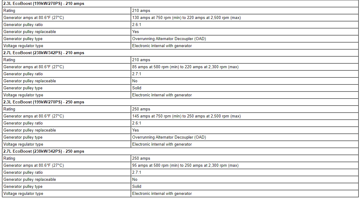

That is correct for your application. The -J is the other possibility, likely for something that is a lower trim level and no overhead upfitter switches. Now, if they said the correct alternator was back ordered for months and this was a customer pay repair, I'd try the -J just to get going. I can't tell you if the only difference is idle and total output but it that's sorta what it looks like.

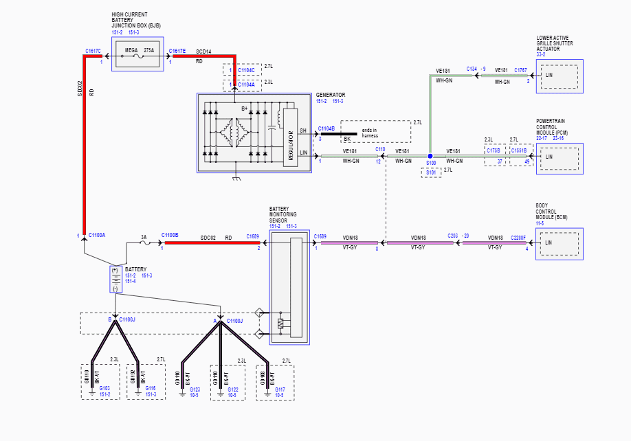

Only one wiring setup and the only connection difference looks like the main lug coming off which is different between 2.3 and 2.7.
