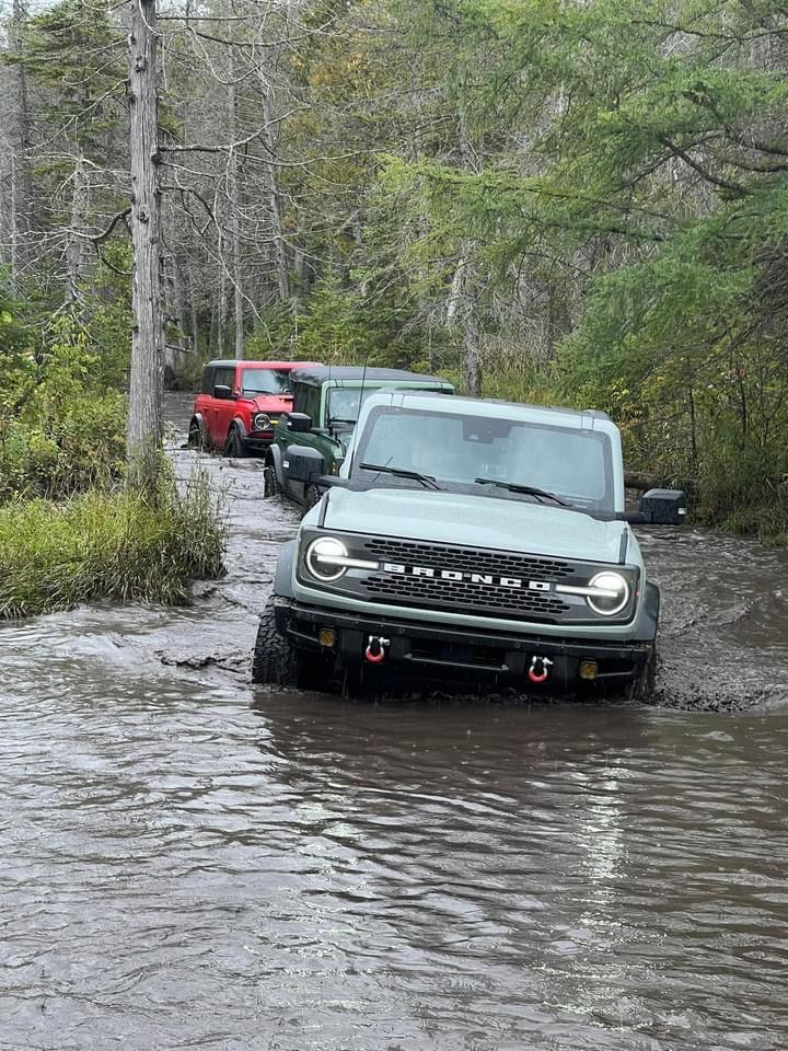

No such thing, Jeep alternators fail on occasion when wet, like everything else. I went with 17 other Broncos (and two jeeps) in and out of water for 12 hrs., up to and past the floorboards, we could hear the waves lapping against the floor. Not a single issue (and a smaller group had done more extreme wheeling the day before).
The next event, a groups was hammering through about 12 inches of water and we had two issues. The Jeep guys I was with talked about the same issues, when people are too aggressive through water.
People will almost always talk about problems, not things working well. It's just human nature.

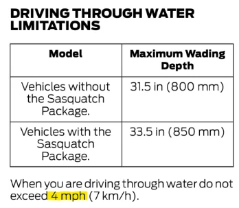

I was going to say you are being ridiculous on a vehicle sold as built for off roading but the manual is very clear on the water fording speed:
