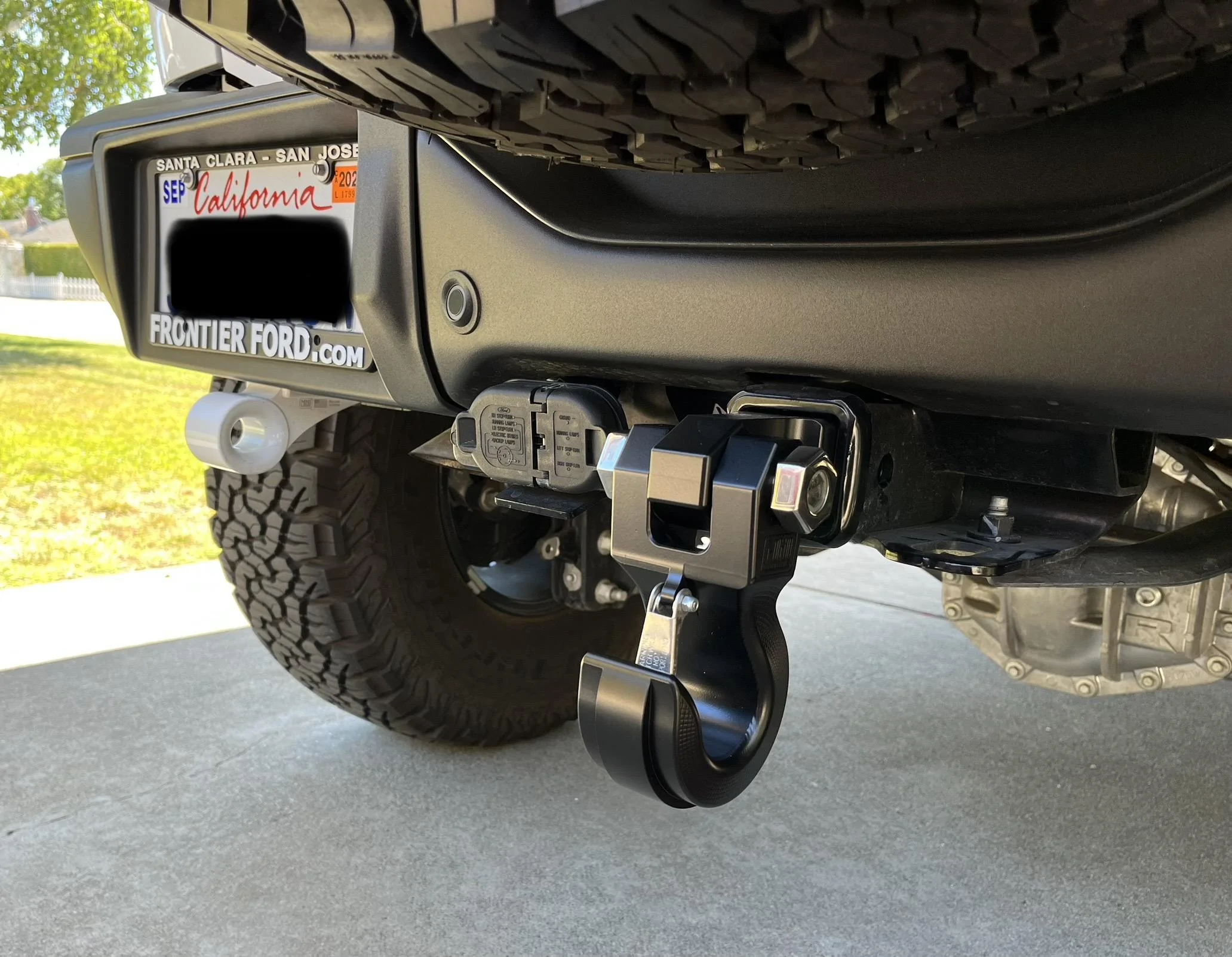

Factory loops are tilted down at an angle, while these are thicker they go straight out. Most likely not much of a difference. I will get back to you later today when I place my factory next to these.
How did these end up comparing to the factory ones?

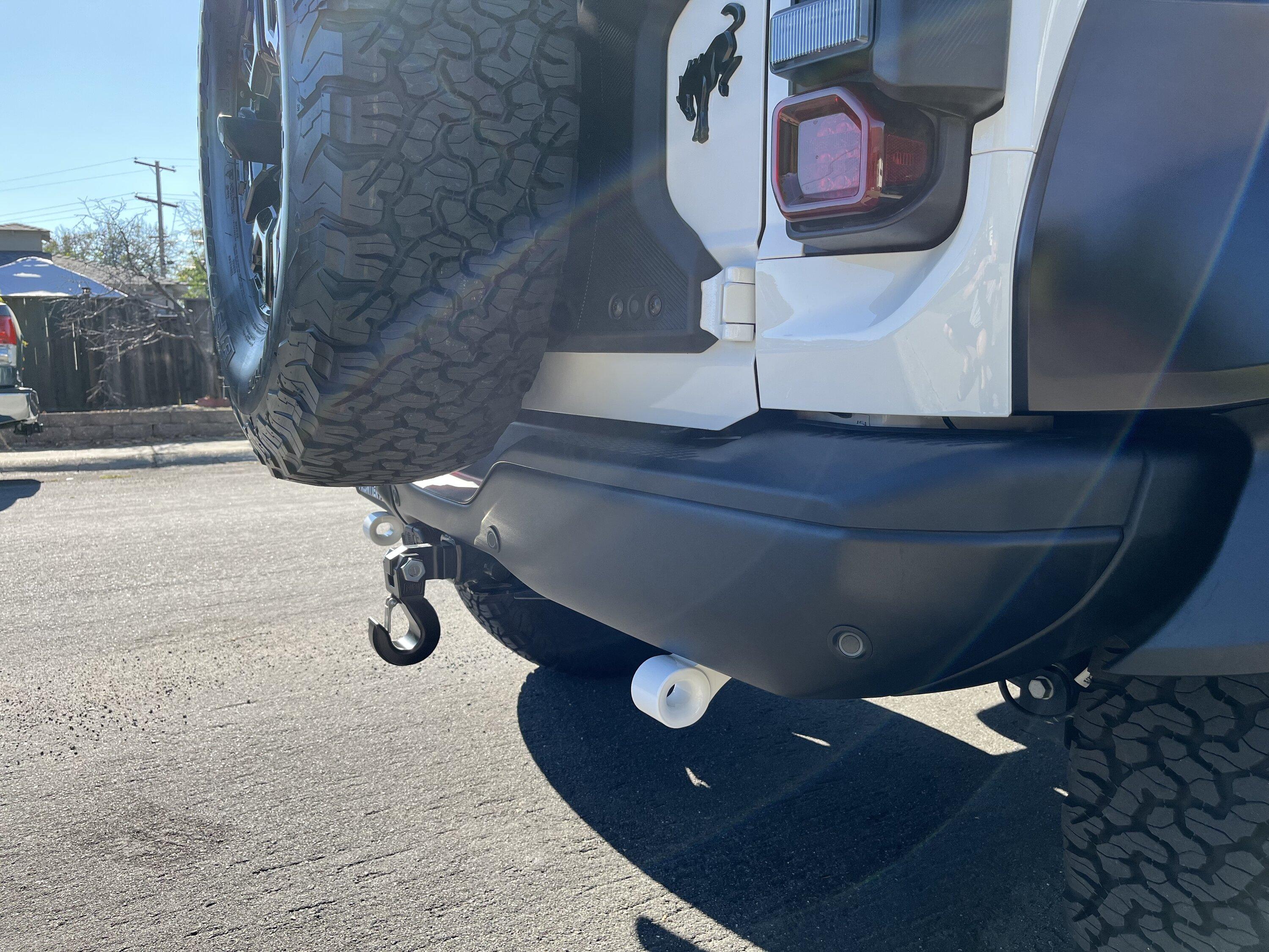

Seems like a lot of people are looking to put a factory tow hook on the rear passenger side of Broncos that only come with a rear drivers side tow hook. The Ford dealer parts department didn't have an easy time finding it, but they eventually did. Not cheap, though. $71 for the hook and $6 for the two bolts. I used my Ford points, so it wasn't as painful. Torque for bolts is 59 ft/lbs.
Complained to my dealer because I thought that my BD had arrived misconfigured and they set me up with one for free.
