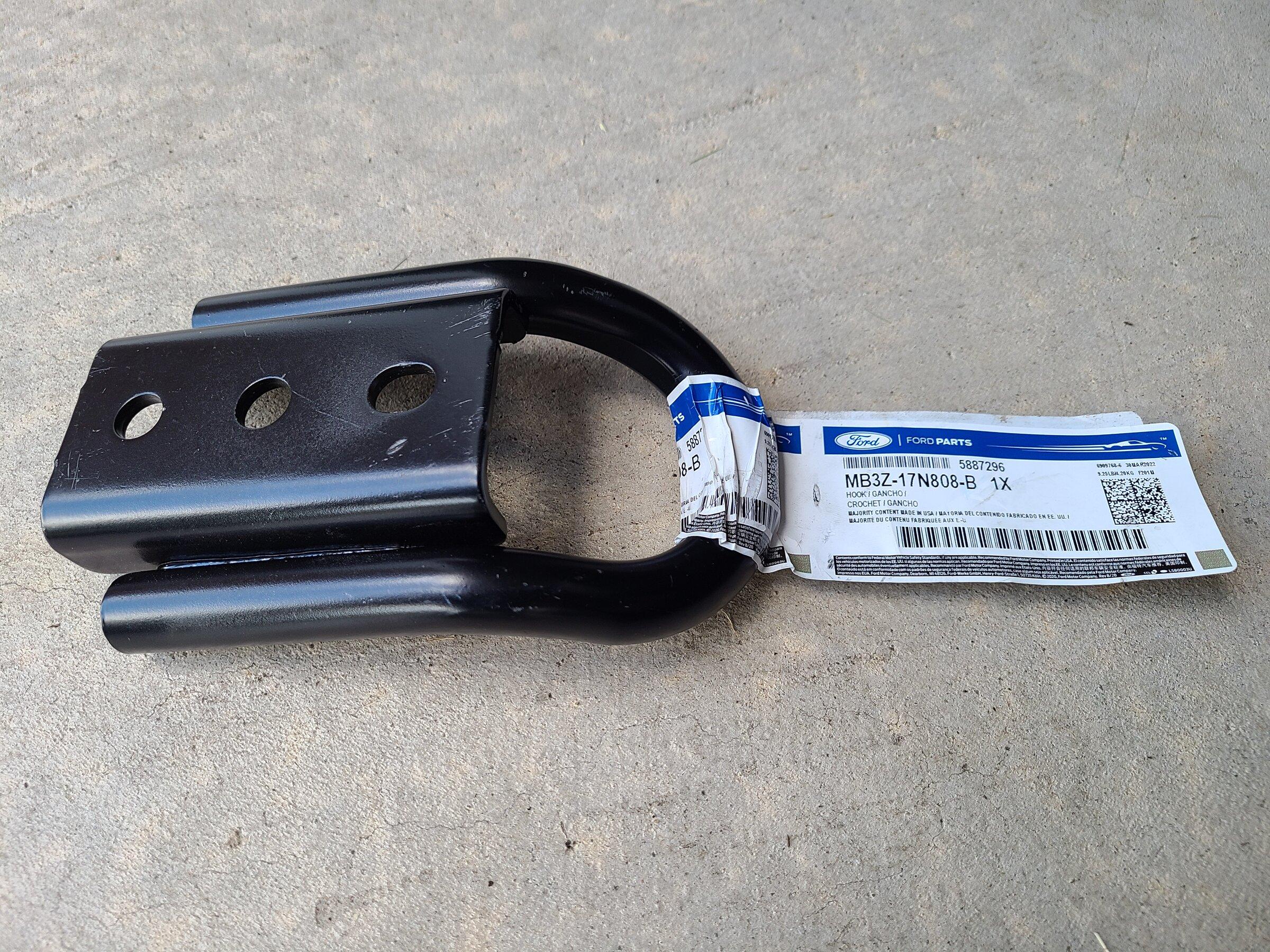

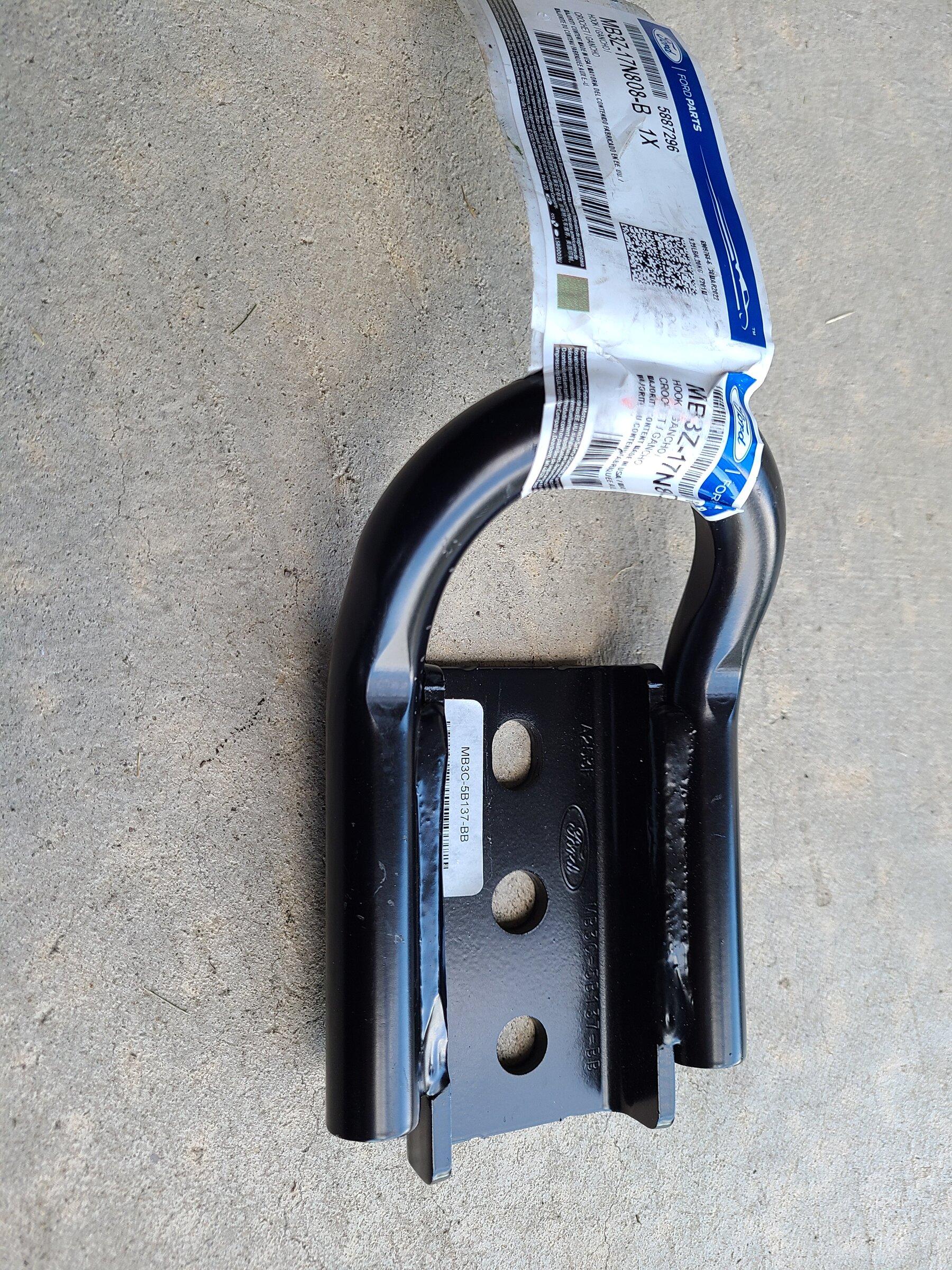

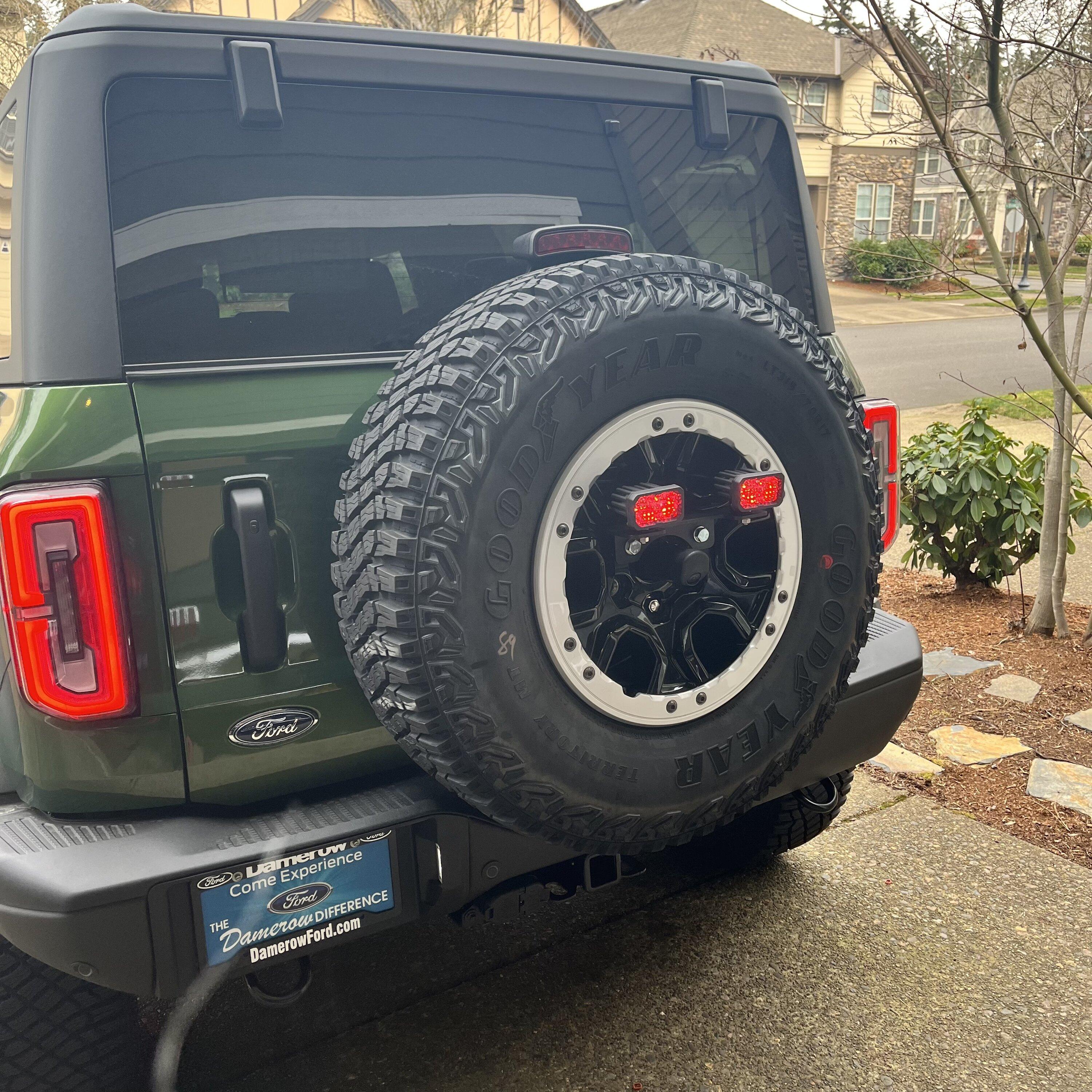

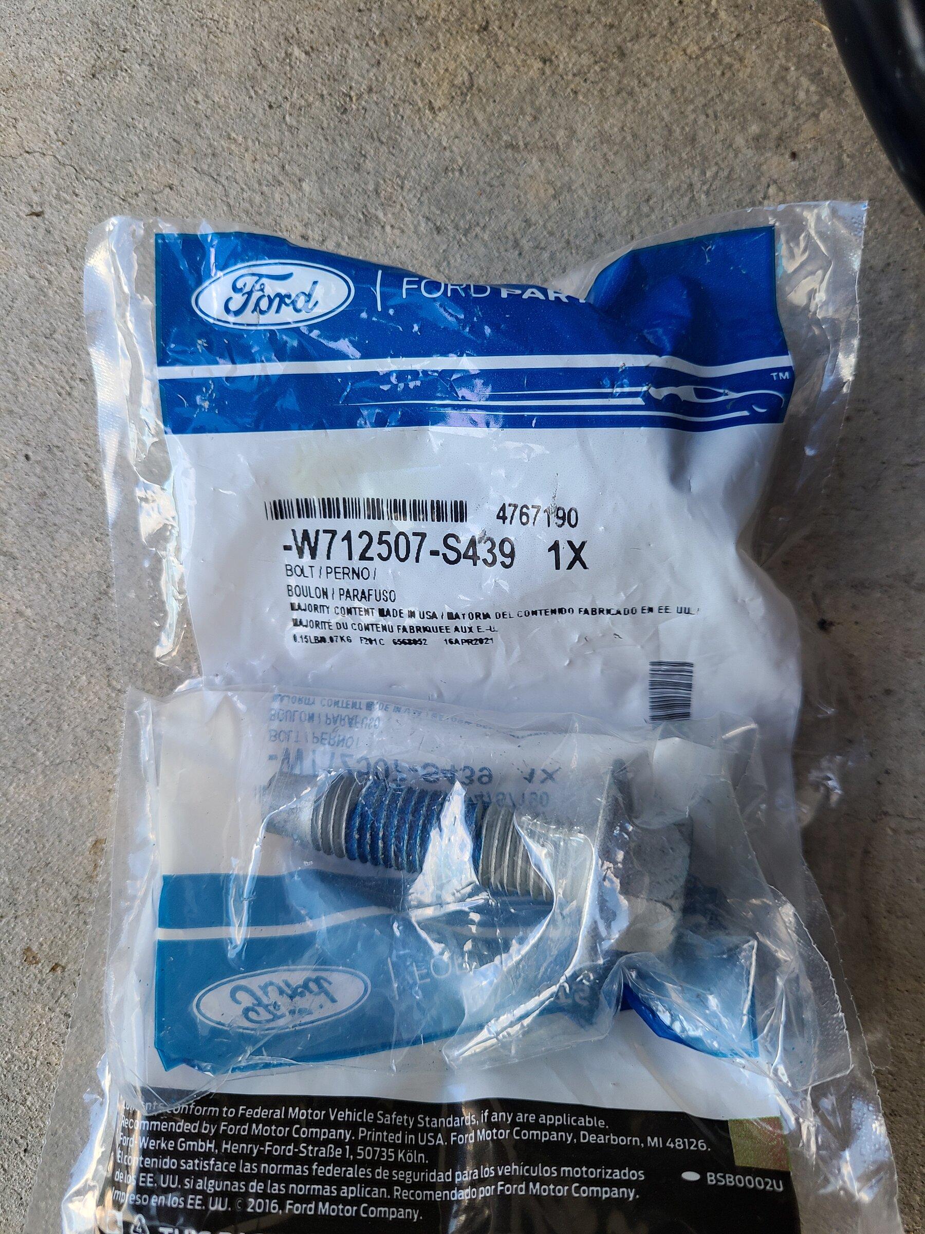

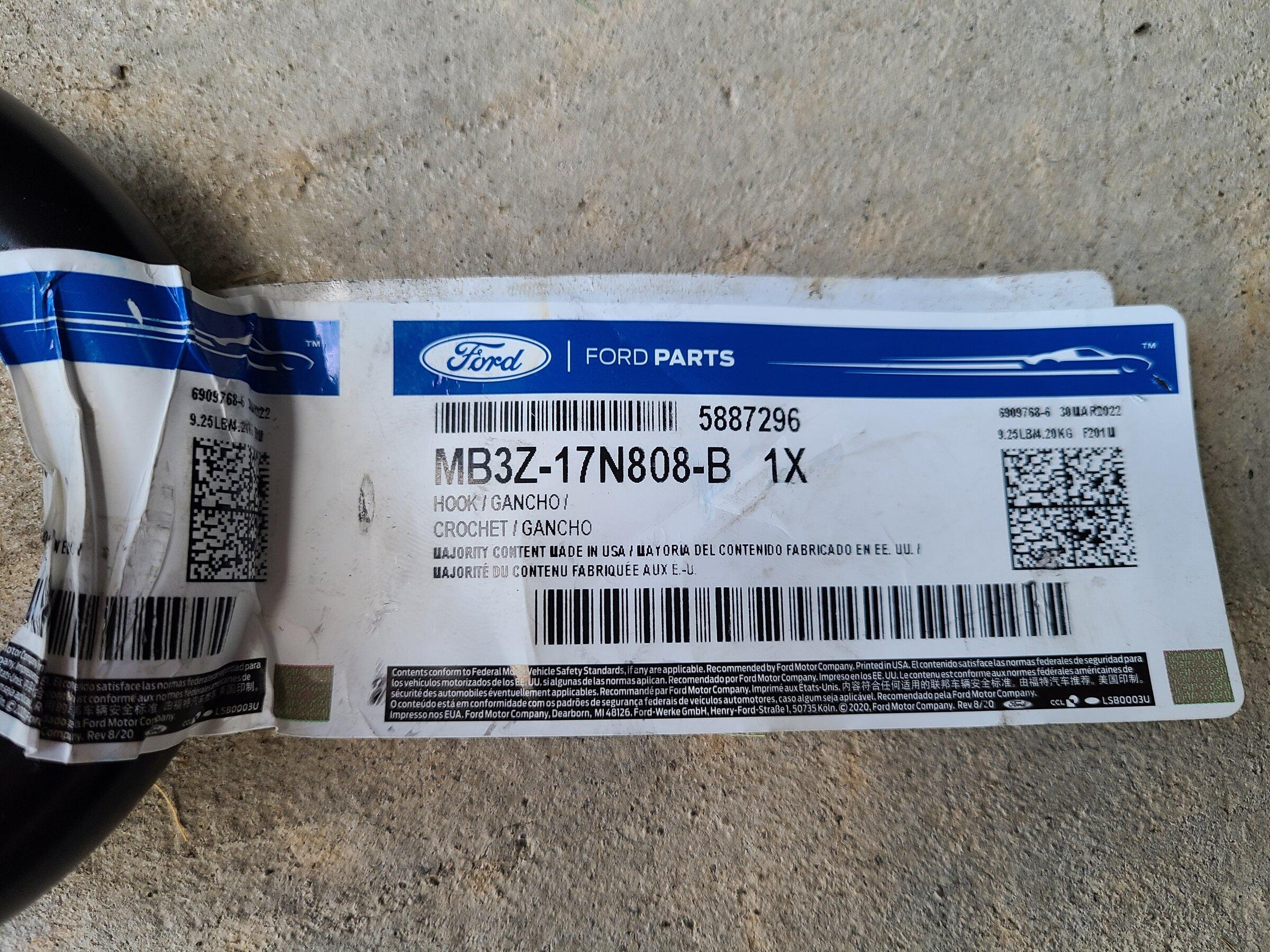

Seems like a lot of people are looking to put a factory tow hook on the rear passenger side of Broncos that only come with a rear drivers side tow hook. The Ford dealer parts department didn't have an easy time finding it, but they eventually did. Not cheap, though. $71 for the hook and $6 for the two bolts. I used my Ford points, so it wasn't as painful. Torque for bolts is 59 ft/lbs.

Thanks for this. I ordered one for my BD ‘22.
Are you able to tell me the size of the bolts - what size wrench will I need to put these on?
Thanks.
No problem. The bolt takes an 18mm socket.

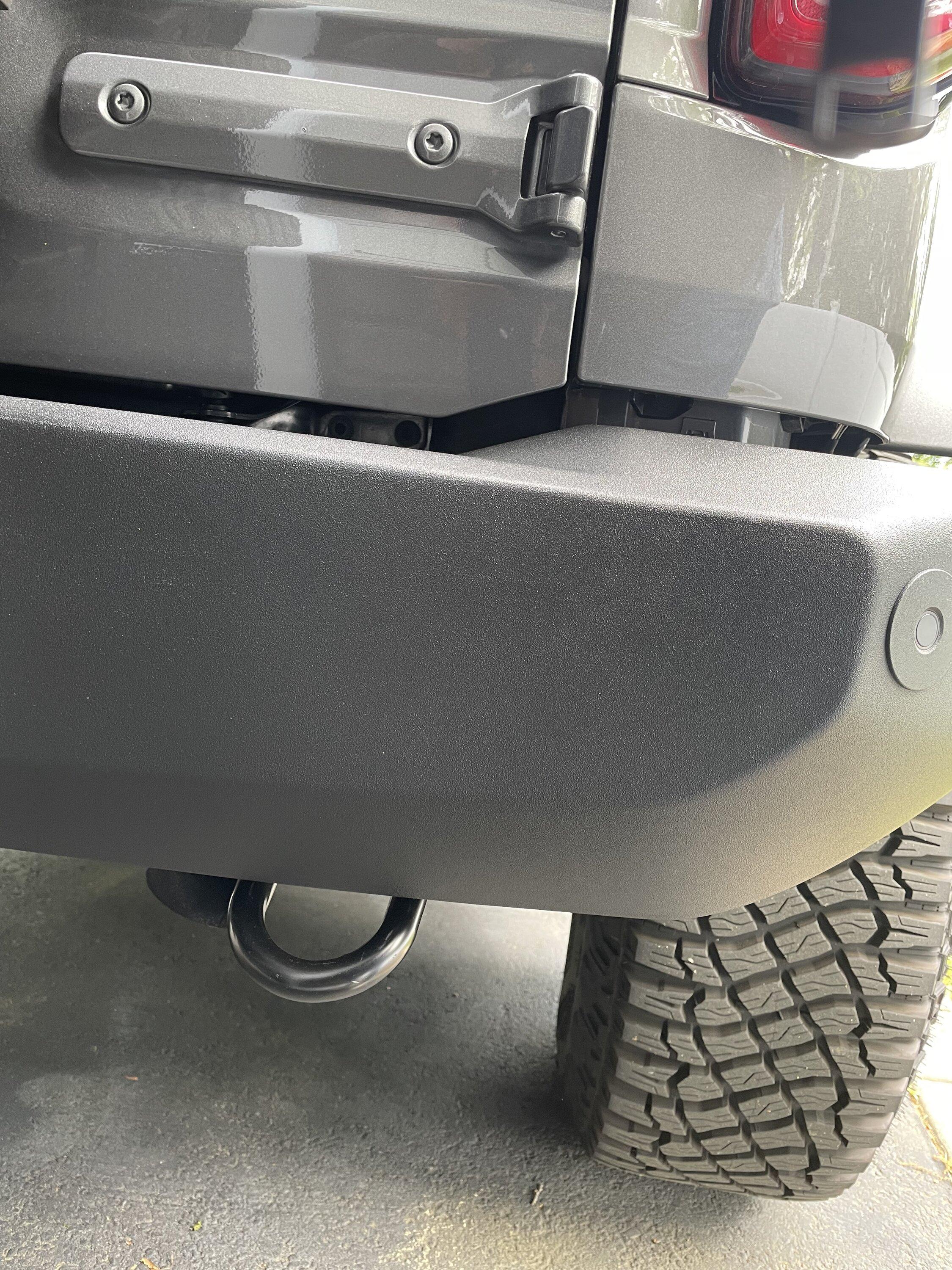

Got mine installed, but can’t find where to activate it in ForScan

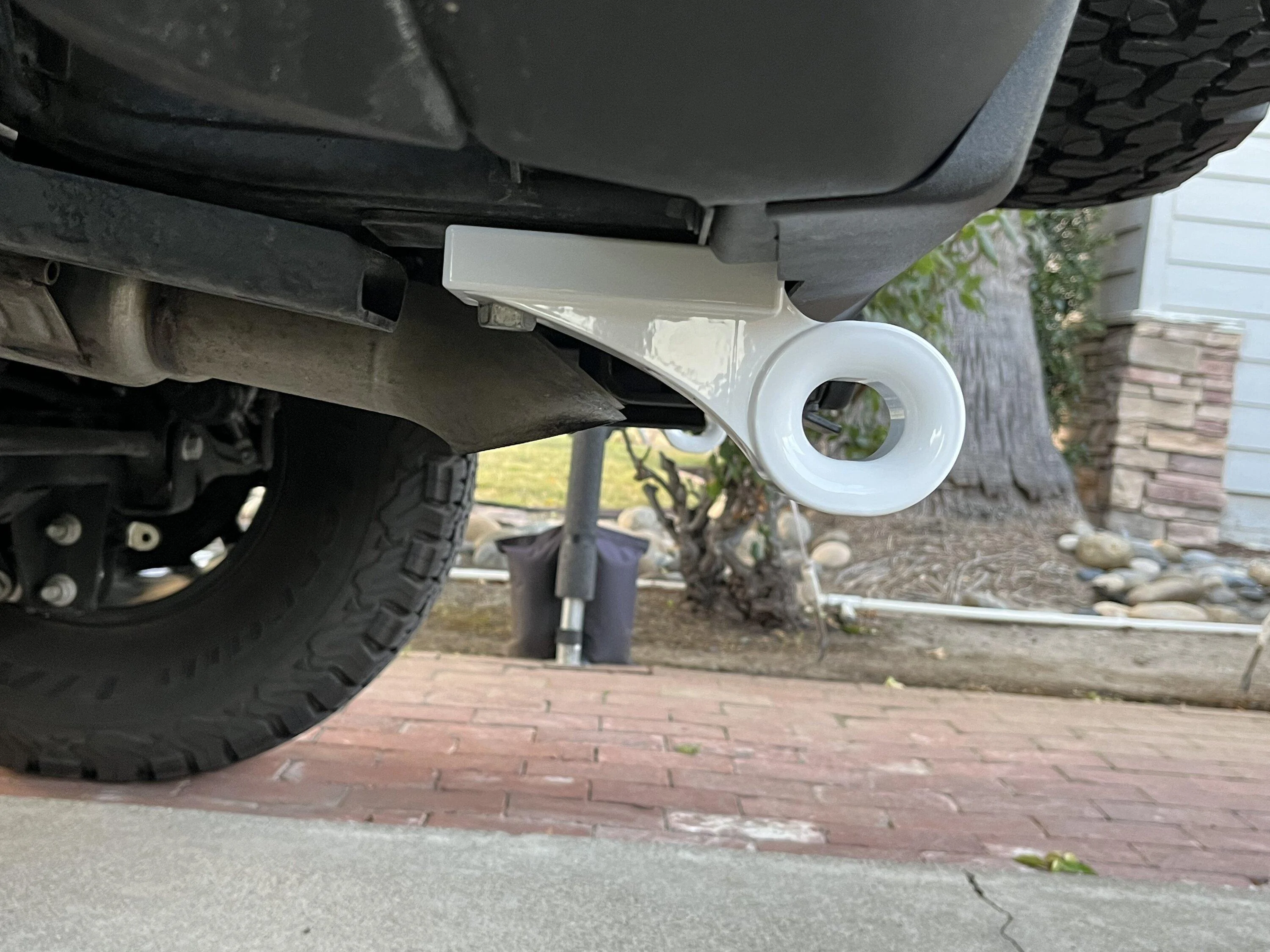

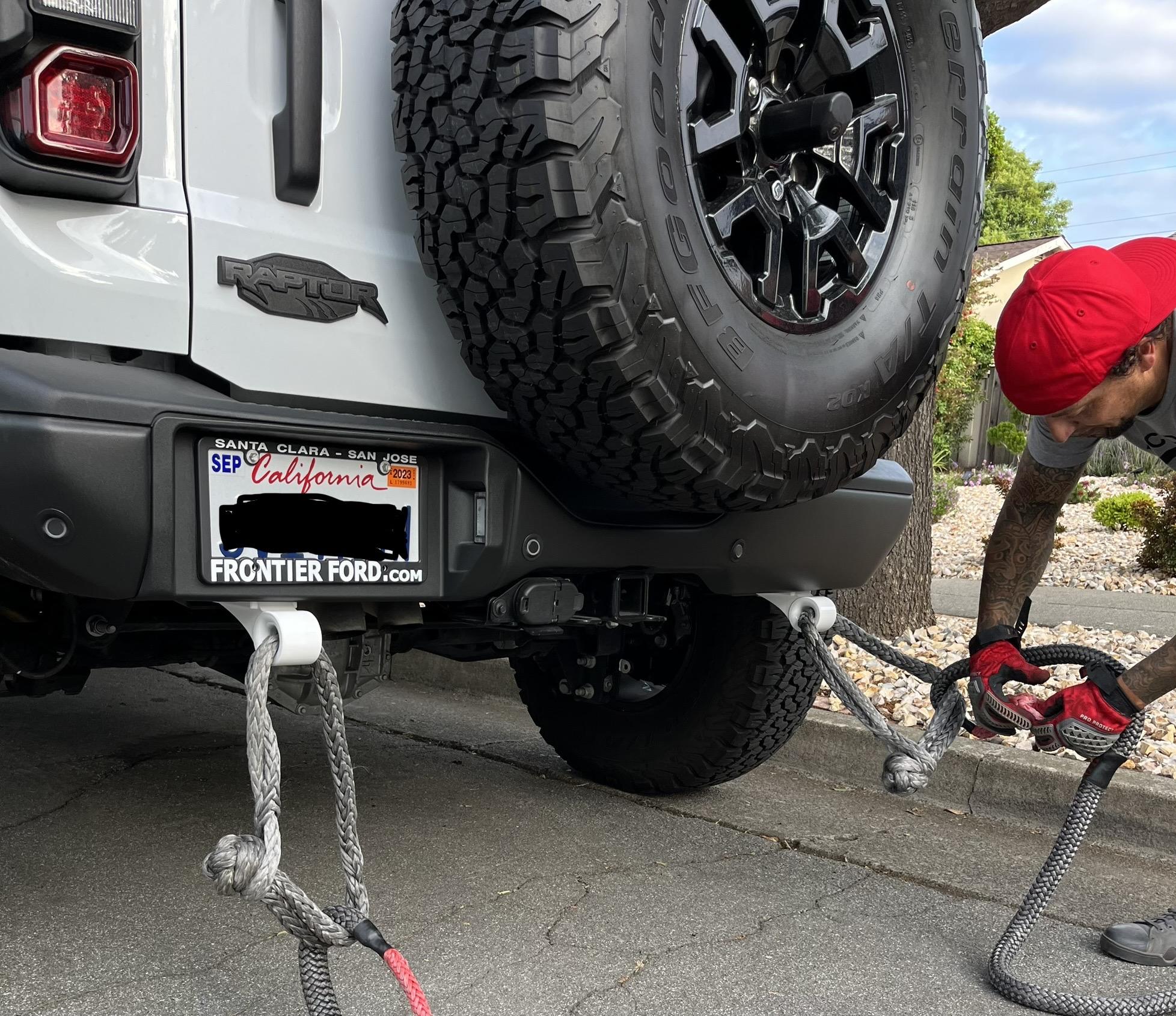

Monster Hooks Inc is coming out with these.
BTW these are made from 6061 aircraft grade aluminum, powder coated, will come in a few different colors, and have the rating laser etched onto them. I was lucky enough to get a pair before they are released in a few days.
